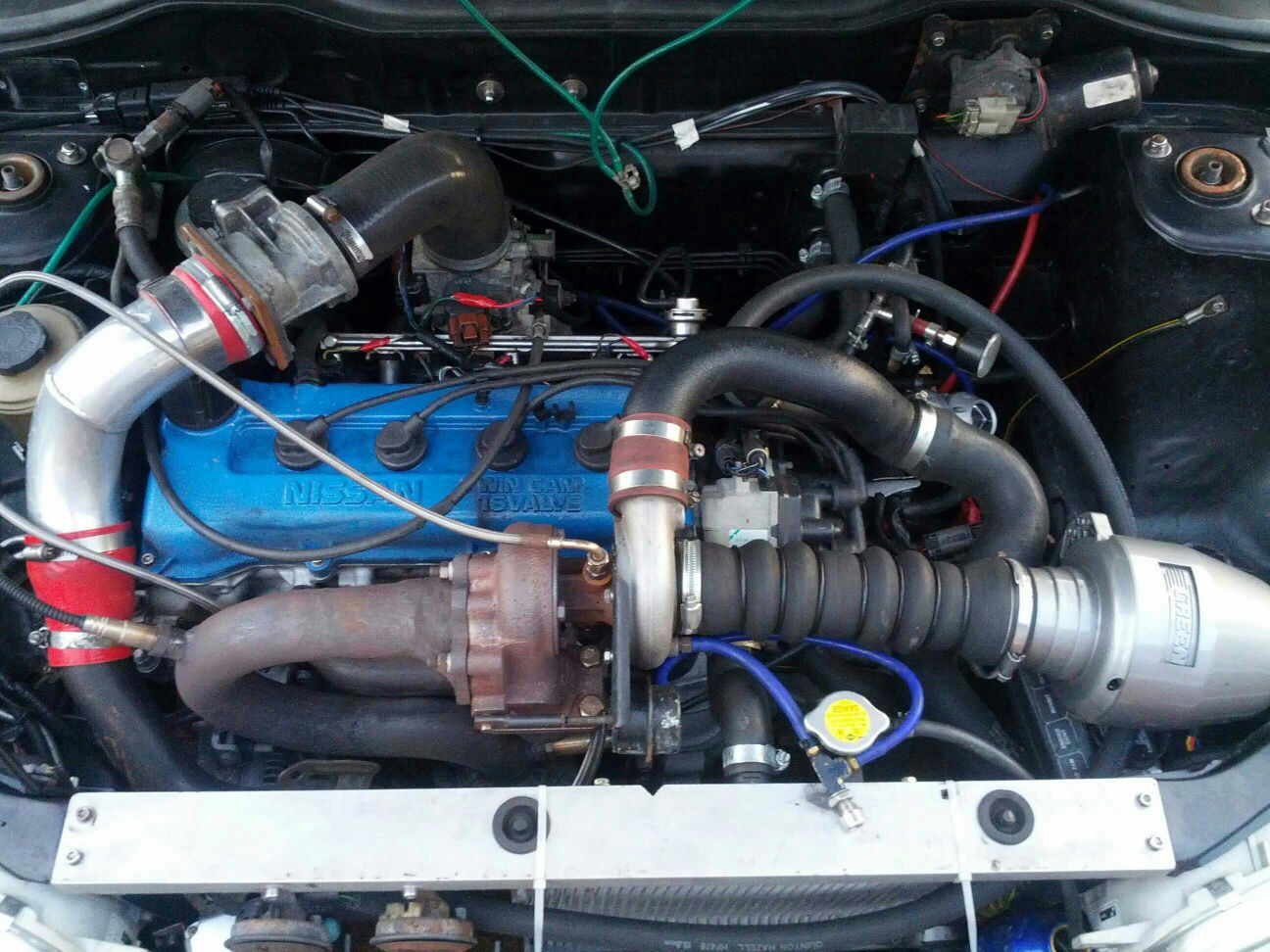

You legendyes i took the slam and grille off to show you in detail mateand try a bike pump on the w/g pipe
Yours looked like it was mounted high at jae mate any chance I can get a pic of your set up?Jesus that's loads of room what you talking about
NoYours looked like it was mounted high at jae mate any chance I can get a pic of your set up?
OkNo
sounds like a vacuum one mate, and there,s no pipe fitting on the alloy compressor housing eh, my 1st two tubby,s were vacuum ones tom, i just fitted a + pressure actuator and repositioned the arm (i had to move the arm on most of mine, after clocking the turbo anyway)You legend
