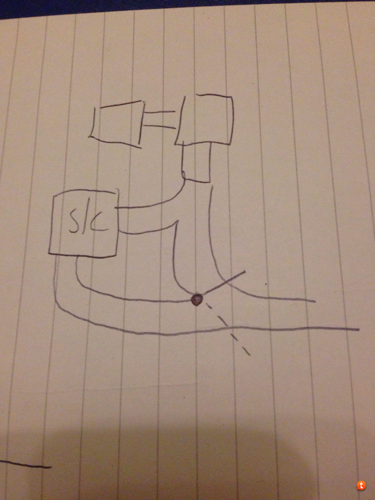

There is still nothing stopping boost from sc blowing back through the turbo and escaping eh? Was thinking more like this:![]()
Better? One valve, no solenoid
you would only need the 1 eh neil, mounted in the s/c exit pipeCheers(actually i do remember you suggesting that earlier on)
Turbo exit pipe surely? Much easier for sc to blow past a non spun turbo than for a turbo to blow through an unspun screw supercharger ehyou would only need the 1 eh neil, mounted in the s/c exit pipe![]()
Nah, siamesed inlet with the reed valve in the s/c exit, then you can choose between the 3 options at the flick of the magnetic clutch switchTurbo exit pipe surely? Much easier for sc to blow past a non spun turbo than for a turbo to blow through an unspun screw supercharger eh
Quick sketch for my bleach fume soaked brain?Nah, siamesed inlet with the reed valve in the s/c exit, then you can choose between the 3 options at the flick of the magnetic clutch switch![]()

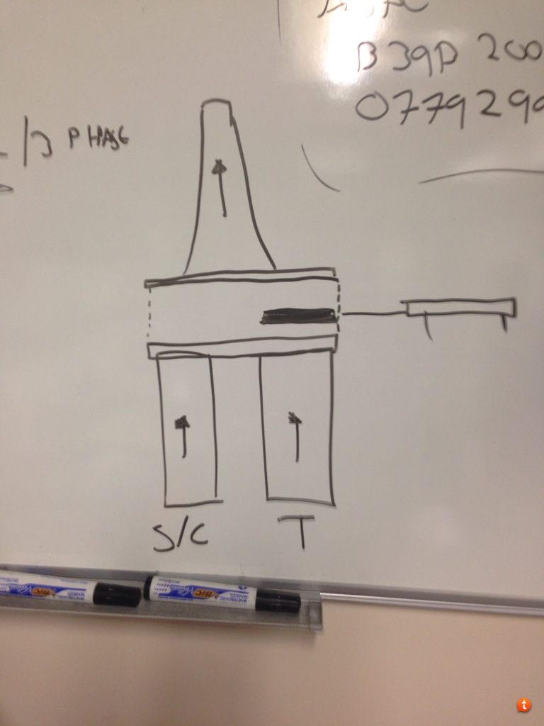

That would work but I've never seen or heard of a valve like that... maybe you could make one?How about this?
1 valve

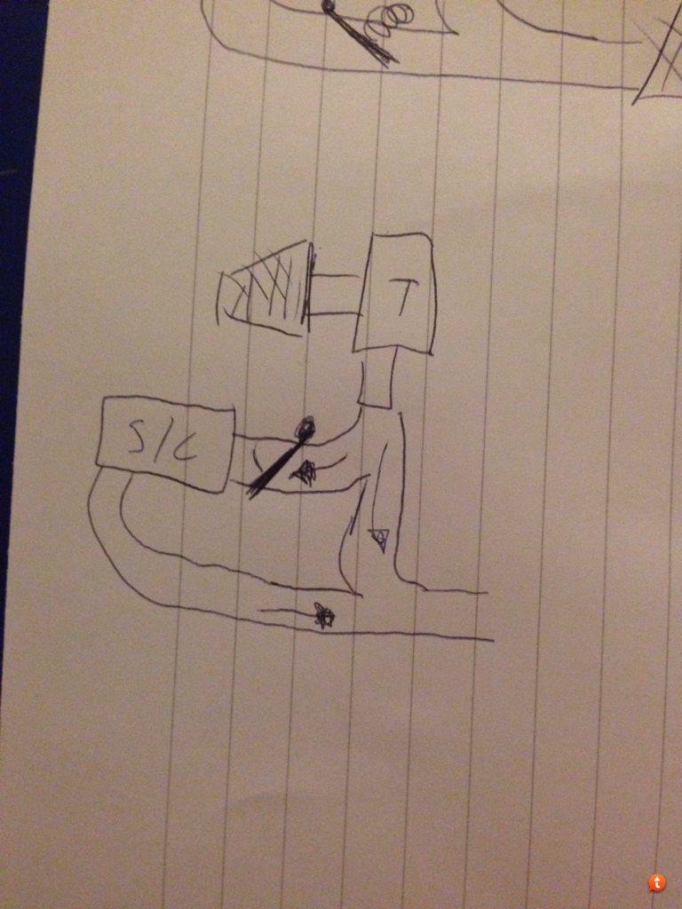

Drawings?I'd go for giving the s/c it own inlet and just a bypass valve on s/c exit
No extra heat by blowing through each other and you can link the bypass valve to the electroclutch
So it closes when the clutch goes off
Much simpler no?
Bare with me a few minutesDrawings?
Nothing to stop boost generated by supercharger escaping back through turbo ehFound it
It should be ok. That drawing is exaggerated to give me a clear view. But the charged air would have make near enough a u-turn to towards the turbo. The turbo pipe should have a positive pressure in it to prevent that and also engine vacuumNothing to stop boost generated by supercharger escaping back through turbo eh
That U bend won't stop the boost escaping mate, will only limit the flow slightly. Unless the turbo is generating as much as or more pressure than the S/C the compressed air will escape through it no matter how convoluted the pathIt should be ok. That drawing is exaggerated to give me a clear view. But the charged air would have make near enough a u-turn to towards the turbo. The turbo pipe should have a positive pressure in it to prevent that and also engine vacuum![]()
Nah, driving air back through a turbo does hardly anything, would still spin up fine, will just get chatter which won't help the life expectancy...Wouldn't that sort off stall the turbo aswell?
We'll soon seeThat U bend won't stop the boost escaping mate, will only limit the flow slightly. Unless the turbo is generating as much as or more pressure than the S/C the compressed air will escape through it no matter how convoluted the path
Flow and pressure are different beasts rememberWe'll soon see
I'm confident it'll be ok. Basing it in the "air flows the path of least resistance"
I'd say that rule would apply regardless.Flow and pressure are different beasts remember
Well it will because while the engine isn't admitting air the pathway is blocked and the only 2 exits are back through sc or back through tc, and the sc will easily overpower the turbo. Just checked with another maintenance bloke here and he came to the same conclusion...I'd say that rule would apply regardless.
