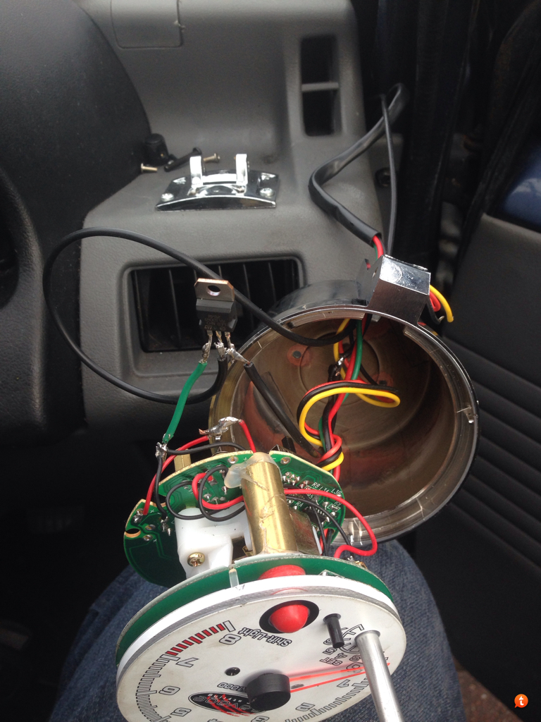

Tried wiring up into the rev counter light today
Experienced a problem.......here's a video off what's going on.....
The black rev counter wire I'm joining the relay coil too only shows 12v when light is illuminated and 0v when off, but when I add the coil wire it dimly illuminates the light when it's meant to be off, the light should jus be on or off, no in between lol.
It's operates the coil once, but then I have to remove the wire to stop dim light, otherwise the coil stays engaged...,.::::if any of that makes sense :D
Video may help
Try swapping thr wires on the relay. Some relays have a flyback loop diode, might be interfering with the circuit in the rev counter. Or the coil may jist be drawing too much current...
It's jus a standard 5 pin relay
Tried swapping connections over.
The volts is switched on the - wire inside the rev counter too, the + sees 12v all the time
Gunna need bit off help on this bit people, lol, where do I put a/which transistor

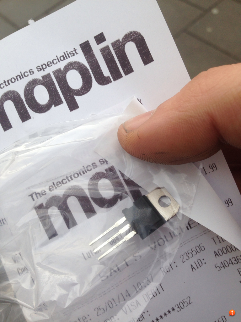

i mean use a transistor to drive the relay mate :)
If you can wait I'll do a detailed drawing and explanation tonight... but basically a transistor is a tiny little switch thats on when you apply a + voltage to the signal input on the transistor
Edit: Use the transistor to switch the relay coil, transistors don't deal well with high current without masive heatsinks...
Amazing!!!
Cheers!
Now I gotta find one from somewhere by tomorow

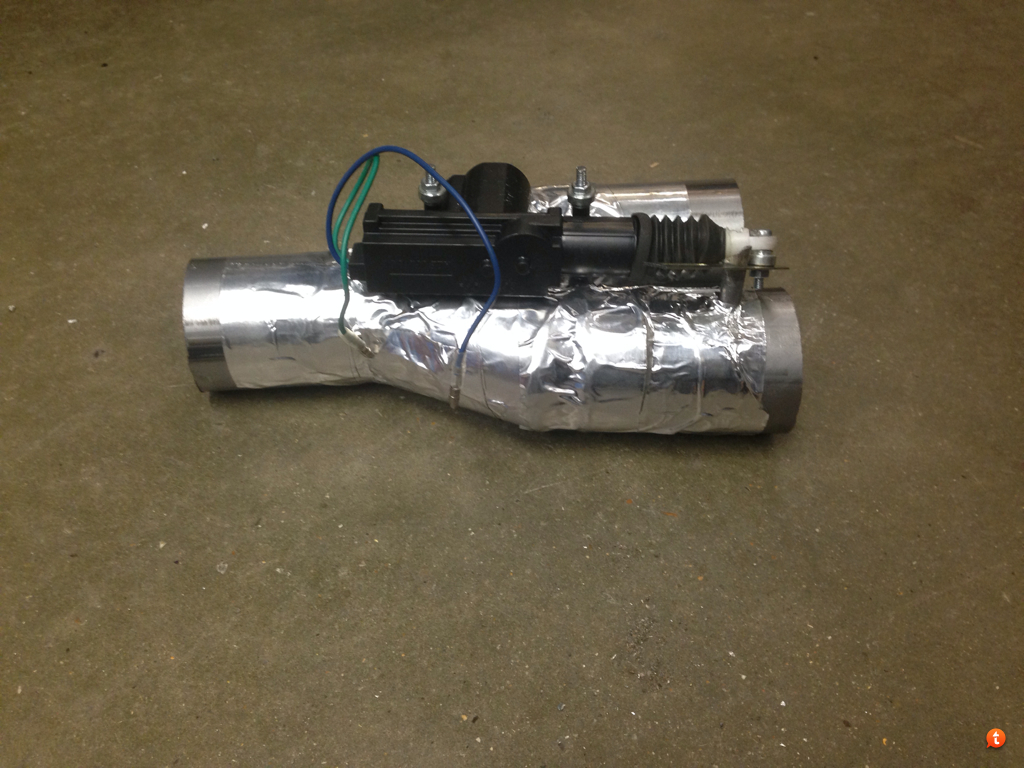

Oh, here's my valve thing I made too, it's close to exhaust so wrapped it in heat reflective tape, controlled by a central locking solonoid
Looks awesome!
Well I can't find another door solenoid anywhere :(
I can get the s/c to boost thru 1st gear if I manually shut valve, but as soon as turbo boosts, it opens the valve and it stays open, so when you go into 2nd and s/c is back on, it's jus recirculating the boost.

Apparently those door solenoids will always burn out if left on for more than a few seconds
If I put a light spring on the valve keeping it shut, would the turbo pressure be enough to open it?

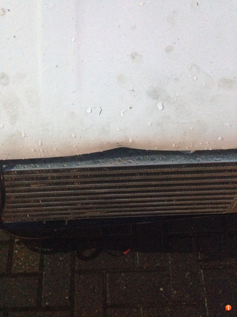

Popped down the shops in my van, then random massive lightning /gales/ hail ston storm happened, came back and bonnet had been blown off and dented :(
That's the second bonnet that's flown off now and damaged.....really should bolt it on :D
Made a quick spring out off weldind wire and fitted it, feels ok, not to much tension, jus enough to reset the valve after turbo has opened it
