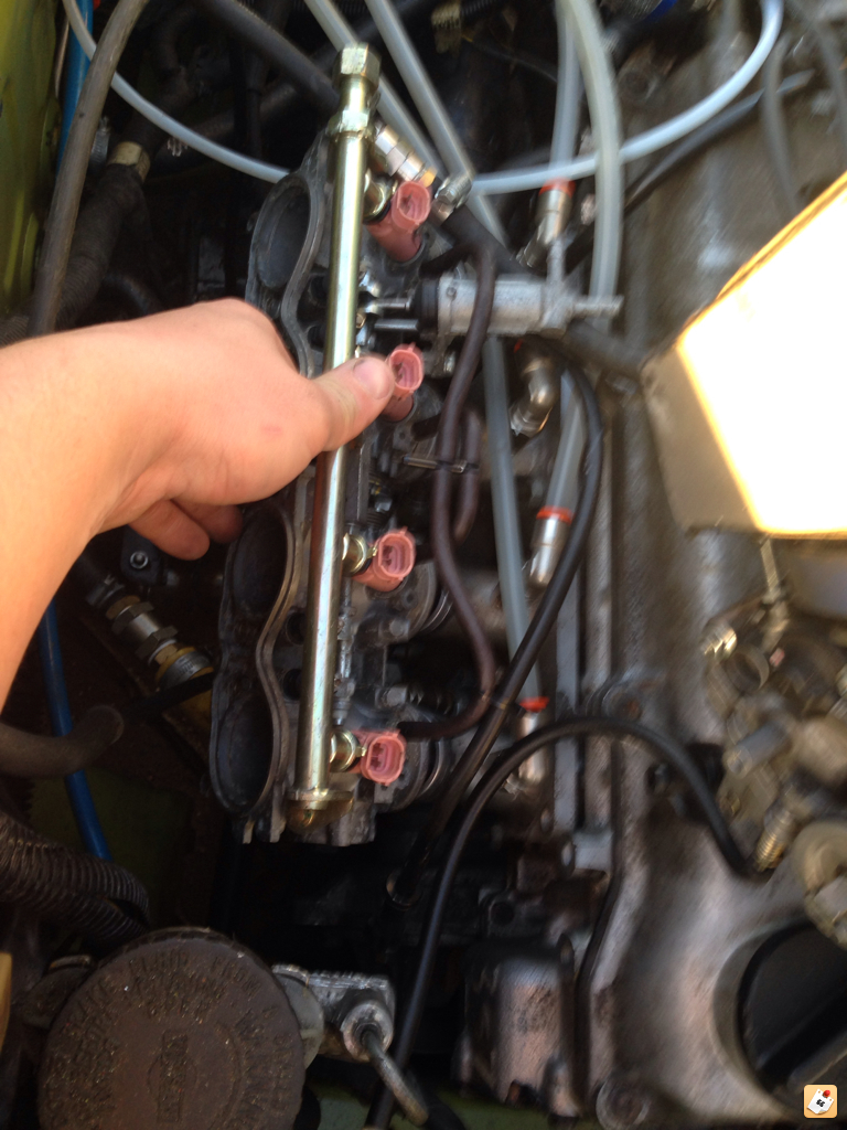

just the job neilbosch topfeeds by the looks 0280 155 ???
nah, pre nats (type 5) nistune neilCool!!
So if I use my swirl pot system, replace the pump with hp pump , and rising rate reg......megasquirt ?
whats the part number on the side of the injectors ?Havnt a clues mate lol
Would I need maf sensor
just a pump really mate, i ran my ghetto setup on 30psi fuel pressure for monthsIl have to check later, the mrs weren't happy I was at workshop playing on Xmas eve lol

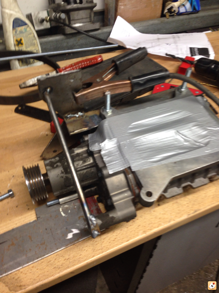

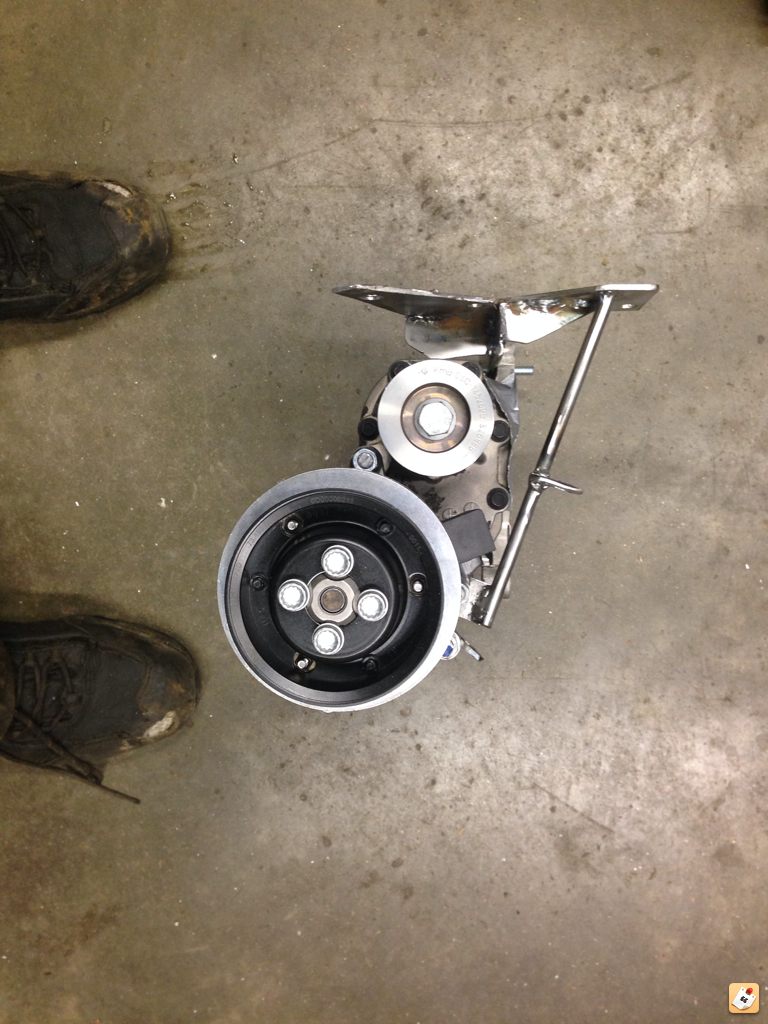

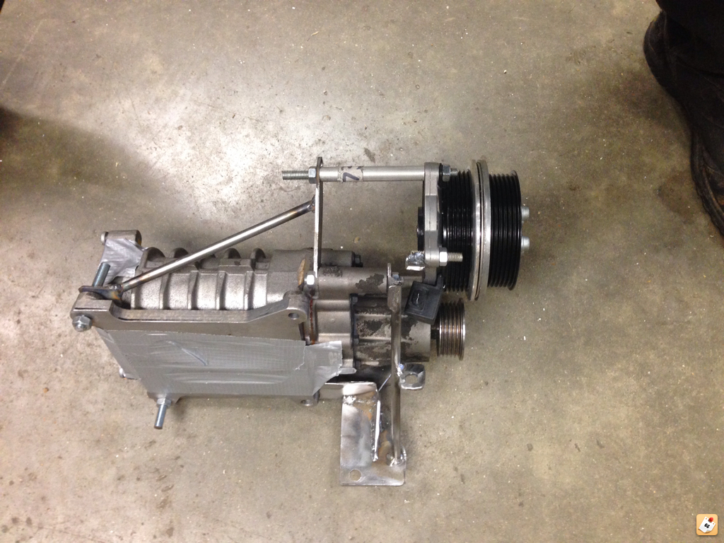

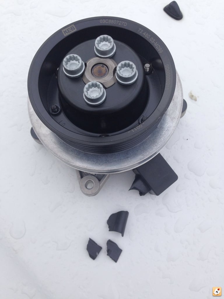

Pr0nStarted on supercharger and magnetic pulley brackets today, jus about squeezed it all in, it's going under alternator
Chop chop, saw saw, weld .....here's some pics
Belts coming tomorow, then gunna strengthen where necessary
