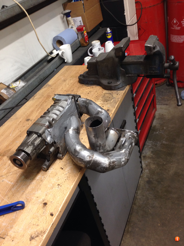

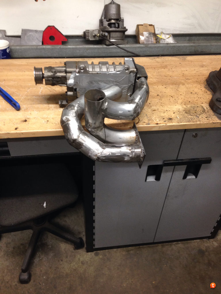

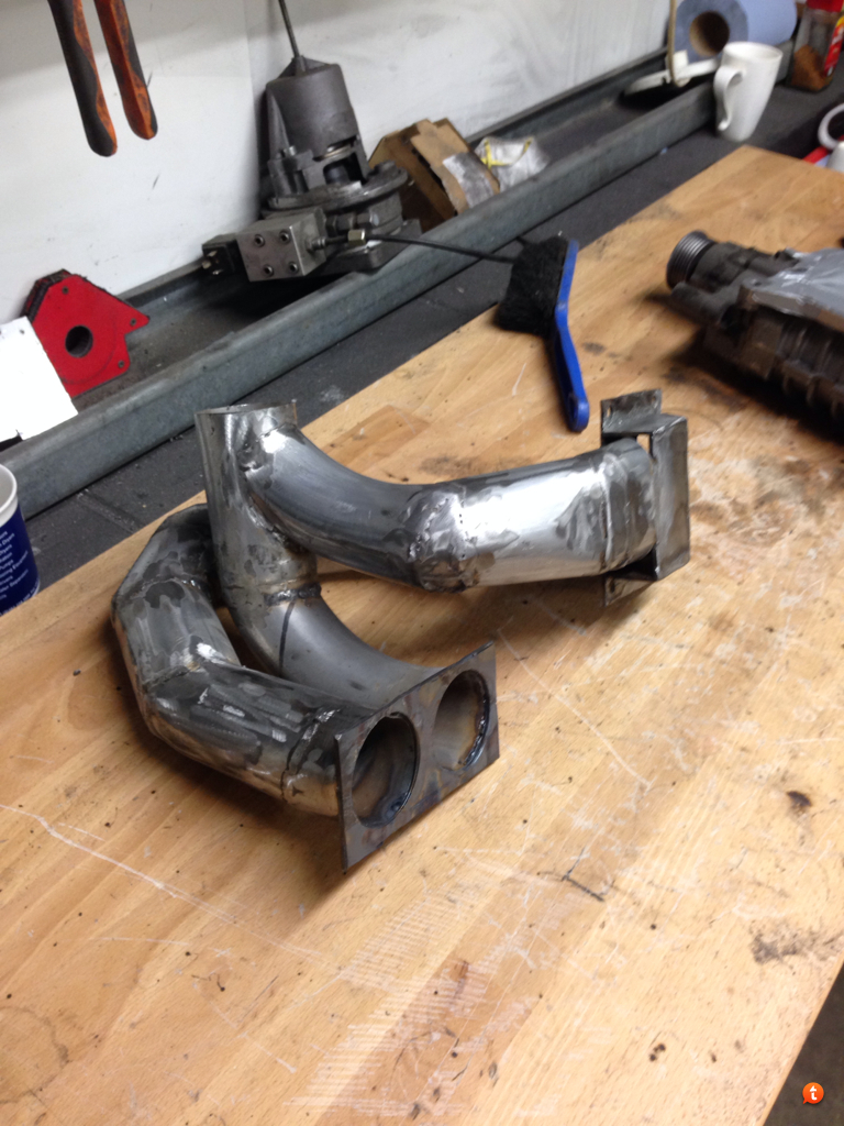

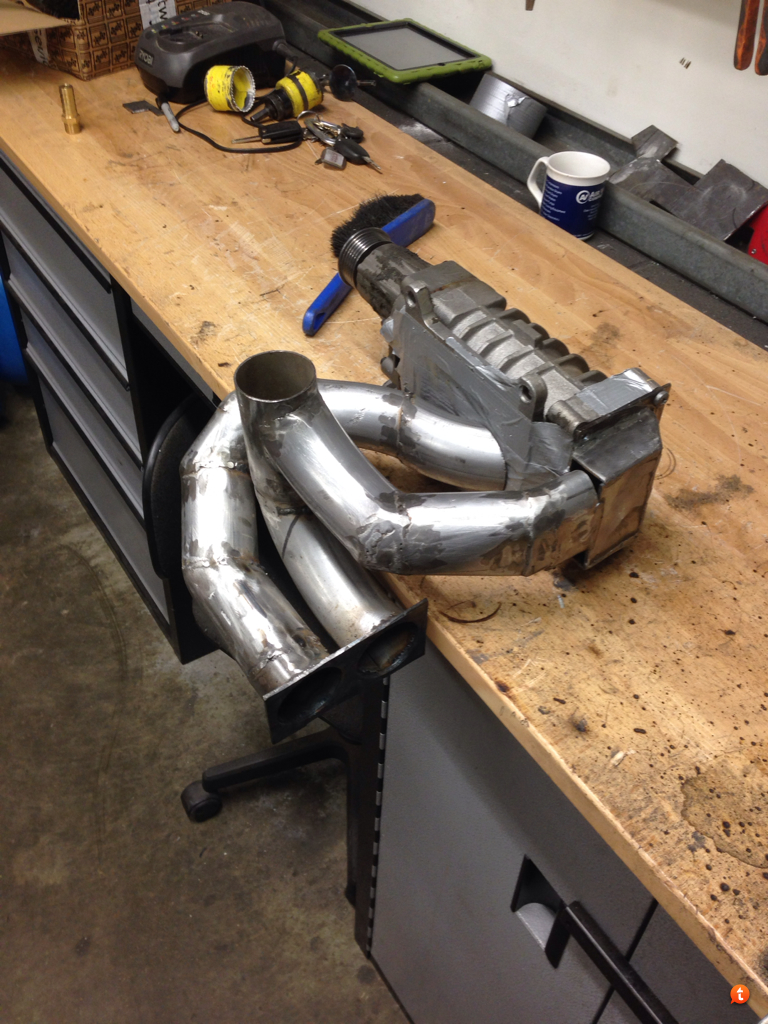

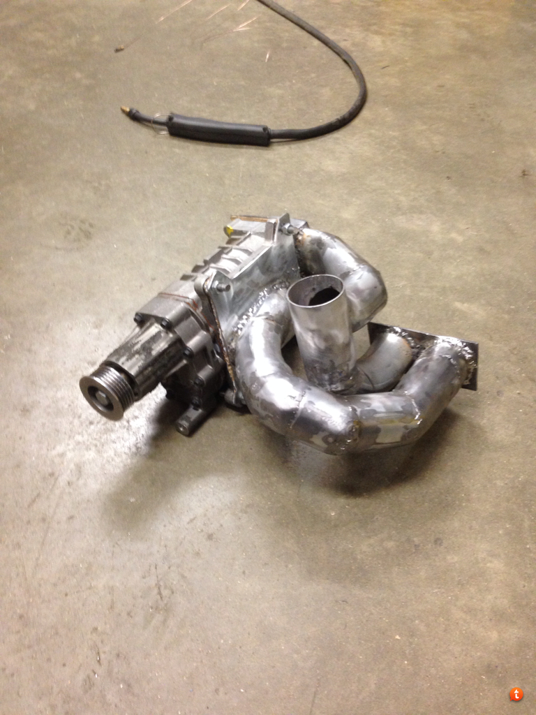

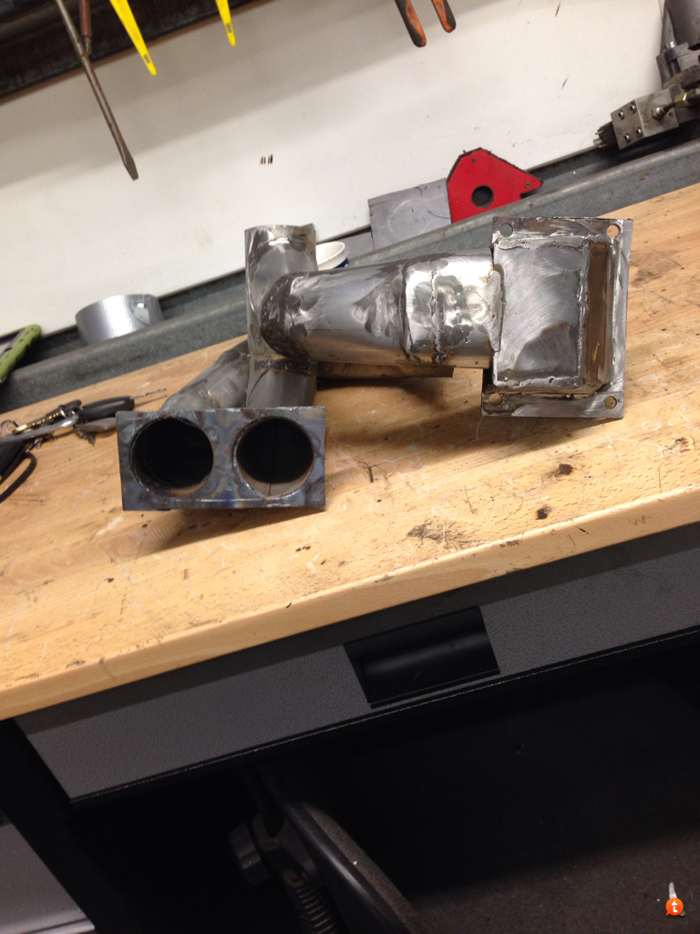

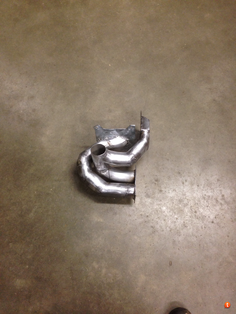

Manifold so far.....

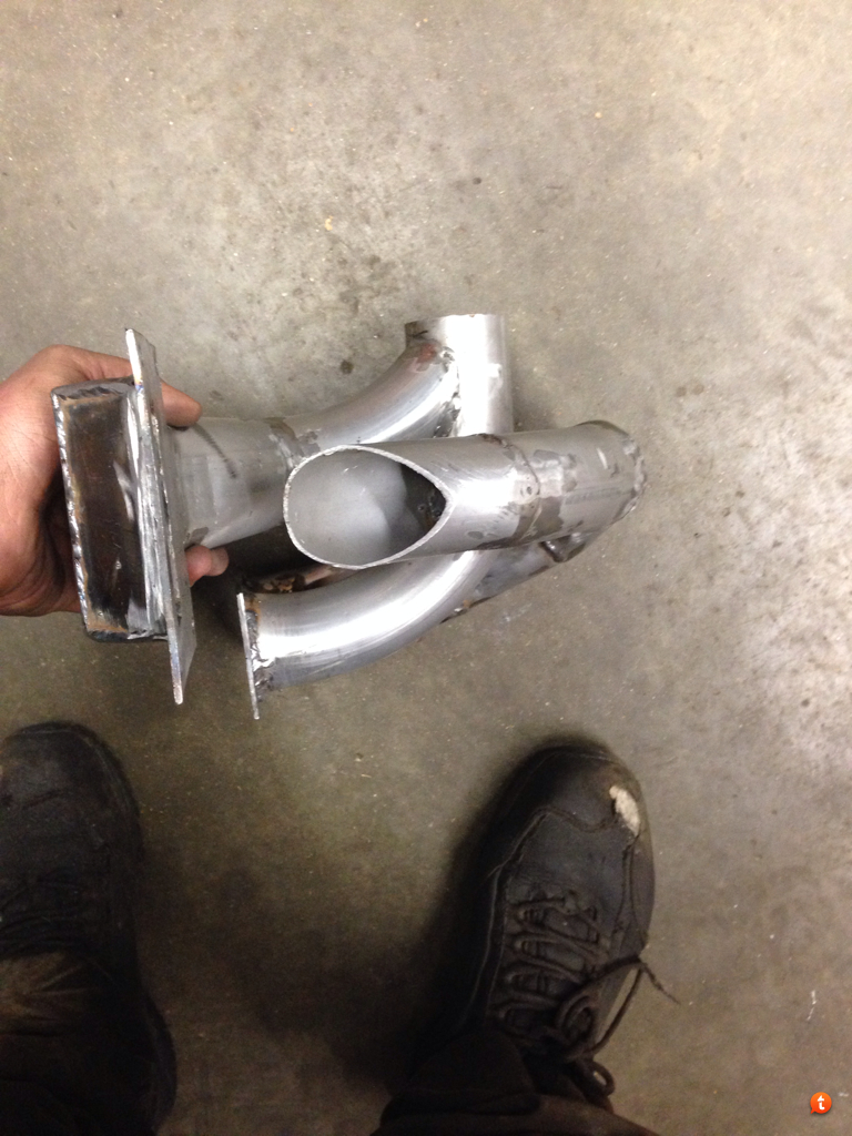

A lot more grinding needs to be done to maje it look pretty, but you get the idea
Turbo goes in top hole ;)
Cheers ,
Need another plate to make outlet flange, and start on flappy valve thing lol

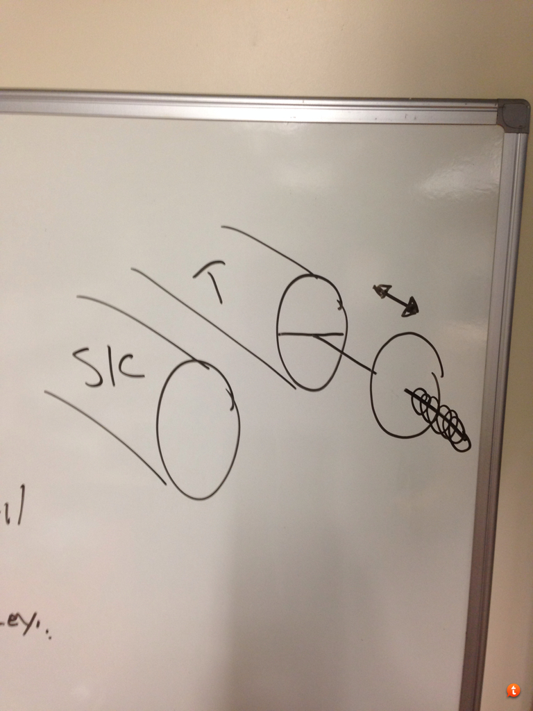

Right, lol, had another thought
I've tested back flow thri the s/c, there's little or next to nothing that comes back, so no need to block s/c whilst turbo is boosting

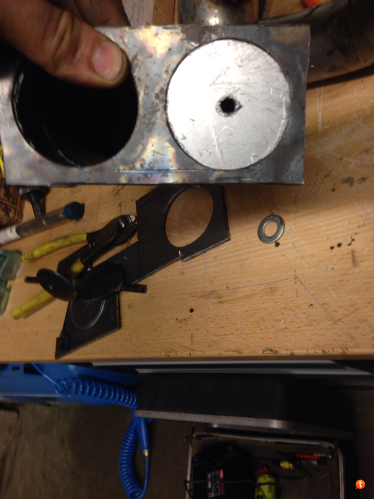

So would this be ok as a valve for blocking turbo whilst s/c is boosting ....
Or would it be to restrictive on the turbo?
Or would hinged flap valve be better?
I've got the disc cut perfect for it,
Probably be fine, but I'd make the disc larger than hole diameter, then turbo pressure is acting on a larger surface area once opened and will hold it open wider, and you can also then fit an o-ring to it to aid sealing. I still think the reed valve is the way to go however.

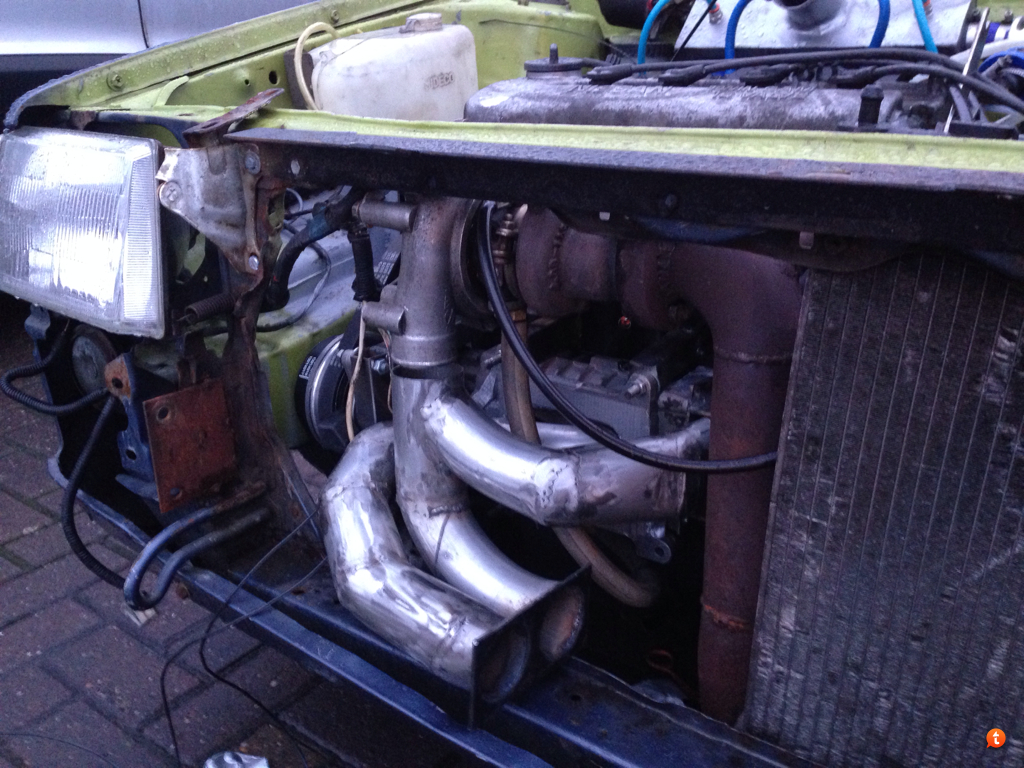

Ok,

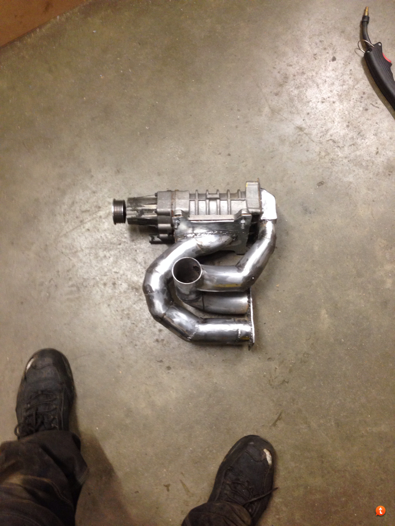

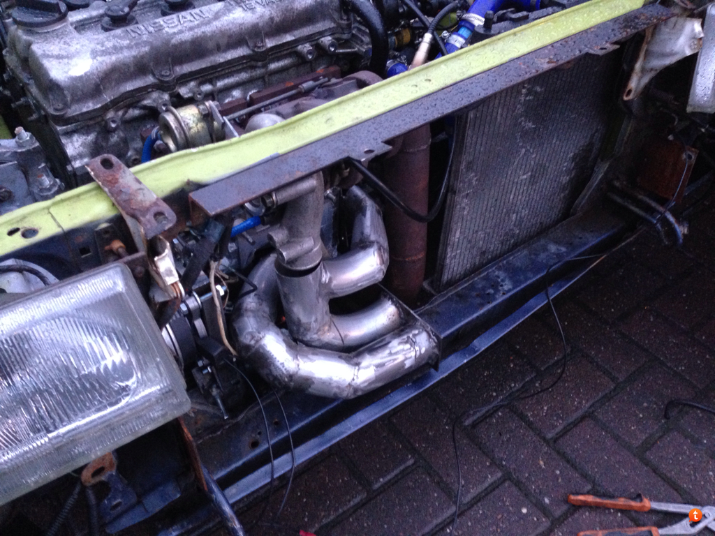

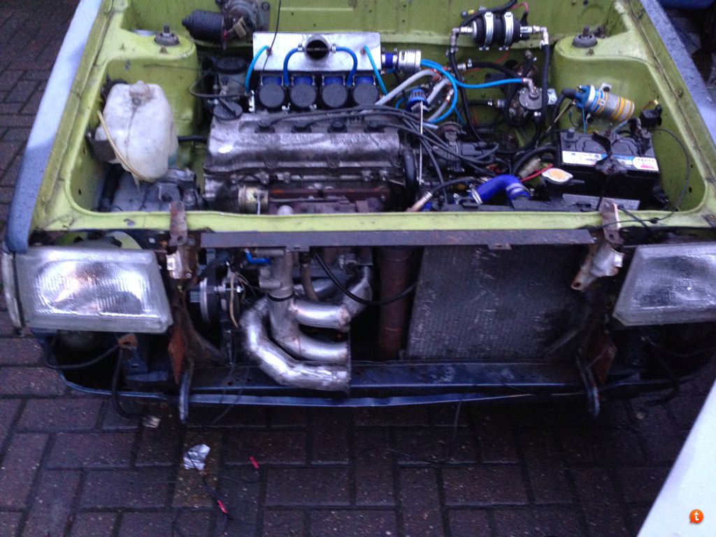

I havnt finished the pipe/manifold yet,
This was just a test to see whether it all lines up and clutch works, I guess it will be quieter when it's piped up, I have removed A LOT of sound proofing to that came with the charger (would melt where it is ......
Anyway.....
Ok,
Anyway.....

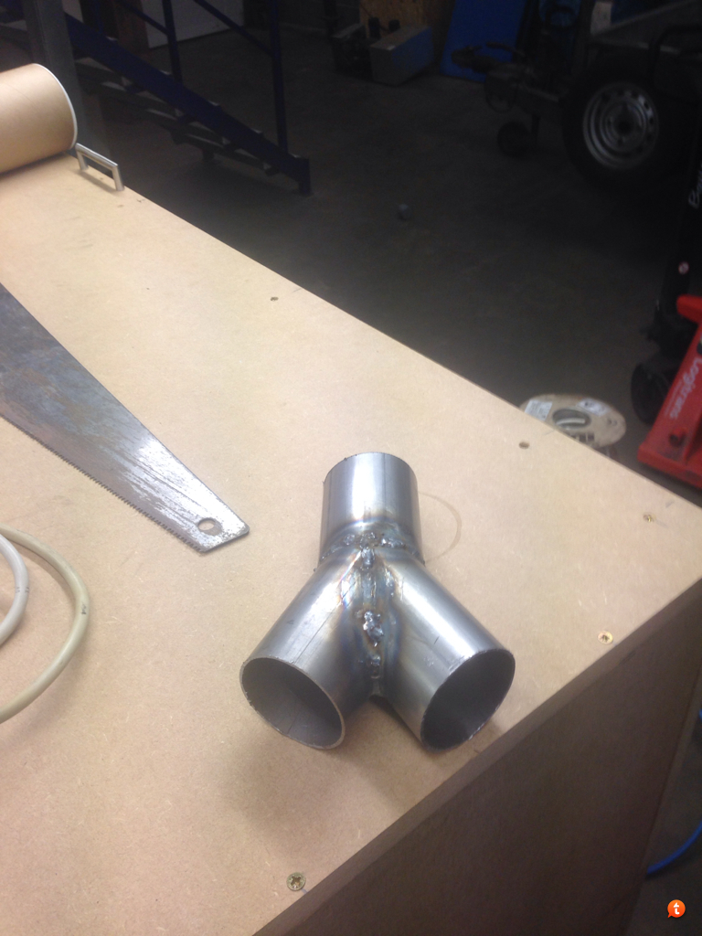

2-1 piece
Aaaaaaaaaarrrgghh!!
1 bit I'm waiting on to link it all up.....1 !
It's a central locking solenoid to operate the valve that'll go in the missing section

It shows! Especially in that pipework... I know how long it takes to make stuff like that
You'll make it in plenty of time... you'll have time to wash it before you go :p

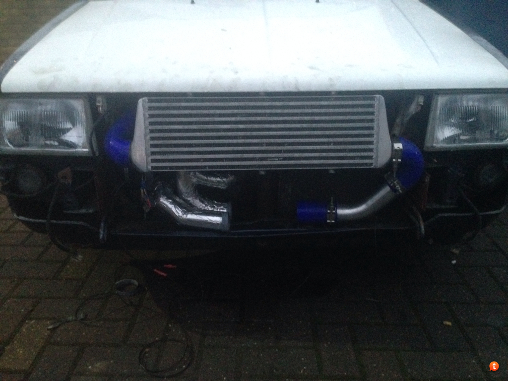

So thought I'd try the car jus with the supercharger.............no!
Thought the natural draw from the engine would be enough on idle to suck in whatever the small charger put out on idle, but no, so gunna have to put in (somwhere! ) that BMW mini bypass valve
