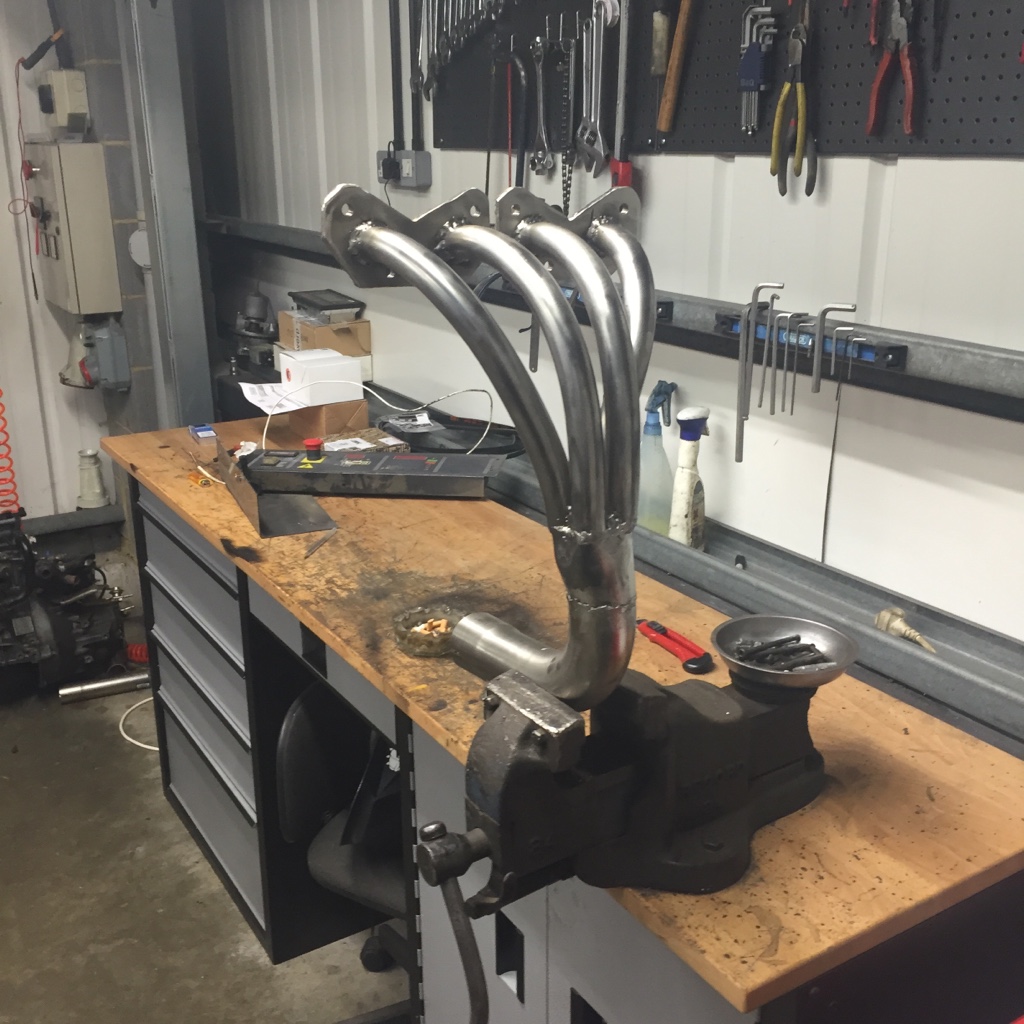

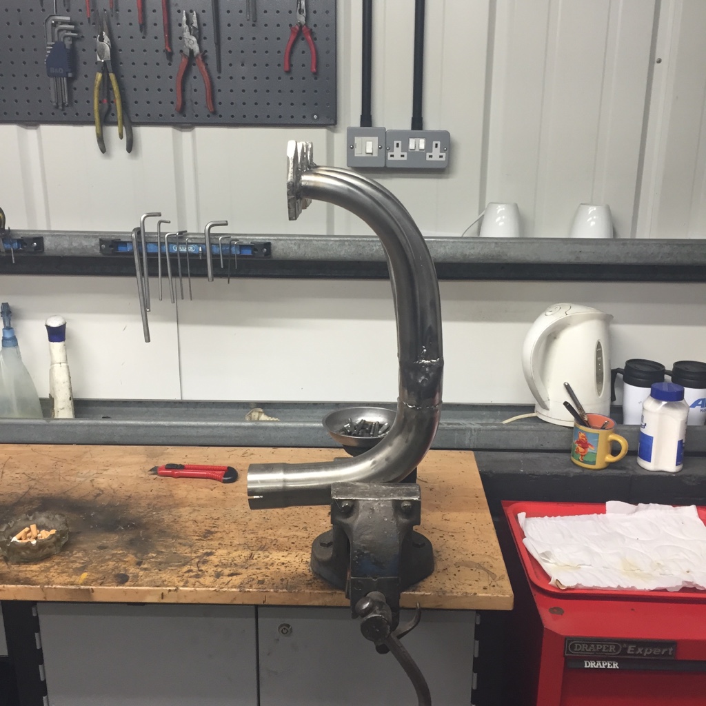

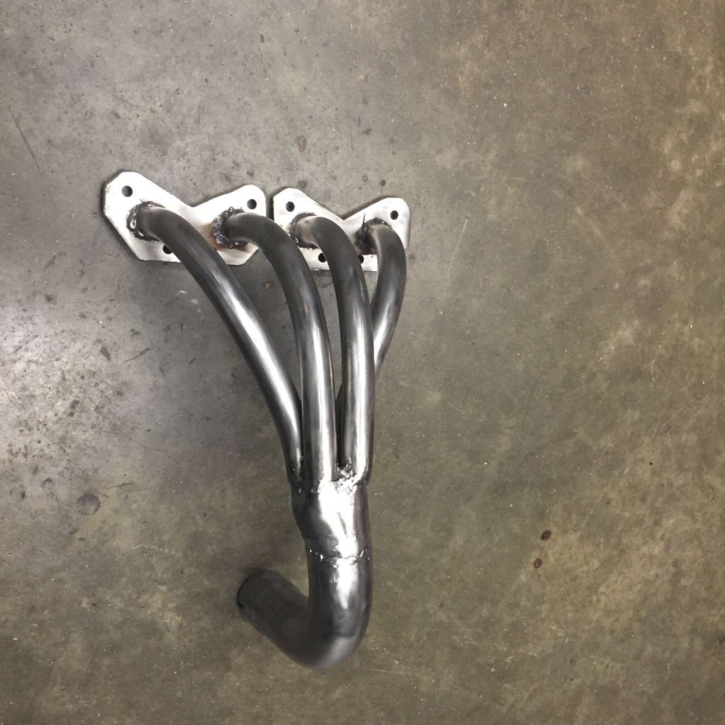

Turned this lot....
.....to this

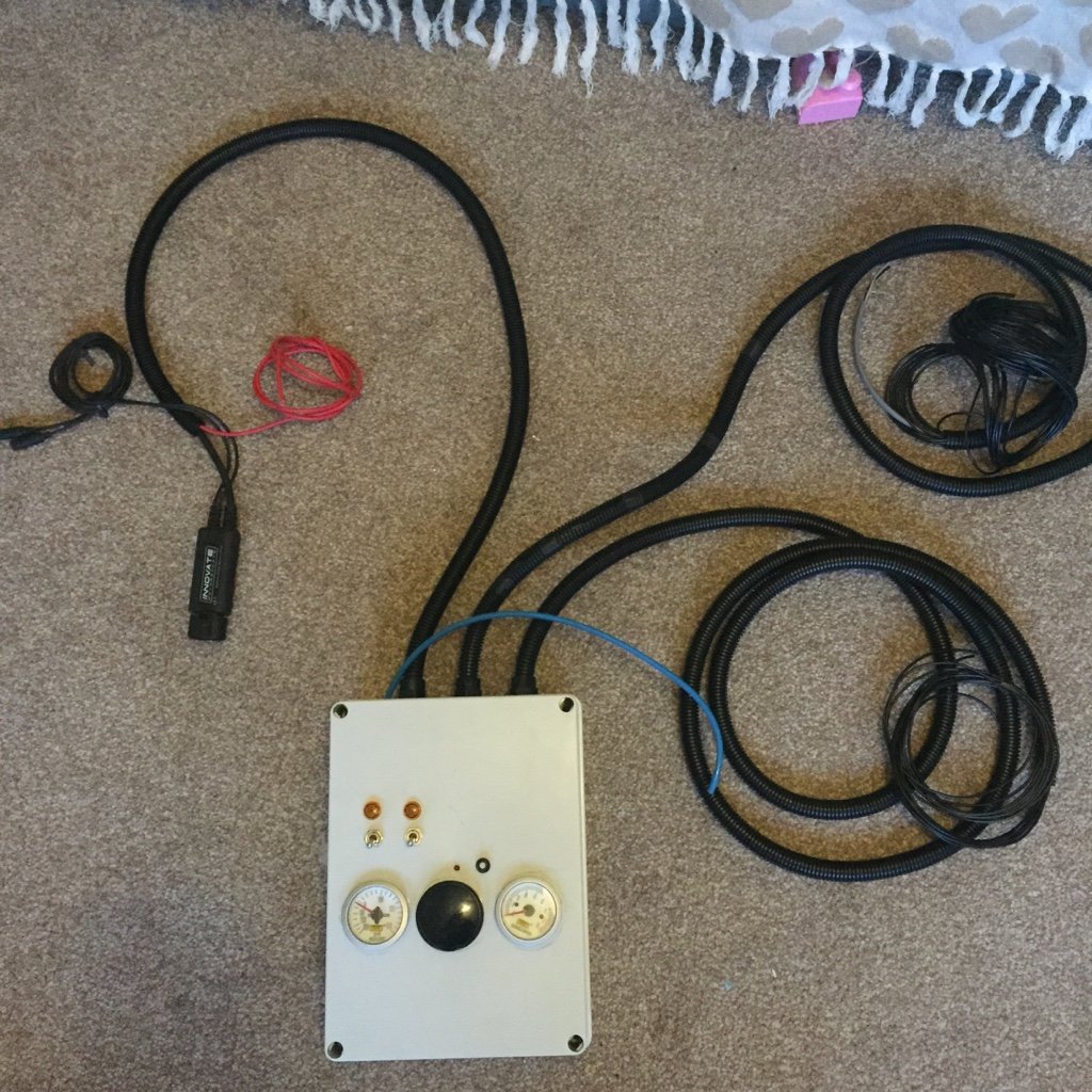

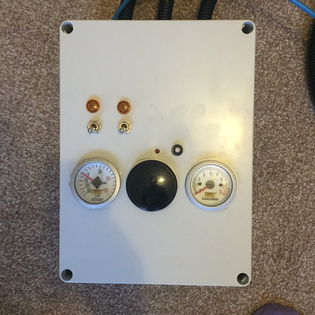

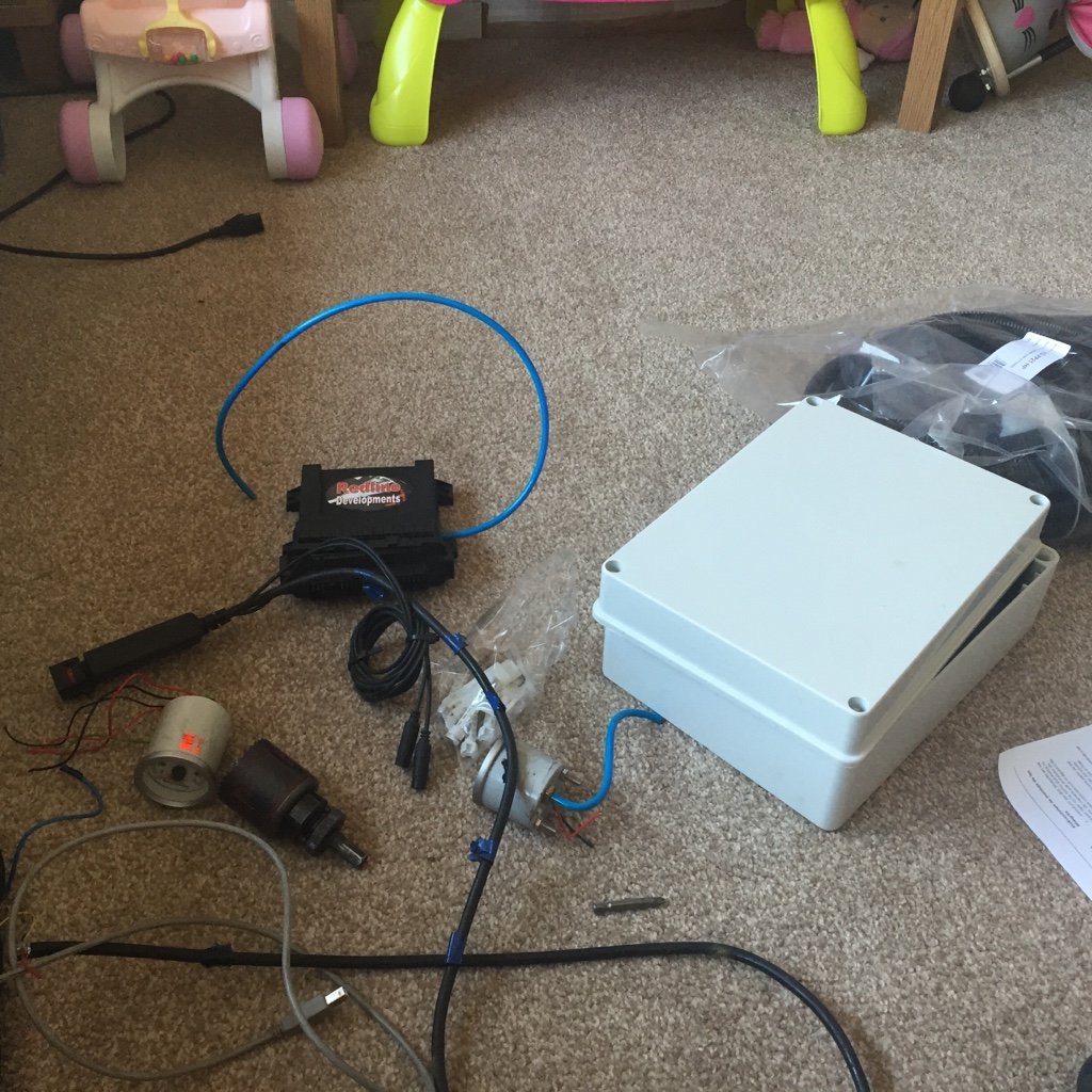

It'll sit under dash on floor just in front of gear lever
Idea was to have a plug and play box which
Holds ecu, widenband O2, relays and fuse holder, that I can transfer between cars, with out having to dismantle and rewire each time
I had a similar idea but not interchangeable and no gauges etc
What size box did you use Neil?
Every one I've seen seems too small
300x 200 from a electrical factors, £10
Got boost, tacho and AFR gauge, all it needs it 12v supply and its done
This way if I smack up the car, or it rusts out, just plug it into new one

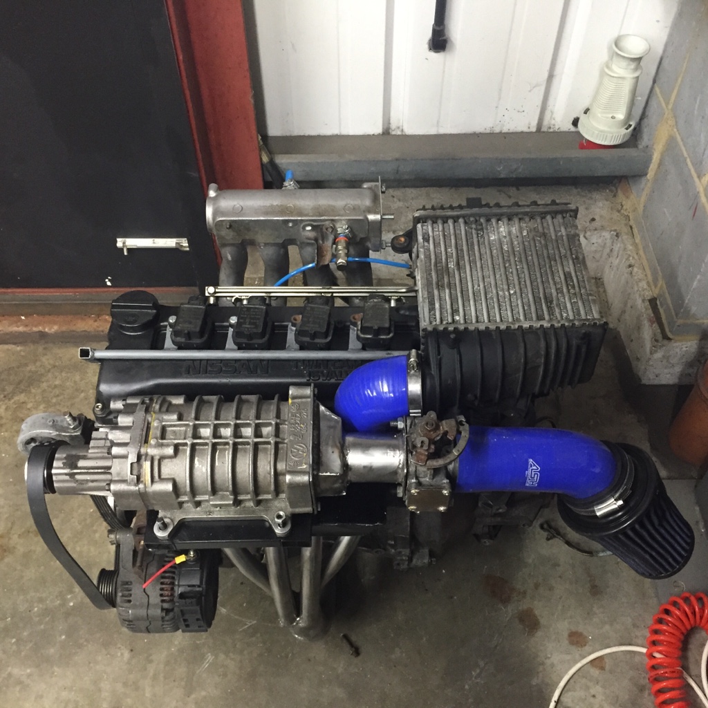

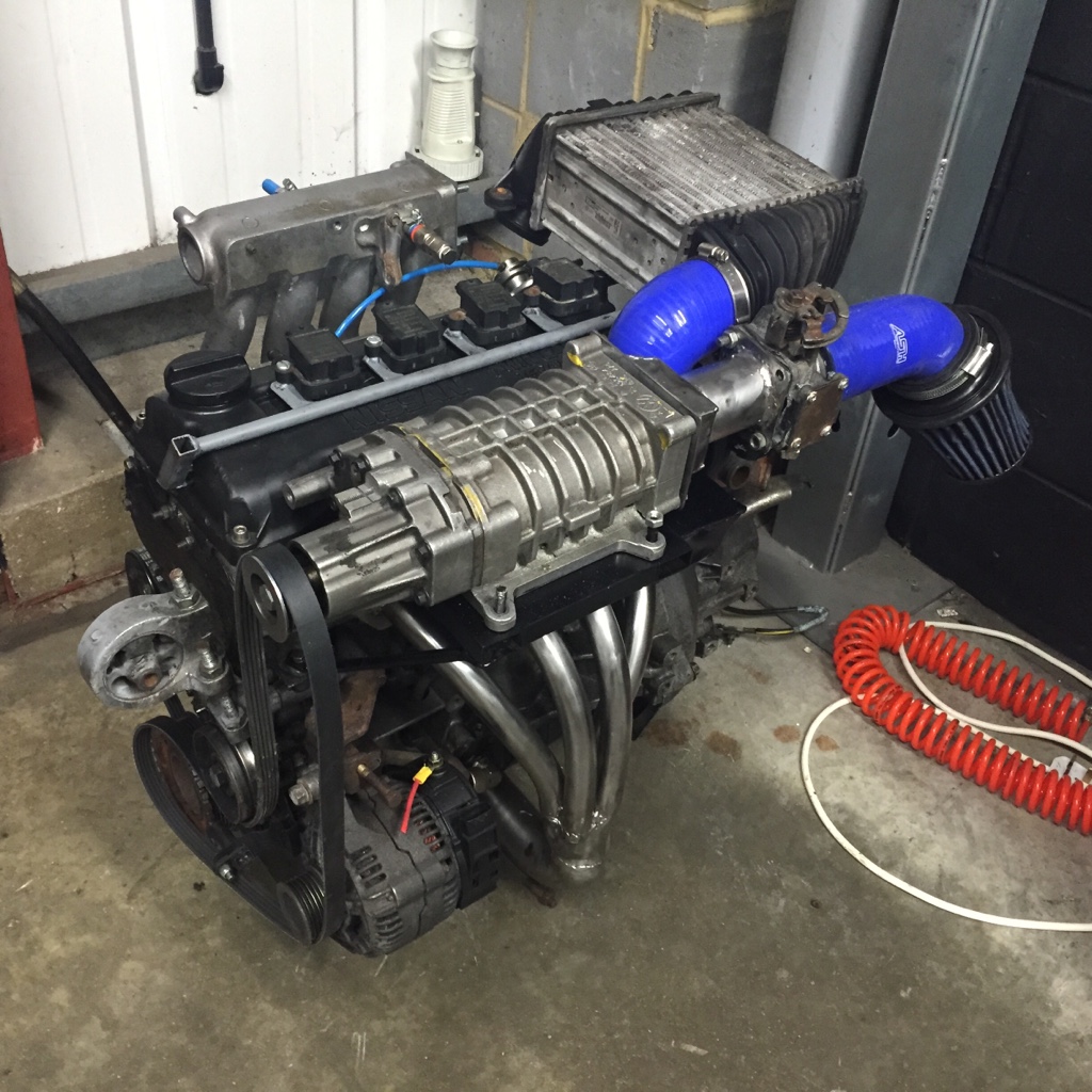

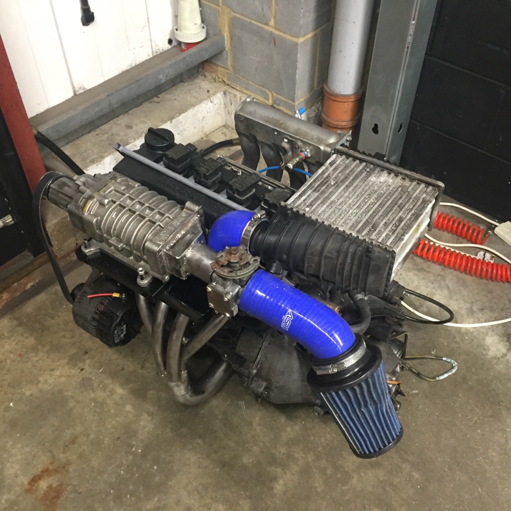

So without spending any new money and going through the pile of scrap parts I have,
This will be the engine sorted.....

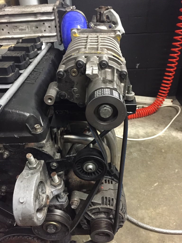

I'm having trouble coming up with a idea of how to make this black idler pulley into a sprung belt tensioner
Any suggestions
i would extend a sandwich plate under the s/c neil, and use that bracket you have as a stay
so, a slot facing you in the pic, close to the top pulley for max belt contact :)
