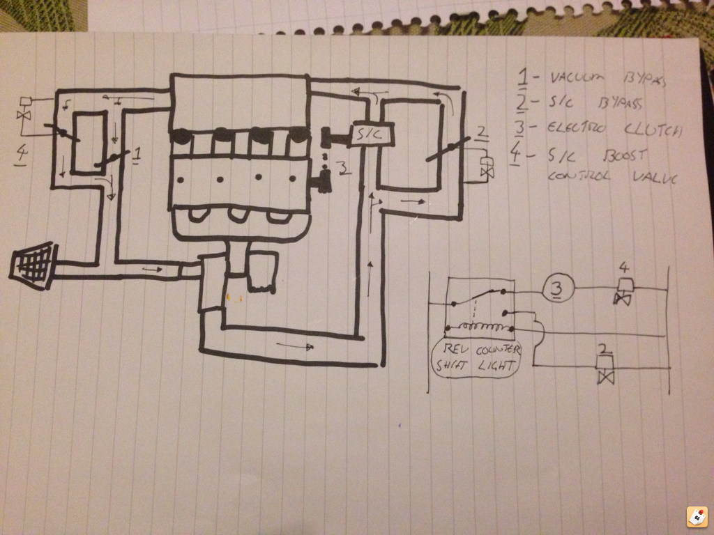

I've got a rev counter with adjustable shift light, so if I tap into that and set light to come on at 3.5k, that's what il use to control the electromagnetic clutch
Feel free to pick holes in the plan![]()
If you convert to megajolt or go full out and switch to efi then the ecu has several user defined outputs which can control pretty much anything
only problem with this is a pressure buildup in the compressor line bogging the turbo down and possibly restricting the exhaust, maybe a recirc valve would be needed to allow the compressor to freewheel until the sc cuts out?
worst comes to worst have a 1way valve tee off the compressor line back into the intake, and close when sc shuts off so not that big a deal.Theory side of stuff never sinks on with me, I only truly learn by doing

I doubt it as unless the valve after the turbo compressor was boost tight sc boost would just leak back through the turbo compressor...Does the s/c after the turbo have a Venturi affect and aid spooling?
not sure tbh mate, but i doubt if s/c,s are set to run continuously @ cruise etcWouldn't the vacuum operated bypass be enough for idle/off accelerator?

Leave it alone, get it running properly on turbo.

Nice one mate!there,s a lot of info here neil http://www.volkspage.net/technik/ssp/ssp/SSP_359.pdf clutch pedal sensor that engages the s/c clutch, and electronic diverter flap, 5:1 speed ratio, and low load n/a mode eh![]()
thats mainly for smooth transition neil, the turbo will boost depending on what throttle you have, but the s/c will cut on what rpm you have ehThe tsi has a boost control valve for the s /c, wood that be needed too ?
Turbo would be freewheeling while sc is engaged eh, as the sc will effectively choke the air supply to the turbo (being a fixed displacement pump), and the sc will give a fairly linear boost curve right until it disengages... Centrifugal clutch could work if you had it so it disengages at a certain speed (as we deliberately want the sc to come in at the lower revs) but then you don't have the option of using a switch on the throttle to disengage the sc depending on the throttle position (for fuel economy etc).you could cut the s/c via a boost pressure switch maybe ? for a smoother transition
and how about a centrifugal clutch neil ?
Ahh that makes sense, That works tooThe way I intend it to work is to jus regulate the boost pressure of the s/c, to 0.5 bar, jus like wastegte on turbo. Idle bypass still operated by vacuum
Once the turbo circuit is activated, solenoid to the s/c actuator is disengaged so no air can operate the actuator so it's fully closed , then turbo can boost to a higher pressure.....if that makes sense lol

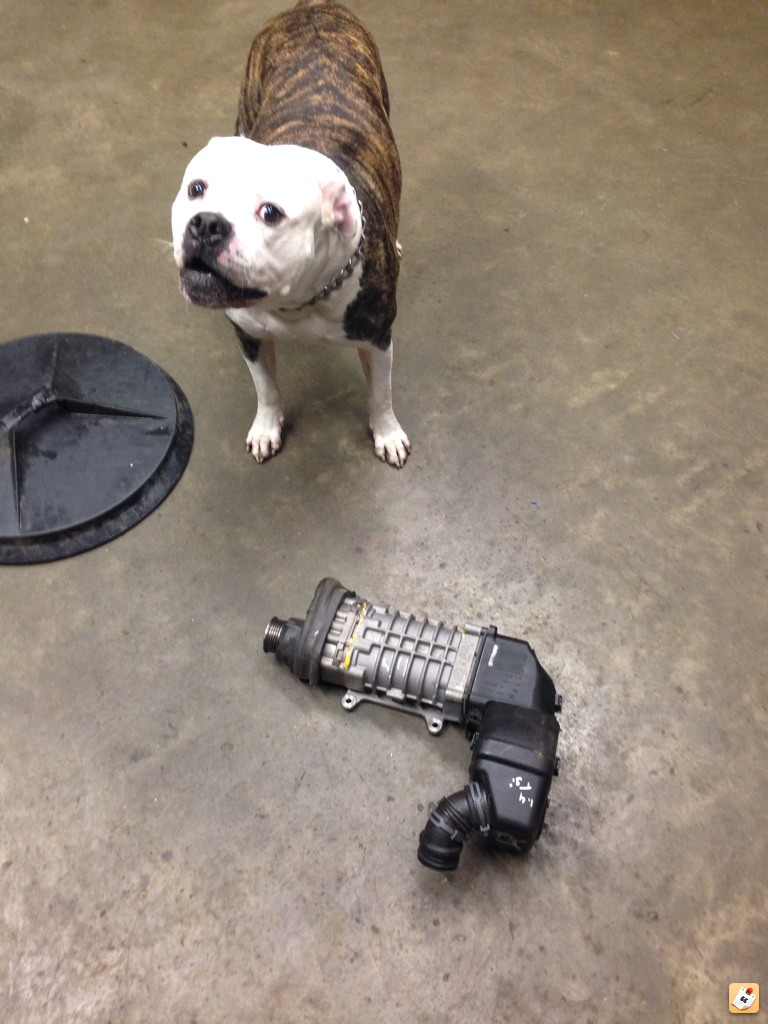

Got this today ....
