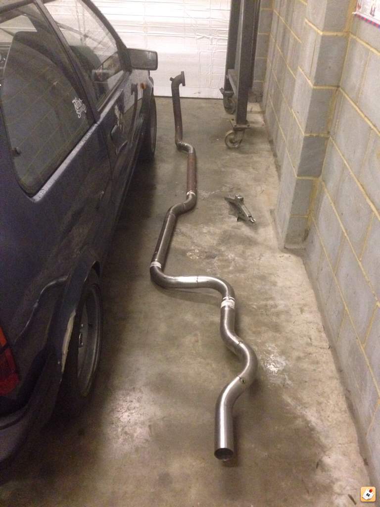

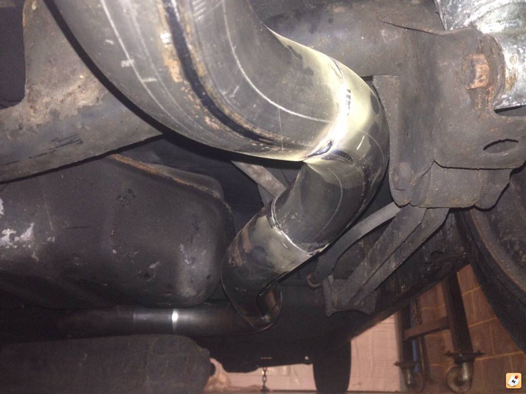

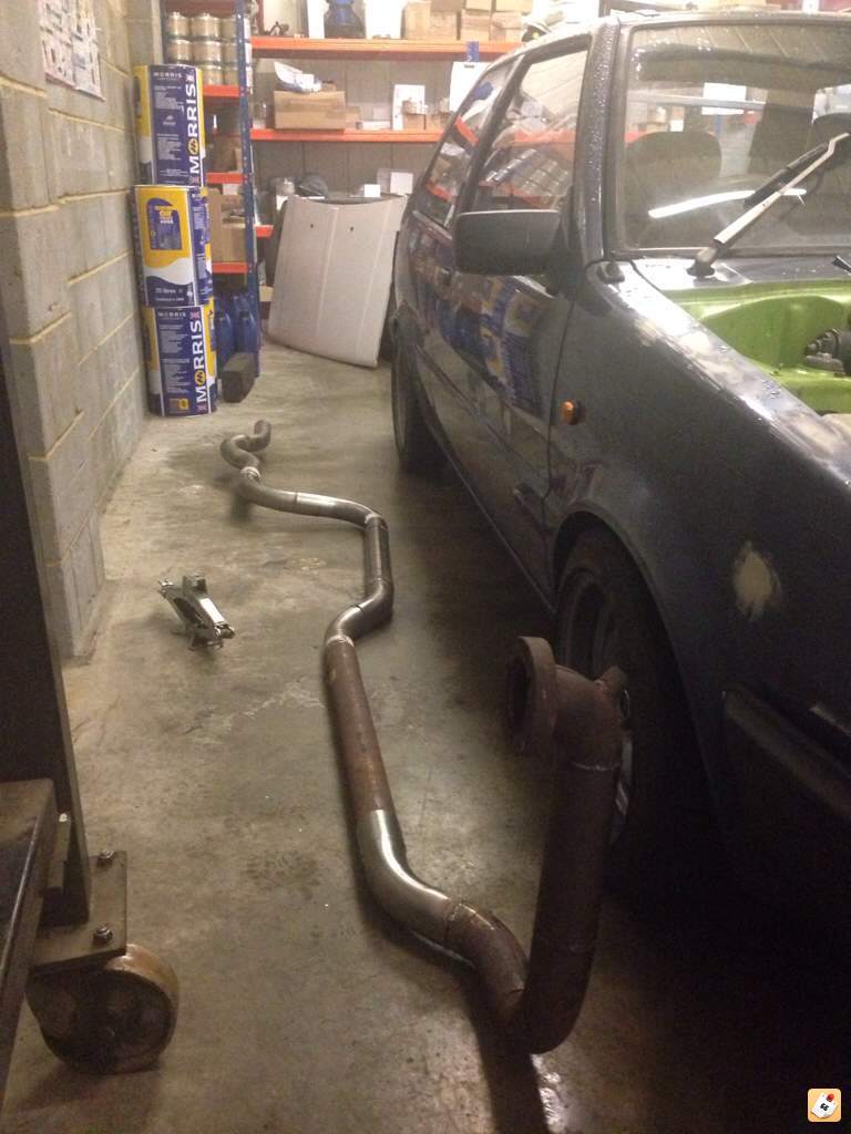

This was a right pain in the ass to do with no car lift or ramps!! But here s what I got up to tonigjt
Wiggly bit round gear linkage
Couple if bends round fuel tank

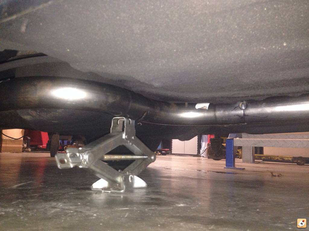

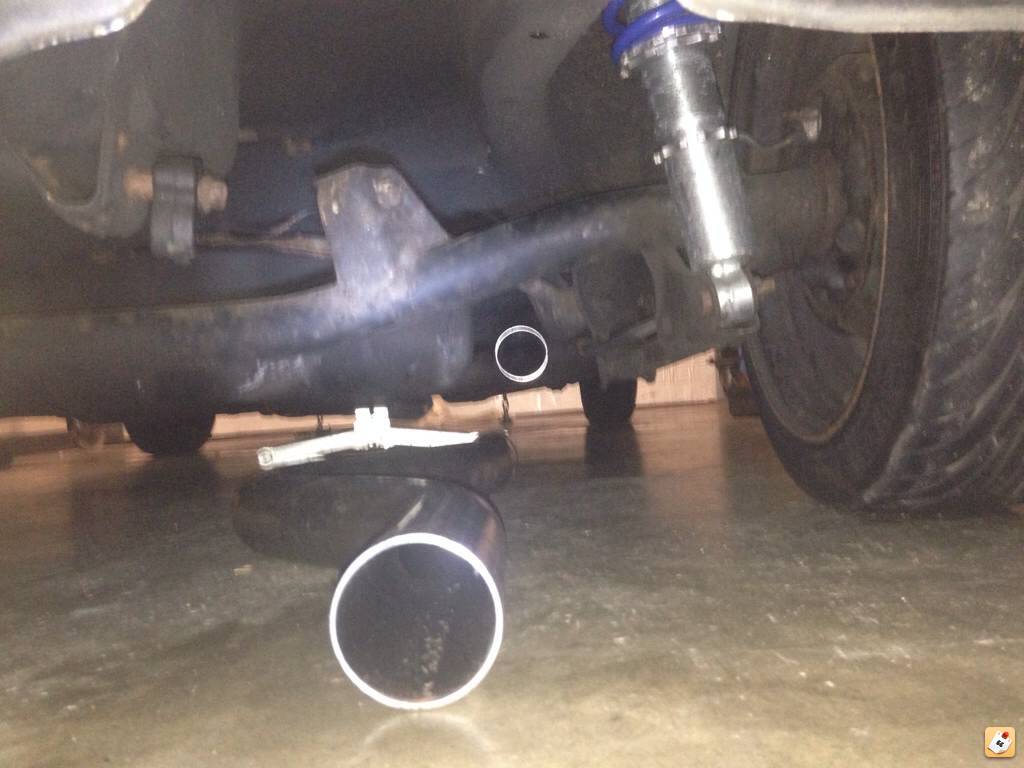

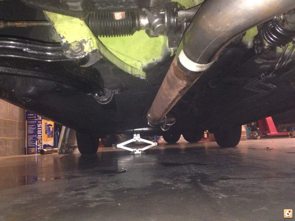

Cars to low to use the over axle tube lol
So trimmed it down and tucked it under the axle
Here's the tacked up exhaust as a whole, looks massive! Lol
Jus gotta weld it up, put some brackets on, then find a back box

That was more money, always add one later, but will be putting on a back box off some description,
in total it's cost £130 pp, so not to bad
Correct me if I'm being stupid (pretty bloody possible), but if it's under the axle won't the axle rest on the exhaust when the car is jacked up? What with suspension droop and all that?
I found when I run coilovers on a K10 the rear axle only droops by about 2 inches max.
Exhaust sounds sweeeeet. !!
So much quieter in the car, even with out any silencer or back box, tempted to jus leave as is lol

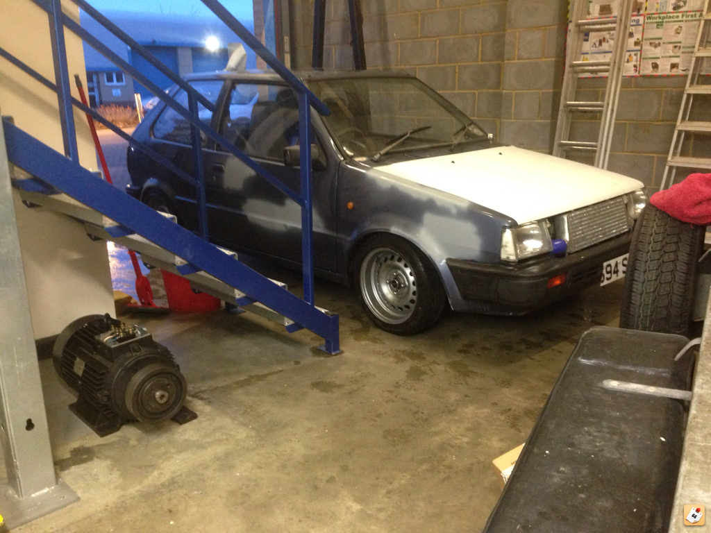

Been doing a bit if bodywork today, knock out a few of the dents, rust and stuff
Got a mate who's opening up a body shop soon, so gunna trade some work with him, il do him parts cheap, he paints the car lol
Same colour ,

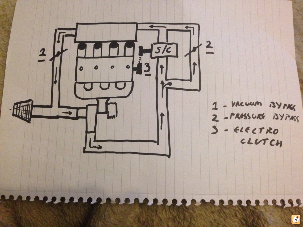

So after a couple of tins, I've come up with this for the twin charge set up
Turbo into s/c, at 3.5k s/c disengages, bypass opens and turbo takes over
Throttle closed, vacuum bypass valve opens releasing pressure into turbo inlet pipe. Idle control circuit too
I've got a rev counter with adjustable shift light, so if I tap into that and set light to come on at 3.5k, that's what il use to control the electromagnetic clutch
Feel free to pick holes in the plan ;)
You'll need the vacuum for the bypass taken from all 4 intake pipes behind the throttle body's of the carbs... but you probably have that already for your BOV no? (guess you're using the vacuum bypass as a recirculating BOV instead now)
I can't see anything wrong, that's pretty much how I would do it :)
You might have to do some Frankspeed style mods to tweak it for this but I'm planning on using that too. I like your idea with the shift light btw, that was exactly what I was gunna suggest haha :)

What size are your boost pipes gunna be, and do you have a check valve big enough to use on the turbo line? If not you could use a 1 way valve and have the shift light open that as well
I can get any size valve, jus the coils used to activate them might be an issue, most are 230v or 24v AC
You can get 12v dc ones, might be an older standard though as I've only seen it on the wheelabrator stuff at work
(our wheelabrator kit is all on its last legs and at least 14 years old)
Il browse the rs catalogue at work.
Jus wondering though, should the change over be purely rpm based?
I'd do a check valve, so the super charger pressure holds it closed until the turbo pressure is higher than the sc pressure, then you'll get a smoother transition if the turbo comes on boost just before the sc cuts out, but the 1way valve is just another option. Can never have too many backup options :)
Could look at that, but those things ate quite restrictive ...... Plus the double kick off power would be funny ;)
:O I just thought of a problem... as the turbo spools up the aor density will increase at the sc intake, so if your sc is working at a pressure ratio of 1.5 and you already have the turbo generating a pressure ratio of 1.2 say, you'd get 1.8 at the engine (0.8 bar boost)... maybe you should have seperate air feeds to the sc and turbo?
