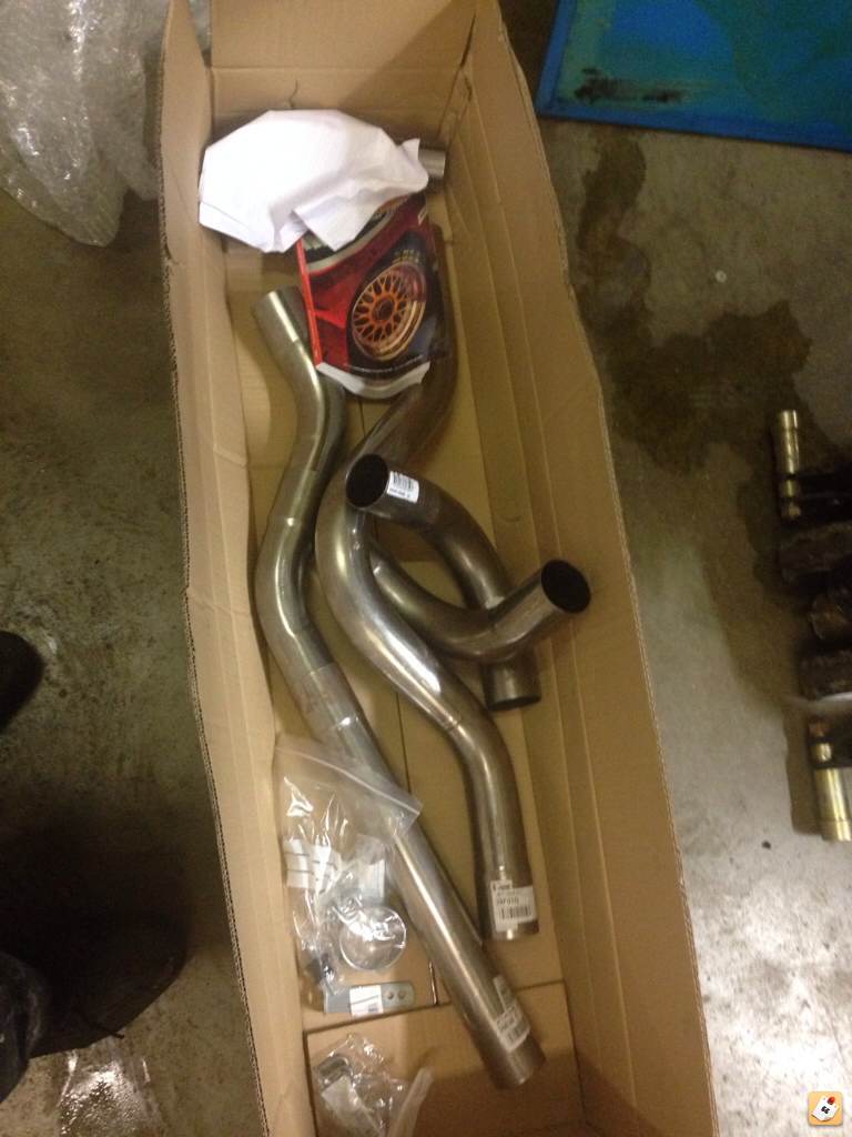

Hope I get my box of exhaust parts tomorow !
