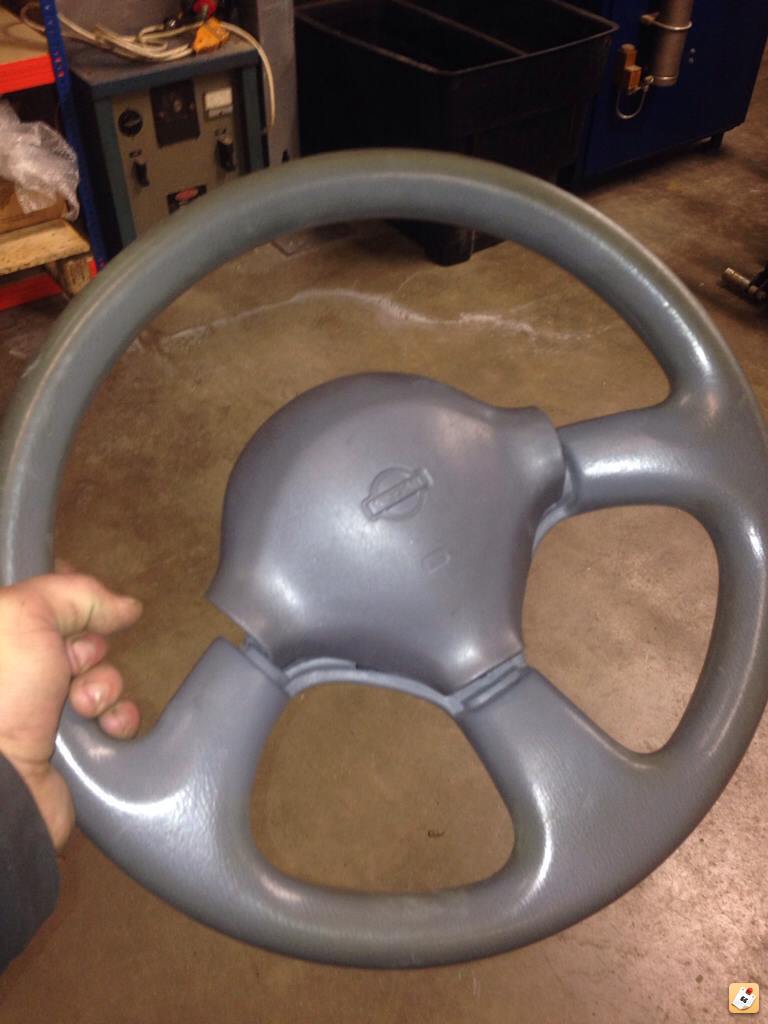

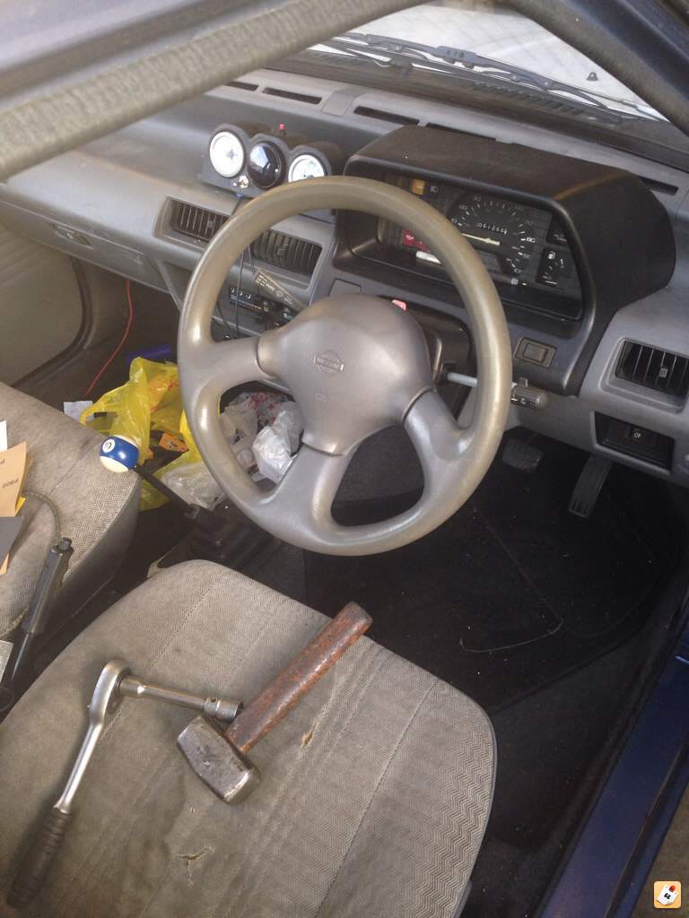

Horn should still work ok?
Wanna msg me your paypal or similar?
Pm me your address so I can get delivery arranged, then when i know the exact price to your door I'll give you my paypal :)
And I'd imagine horn would still work as long as K10's have the basic copper slip ring and brass contact on the steering column. Dunno about indicators self canceling though.
