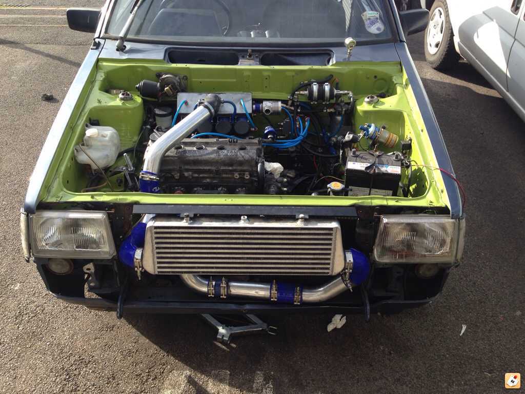

Trying to balance power, without blowing a lil 1litre up is hard haha![]()

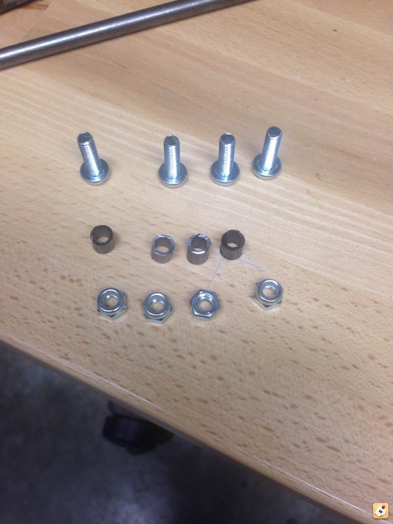

Rears, cut down bush to correct width of k10 mount, that is all that's needed
just done this with one , aint getting it to line up with where it shoould be , its touching off the back axle and at that its still not lining up with the hole it needs to go into , had you this problem or have you any suggestions? i know you said try at your own risk which i didhopefully i dont end up with a butchered coilover which wont fit
Sorry mate. Didn't see this, glad you fixed itnevermind , if i hadnt been so stupid i would have jacked the axle up to where it should be and they fit perfect !![]()

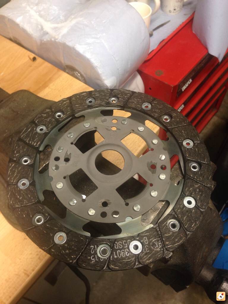

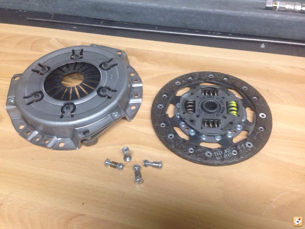

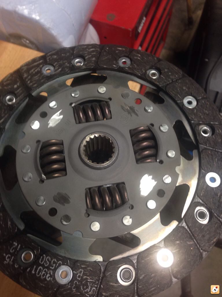

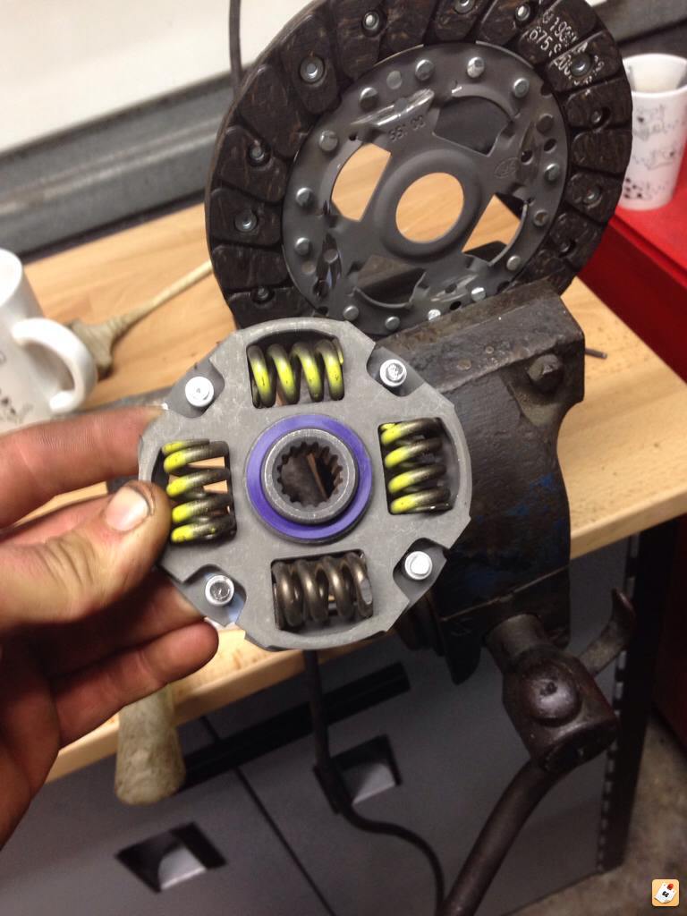

you have a short memory neilWtf is this clutch made from?! All I want to do is drill it out a smidge and I've gone thru 3 drill bits![]()
quote "bolts and nyloc,s ideally neil, i sharpened a 6mm masonry drill personally (that driveplate is spring steel eh )"
http://www.micra.org.uk/threads/clutch-advise-please.57956/#post-639692
Oh yeah haha!!
Tough old #### ain't it!!
