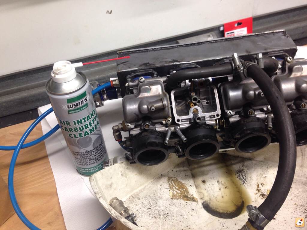

Jus whipped off carbs, cleaned everything, still no ignition, swapped leads and plugs over, no joy!!!
#### you car, it jus doesn't want to work anymore
It was all fine yesterday, running sweet, can't see why it ain't working now
