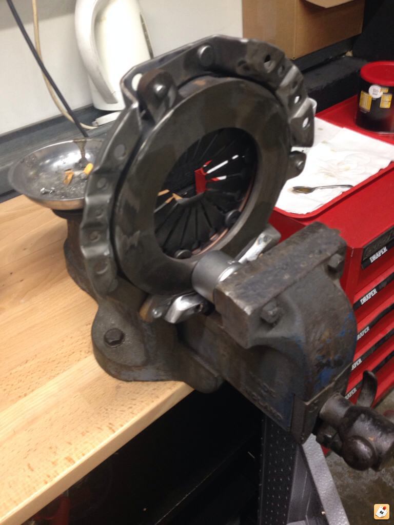

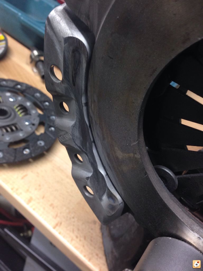

yes my (cheap ) carbide tipped masonry drill does cut through it like butterDiamond tip or carbide bits wil go through like butter, £££ however

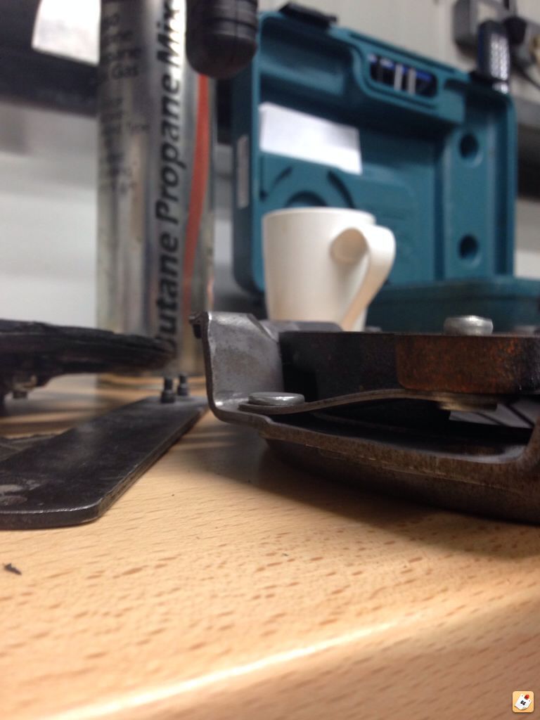

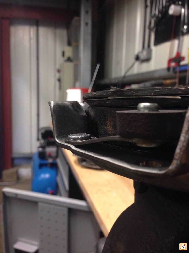

you might need to bevel it a bit more neil![]()
Yeah that's probably the problem lolThink that I don't have the front mount sorted won't help either
+1Nah front mount is pretty useless. Just stiffening the rear up will do![]()

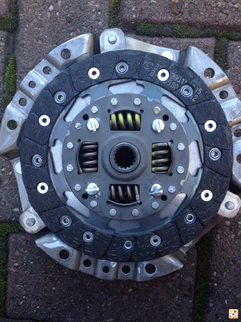

its being trapped when the bolts are tightened and diaphragm compressed the eh neil
fraid so mate, you need to compress the diaphragm to get the grinder in properly, and/or grind a full 45deg chamferDo I need more grinding?
