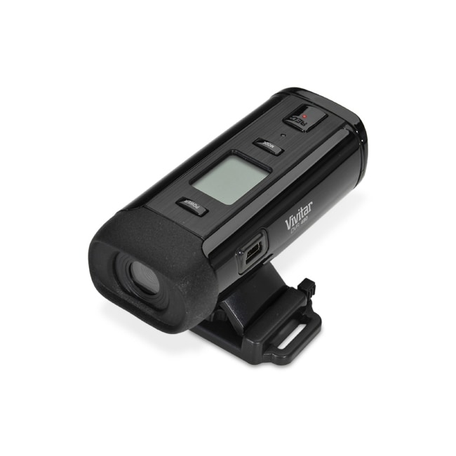

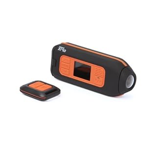

frank, what sorta cam was on ur helmet?
please dont buy that one... i have the same here... i needs very mutch energie you can better hold the 12/13v plug in... and on a 2gb mini sd it can only take 1 hour
