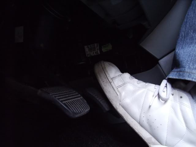

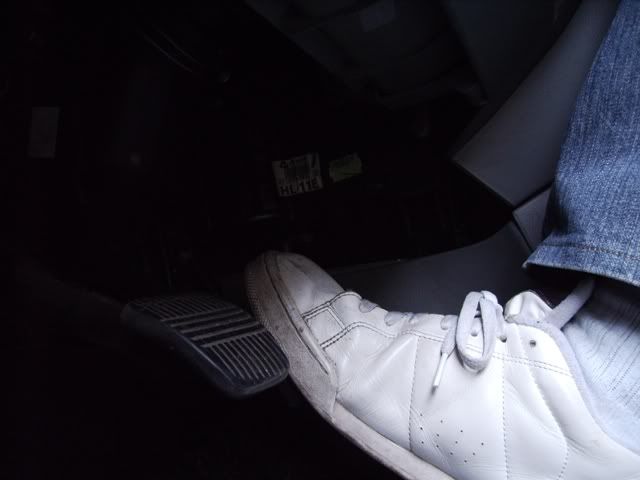

the cool brakes works quietly now this morning. although the pedal feels the same as the old brakes initially where ya need to press abit harder to get much braking, and at the biting point there's more sponginess as the brake lines, pads etc squeeze. obviously pressing harder beyond the biting point it stops harder now but just don't like this uncertain initial lack of biting. maybe need to upgrade the master cylinder?

does upgrading to primera master cylinder make it feel firmer hence need to push harder? although will prob resolve this long travel squishy feel by the increased flow per pedal stroke
maybe upgrading the brake booster could improve the biting feel?
during bedding i noticed i brake harder with me left foot than right, most likely due to this real heavy clutch, which may explain why i think the brake feels weak (cos my right feet is weak)
