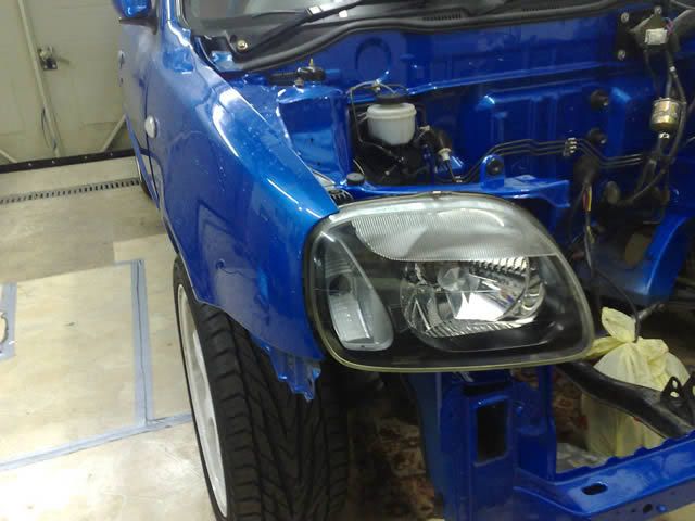

the facelift head lights are fully one part, one plastic surround for all of the light....doesnt that make the prefacelift the same? i thought the prefacelift was fully one part of plastic inside the headlight? lol
squarepants: whent removed the glass from the headlight, a part of plastic came with it....which was the bit inside i sprayed black which wrapped around the bottom of the main beam housing! its complicated!!
however...you tinted yours so you should know what im on about lol!!!??
prefacelift and facelift both have "two plastic bits" inside the headlight!
prefacelift being:
1. headlight + sidelight (joined)
2. indicator (seperate)
facelift being:
1. headlight (seperate)
2. sidelight + indicator (joined)
naps
in the facelift head lights theres only one bit of plastic (that surrounds all the light) it covers the side light, indicator and most of the light area if you get me?
i.e (below on ians and richs old car's) all the black painted part is all one bit of plastic! lol if that makes better sense.

Ivan, i saw James k11 with his new tinted headlights and you guys did an awesome job!!! they look very........INTENSE!!!! transform the car!!!
are you running "Eagle F1 tyres"???? if dont mind me asking?
Not tinted, sprayed matt black. The tyres are the best non-cut-slick tyres money can buy. Uniroyal RS1's. RS stands for Rainsport. I have them on my modded Almera GTI running about 150ish bhp and it does not spin on anything but the harshest of starts in the dry and are also awesome in the wet.

do the tinted headlights fail mot napster?
i feel the term "tinted" is the wrong word! they are not tinted.....the inside is sprayed black! i have not covered the glass!!!
the reflectiveness within the indicators housing block may be less.......i honestly dont know for sure Joel! plus some MOT stations may miss it, other may pick it up!
yearh i just say that ''the inside of my head lights are painted black'' i carnt really say that they will pass the MOT as i dont know until next month! it should be diffrent for yours tho (i think) as the facelift headlight inside plastic covers, cover the sidelights....so may fail on side lights not beening reflective engough, but then agian they work fine when they are on, so may pass as far as iam aware! lol the only thing it will fail on is the front cross member! (the old micra that is, as my new one has had a new cross member not long back (kristians old one of the wide arch..lol yellow overspray, also got his old shocks and springs with added yellow overspary :p))

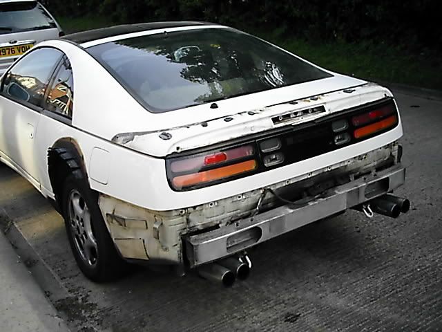

###### mate. Thought you'd already chopped your steel arches. Nearly all cars have to be done when going wide. The 200 and 300 boys deffo do as I've seen a few done.
Ivan
the cutting of the arches is actualy quite easy, its quite heart redering lol, you get templates for the cut out's, what you have to do is cut the outer arch away(using the templates ), but leaving the inner arch in place, then you have to cut up the inner arch to where you have cut the outer arch off, then fold the inner arch out and weld it to the outer arch for strength, you will see what i mean in the first pic of my thread, the bits that stick out of my arches is actually the inner arch bent out
fully underseal the cuts and the weld
actually fitting the arches is not too bad if you know what to cut off to make them fit, unfortunately i didnt take any pics as to what to cut off, it only took me, my dad and peter from pps about a day in all to cut the arches and fit the kit, (when say day i mean about 12 hours)
there is a lot of fibre glass that you have to cut away from the arch kit to make them fit, but once that is sorted, its a matter of linging them up prefitting them with self tappers and fitting the rest of the kit to see if it fits before gluing (use fibrol) to the car
Copied from the 300zx club forum.
Ivan
Ah, I think I get it, separate it at the bottom seam, cut the outer (painted) part of the arch away to get teh shape, then fold the inner arch upwards and outwards - is that why there are 'tabs' in the inner arch as there isn't enough material to fold out fully?
