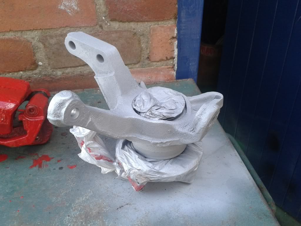

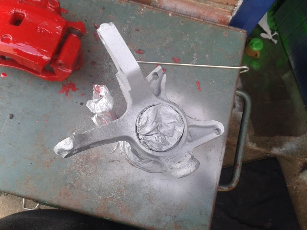

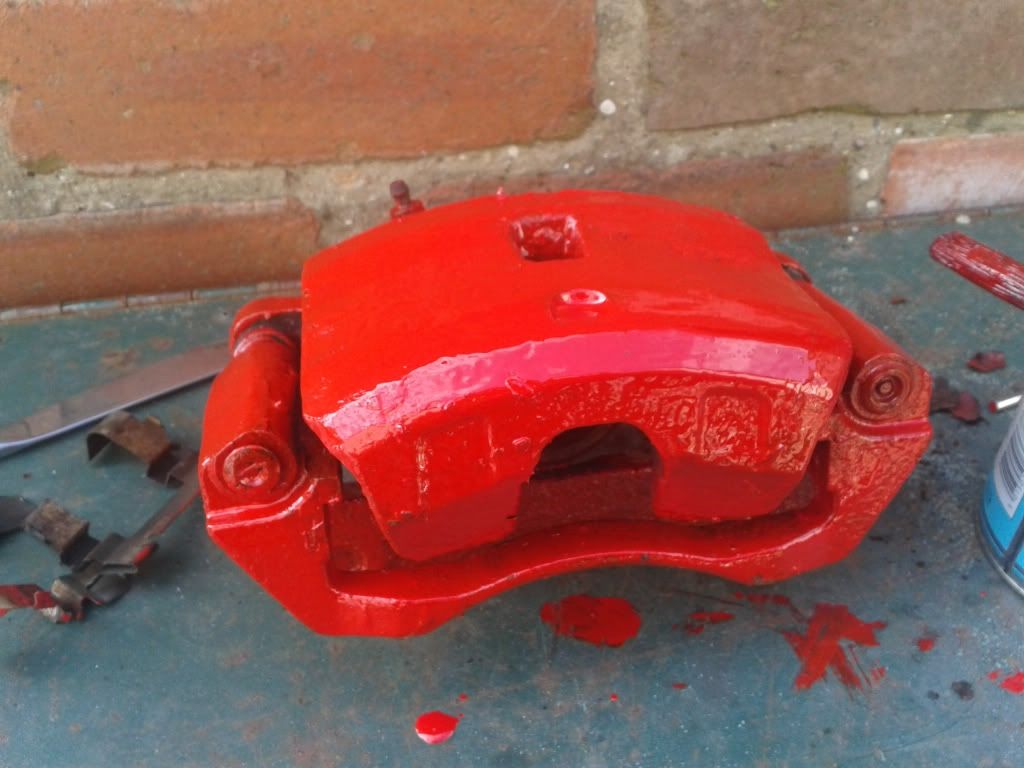

They're not finished but here's pictures of gtir brakes :)

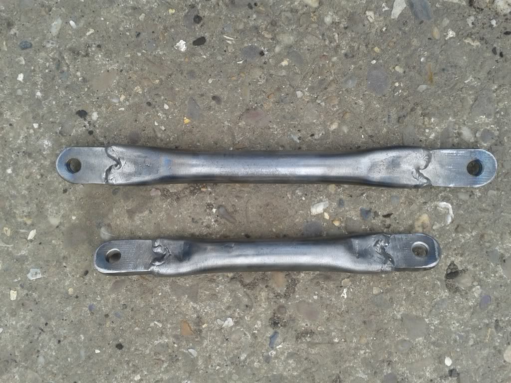

Now here's something I forgot. Something custom made for me by our Ed
They're tie bars for my engine subframe. So I need to get them on. But as I'm going to be popping the engine out at some point soon. I'll leave it til its back in :)

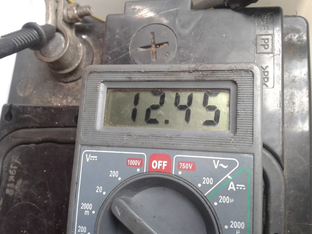

So I set about this morning testing my wiring and my set up
Battery came out @: 12.45v which isn't bad considering it hardly ever gets used
Then I tested the cca of my starter which came out at a measly 59/60amps. Starter turns over like the battery is almost flat. Which I assumed it was so thought nothing more
No picture here its hard enough holding the two multimeter prongs
Traced all wires and the starter isn't getting the full 12.45v from the battery.
I changed some terminals over tightened some connection and cleaned up others.
Tested the starter this time and a full 12.45v at the starter.
Engine start button pressed pop went the fuse.
Now defused my battery wire and it cranks over sweet...
I guess we call that problem solved ;)

Spot on mate, poor connection at a terminal or plug at those amps is a fire hazard eh :) glad it's better. Also still good to know it'll crank over on 60 amps, engine must run like a sewing machine :)
Exactly that which is my worst fear. So I'm glad ive caught it and secured it :)

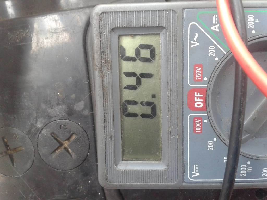

Oops... battery voltage a tad low
Yes ok I left it on overnight with the sidelights on
Deapite having a killswitch, mains switch and a battery live indicator
Fail

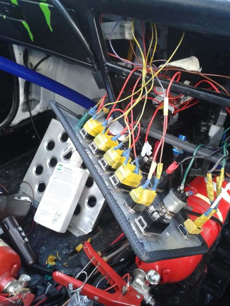

Whats this battery live indicator?
Its a light that comes on to say the battery is live. It is meant linked to a volt meter (I broke the screen so a new one required) also plugs into the door switch aswel, the buzzer that normally goes off if you leave your lights on, now goes off if I leave the kill switch active

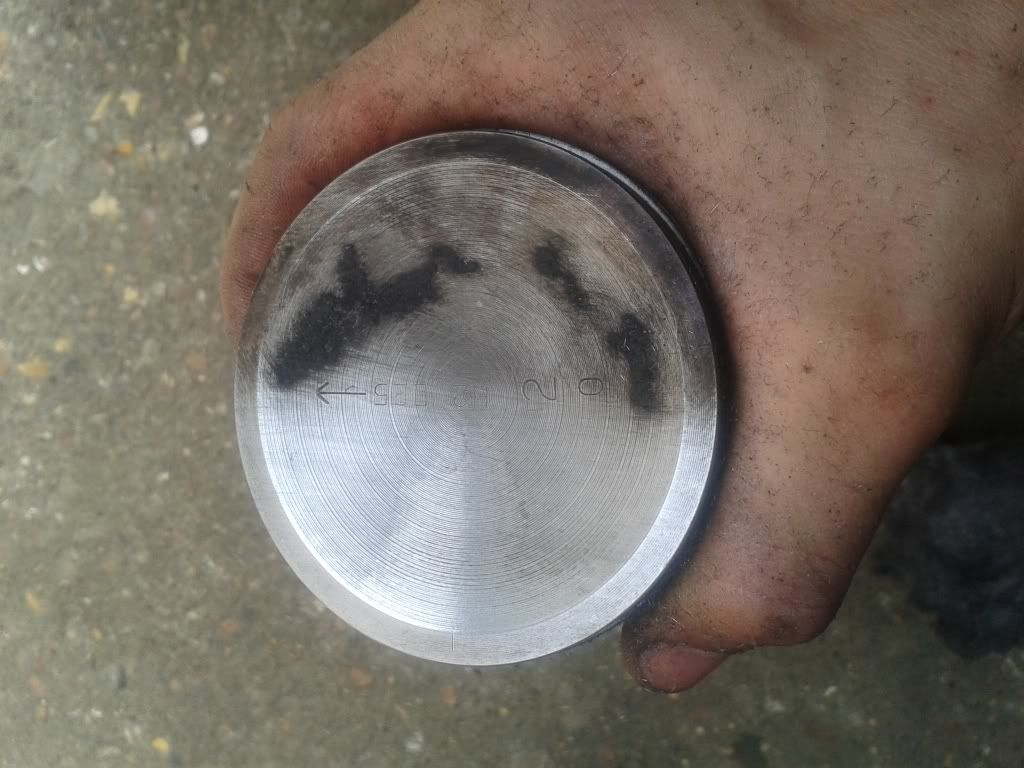

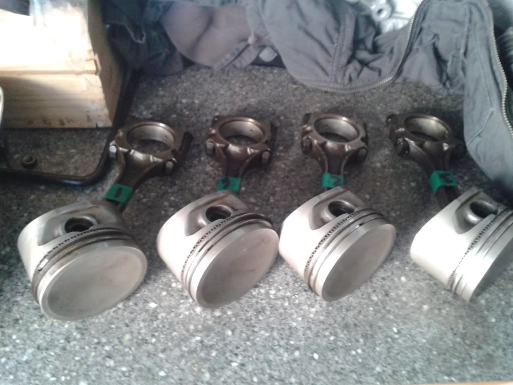

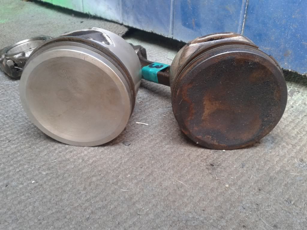

Gave my internals a bit of a cleanup.. well my other ga16
Midway
Before and after
A nice shiny set
With them fairly clean I'll get the rods off to be shot peened. Will order another set of ARP rod bolts to go on these too
£150 spent and this ga16 is turbo ready :)
