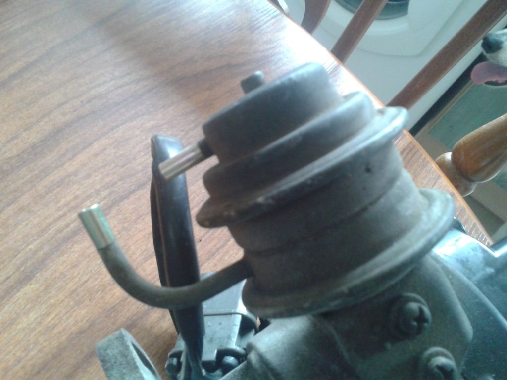

So I could take this magnetic setup out and use points? Except ive no vac advance
Vac advance is only really to give a more stable idle, I blocked off my vac advance on the lucas dizzy in my spit as it was messing up the timing, could set the springs and bobbin weights more accurately without it
oh and yes you can use it, just mod the trigger wheel and sensor to fit.

If one is rpm you need a unit with a map, as the rpm signal will be to advance/retard ignition where in older dizzys it would be done by a bobbin weights on springs flying out at speed and moving the points operating cam around.

I've two dizzys the ds dizzy has weights and vac advance. This de dizzy has none. Just this sensor and it doesn't move either... so needs a map

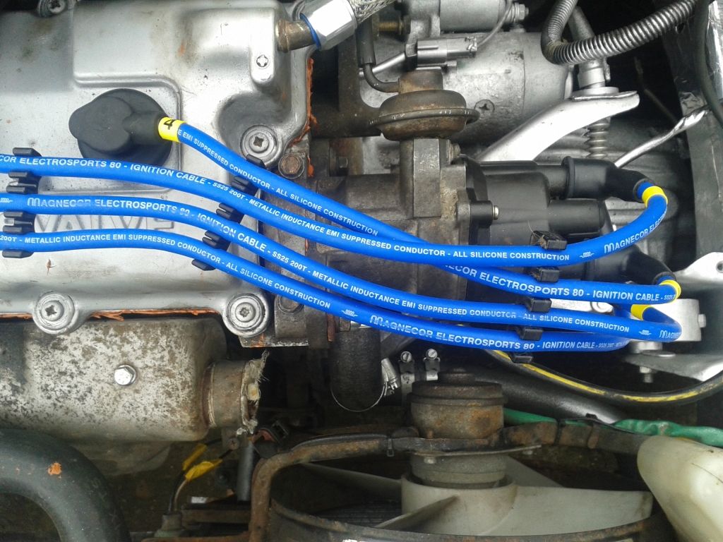

Well I got it 2.. magnecor leads.. but they didnt have them in so posting them to me
Call it a paperweight because it still won't start. Still without a functioning distributor

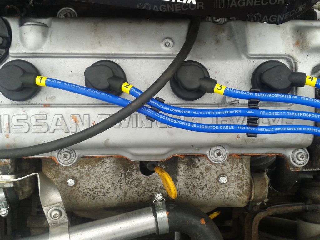

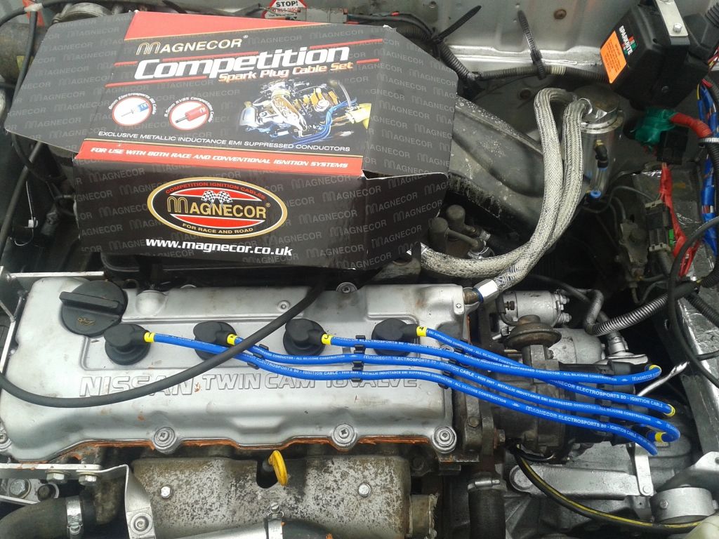

So these finally arrived 2 weeks later
Simple fit so I popped out and plonked them on the car that wont spark :p
They don't include a king lead in the set which is a bit of a joke really but ah well I'll get one sorted.. oe one for now
Even included a free sticker

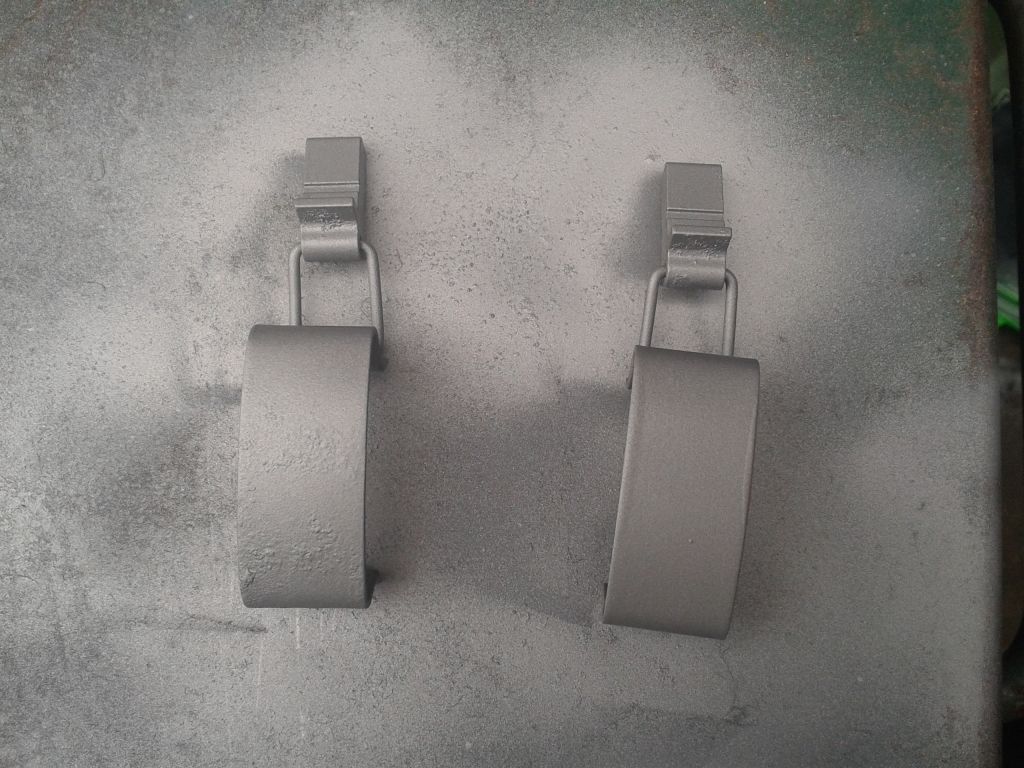

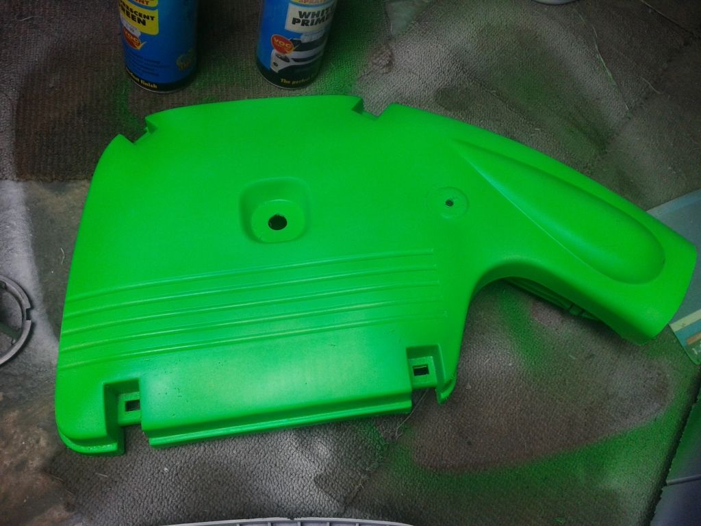

So I started prepping my car for jae.

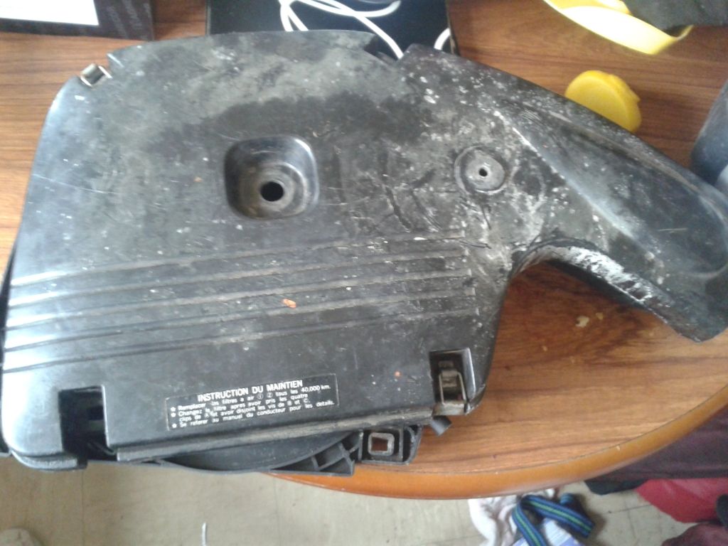

First I sprayed the oe airbox.
Here it is:
Cleaned, sanded and sprayed
Plus the catches

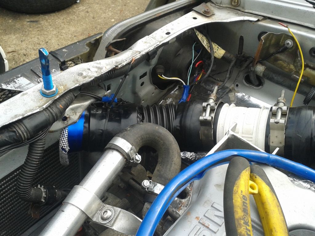

Waited for it to dry so had a rummage in my many boxes of spares and mocked an inlet for it
Before you ask yes it is a trd track use sticker off my old celica
Feel free to mock my insulation tape joints :) made it useable just incase I take it out for a drive and forget.
Gonna get it made out of alloy pipework and make so slots in the bonnet where I can to cool it :)

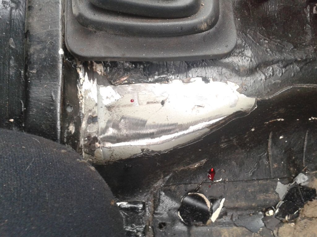

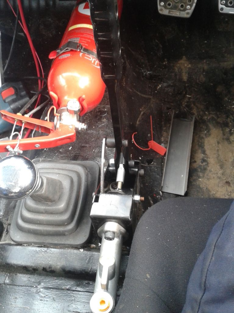

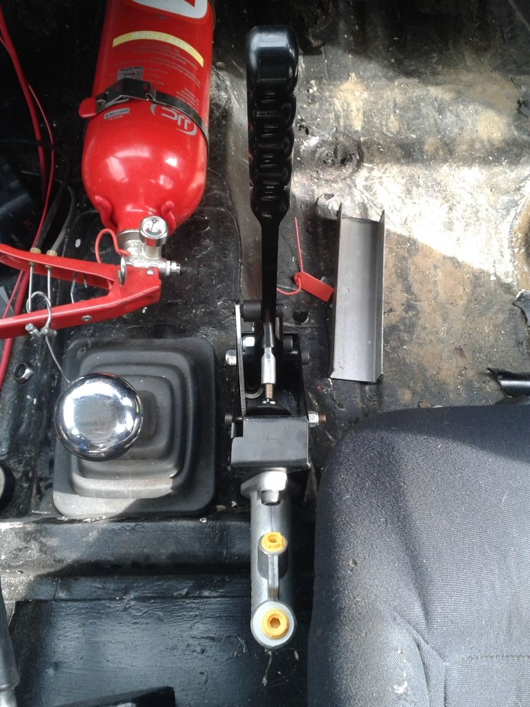

Made myself something today. Missed a few pictures out. So you've got the start and end :p
Started here
Cleaned my tunnel up and moulded my metal :) the red spots are the result of my finger meeting a sharp edge
Finished product... already... just like that :D ignore my welding I've still got no gas :p

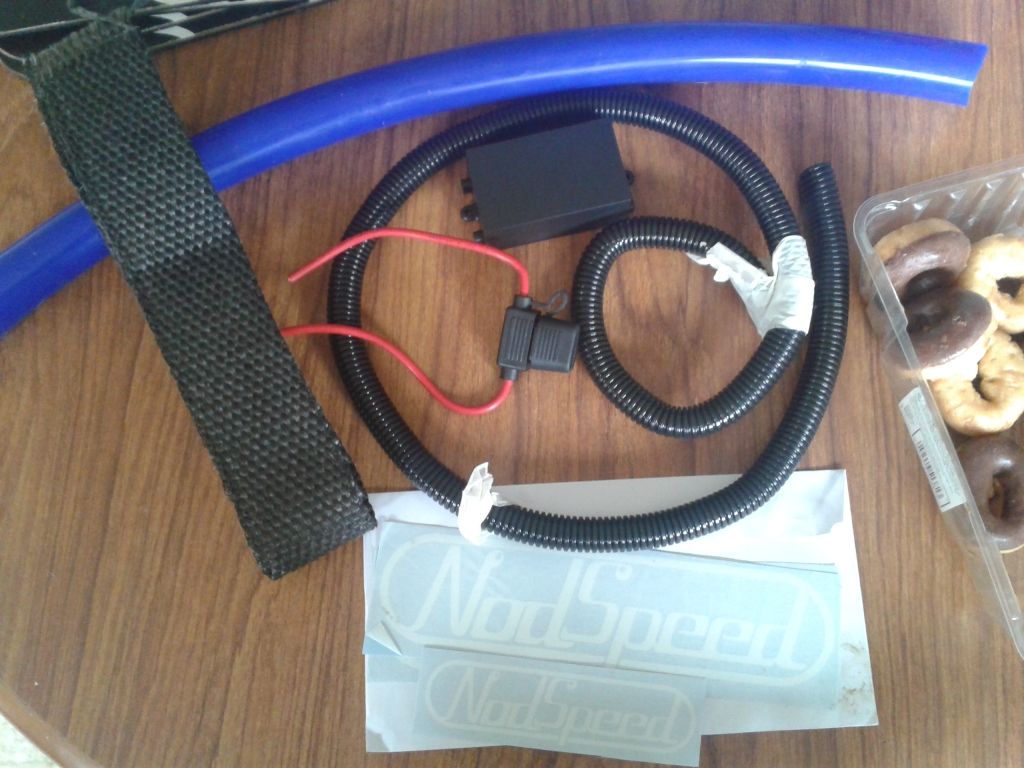

Got some other little bits and bobs for it too :)
Some pipe for my internal washer bottle... saves cramping myself under the dash with a jug of water
Some exhaust wrap for the turbo elbow.
New inline fuse as I've mpved my battery.
Some cable conduit for waterproofing my electrics and a box to house my spotlight relays.
All the little bits matter :)
And some NODSPEED STICKERS !!!! :D
