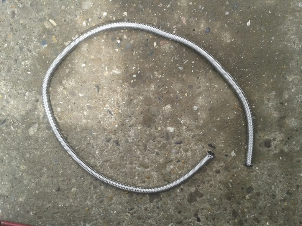

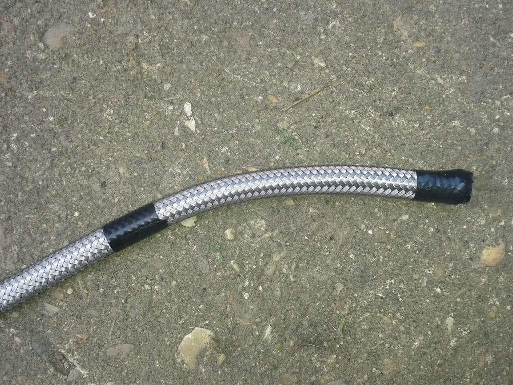

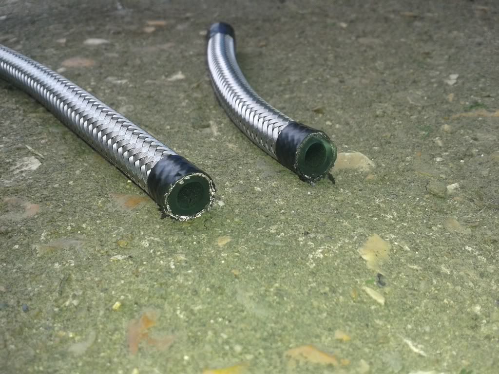

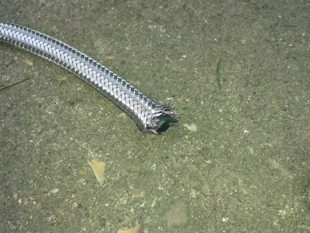

First up braided fuel hose which arrived this morning
If you just cut it as it is you end up with this
This is how I was supplied it which is pretty poor
Anyway... this is how its done. Work out what length you want and wrap some pvc insulation tape around it. Making sure the the centre of the tape is your mark
Then cut down the middle :)
Leaves you with a proper finish to the hose.

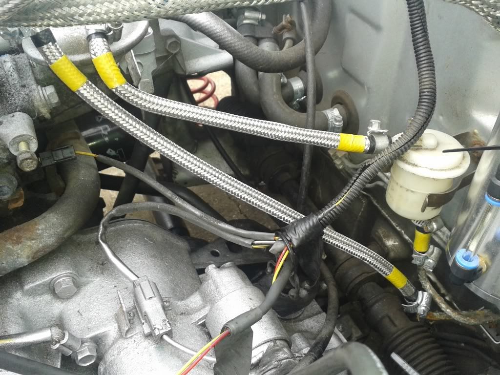

My pipes looked like this
And finished up like this. They look super tight but there not :)

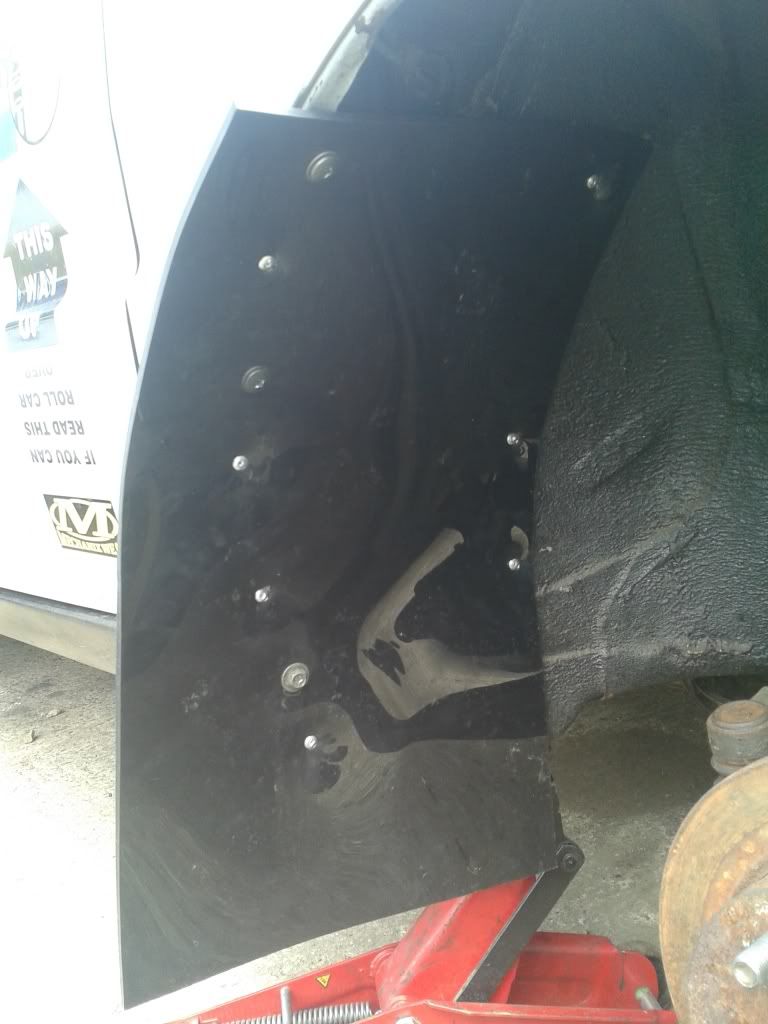

Update 2/3: Next up mudflaps, shocks, my washer bottle and boot springs .

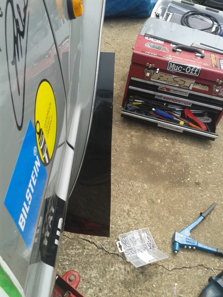

First mudflaps. Nice and easy except there are regulations for mine. 40mm poking out from the tyre edge and no more than 80mm from the floor. Believe me when I say lining these up is no fun
Use the orignal mudflap mounts and then pop rivet it to keep it extra secure

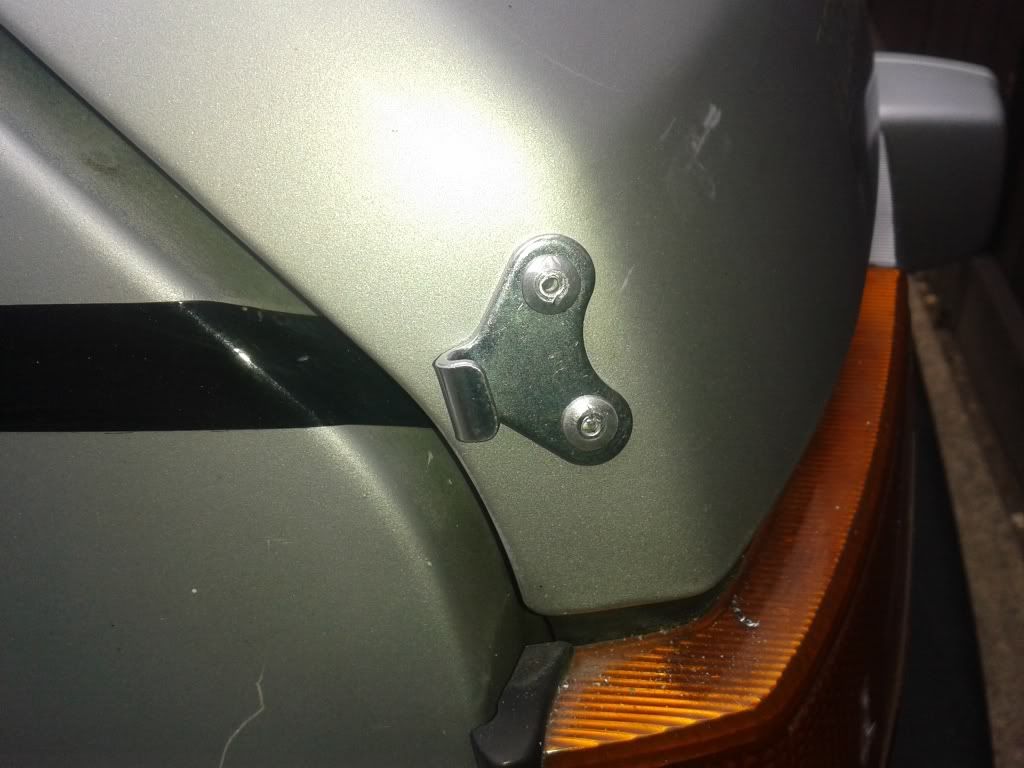

Next boot springs. Nice and easy
Part 1 drill and pop rivet

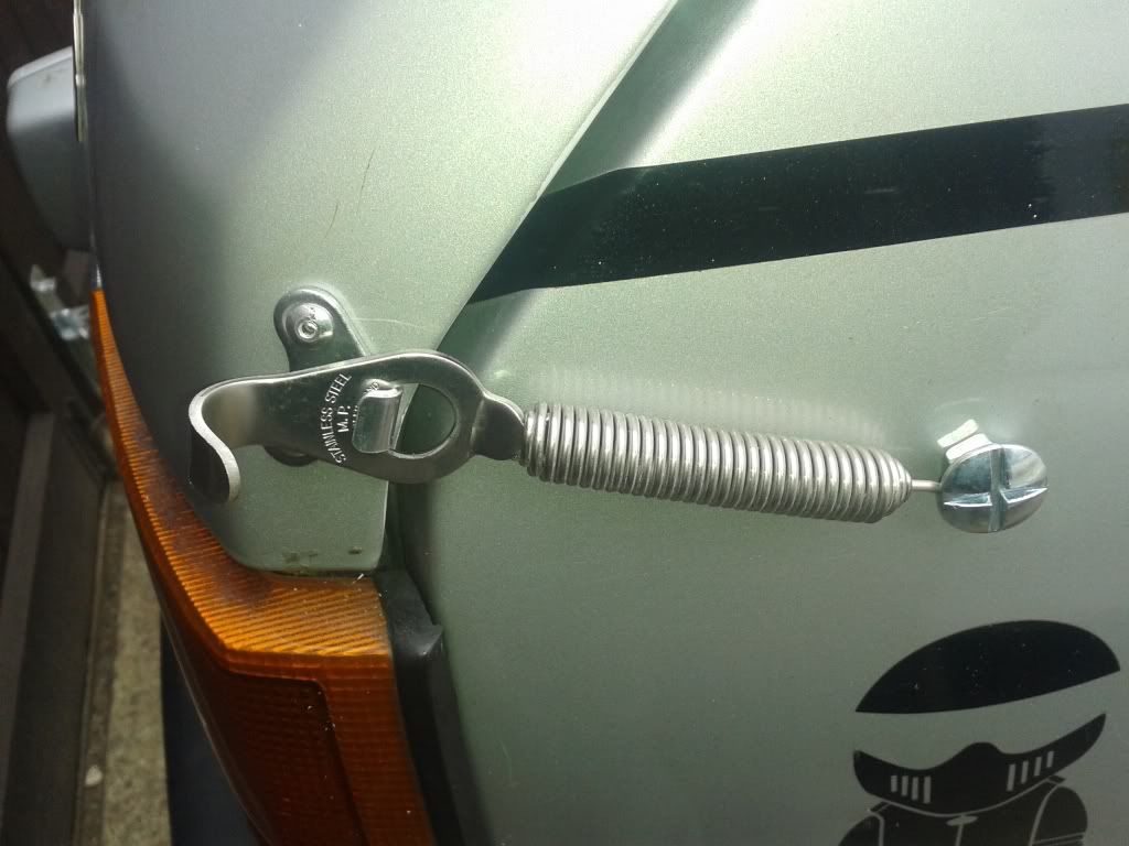

Part 2 line spring up make hole 10mm from bottom. Drill and mount. Have to add the 10mm or there's no tension on the spring :)

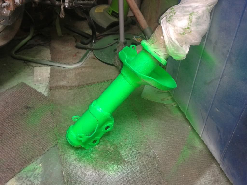

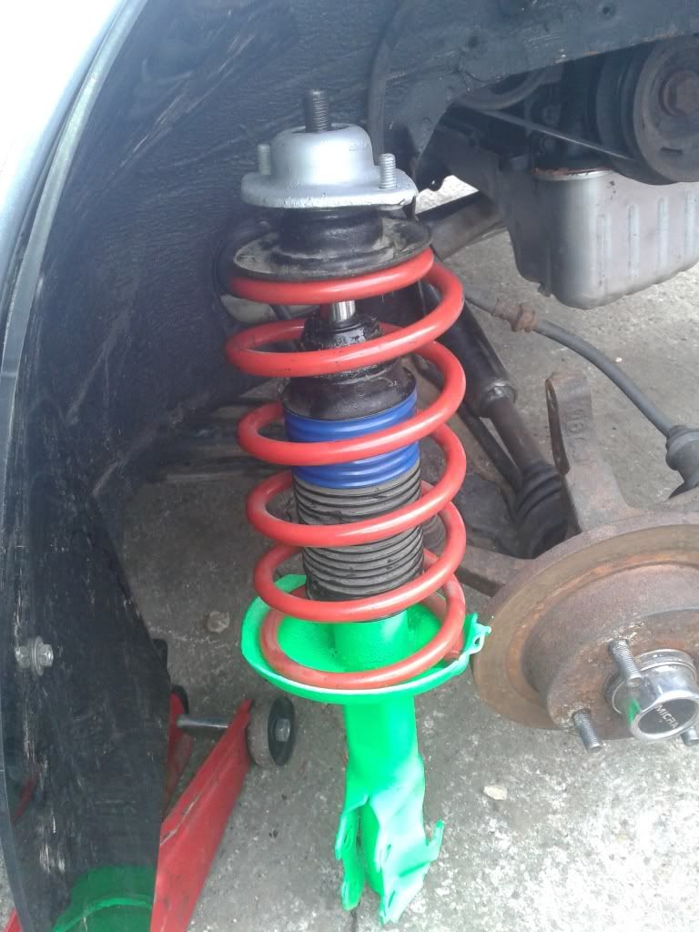

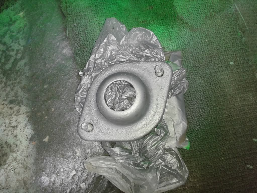

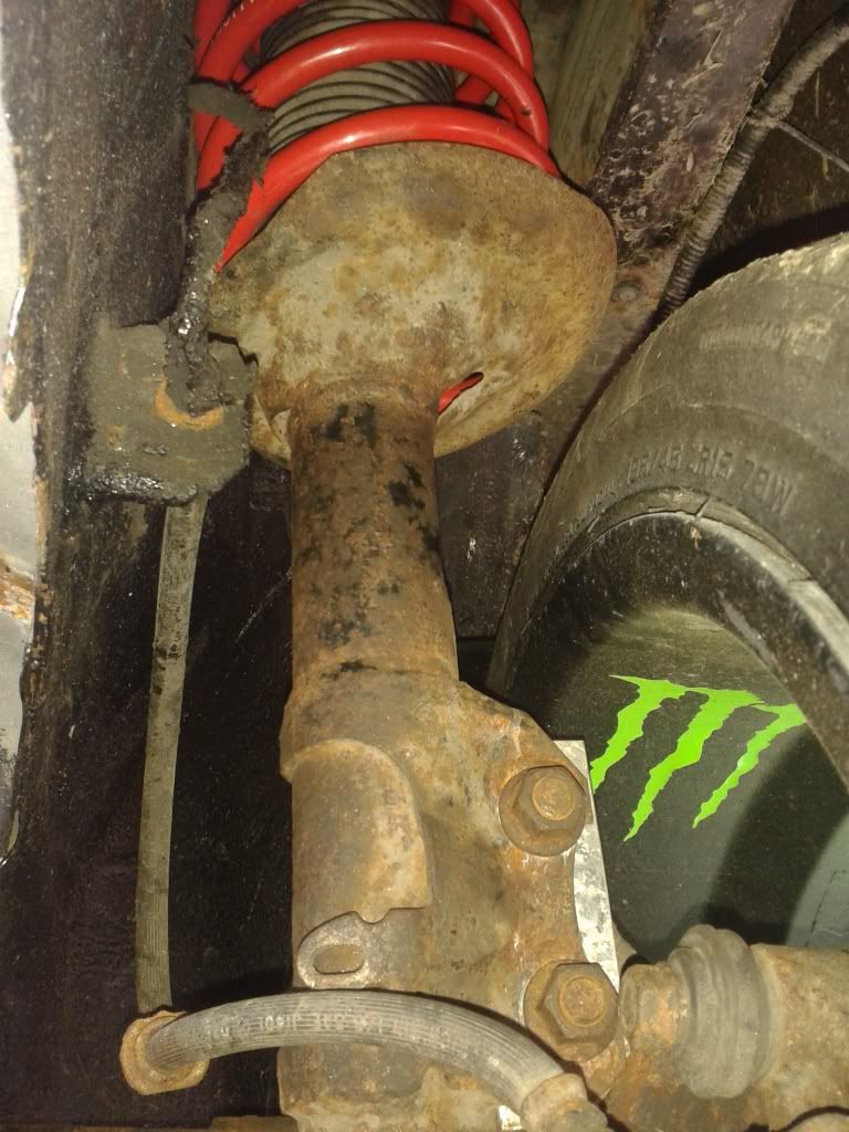

Next up my shocks
Sand, prep, prime and paint
Not forgetting the top mount
Then bolt it all up
Before anyone asks... yes the little 1 litre brakes are back... being as I'm paint things I bet you can't guess where my gtir brakes and hubs are :rolleyes:

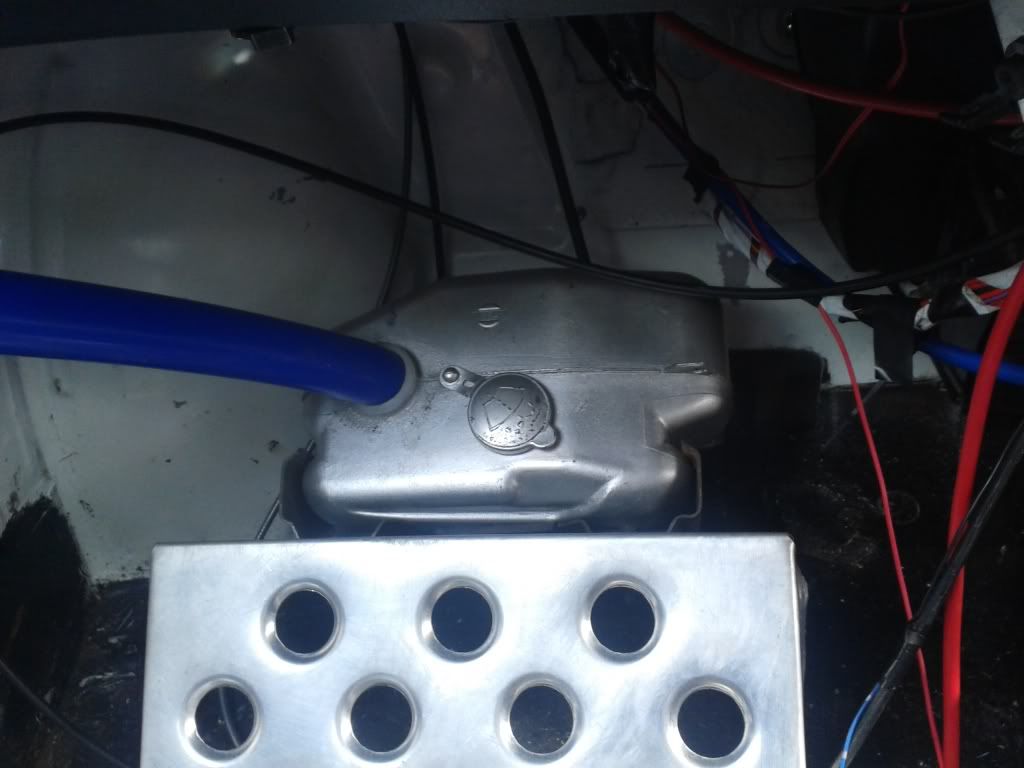

Finally my washer bottle
Simply relocated on my navs footrest
Extra pipe to fill it with and the washer jet pipes still attach to the jets on the bonnet no trouble

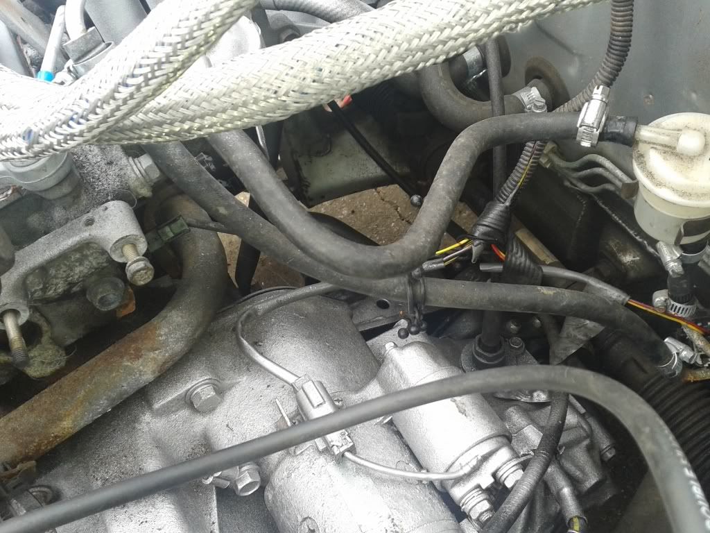

My only thought is the fuel lines look quite taut and might tug loose with engine movement over rough ground and revving? Looks good otherwise :)

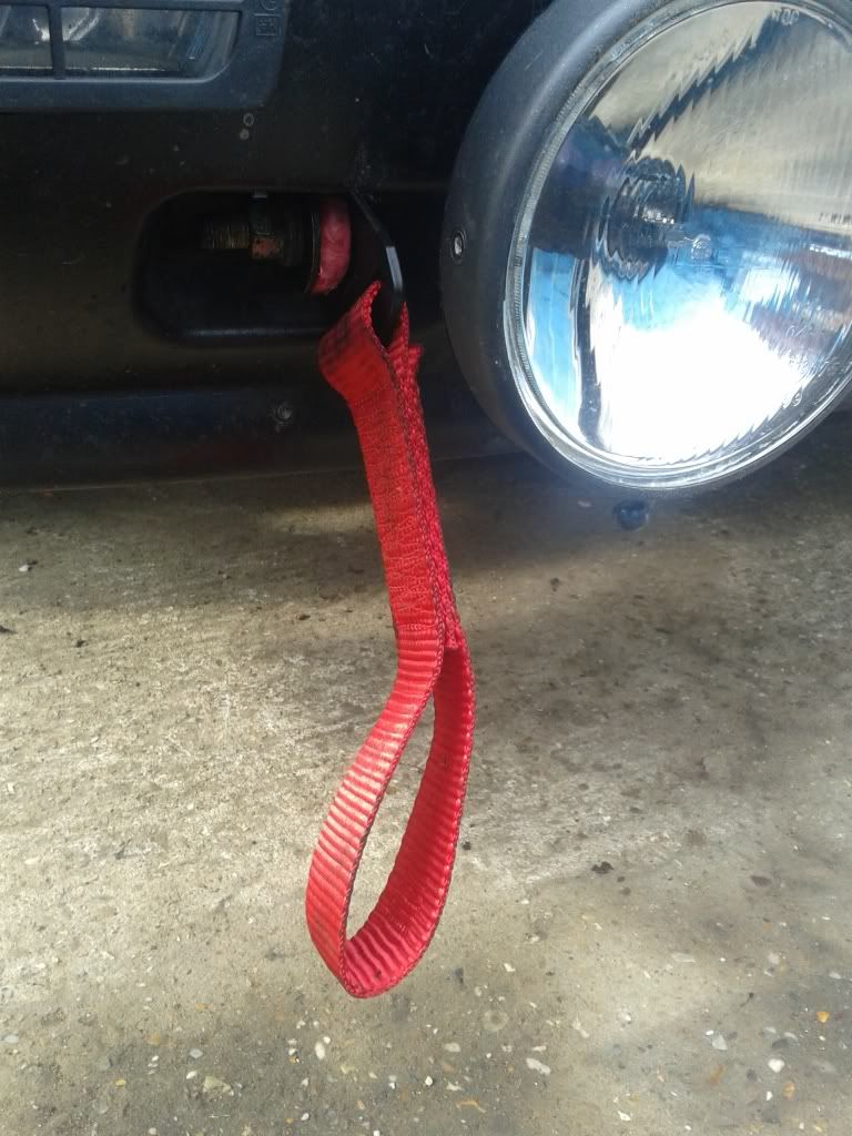

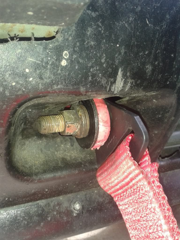

First the simple tow strap
How its bolted

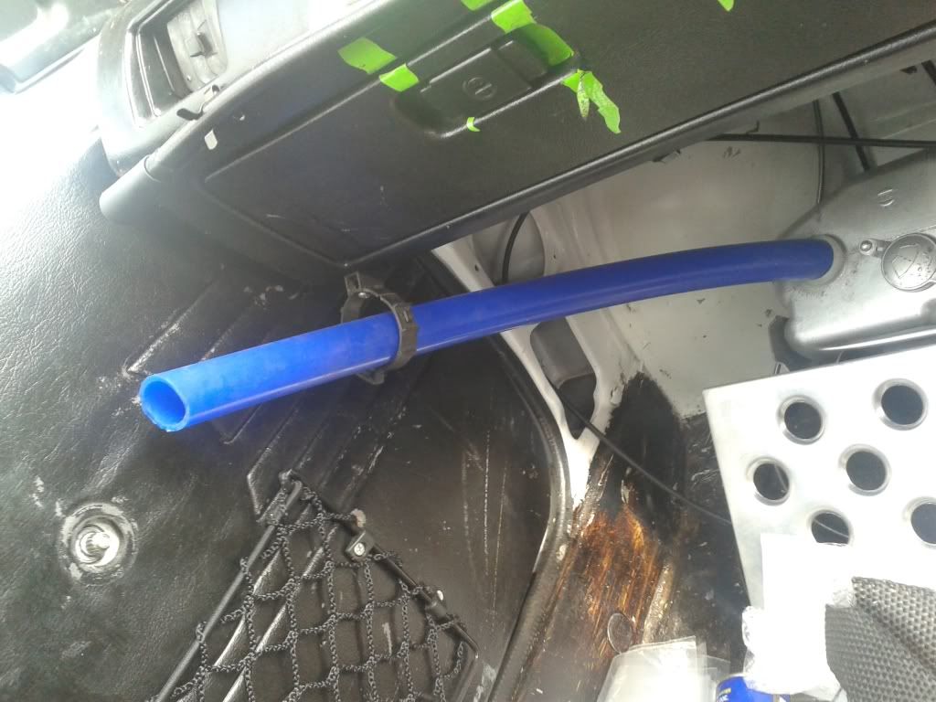

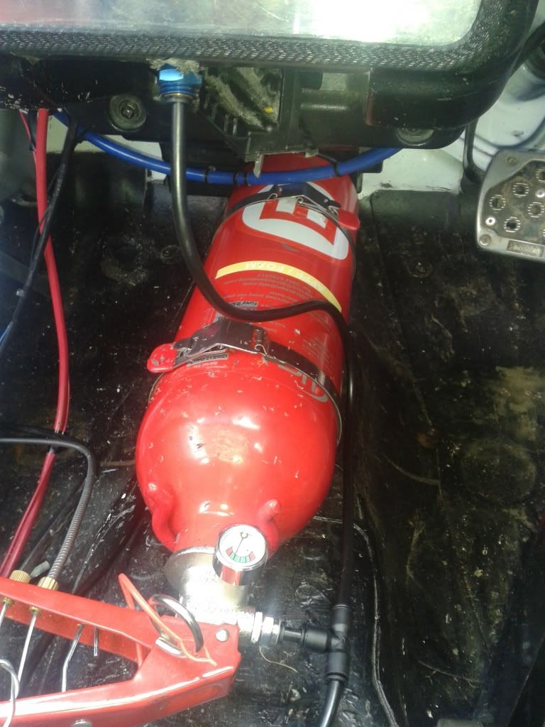

Next up the fire extinguisher plumbing
The piping bends like pipe cleaners so its fairly easy to mold. Just need to get some p-clips and secure it properly

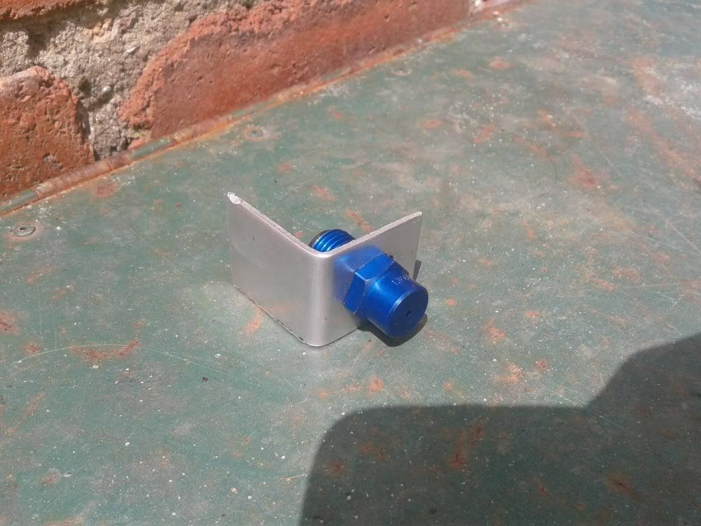

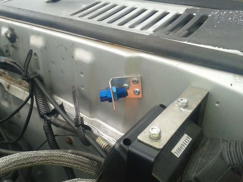

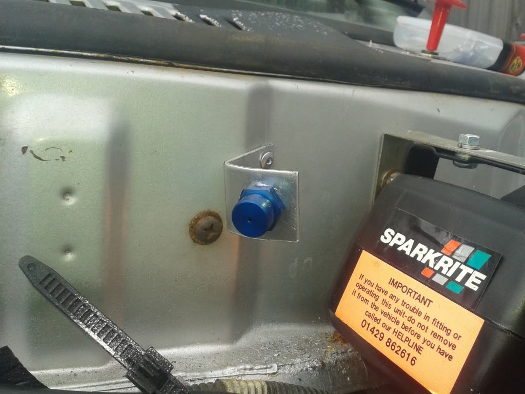

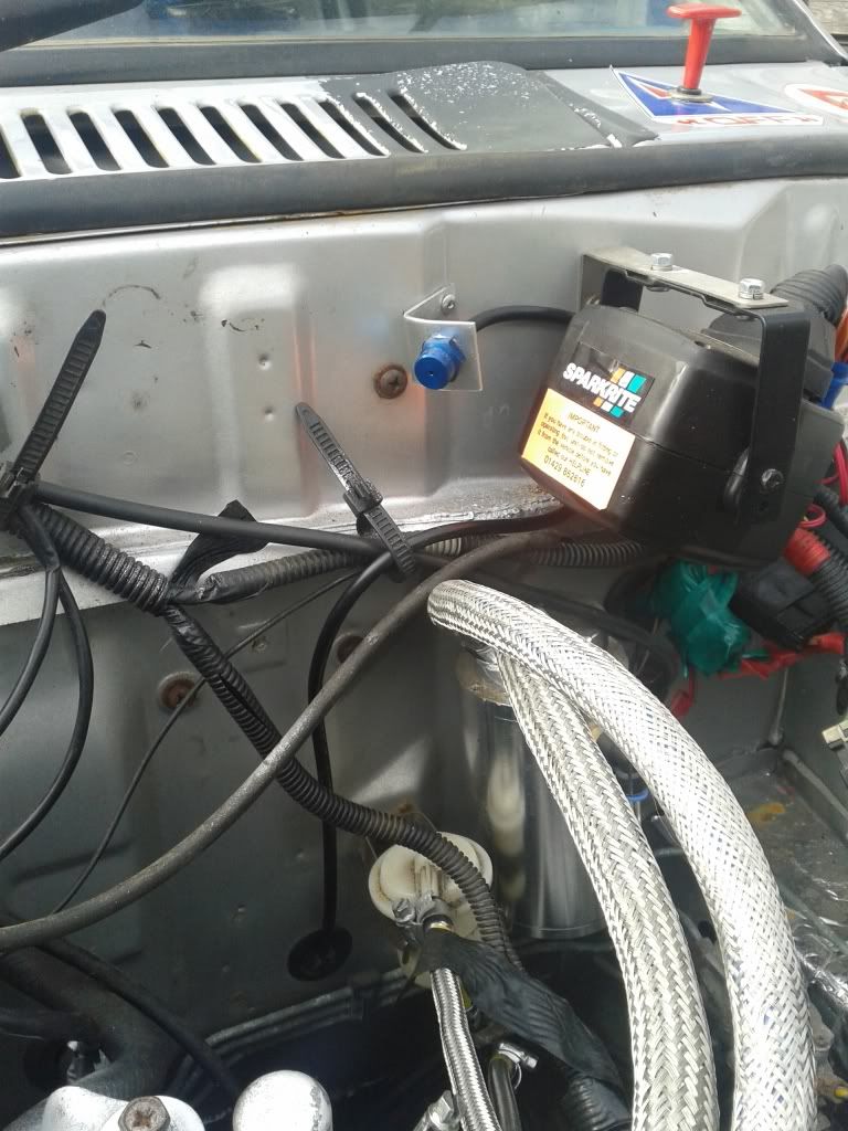

Needed a nozzle bracket so I made one out of aluminium
Attached it the firewall
Then plumbed it up :)
