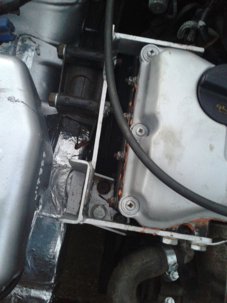

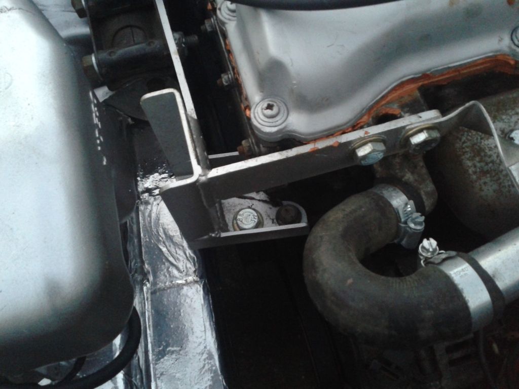

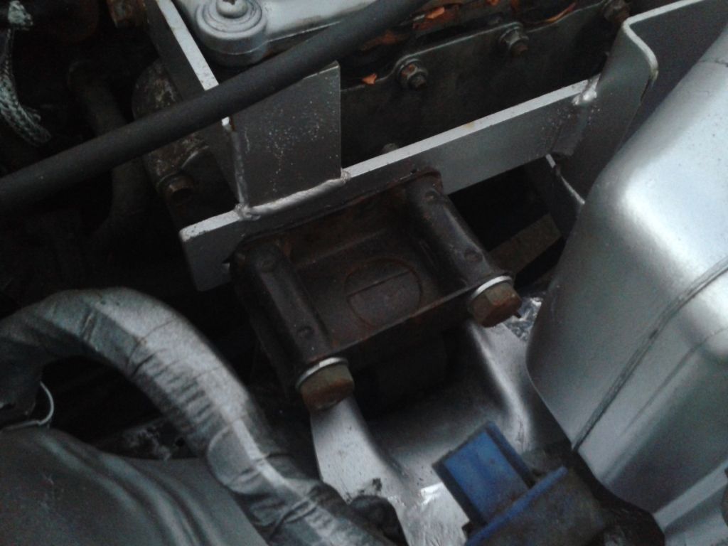

could you get a pic of there the bonneet pins closest to the windscreen are mounted in th bay just i wasnt sure were to mount them
I shall do tomorrow for you :)
They're mounted in the top of the strut tower itself. Not how I wanted it buts that's how it ended up. But believe me there's room for em on there. Ive got a chunky 6n diesel setup under there and its no problem :)
You can weld a triangular plate from the top of the strut tower to the inner wing and drill into that (my original idea)

On my k10 there were small 3/4mm holes already in the top so I drilled them out and popped em in there. The large repair washers are a good recommendation too.
Mine also has a small steel tube on em with garden hose pipe round it to give the bonnet its lift for better airflow
A doddle on a k10 with how the bonnet opens :)
Top mounts already just holes to drill out and strengthen

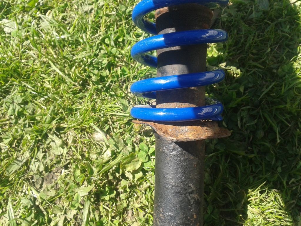

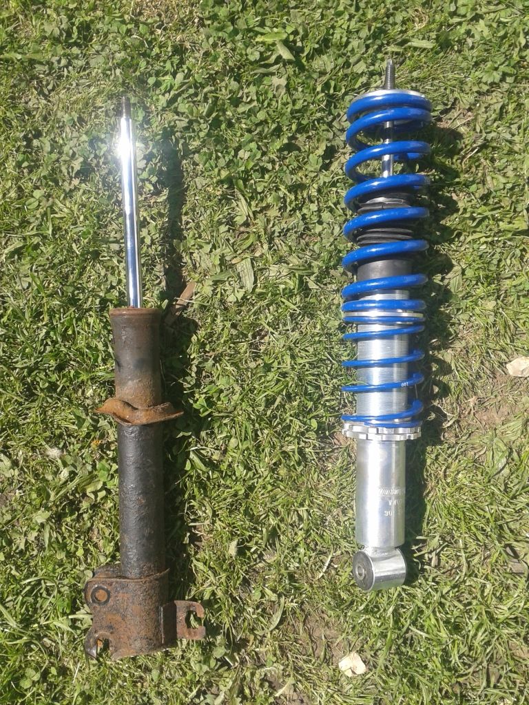

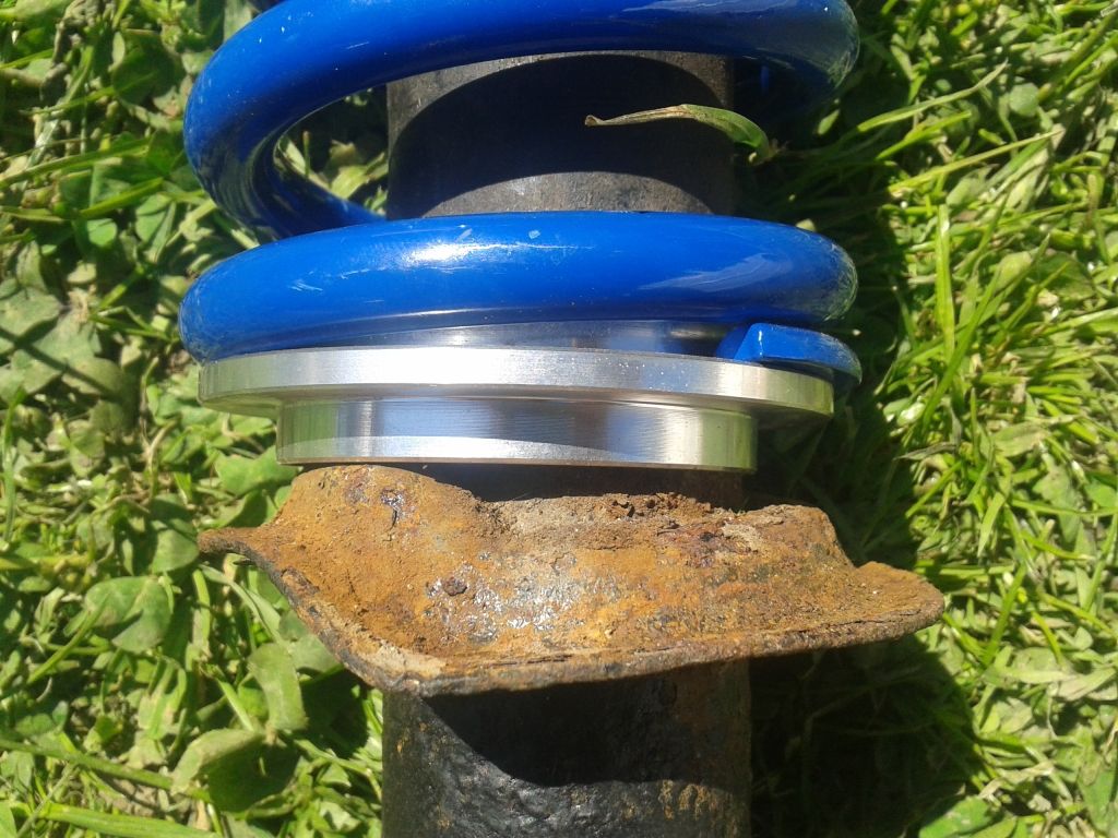

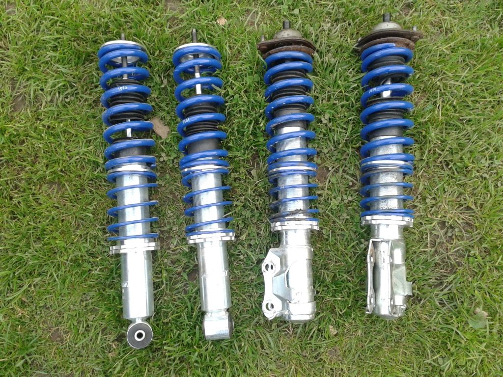

So I was fiddling with a set of coilovers just now and did this
Thought hmmm...
Needs a proper seat..
Mill and weld and voila! Low and stiff k10 stiff k10 suspension (I didn't mill and weld but I might with some different springs)
Non height adjustable but you can alter that by changing the spring free length and of course spring weights can be changed :)

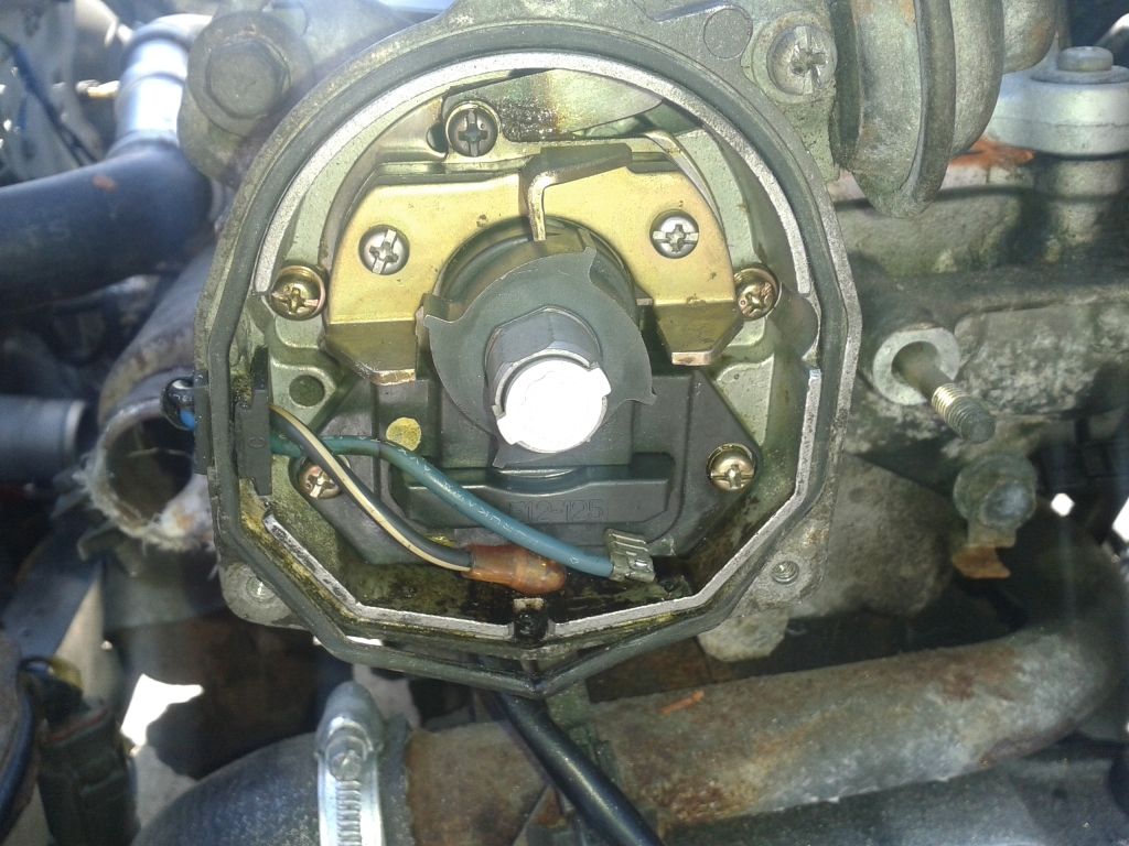

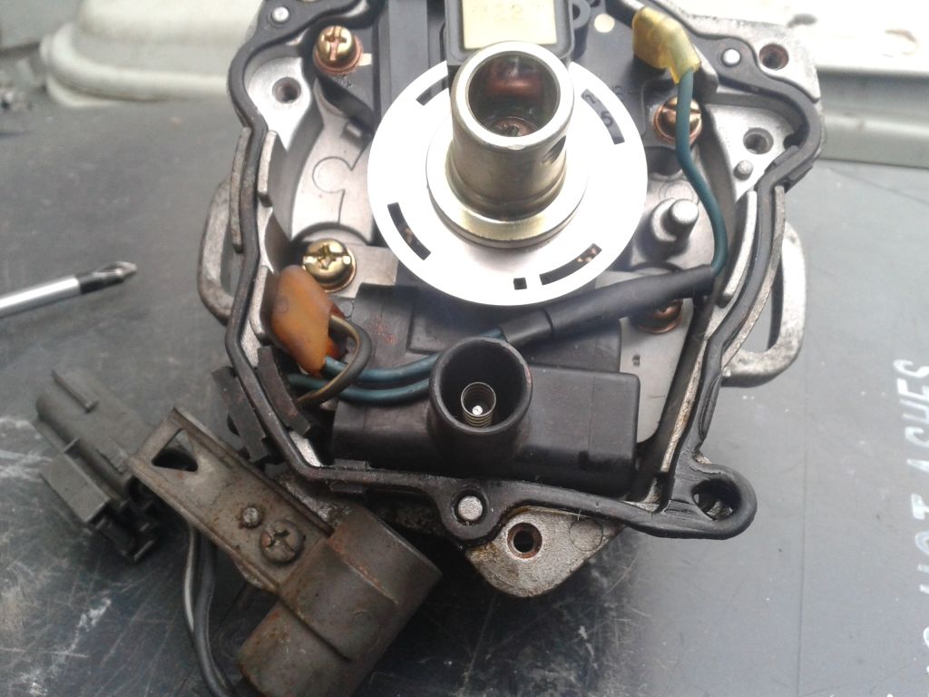

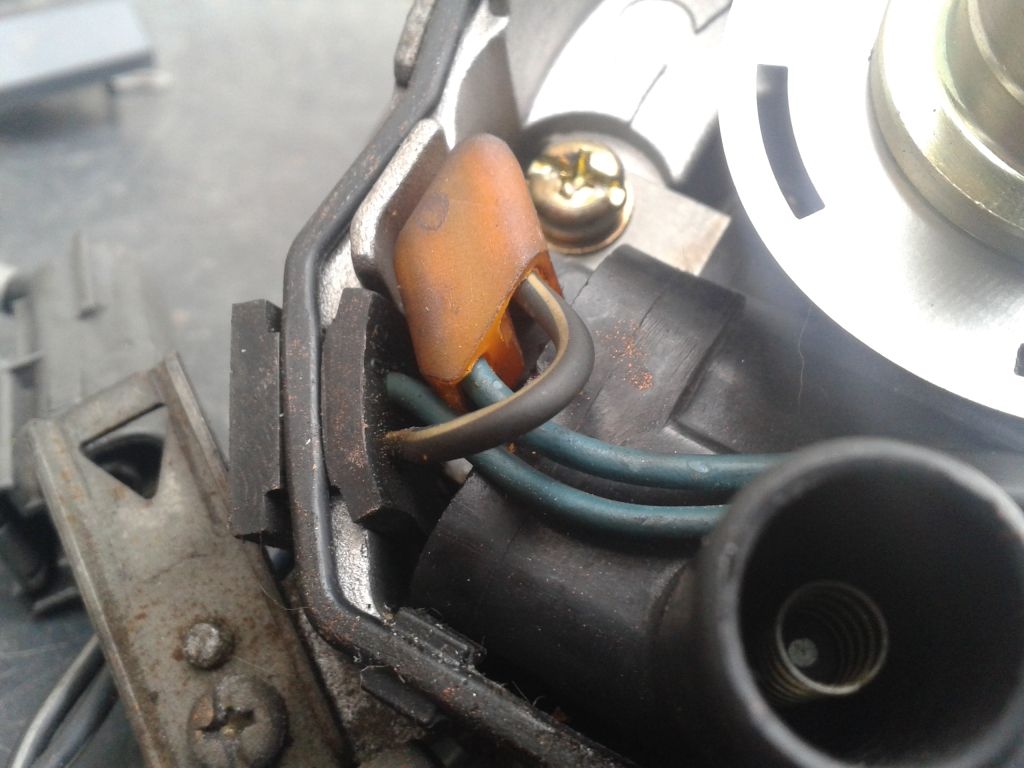

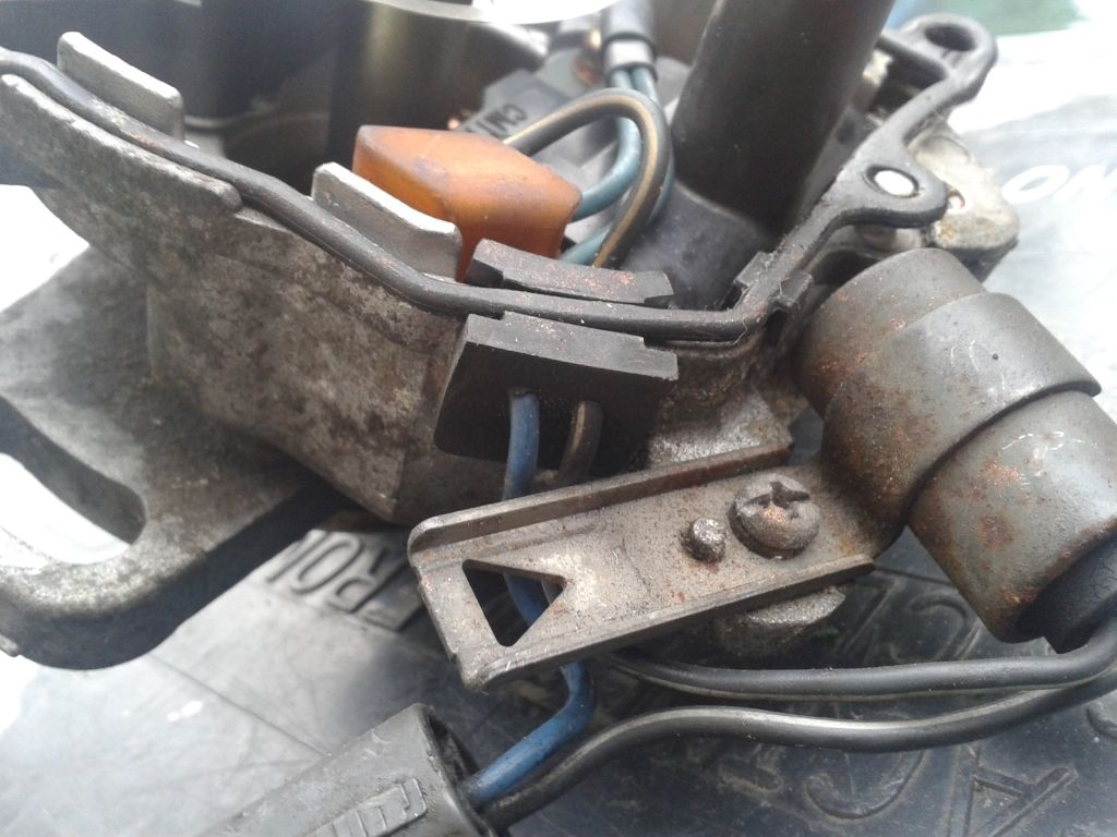

Anyone any ideas what the computer chip thing is at the bottom?
And what wires should go to it. Got my black blue wires to coil but there's one missing. Cant for the life of me remember

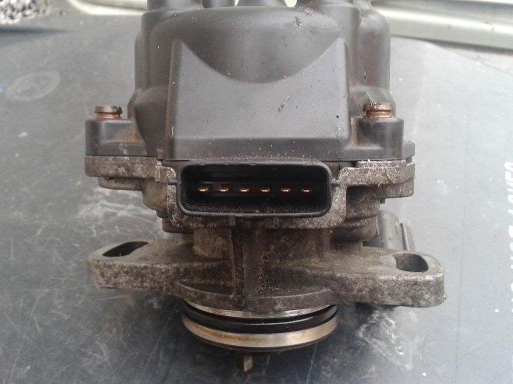

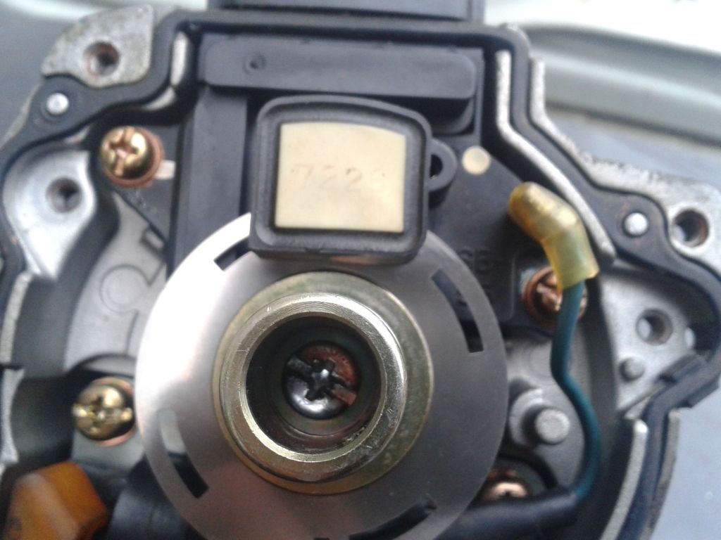

What does each pin do on the de dizzy? Cant find a wiring diagram
Here's the pins
An overview
The usual blue black coil wires
To coil
Sensor which replaces points
Will this sensor just need power. Thinking it needs management to decode data from it.
Need any and every idea going and some sort of wiring diagram
its a simple 2 condition sensor, on off. It detects magnetic flux which is absent when the slots come round. During the period the slots are under the sensor there should be a break in the signal to the solid state switch, that closes the circuit needed to discharge the coil through the dizzy. No high tech management needed. There should be an ignition module though I think.
Disclaimer: This is based off my installation of pertronix into a spitfire dizzy, and should not be take as gospel but rather a place to start.
Thanks. I guessed it wouldn't be too complicated. Its finding the two wires to power it.
What about bypassing a module. For now?
i think the 2 wires go to the coil, and the other 5 go to the optical sensor/CAS and power transistor andy :)
But I dont know what those 5 are :( should I buy a standalone unit I wont know what wires I'm plugging to connect it
Magnetic is cheaper, optical can be set more accurately, or so I've read. I don't see how it makes that much of a difference. Just magnetic can be thrown off by iron filings but optical can be thrown off by anything opaque.
