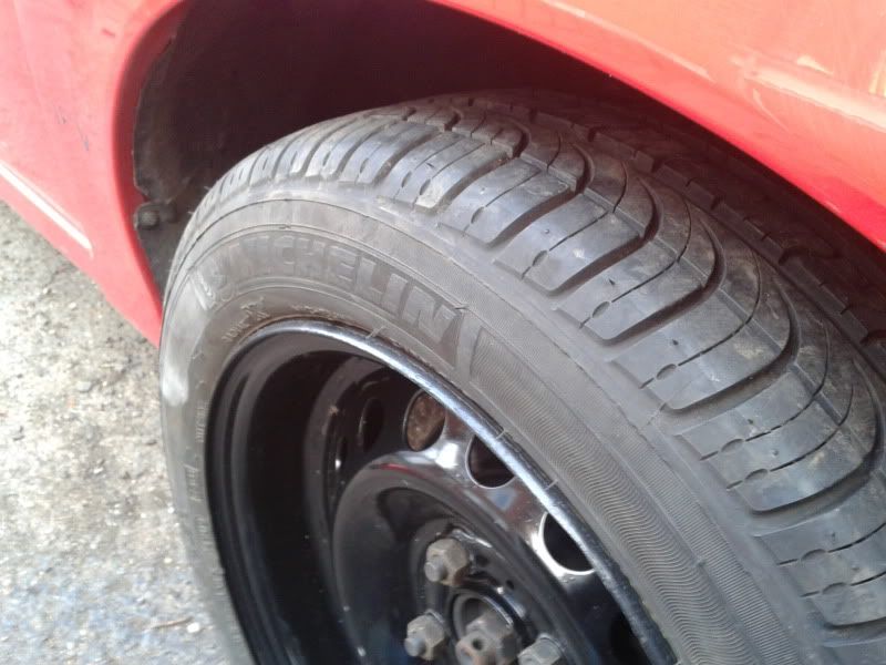

Trying to source some cheap part worn tyres for my Frank wheels.

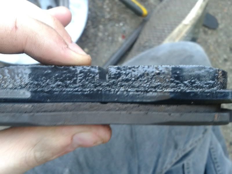

In other news i sorted out my brake pads today, the calliper still seems to be seizing slightly, its very stiff to retract.

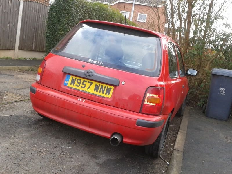

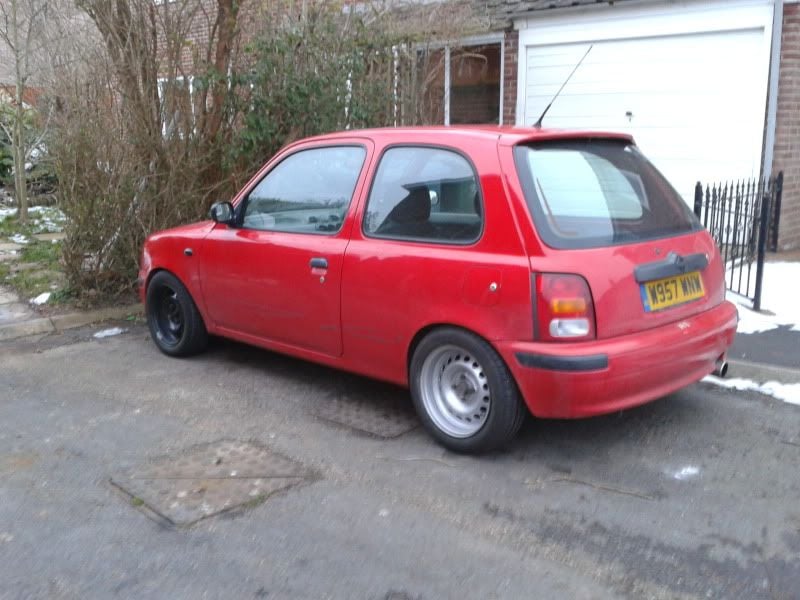

Better photos over the weekend when she is clean but i'm so happy, its not bouncy and the ride is comfortable yay!

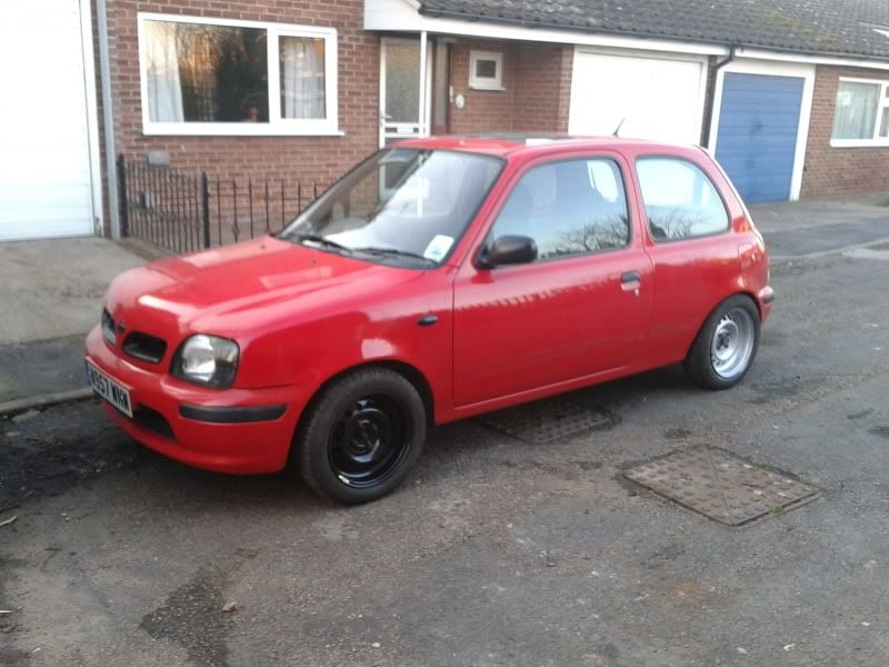

Thanks Harlen i'm quite fond off it. Not sure what else too do to it now just general tidying and making it MOT passable.
I remember reading that the Nismo pre-face splitters can fit the facelift somewhere.... Don't quote me on it. But one of those would finish the car nicely. Any type of splitter would really.

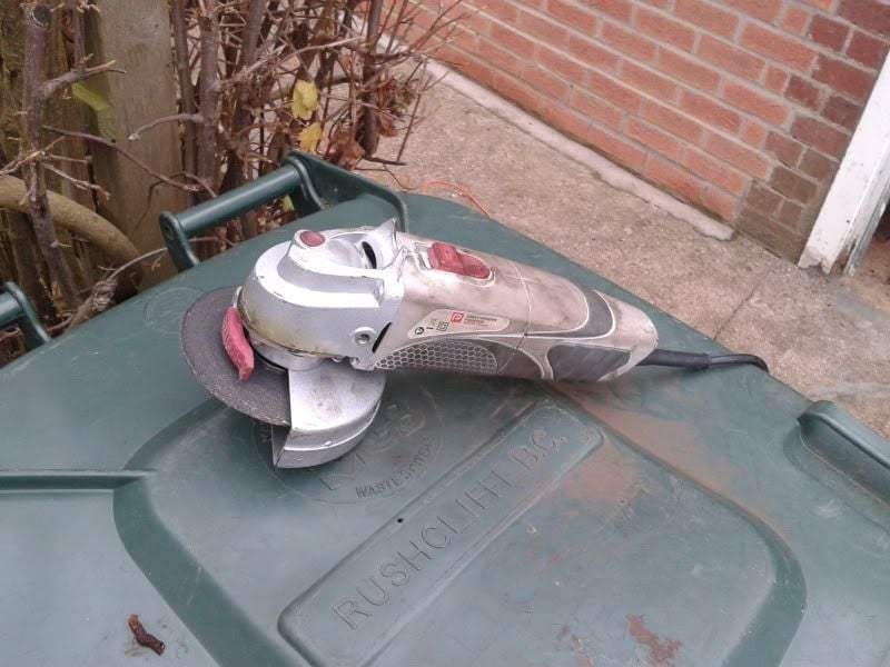

Ground the panhard mount off the disk axle, now time to get the broken one off and this one welded.
