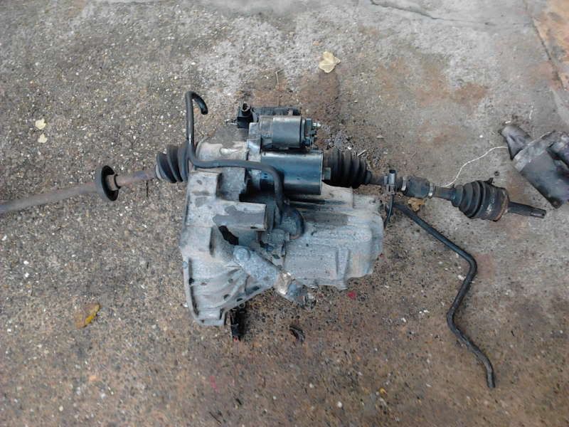

Now the "fun" bit I pulled away and there was a very very loud crack and my gearstick flew backwards nearly breaking my wrist.
Turns out, the rear Gearbox mount bolt has managed to snap a large bit of the bell housing off andf is no longer "Bolting"
Gearbox is currently sat on the cross member being held by the gear selector.
Just drove 5 miles in first then called for rescue...
YAY!!!!

Gearbox is ready to go on just got to get the old one off now.
Well the old box is ready to be dropped in the light tomorrow then pictures of the damage will be up.
Right its in! Works! Celebration for the celebration!
Heres the damage too the old one.
And the new one before going in, with my starter motor and speedo drive fitted.

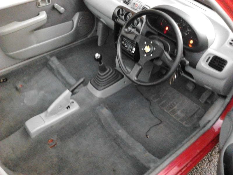

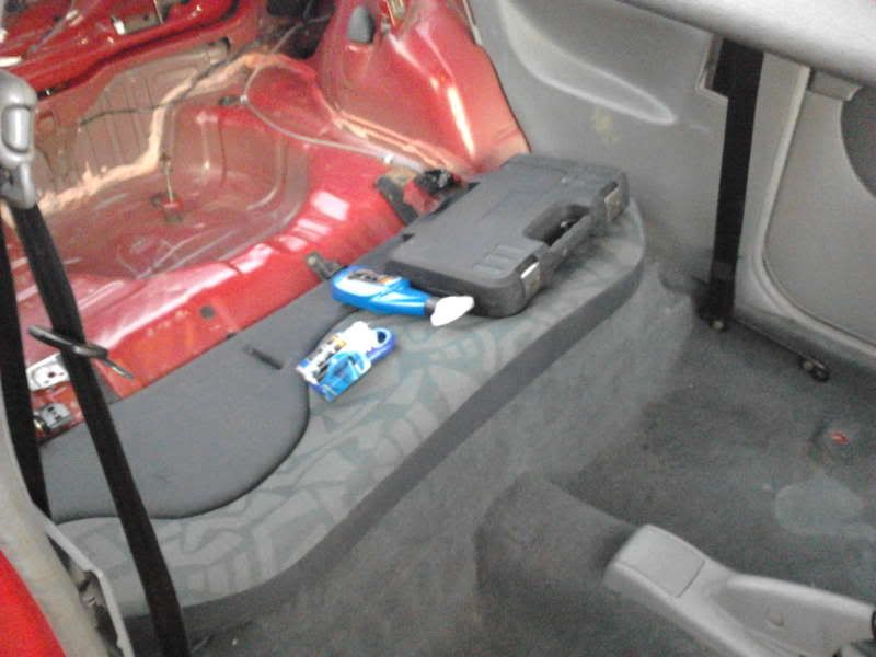

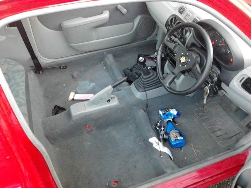

So after leaving her sitting and being my temporary shed while i was fixing the gearbox i thought the car needed a well deserved interior valet.
So first off i took the front seats out to make sure i could really get at everything.
Before:
Look at the mess the ominous white stain is from a split bottle off polish.
During this is after hoovering and rubbish removal:
Still got one seat left to do then finished pictures up tomorrow.
