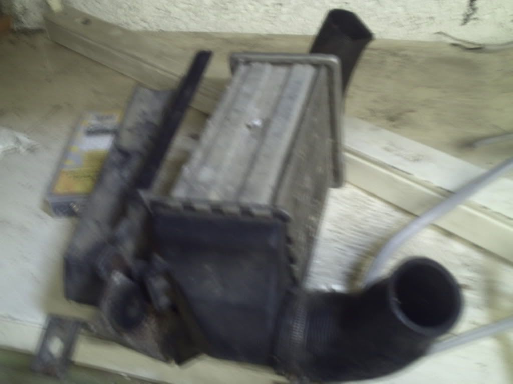

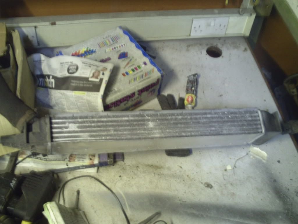

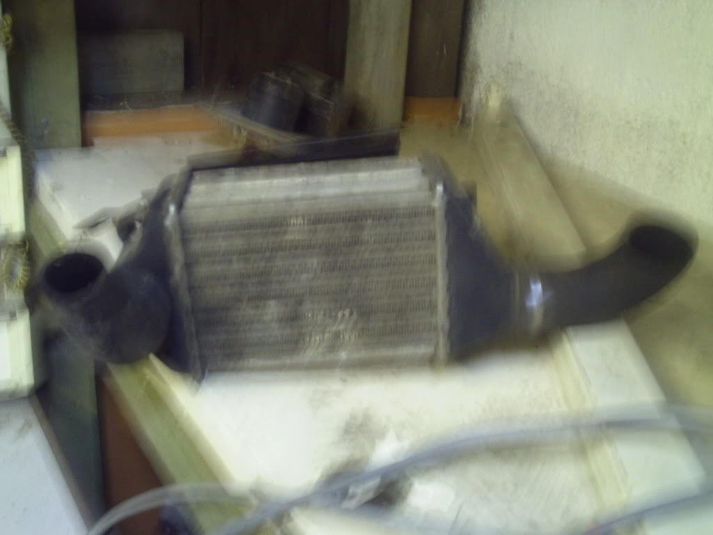

Got a few pics of this intercooler buddy well two different intercoolers.
the longer one is from a citroen cx and the other is from a mk1 uno turbo..
Cheers for the offer dude, I'll wait for the Evo on as it has bigger inlets/outlets I would have thought cheers anyway though mate(Y)

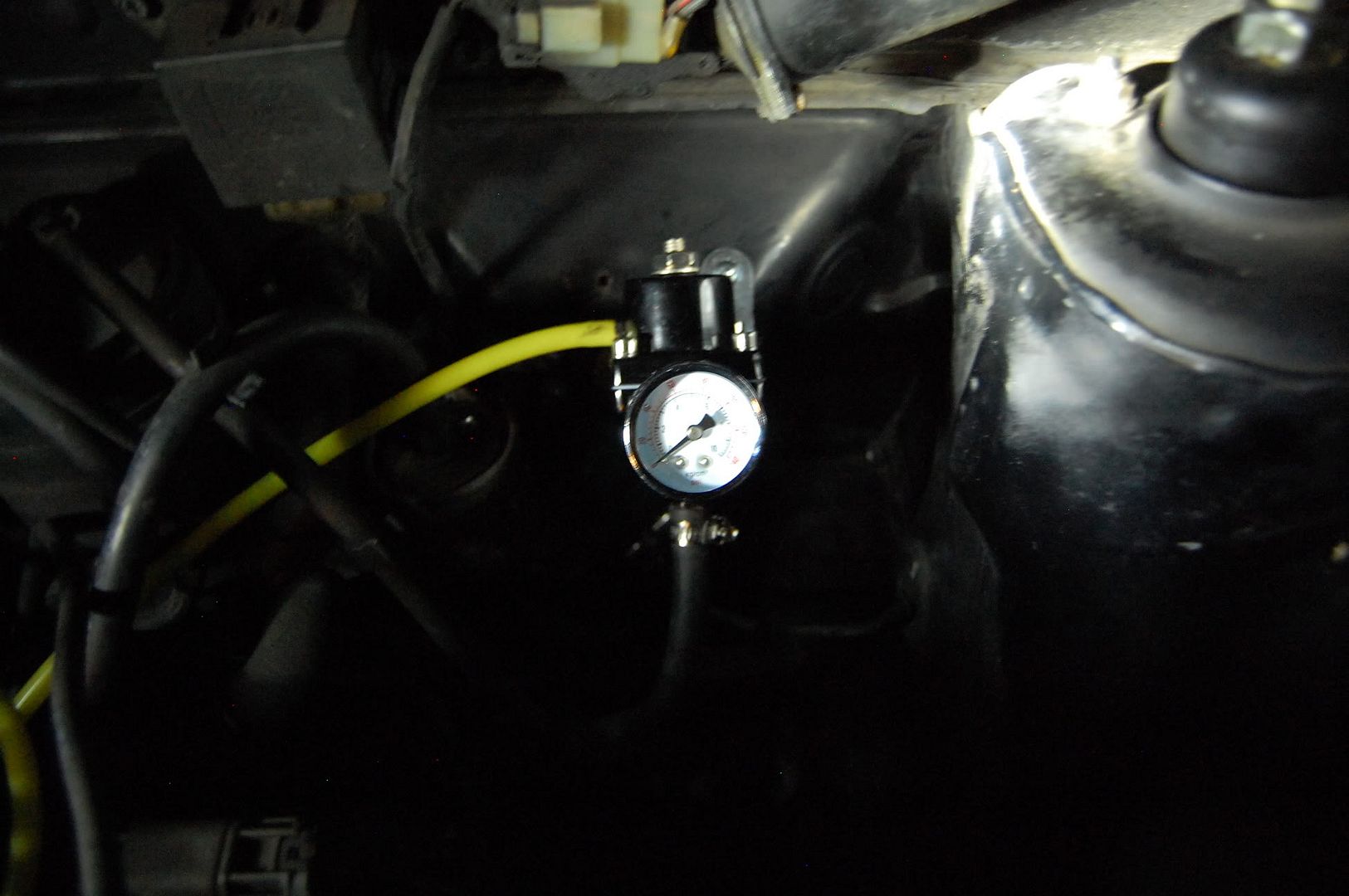

Finished fitting my fpr, all is well :)
Set it to 4 bar and no fires, burst hoses or the like
It does however feel more 'responsive' on the throttle though!!

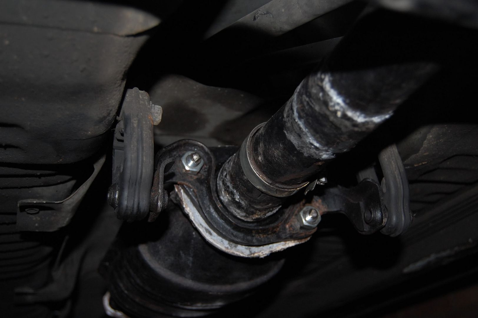

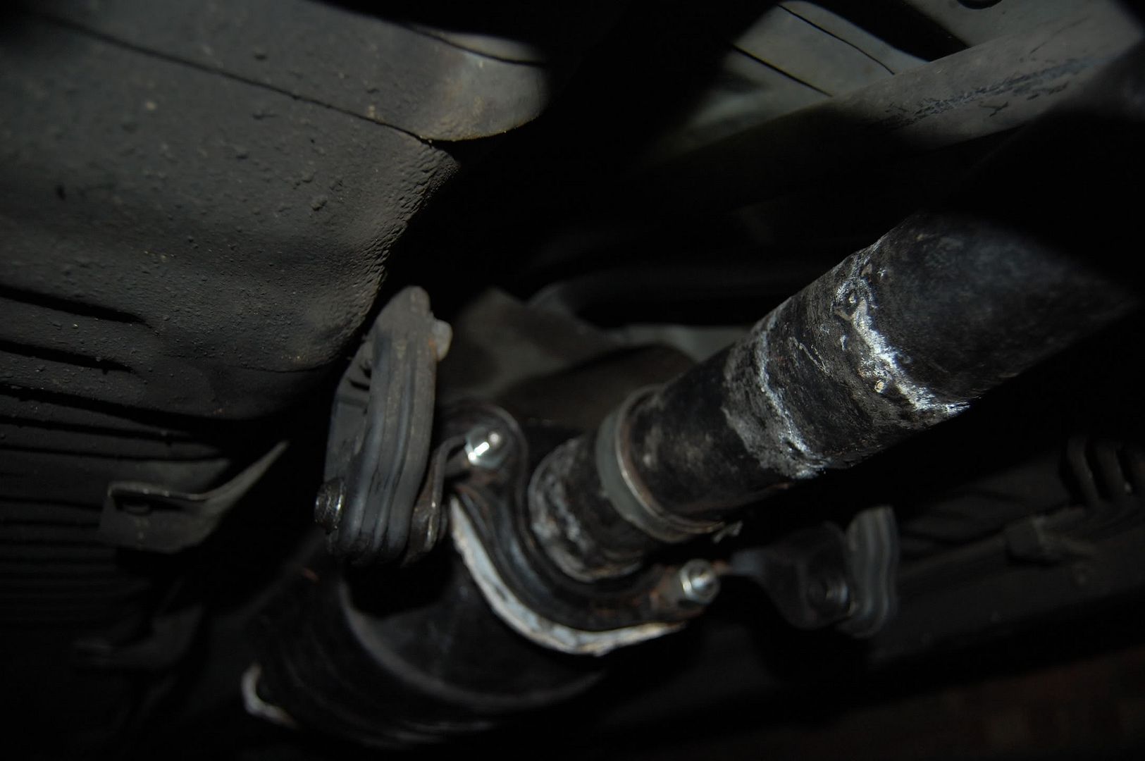

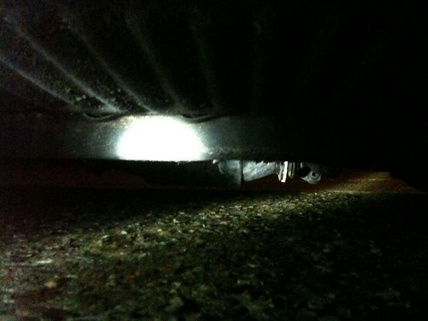

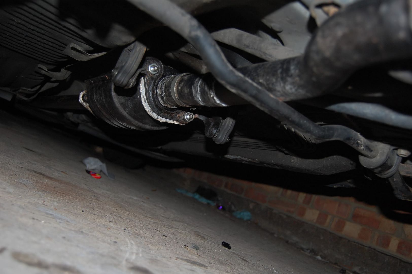

Little problem I have is this
Went for a spin round block after fitting fpr and front strut and handles like a dream
No body roll, no boatyness no comfort !! Lol
But and a big BUT, I have some issues
- down pipe is resting on the front arb and making a racket, gonna have to either lift the lot up towards the floor or remove arb??

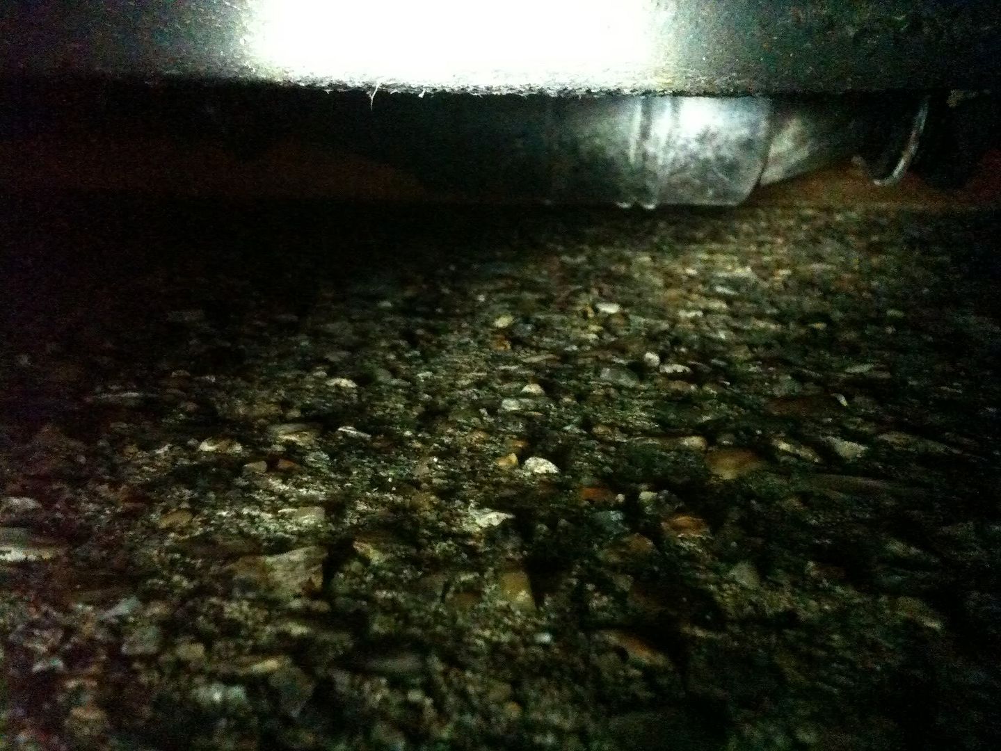

More importantly my cat/decat is less than 1 inch from the floor, if there is even a slight gradient issue or curve In the road it's sparky spark time!!!
What are my options?
Is it possible to bring the mushroom hangers which hold the exhaust to the floor higher up?
Can I do away with the rubber hangers and push the exhaust up so both hangers from the cat and floor pan are connected and do away with the rubbers all together??
Car drives fine sounds funking mental but I've got serious arch rubbing from the rear, a downpipe causing my teeth to rattle and scraping from the cat :down:
Help a bruvva out
I presumme so mate, the legs are at the lowest point ie it's an upside down U
If I turn it the other way it will hand lowering think
The car is just ridiculously low Frank And I need some sort of way to heightening it...??
Need some more legs welded on to the chassis and exhaust to lift if higher I think :eek:

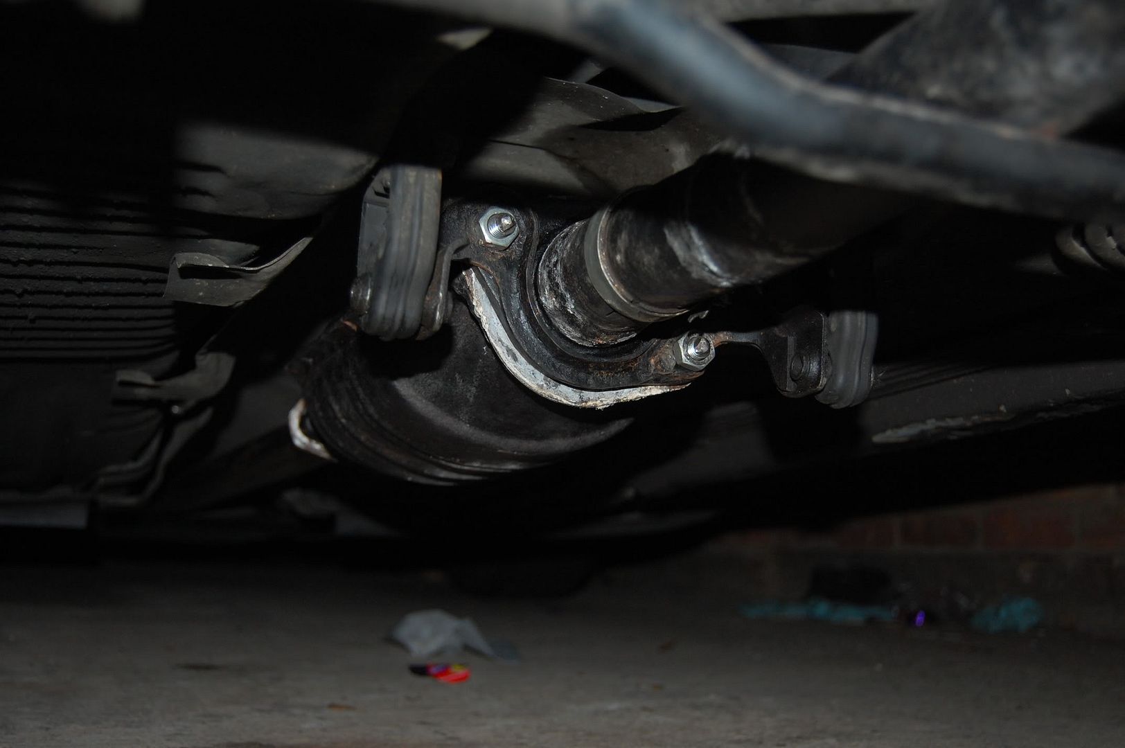

going by a pic in the haynes it should be fitted as an M shape eh martin :grinning: if not, how about shorter rubbers ? (but its a pretty tight fit for a 40+mm pipe to go over the a/r/b but also clear the floor too tho eh)
Hang on, is the rubber on in the first pic on????
Might go and check it again in a mo
It never use to rub on the old car and the cat hasn't changed positions?
Yeah pretty sure it's as the Haynes says, don't really wanna heightened the car
Imma check in get back to you in 15 :)

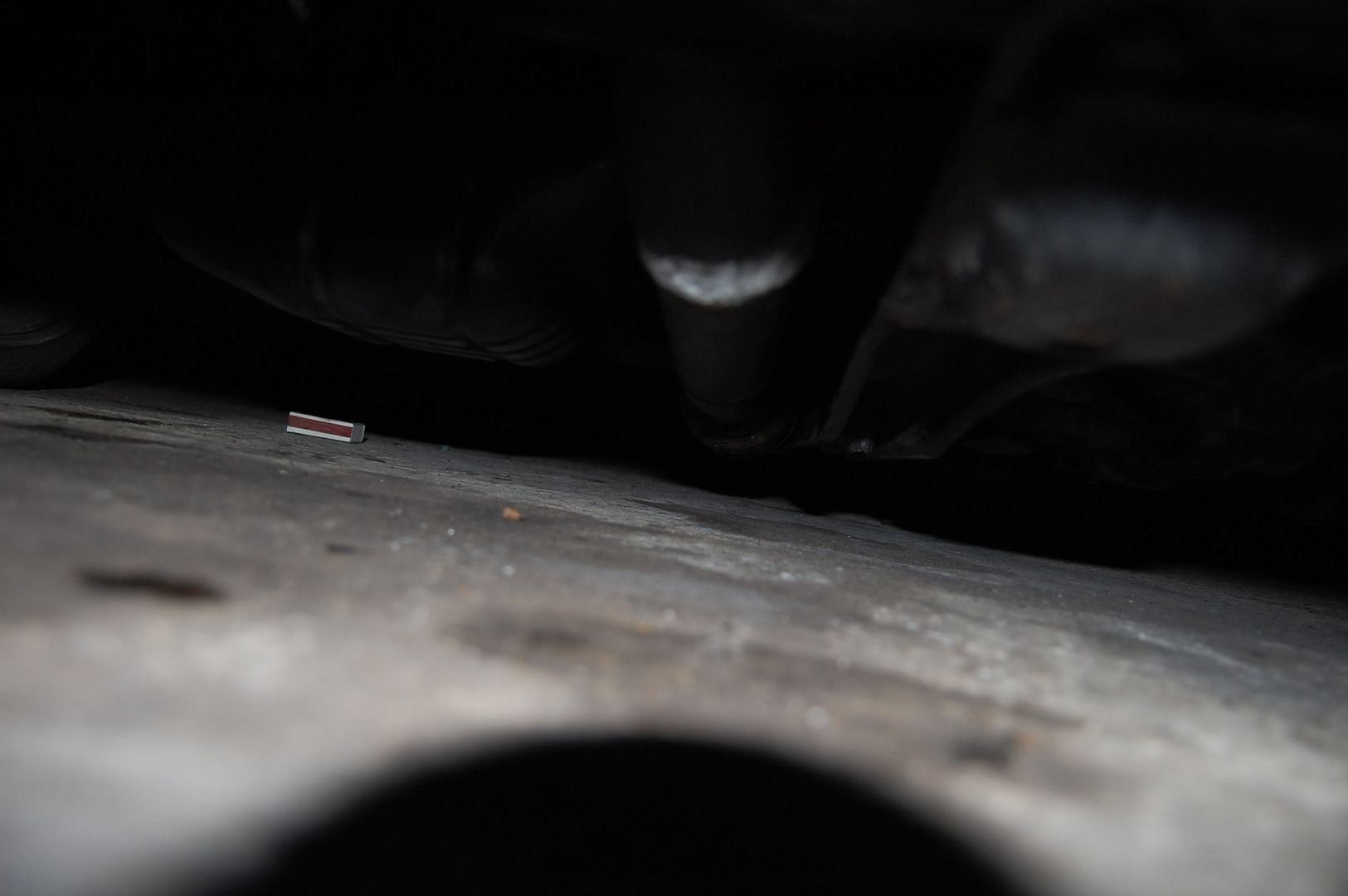

you should have about 10mm clearance between the a/r/b and the bottom of the pipe, and about 10mm between the top of the pipe and the floor, so i doubt if you will be able to lift it much tbh mate :eek:

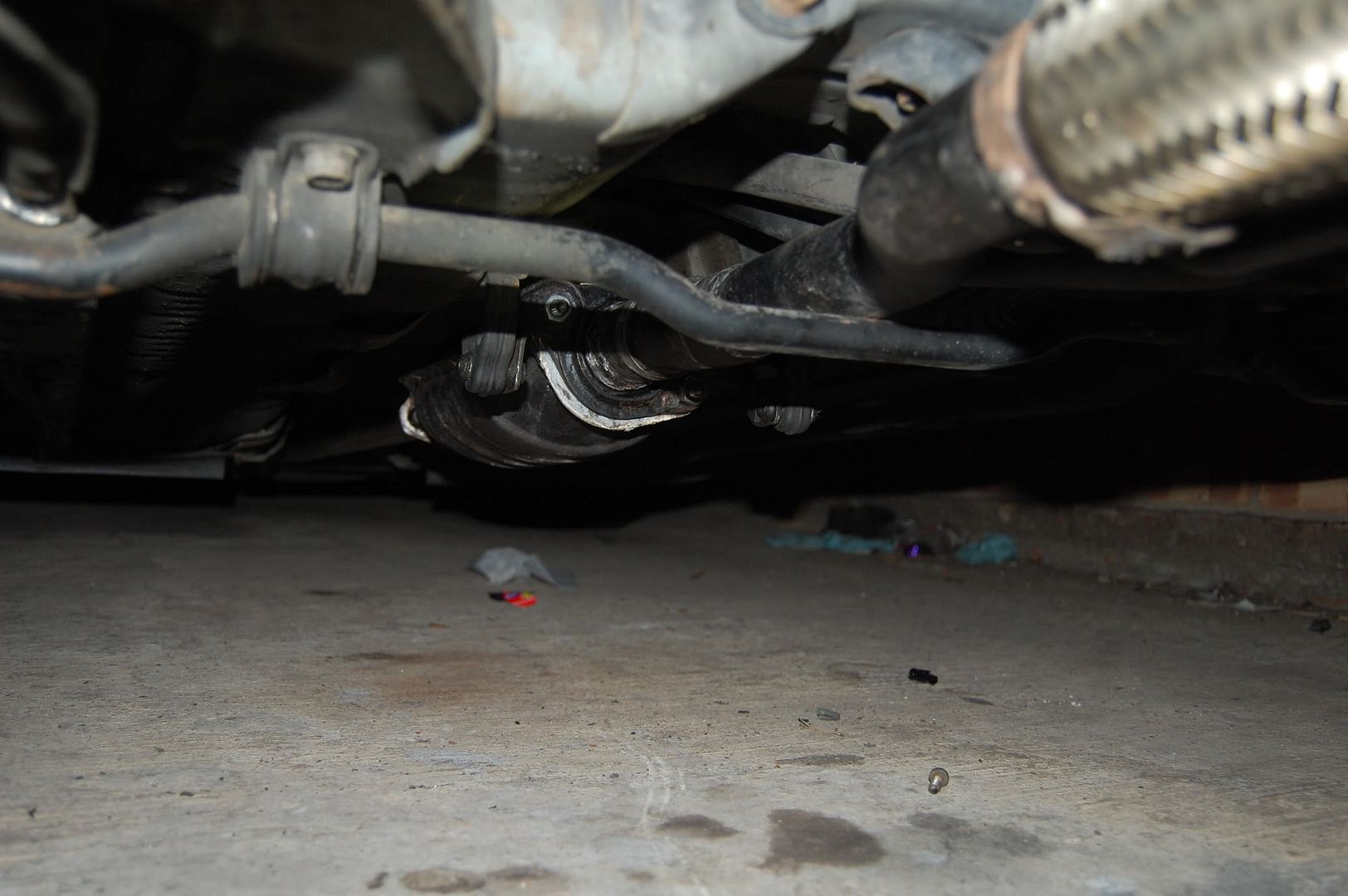

right got some pics, seems to be alot of clearance for the cat to go higher, any suggestions
like you say could try smaller rubbers?
what ya think matey?(Y)

first thing in the morning i will clean that intercooler buddy wrap it up then go from there.. :grinning: will i need to put an address on it do you know? presuming it's the smaller one of the two with the rubber pipes on :p
Hi mate, nah long one please bud I have to fit the intercooler underneath my actuator and there's as much room as a cd case (all I had to measure it!!

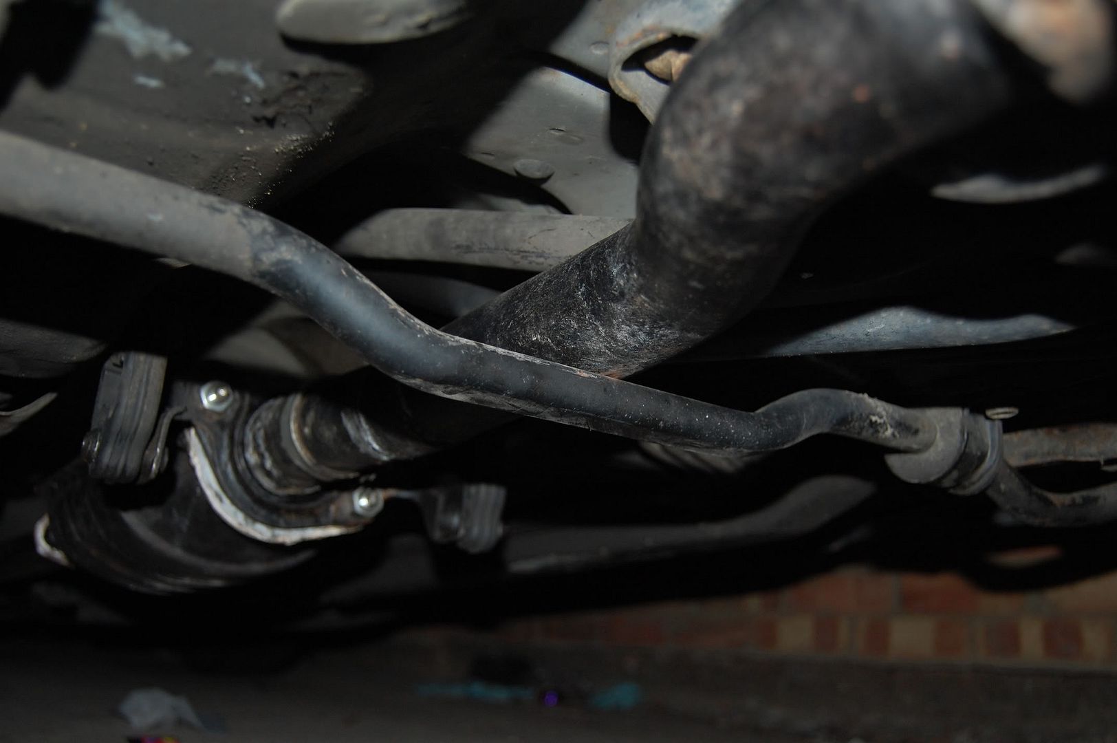

I've given up the damn cat!! It appears I didn't line the downpipe at the right angle so the rest of the exhaust is sagging
Great I thought easy fix, loosened downpipe nuts re_aligned, looosened all exhaust nuts on cat,wedged exhaust to were I need it, wedged downpipe into position
Perfect, then I did the downpipe nuts up and the Finley started moving back
Arb will have to come of, just can't pick the cat up enough without re weldeing new mounts grr
Tempted to put a straight pipe there but don't want to ruin franks awesome work!!

took some pictures of the intercooler today. I'll put them on tommorow :p theres a short length of intercooler pipe ill send with the courier on monday. :wasntme:
If I loosen the downpipe bolts and twist the downpipe it lifts the exhaust up and clears the arb, as soon as i bolt it to the decat it moves back grr
Frank designed it to clear the arb it just needs fitting better by myself
I could clamp it stani but don't wanna start creating a hole where it's rubs when the exhaust moves under load from the engine
you could try that flange 180 deg turned maybe martin ? because i did trial fit it tbh (had to nick the cat rubbers from my misses,s car to test it lol)
