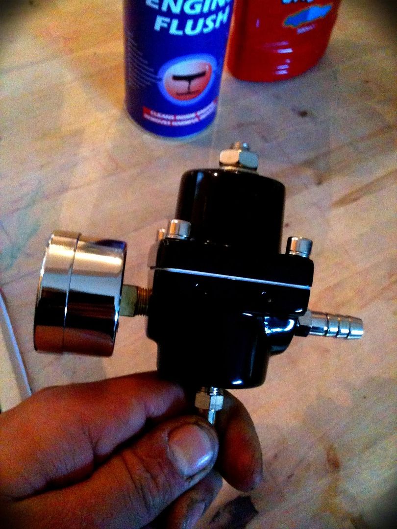

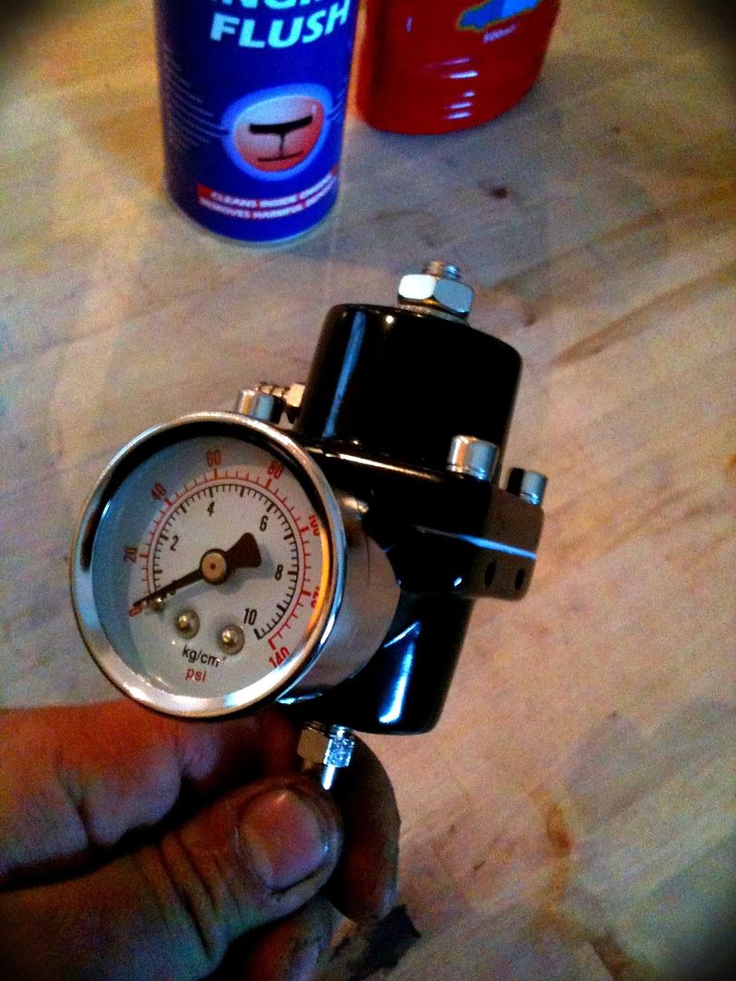

No time today but this turned up this afternoon

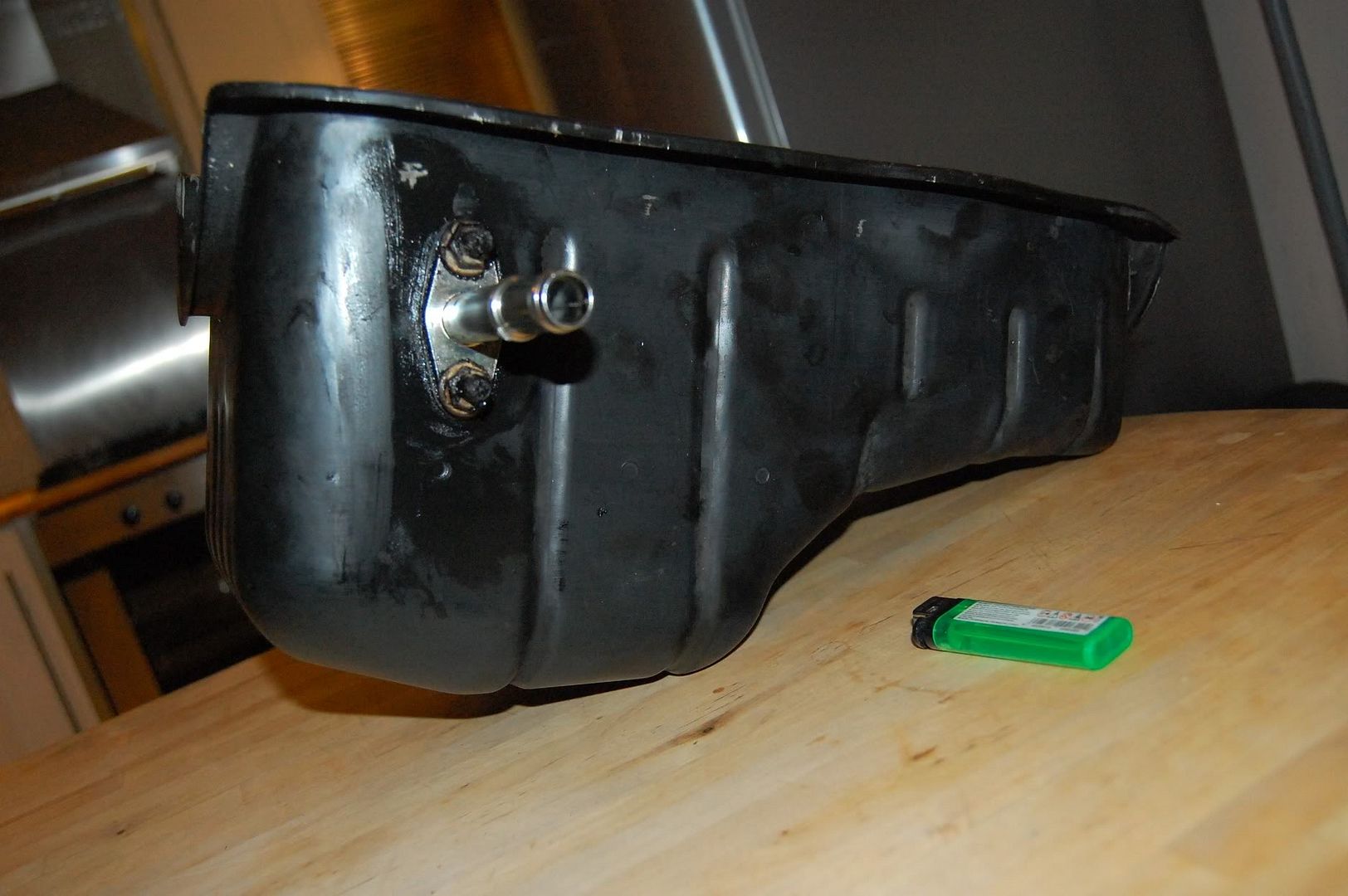

I'll get cracking with the sump fitting during the week

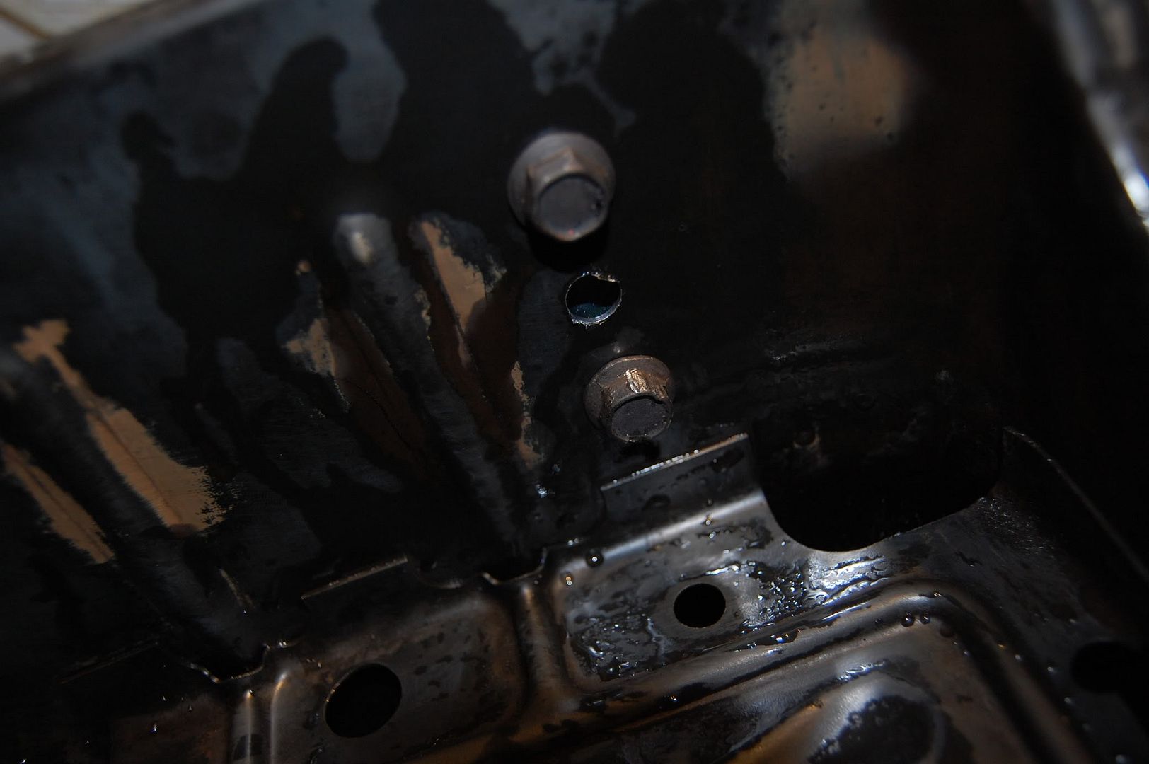

ive got one shot at getting it drilled and tapped properly or ill be requiring a new head
does anyone know thread size of manifold studs so i can get the right tap, cheers
Awesomneeeessss!!! (Y)Thanks mate, had to overdrill it with 8.5mm and re tap it with m10 tap, she's in there strong and no blowing so chuffed with that![]()
How did you get the sump off in the end?

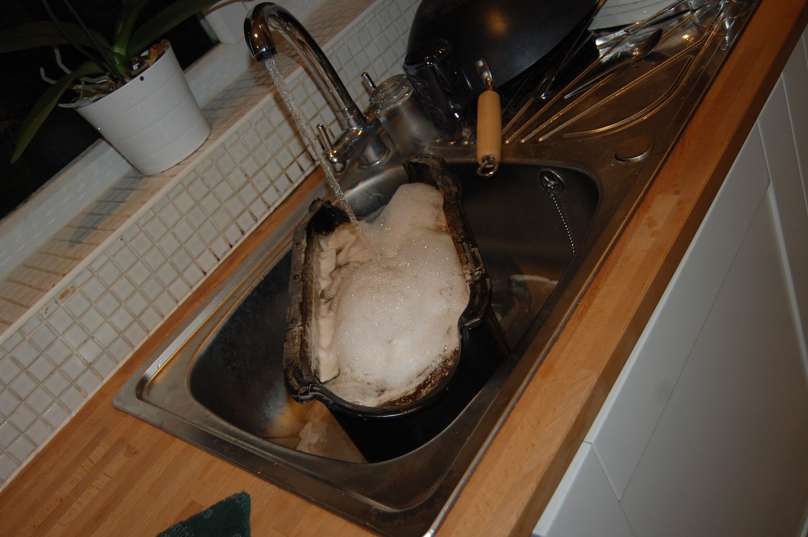

Cleaned all evidence of works before I went to bed and tidied up
Seriously though would dishwasher work on rocker cover? We dont use it at all and landlord would never no![]()
