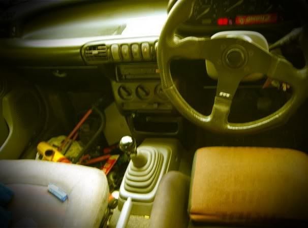

cars looking real good mate. was looking forward to a good pic of the interior and the fitted gear knob! how sad am i lol was dissapointed!
Tis only one I have mate, there's so much crap inside from fitting things etc at the mo
Cut about 1.5 inches off the stock gear shifter and then gearknob straight on, not bad for 5 though:)

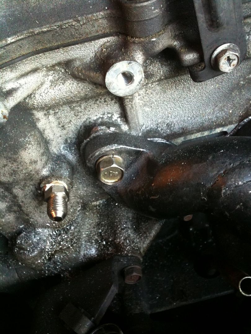

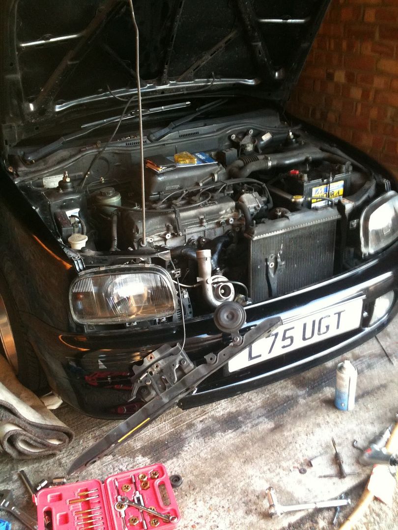

managed to get turbo manifold and downpipe on, and then cat back aswell but ran into problems

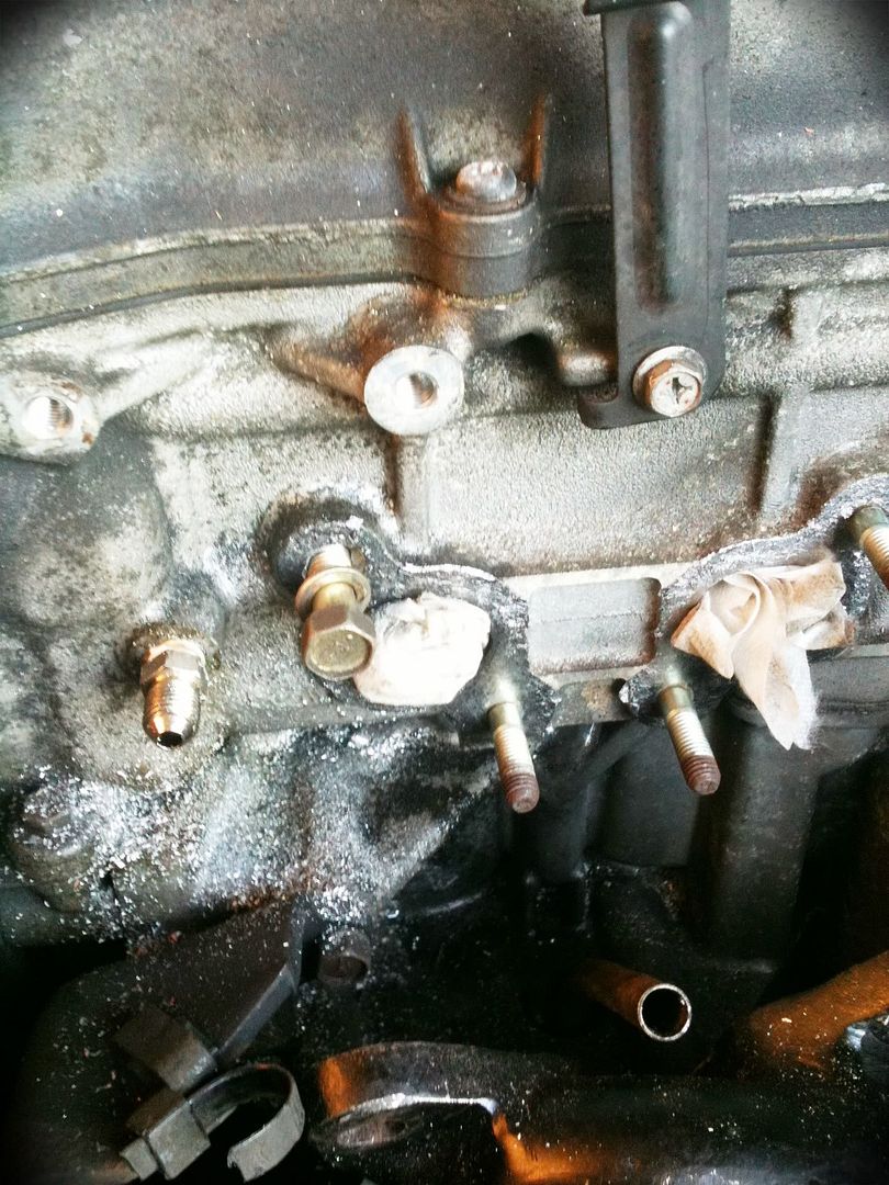

snapped the very top left manifold stud, peed off as it was all going so well too :down:
then to top things off i could not get the damn oil feed nut out and have rounded it try so flipping much :down:
so annoying because things like this are so easy as ive done them time and time again!!
will be removing sump when i can to fit turbo return fitting but need to sort these pita out aswell
what are my options here, is it drill and re tap both holes? i started the car and squirted soapy liquid on the gasket and its bubbling so will have to be fixed properly, its snapped off inside the head so cant get to it to take out
ed/noddie do you still have the tap also what size drill bit please, need some advice please guys

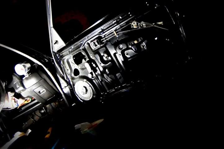

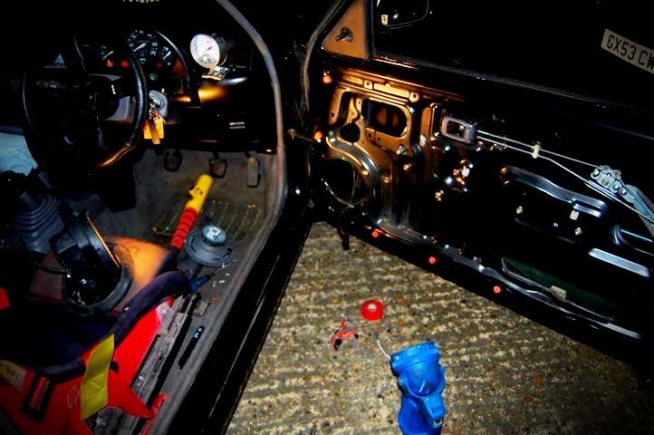

fitted front fli speakers, instant win in sound, stock units are pants really
also keeping the door cards off aswell and will be stripping the rear too, just not everything:p

ive got one shot at getting it drilled and tapped properly or ill be requiring a new head :eek:
does anyone know thread size of manifold studs so i can get the right tap, cheers
Nice not to have to paint all the inside metal black again Mart innit...
What exactly will be left in the rear?
Looking forward to photo updates :)
True, just needed a wipe :) driver side had no glue or traces of any but passenger full if it!! Def keeping front carpet and roof lining think every thing else will go
Any ideas on the oil feed grub screw?
the grub screws usually abit tight and covered in muck. thought the allen head didn't have enough leverage for the screw thread and would easily round off so instead i cleaned the threaded edge of the grub screw sticking out with dremel wirebrush and used this screw&bolt extractor to grip onto the edge and with some gentle patience it loosened off

Cheers all, problem is the outside thread is chewed thanks to a not so successful set of mole grips :(
Will the impact gun still work even though the Alan key hole is slightly rounded?

Scared to drill the head you know :(
hate using stud extractors cos the small ones feel like they're are bout to snap the big ones just wedge the seized screw tighter and at that point id rather just carefully drill it out and re-tap.
Re-tapping can lead to a weak thread though if you dont get the tap and the original thread lined up.
If you do use stud exstractor dont buy a cheap one!! get one that has less chance of snapping as if it does snap you are in a world of trouble (new head time)
Mate heat it up and use a big flathead screwdriver. Use the screwdriver and a hammer to make slots to turn it. Or try a drill bit A couple mm smaller and then break the rest out?

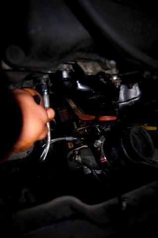

Ok thought I'd have a go now on the oil feed screw, used extractor number 3, drilled it wound it in and bang she loosened!! Well chuffed! Cleaned thread , ptfe tape on the 1/8 npt fitting and in she went
Cool as, I thought!!

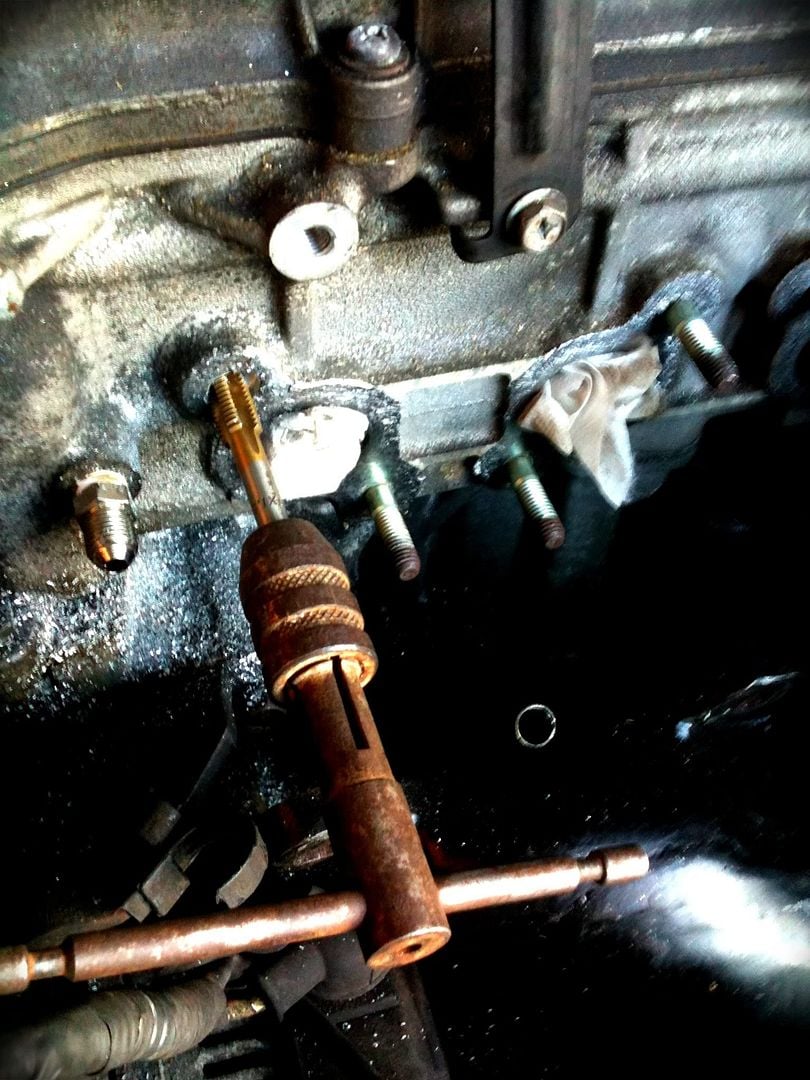

So then I thought I'd tackle the manifold stud
Went wrong and it won't grip the extractor
The thread only needs to go in about half inch so here's my big question
If the studs are m8 I need an m10 drill and tap
I need to know the size please
I will use an m10 bolt and may have to slightly over drill the manifold hole
Please please someone know the answer ??
Thanking you Frank :) do you know if the stud hole goes right into the block or is it just drilled and tapped in factory?

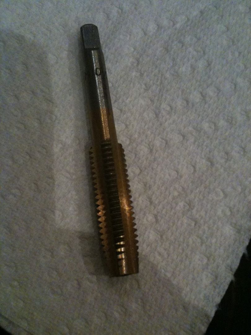

Borrow my friends m10 tap so I just need the 8.5mm drill bit right Frank?
I'm a cock :down:
But one out of two ain't bad, my plan is to use a small m10 bolt with maybe 1 or 2 washers to take up the space
Cheers for the help as usual mate :)
You should be called the fraynes manual in replacement of Haynes !!lol
lol martin :laugh:
if its one of the 8 head to mani studs then an m10 will be fine eh (i,ve had to do exactly the same to our karts exhaust studs)
Got my 8.5mm hss bit today fro machine mart at £1.50 which was good
Drilled some more of the funked old stud out and straight in with the 8.5!
It went though the old stud and voila a 8.5 mm hole perfect
Tapped it with this And some threading oil
In she went :)

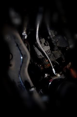

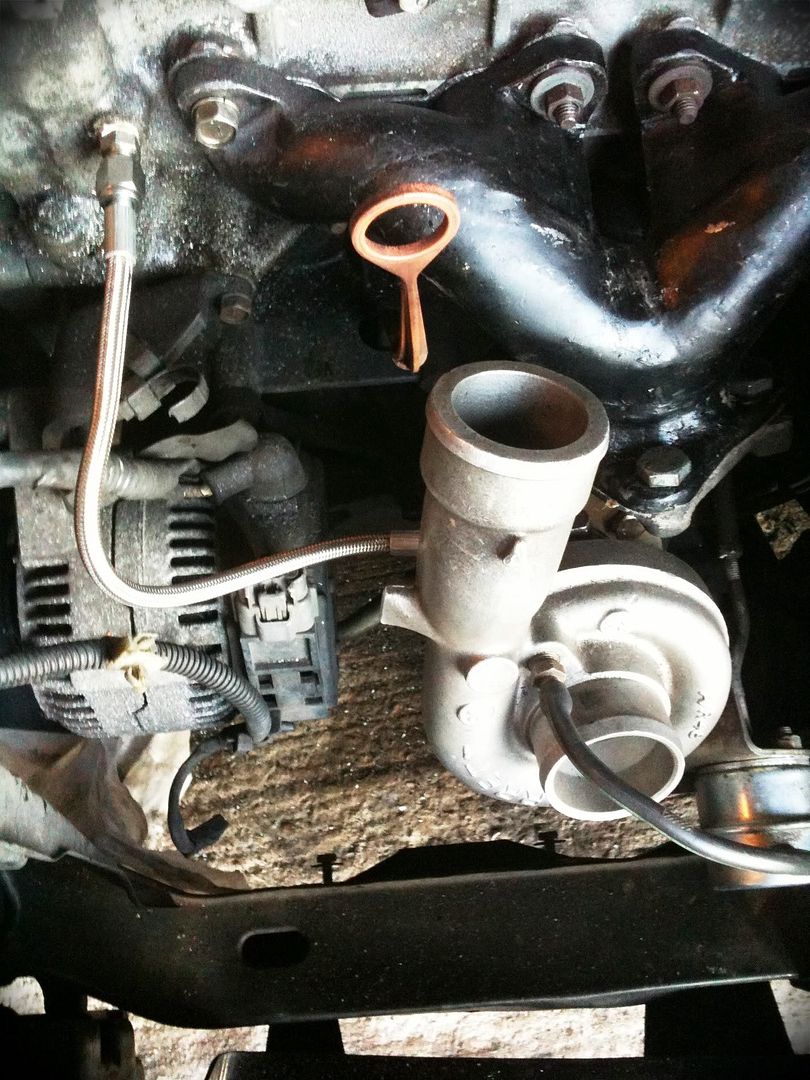

Manifold back on :)

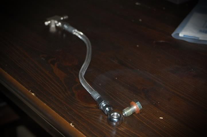

Turbo oil feed back on :)

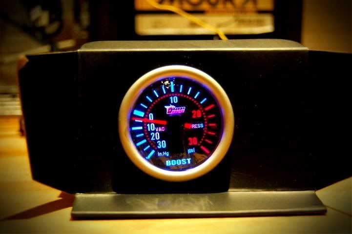

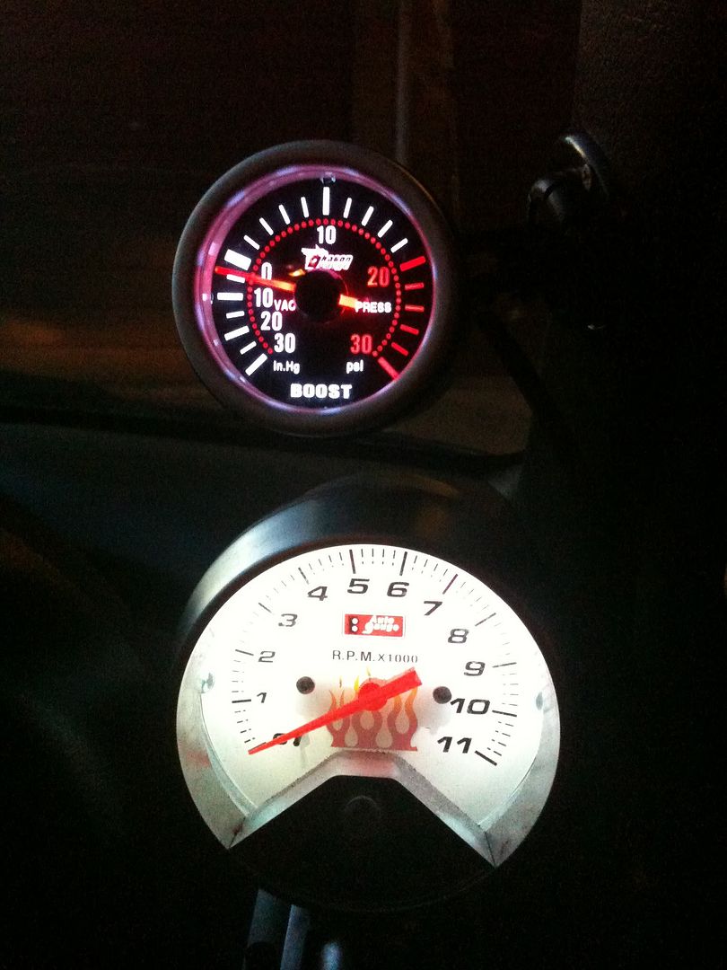

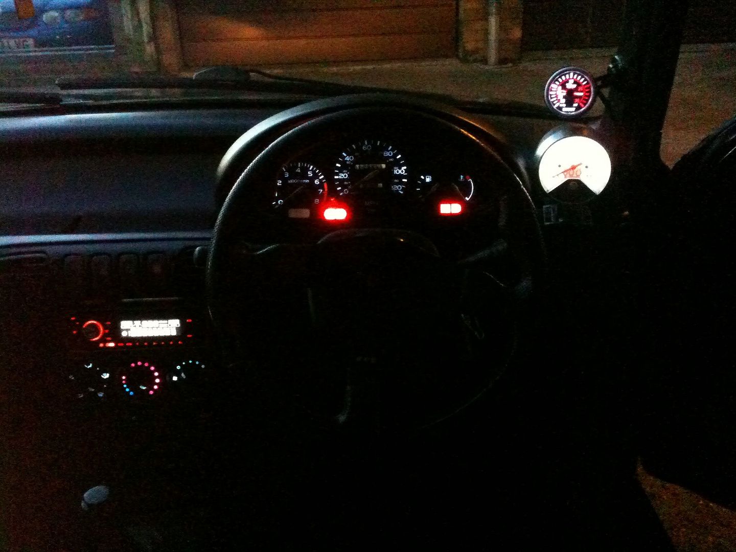

Boost gauge holder
Boost gauge fitted
A closer look
And what she sounds like!!
The return isn't connected for the sump but i wanted to see the oil come through the turbo
Enjoy :)
