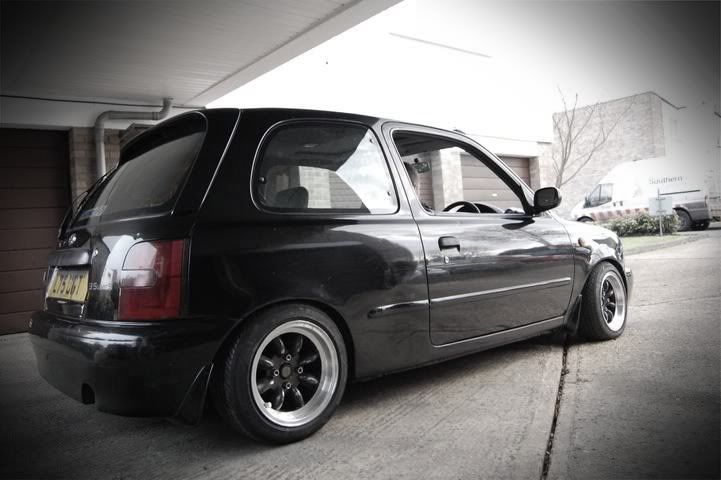

Martboy21s new Black Super s
looks ace mate!!!
Well actually the same as the vision i had in my head for mine looks wise!! lol
I will have some differences that will make it my own tho but nice to see one done in the style i like!
I need 13s and coilovers now!!!! hehe
Cheers guys :)

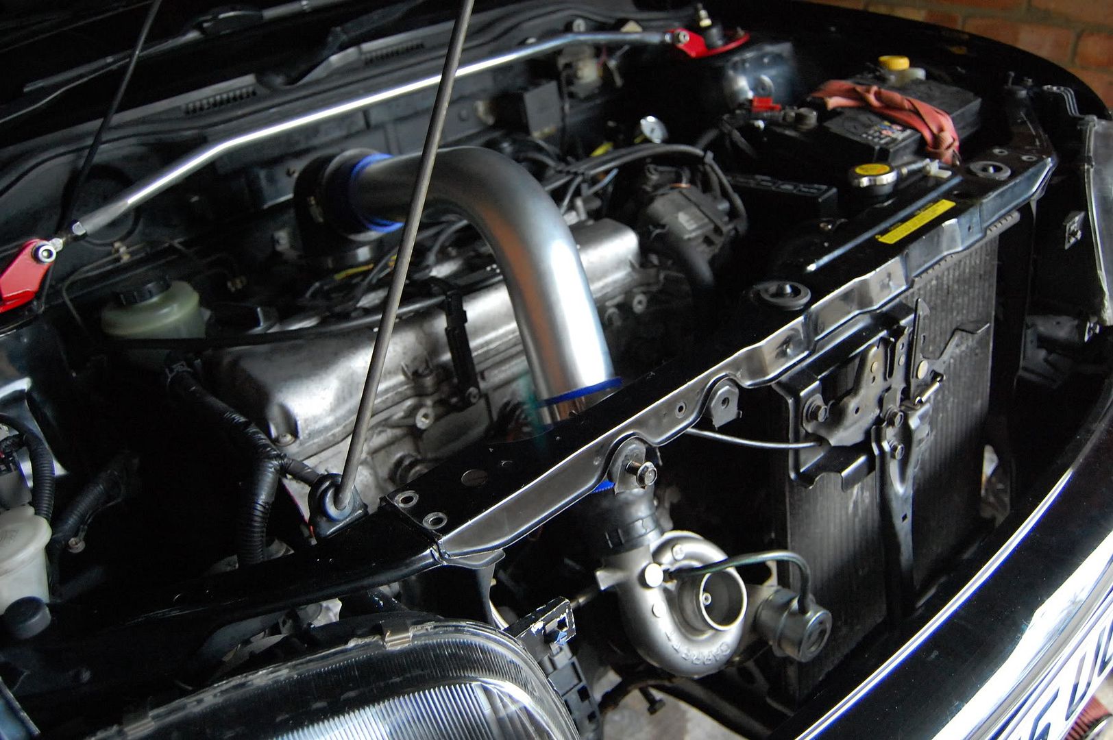

i had had enough and took all turbo associated parts off that night and went about fitting the stock manifold and downpipe back on
My theory was, if it ran fine then theres something wrong with the turbo or setup i had albeit it wasnt actually connected to the throttle body and wasnt running any boost at all!?
noddie had noticed a blow in the downpipe and my lamba which is after this would have caused the readings on the lamba to be different as exhuast gases were escaping through the blow
so after connecting stock manifold and downpipe with original lamba sensor she still runs bad!! ive checked everything and the only thing i can think of is the fuel

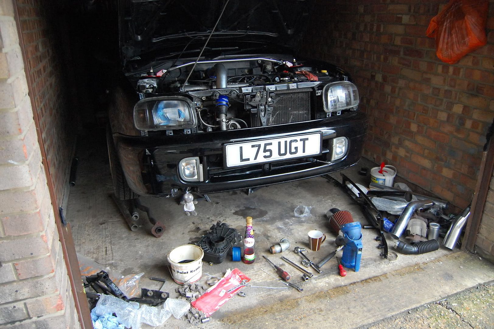

Fitted downpipe today, hooked everything back up
Still runnin like poo :(
Removed plugs 1 and 4
1 was wet and black
4 was DRY and black
With engine running and removed injector 1 clip ( nearest oil cap )
Engine started to drop revs
Same with injector 2
However I removed injector 3 and 4 and no change to engine
It even starts with them unplugged ???
I'm guessing you Right stani?
Set about removing the last injector, no chance!! Got the metal holding ring off perfectly, but couldn't get injector out?
It twists but won't pull out, had mole grips on it as well.... Any ideas
