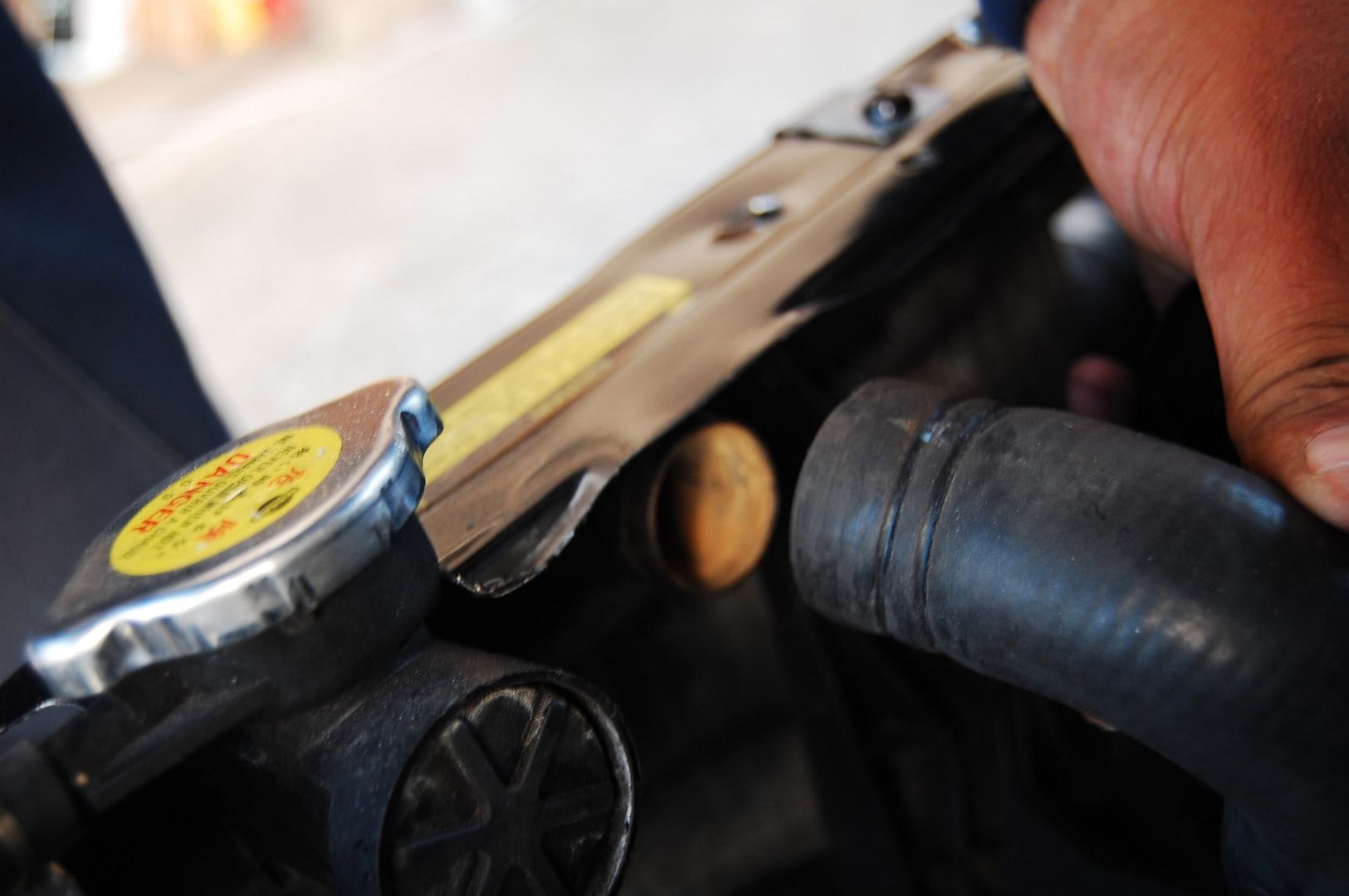

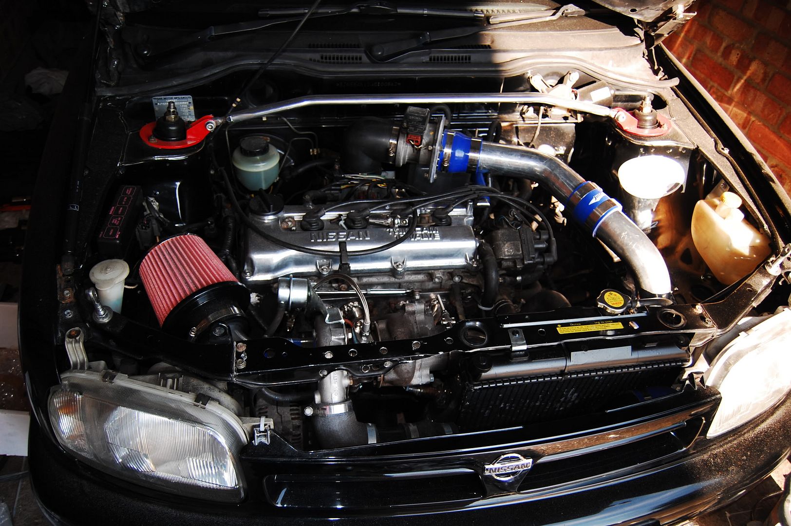

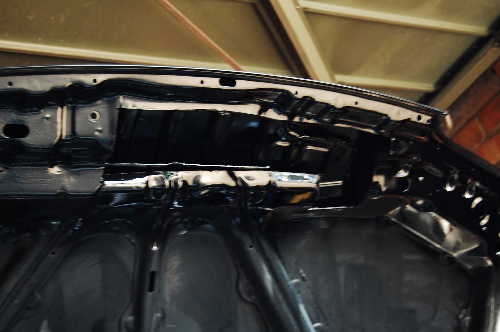

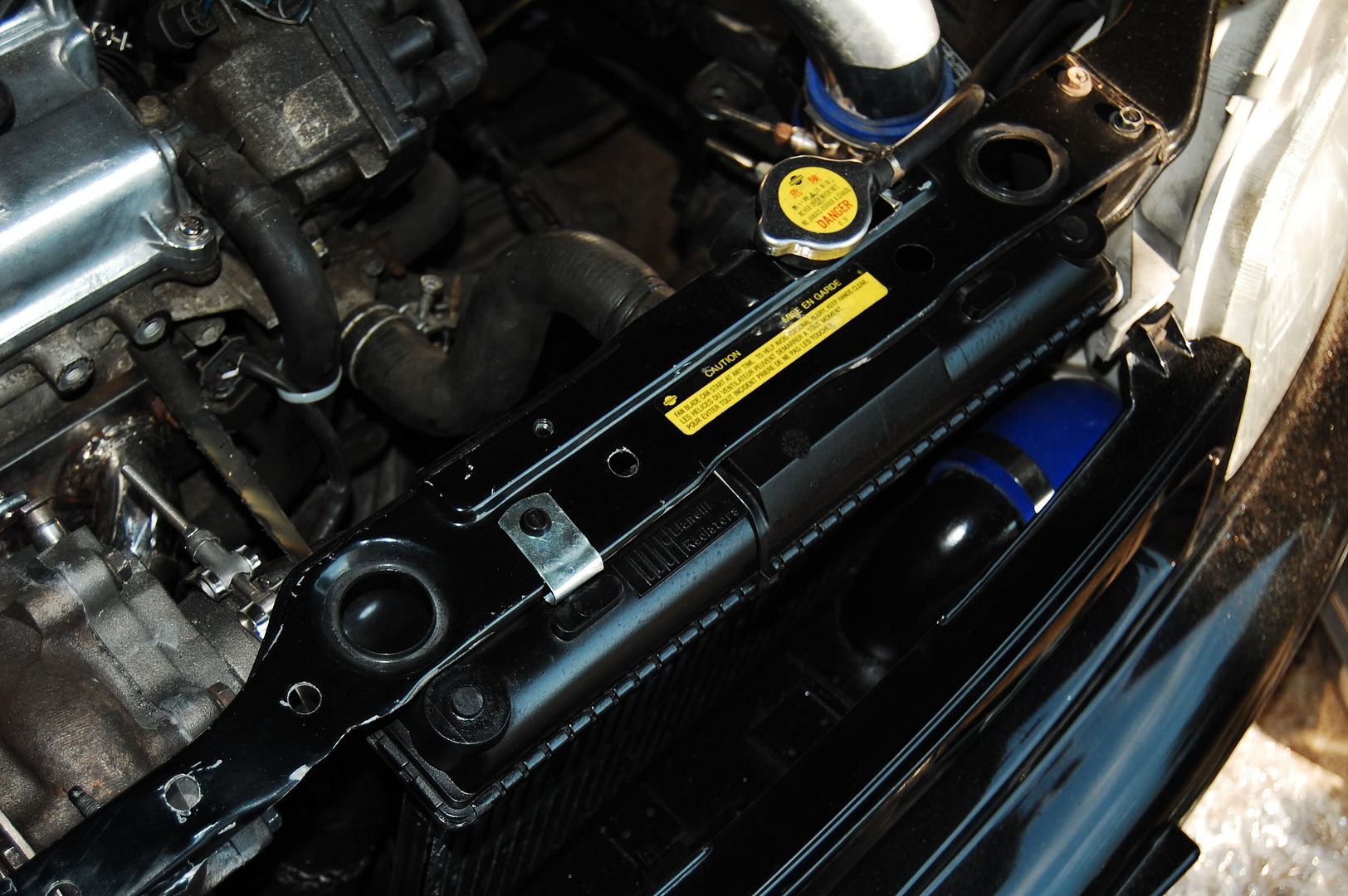

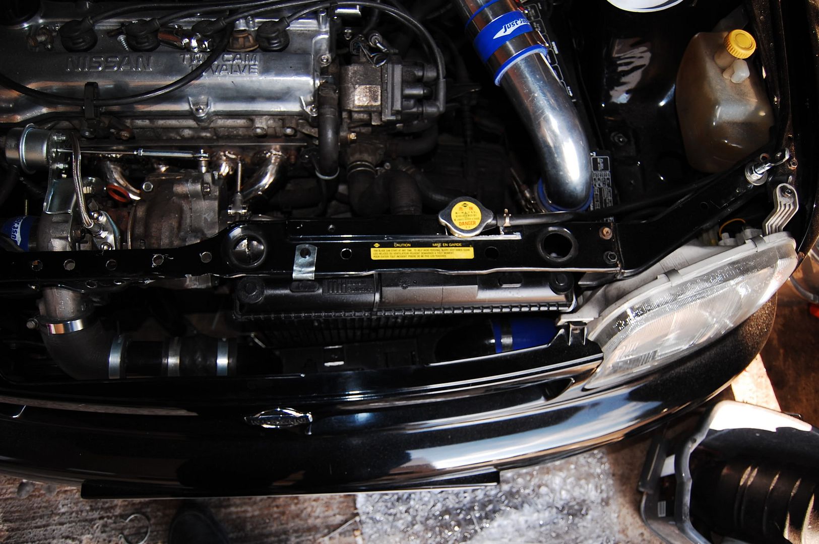

As some of you may know i was struggling with the radiator hitting the downpipe and turbo elbow
determined to not spend a single penny i used what i had to make it fit
have had to cut slampanel off, lock and everything, had to cut a slot out of my bonnet (inside only!)
final position

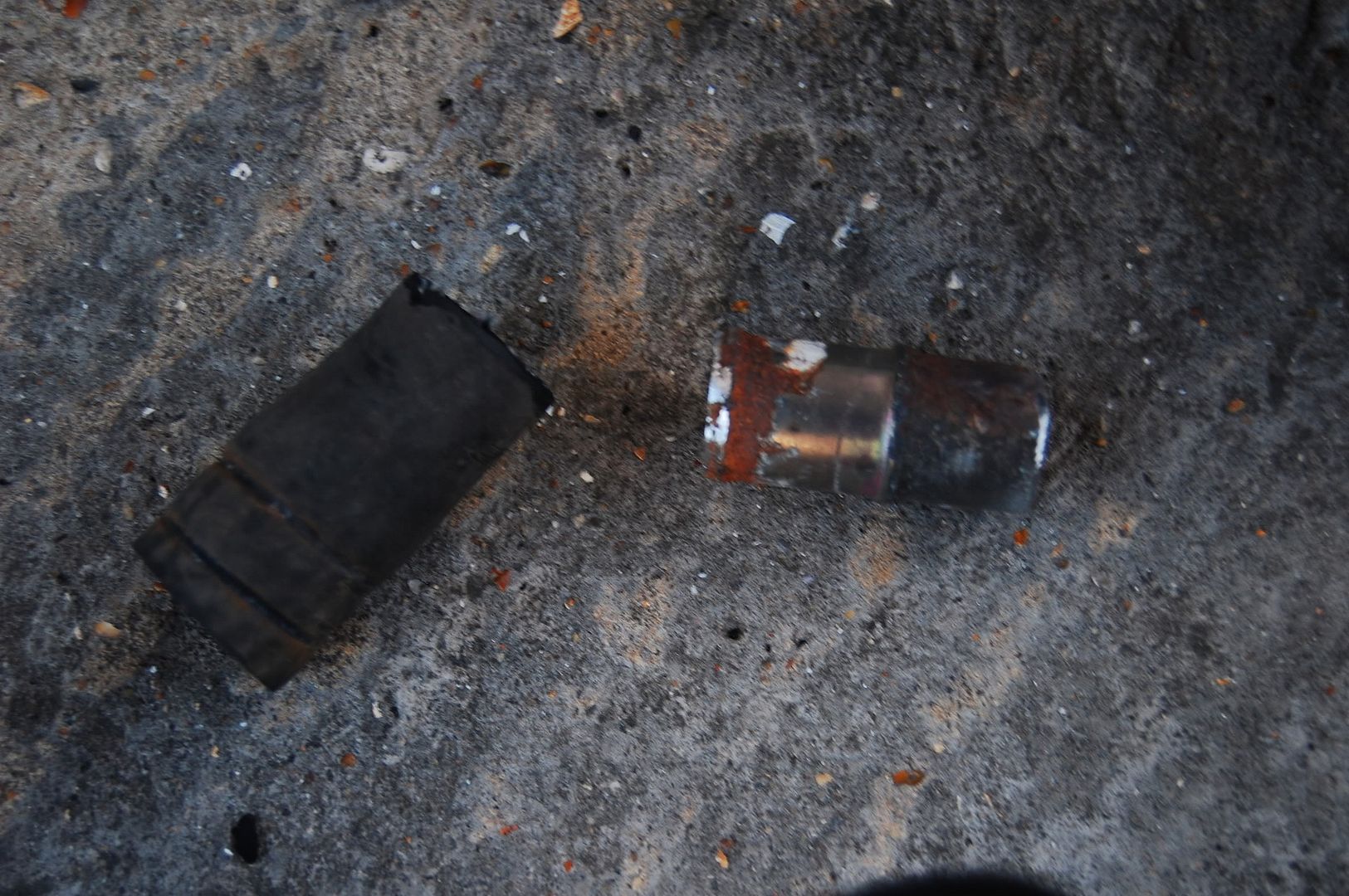

had to make an extention to the hose, out comes the spare parts box ;)
cut these to size
just got to scavenge some clips from somewhere
all finished

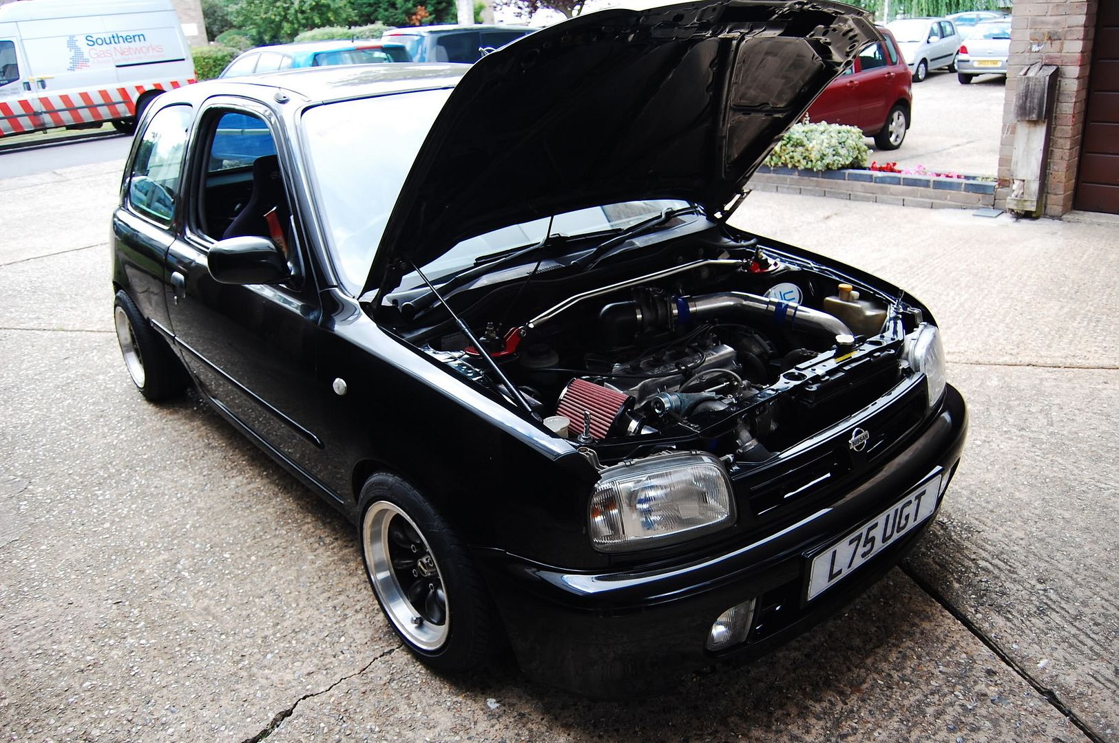

front end done, grill fits all fine too
ready for action

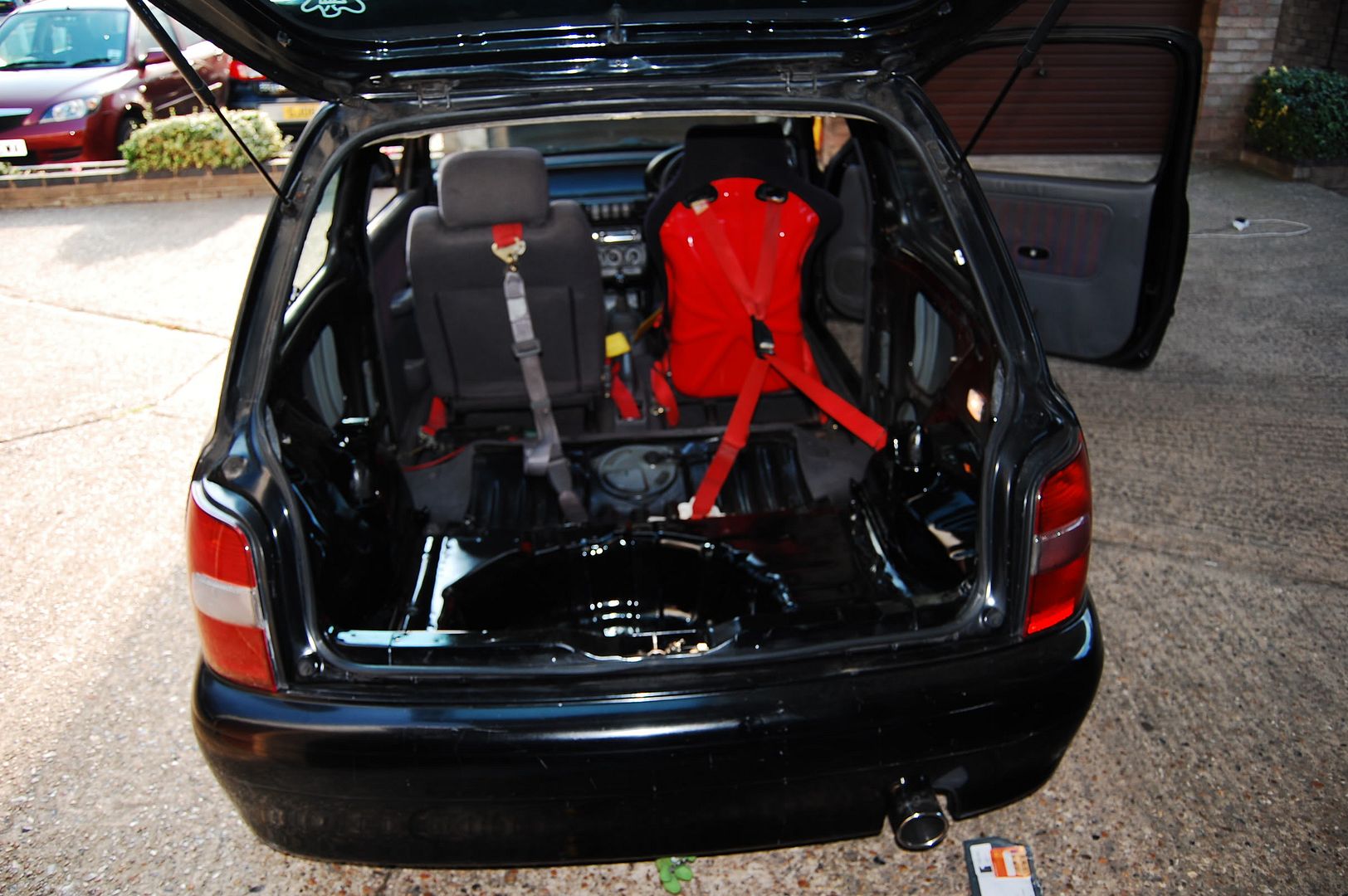

rear is completely stripped out
no more exhaust hanging down, well chuffed and the lowest point is the chassis rails :)
so thats it, turbo conversion finished

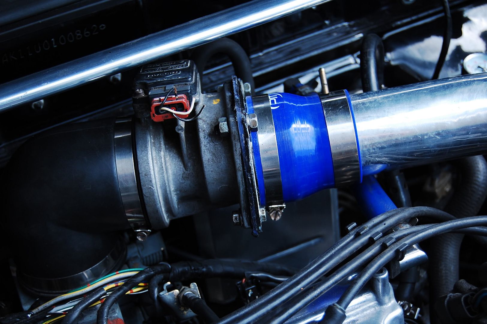

wow that is one sweet little k11 mate (Y) what is your maf off mate? does it plug into the standard loom?
Cheers mate :) mines off an s14 200sx with the sr20 turbo engine
No you have to get the loom from the same car, well the plug actually and make a connector like polly p did :)
sweet just a thought cause im tempted to go down the k11 route just for a while. i just wondered about the maf cause when i turbo'd my sunny it coughed and spluttered at high revs it was a ga14 but i always thought it was the maf that caused it as it was like the cg and was sat in the throttle body. i never had it long enough to change it to find out. i was going to move it to the intake side of the blower. but no idea if it would of made any difference as im not the best when it comes to tuning lol im still learning as im going.
I believe Ed from fusion suggests having it as a blow through maf, works best apparently
I have mine like this as the stock ones over run at around 10 psi
For a lower boost setup it may not be vital mate :)

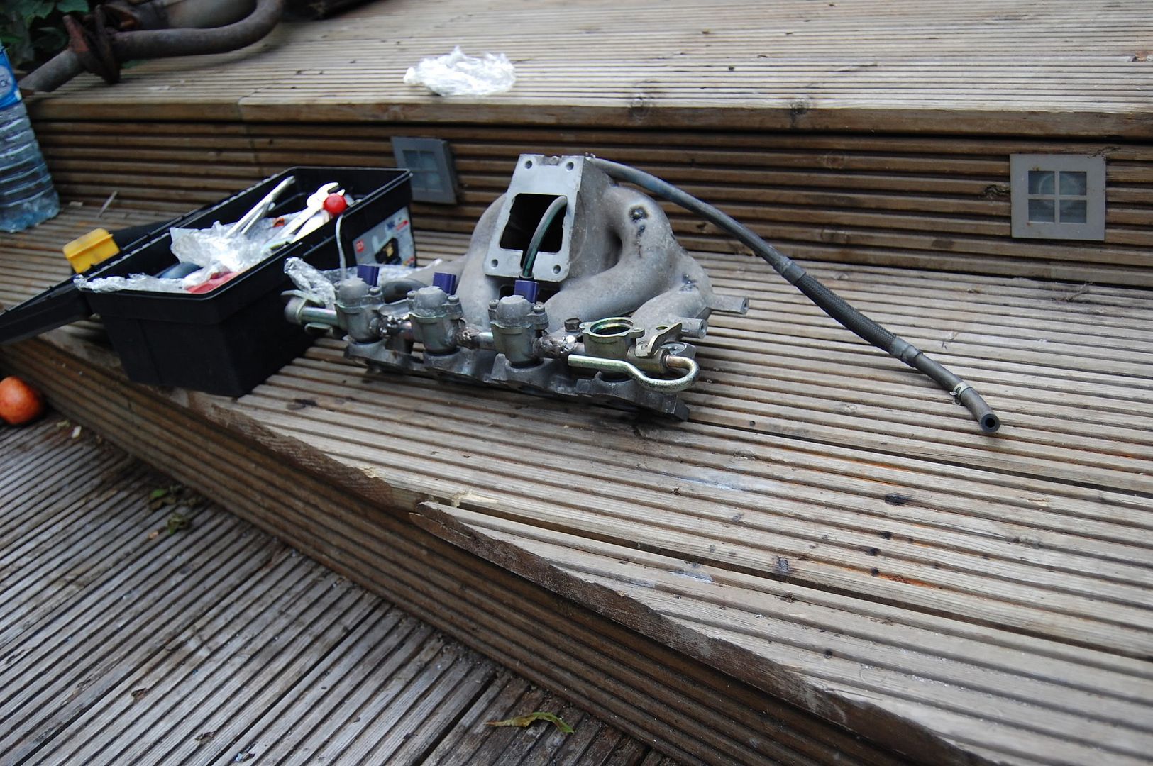

Keeping in the flow of turbo parts one of the biggest problems I'm having is my fuel rail
I was given ages ago some 370cc injectors from and s14 sr20 with about 41k on I believe
They've been in the garage for sometime there just sitting on the shelf doing nothing
I was toying with franks idea of top feed fuel rail and turning the tb 180 for clearance
Problem is I have to buy the rail, stock injectors, redrill the inlet manifold and buy Volvo t5 injectors, all of which cost money I don't have .....

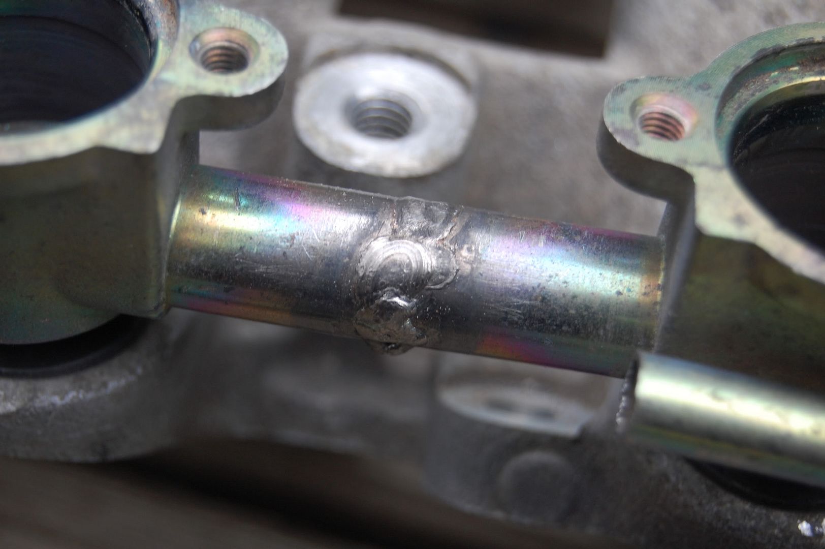

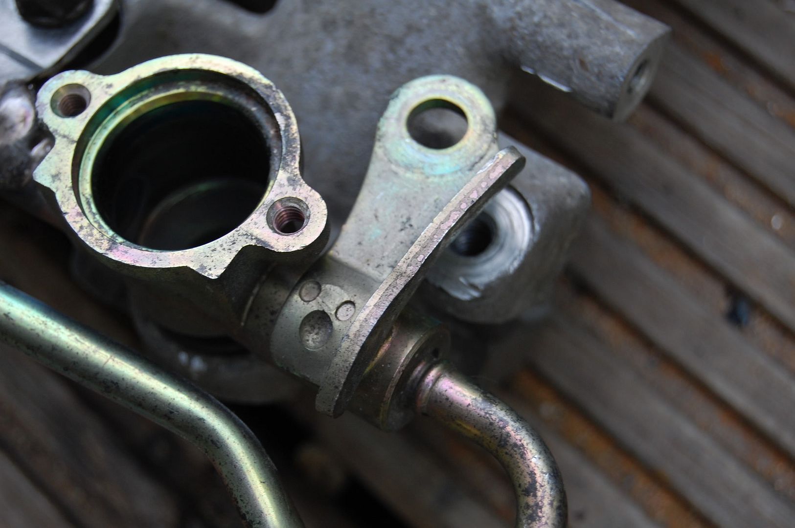

Soooo, with some inspiration from stanis blog I thought I'd have a go! Armed with a tape measure and hacksaw I set of to work!!
Here is what I started with
The two fuel rails
Cg13 and sr20
I started by removing injectors and fpr and made some measurements
Cg13 spacing 79mm
Sr20 spacing 97mm
97- 79 =
Chop chop
First set done
Second cut made, will have to remove all this excess metal with dremel etc
Fitted up
Last 18mm cut to be made
Also found some 1.6mm brazing rods which I believe will weld the rail
Total cost so far on weekend work and fuel rail... Sweet FA ;)

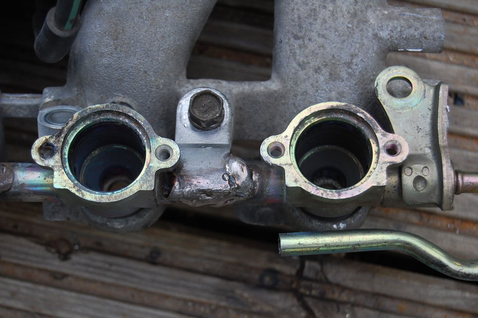

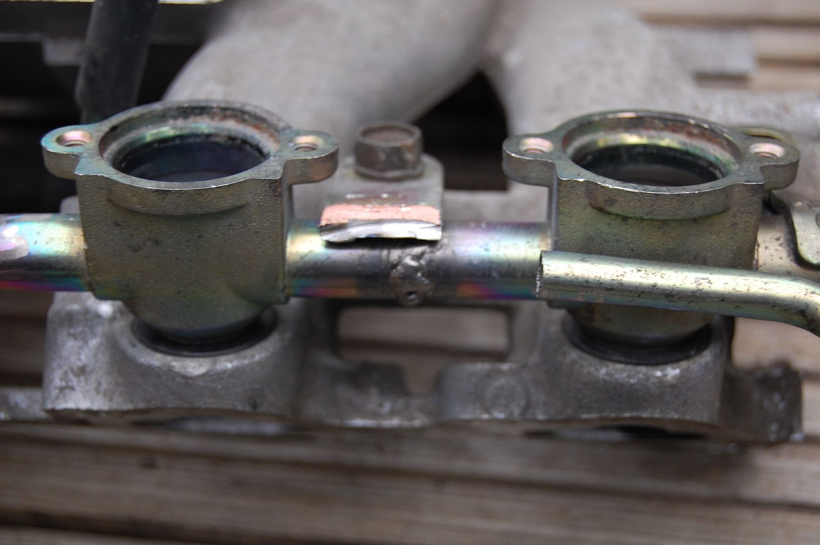

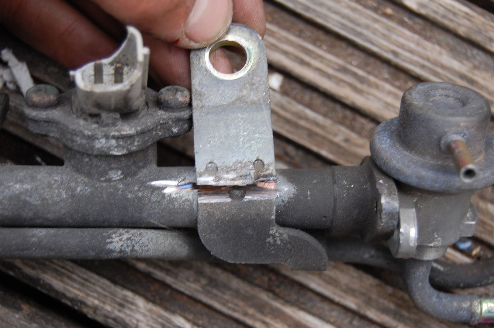

Started on my fuel rail today,
Really getting the hang of my mma inverter welder now :)
Cut the bracket of the original rail
Bolted into place
Welded the rest up
Pic of mount welded
Last mount to cut and weld up
Almost finished!! Will probably have a few pin hole leaks but I'll go back over after if need be

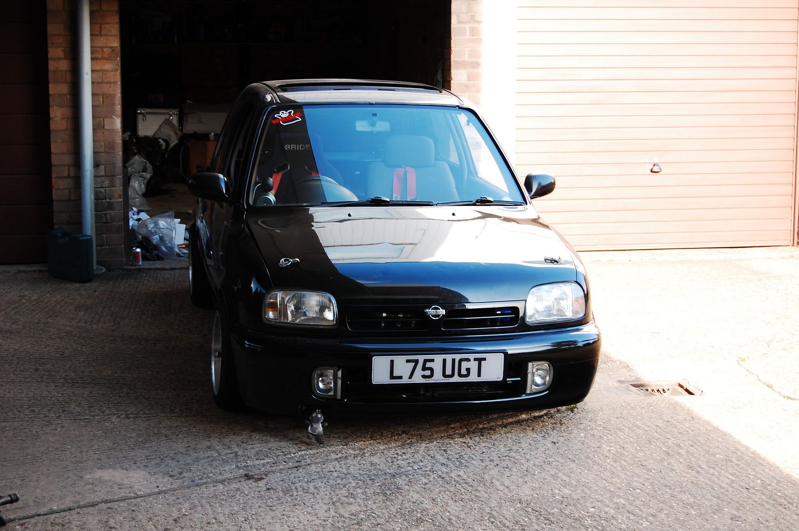

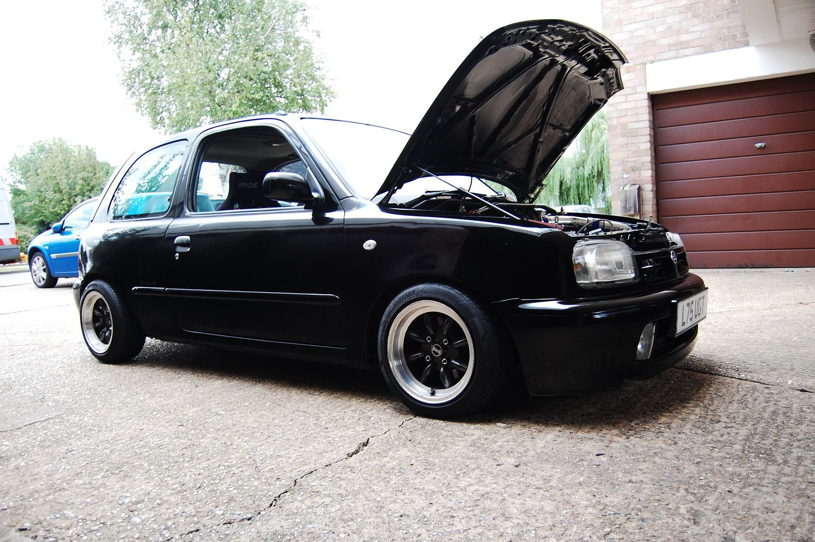

No exhaust anywhere lower than the chassis , well chuffed about that as I can go over speedbumps (just!) with less hassle
And a pic of the mods to bonnet I had to do to allow it to close where I had moved radiator forward
are you using the small plastic rings that space the fuel rail correctly?
Yeah mate you have to bolt the bracket on and then weld it into position whilst making sure it will clamp down far enough when tight, it's quiet tricky also as it can blow holes very easily
Should work though ;)

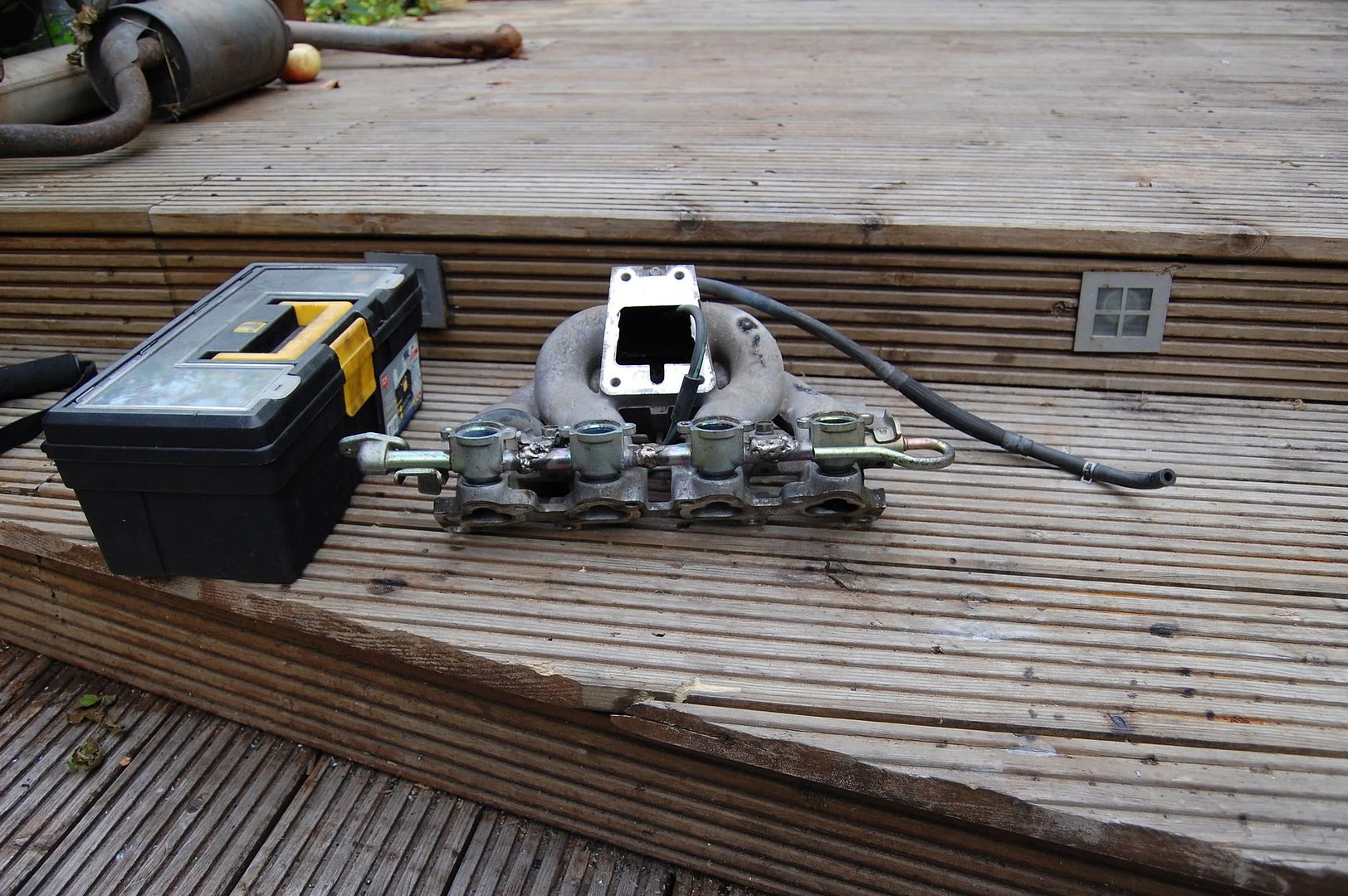

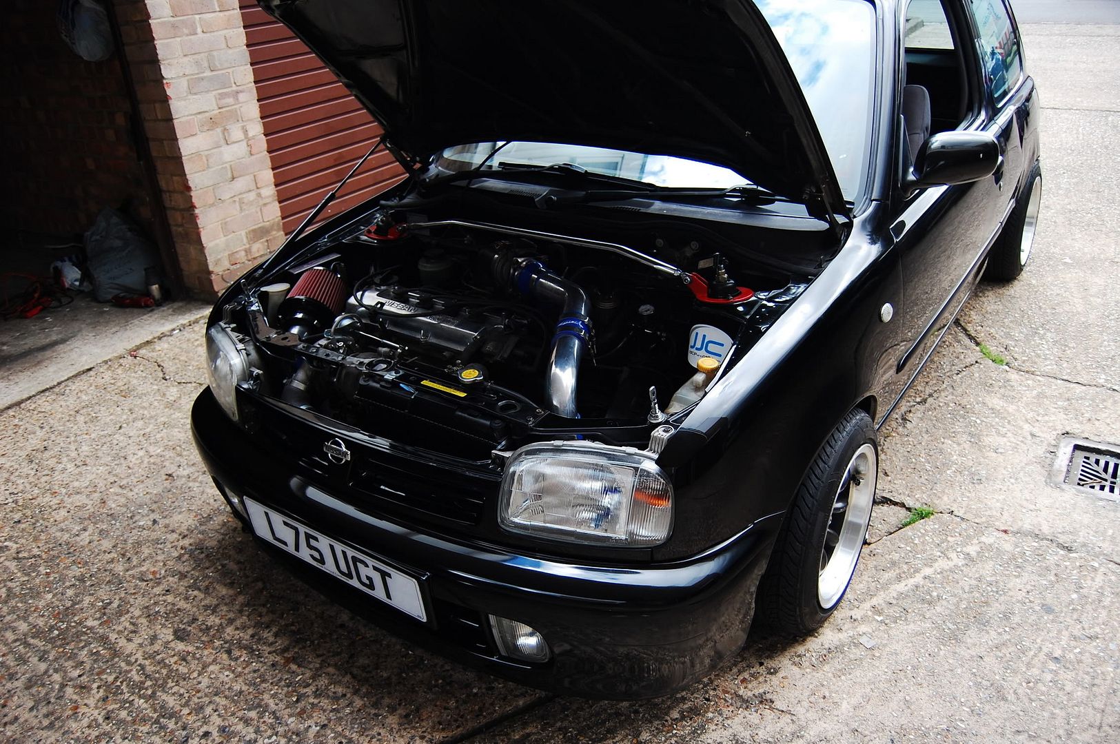

Finished the turbo conversion today :)

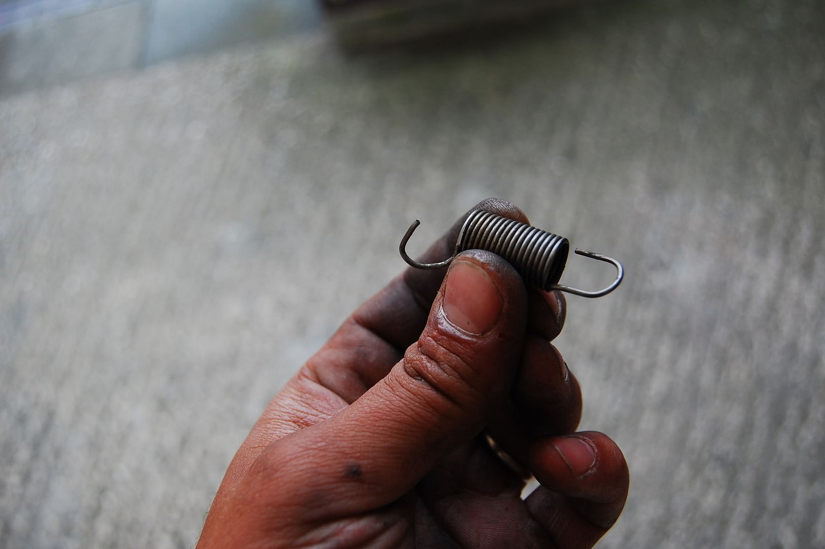

Also found out why my gear shift felt cack , spring had snapped
Removed all the heat shielding aswell, can't stand the stuff!!
Re bent the next coil inline and refitted it, feels so much better!
Siliconed the air flow adapter gasket
Few more pics
Also started and let it warm up, all good
im sure youll find out when u have fuel spirting out at high pressure!
