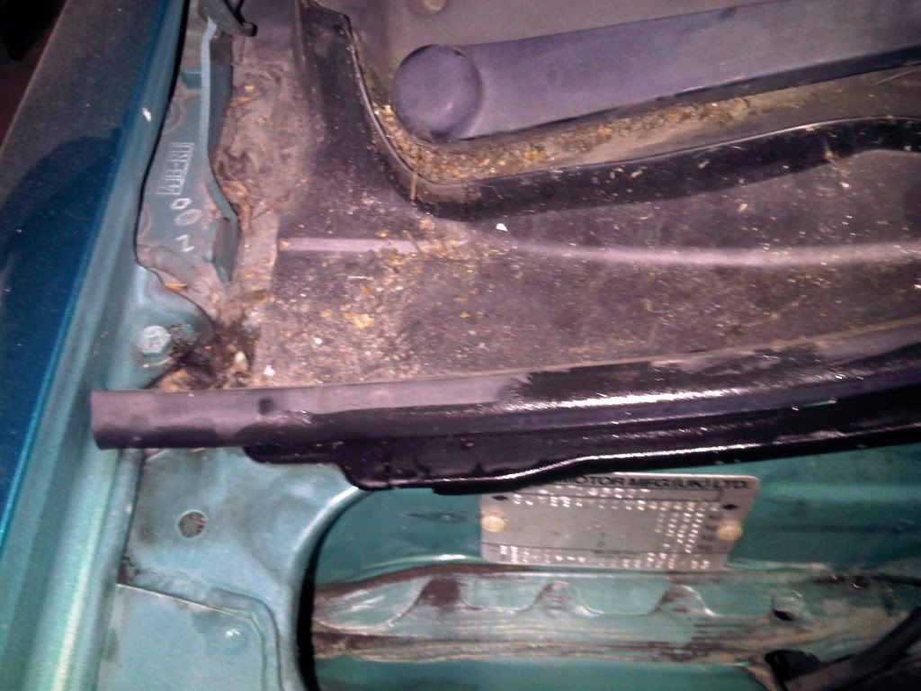

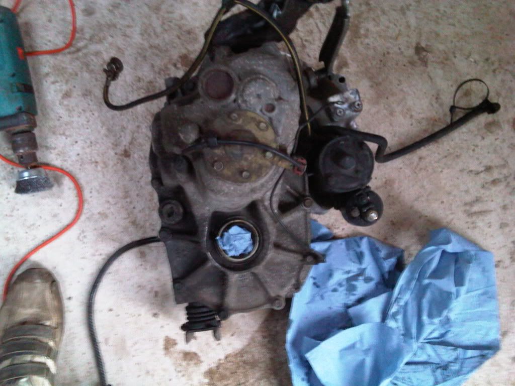

Hey again, things have been slow again the last month or so due to work commitments. However the last week Ive managed to get my ass into gear.

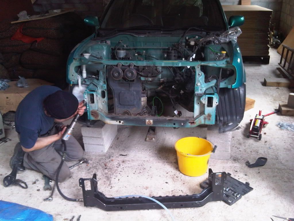

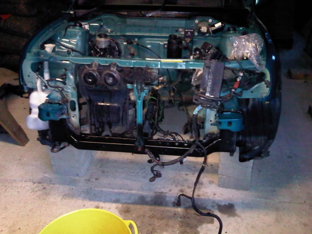

Firstly new crossmember got fitted, big thanks go to Ariel for his super service! Did a great job fair play. All thats needed now is some underseal.

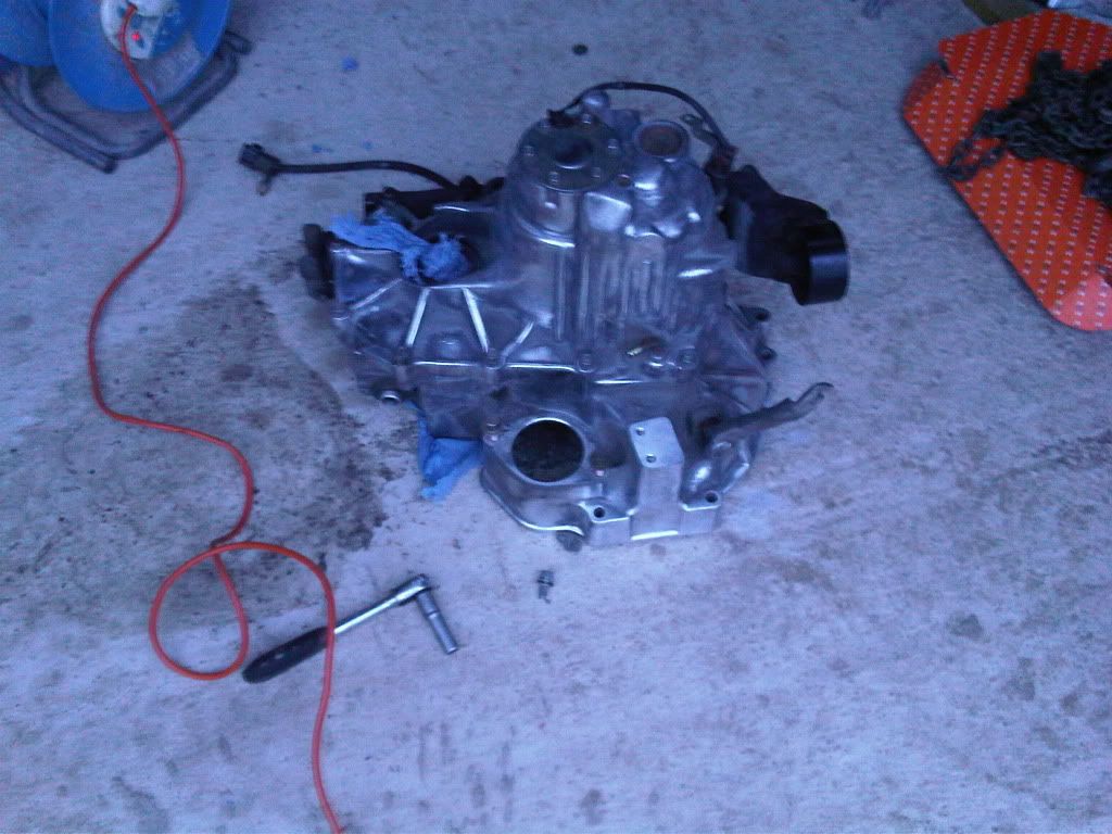

Secondly finished cleaning up the gearbox , looks nice and shiny again now, re-painted the clutch lever and also did all the engine clips that hold the wiring looms in place whilst I was at it.
Gave the engine block a good wire brushing aswell. Overall im very happy with how its all come out. Need to de-grease the engine at least once more before it go's back in though.

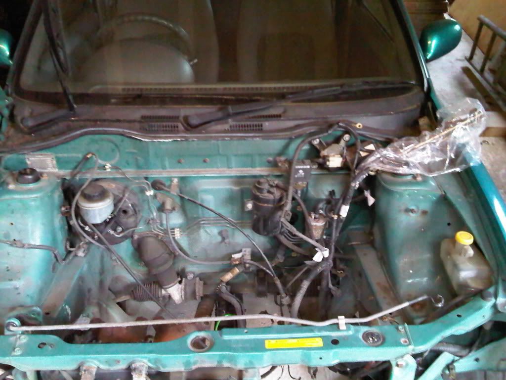

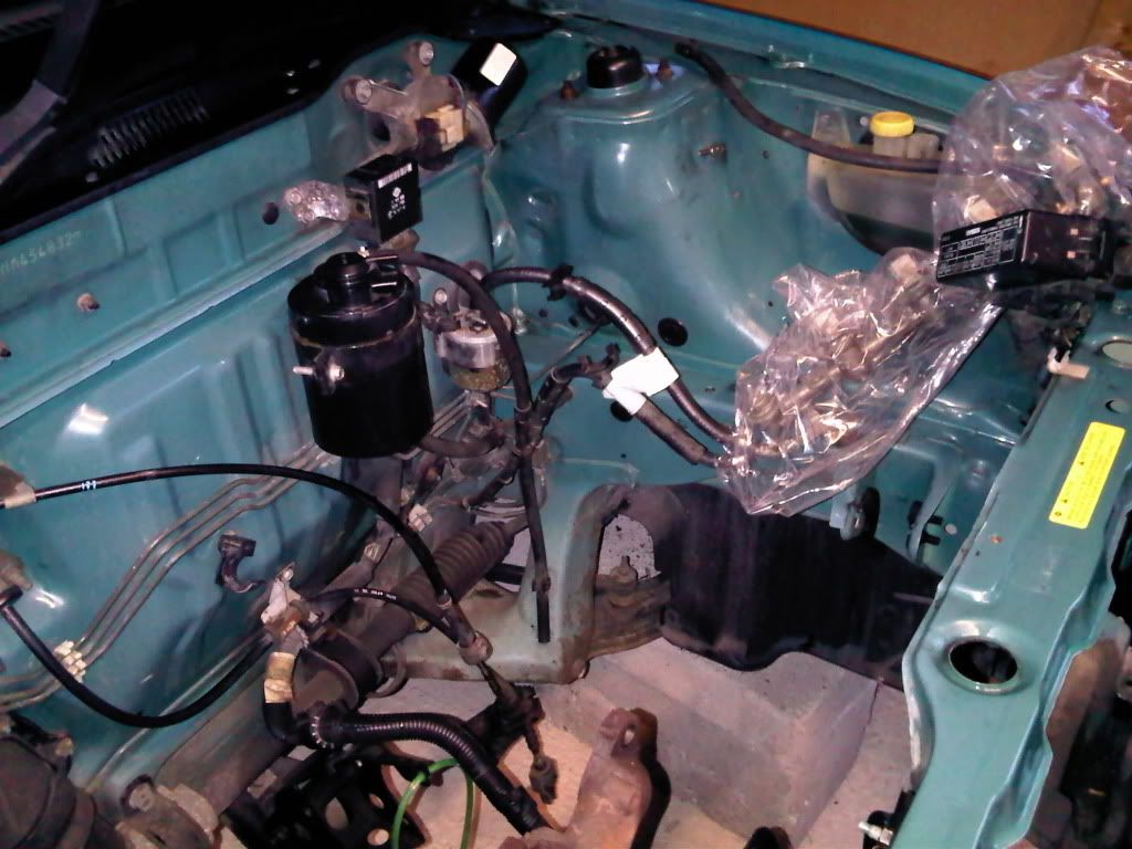

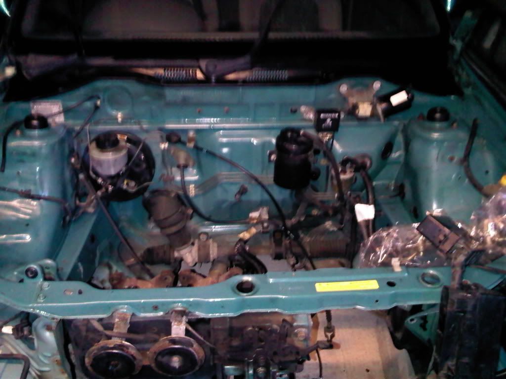

Tonight I went gung-ho on the engine bay, got rid of all that nasty cack thats gathered up in there over the years. Feels like Ive made progress now which is always good. Waiting on some new six point sockets to remove the flywheel now. Decided to go down the cheaper root of getting it skimmed instead of forcking out on a JUN Lightened model. Also popping to Telford to get the rocker cover painted up at 'Innovation Bodyworx' on Saturday, so with any luck next week we might finally have another living Micra! :D
Before:
After:
How she stands at the moe:

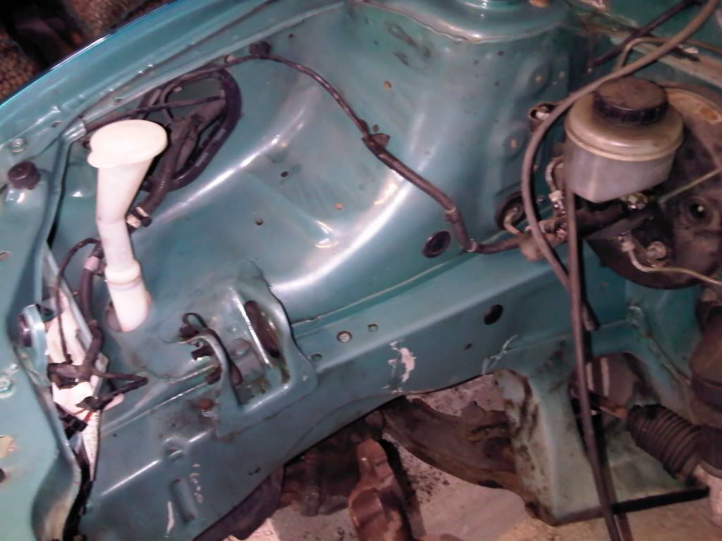

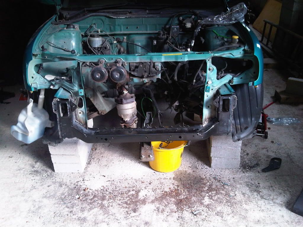

Quick update:
All the new welds are now sealed.
Finished cleaning all the components (apart from I got lazy and havent bothered with the alternator).
Flywheel arrives tomorrow with any luck. Big thank you to Scott for taking time out to do it for me.
New HT leads are on order - 7mm Magnecor, along with some cv boots. Giving the silicone hoses a miss for now, with any luck Ed will get my stock ones back to me some point within the next two weeks, I'll probably grab a set from the breakers before then.
Now I just have to jog my memory and remember how to put everything back together :eek:

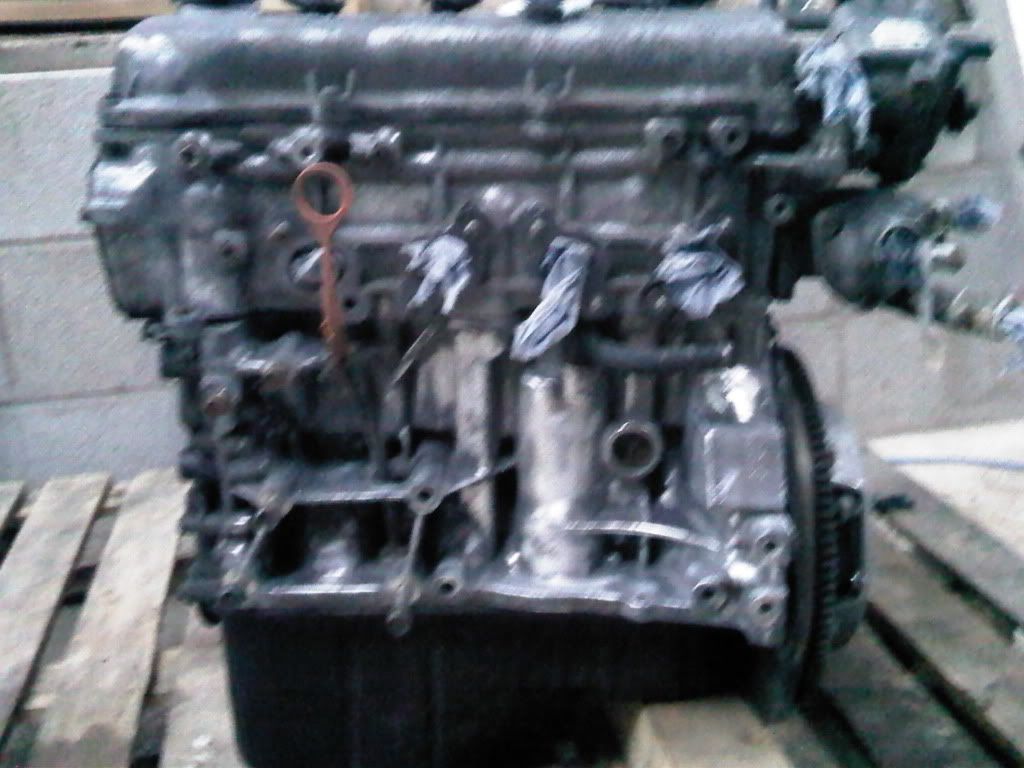

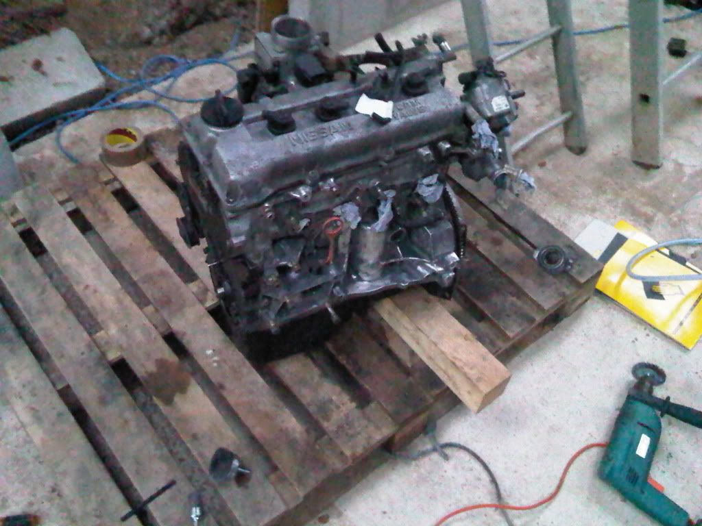

Managed to get some work done tonight.
Flywheels all fitted, just over 4KG (4.06) (thanks again to Sleeper_SS for skimming it)
Everything re-sealed and fitted, just about ready to go in now
Finally sold my old springs aswell just waiting on the final price of the coilovers! Happy days...
