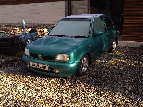

Hey all.
Not had the chance to update recently as all my photos are on my phone and the USB lead has gone walk abouts!:doh: Anywho I finally found out I could load them straight up to flickr of my phone, so heres the TEINS;
When they arrived about 3 weeks ago;
Fronts fitted, desperately need to get some uprated discs:blush:;

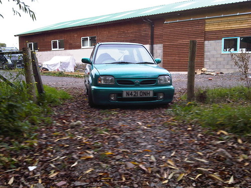

Both fitted. Front fully lowered, rears fully heightened (will adjust soon) sorry about the poop pic;
As she stands at the moe, again apologies for boring picture;
Its unbelievably low now , I cant get over how different the car looks. Only problem is im hugely distracted at work now each time I walk past her :laugh:
