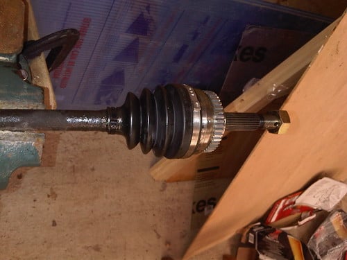

After a hell of a lot of swearing and talking to myself I've finally sorted the new CV joint out. I must have removed the driveshafts from these cars a dozen times now but I still cant do it very quickly:down:
Try'd Franks method of jolting the driveshaft with a Vice grip attached but didnt manage to master it so it was driveshaft out jobby unfortunately.
After a quick drive the knockings dissapeared so thats another problem to tick of my list :D. Boring stuff I know but here's a quick pic.

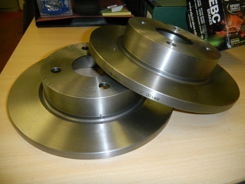

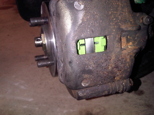

Just ordered a set of Brembo front brakes and EBC Greenstuff pads. I was only going to get the EBC pads to begin with to try and save the pennies but the discs needed replacing. I try'd Euro Car Parts (one of my favourites for cheap parts) but once I sent my order of only £15 for OEM discs I got an e-mail shortly afterwards saying it had been declined (I had the funds:blush:). After this I try'd ringing a fair few times but there was no answer. The only time I did get through I got sent to the Mailbox only to be told it was full.
All a bit strange really so in the end I settled for a pair of mid range Brembo discs of of the bay. (Y)

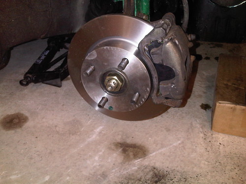

Fitted New Brembo discs and EBC pads tonight. Looks a lot tidier now. Even though the bedding in process is about 200 miles after a quick drive up and down the road it already feels a lot lot more controlled over the stock pads. Worth the extra money so far (Y)

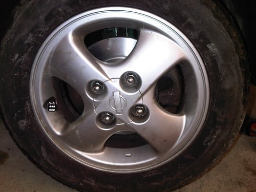

Also thought Id fit my dice whilst I was at it :D
Looks nice (Y) are they just standard micra calipers? sorry if its been mentioned before.
And get a split pin through that driveshaft! :p
Thanks, Yep standards. Dont really want to change the calipers. Im hoping some decent vented discs next will stop me quick enough.
Sharp eyes on the split pin! Im waiting on the right size socket to arrive so I can tighten to the correct torque (its just tightened with an adjustable and a mallet at the moe).
Huuum didnt say anything like that on the information. Looks egzactly like the old one too. Thanks for the heads up (Y)
The difference is the toothed ring around it. there is a pickup sensor that sits just above it on the abs model which sends a signal each time one of the teeth goes past it. not to worry, it will still work on your car:)

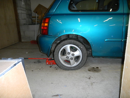

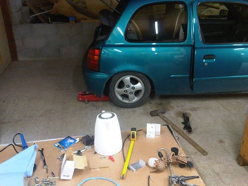

Also took Franks advice on the rear suspension. I removed the spring completely and then lowered the vehicle just to check how much the rear damper would compress to see if it was the spring or the damper that was the cause of the #### poor ride height.
As you can see from the pictures it was the spring causing the problems. Depending on the result of the MoT (and how much Ive got to fork out) I may be giving M.Humphreys a ring this week to sort some 80mm springs out on the rear because Im loving that ride height all night long :laugh:
Before:
After:
