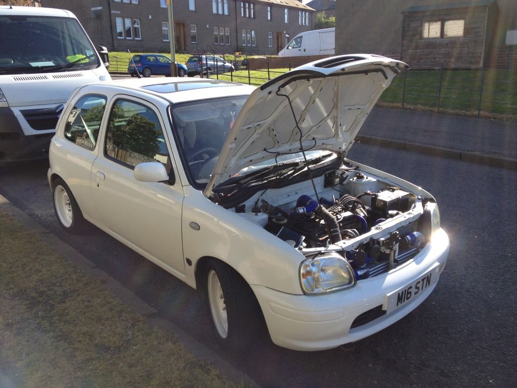

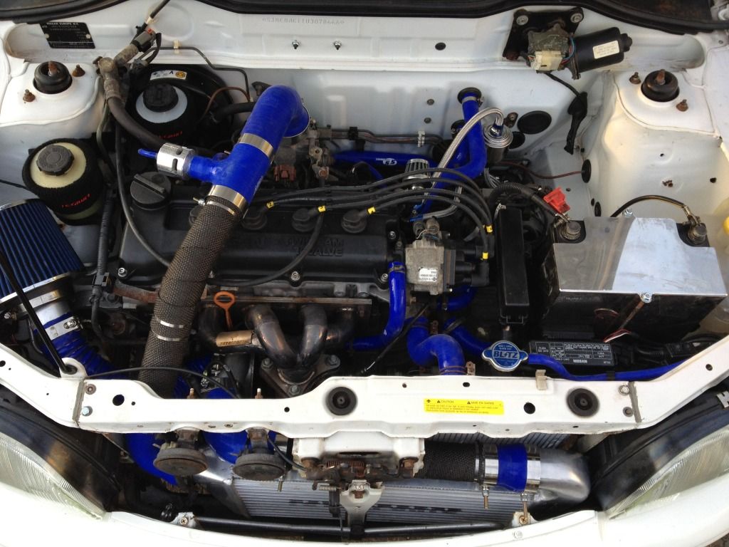

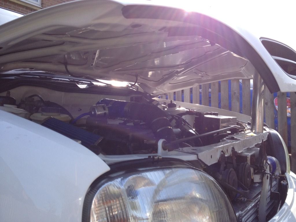

Cleaned the engine bay for crail next sunday as i cant drag it, also a pic of how ill show it off :)

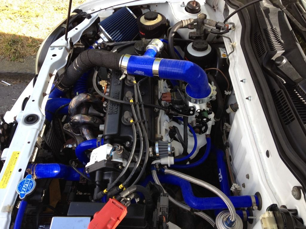

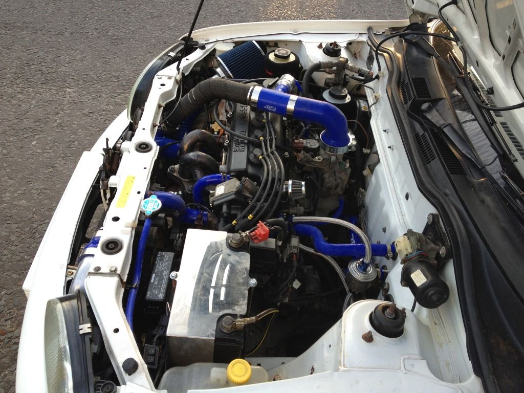

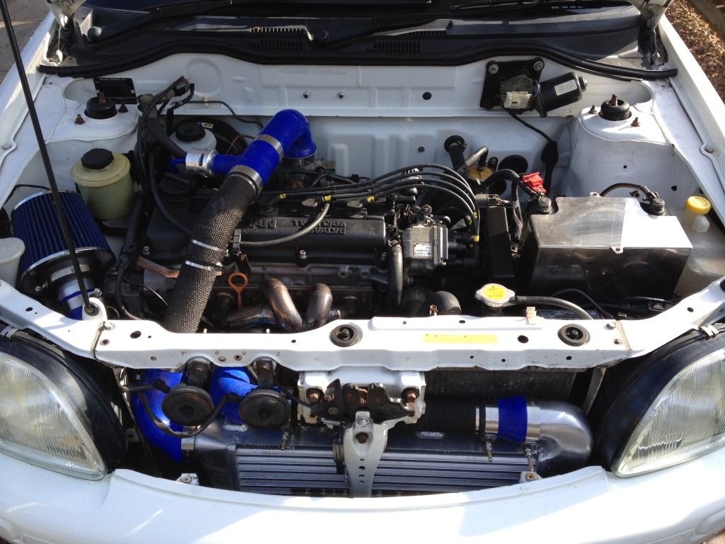

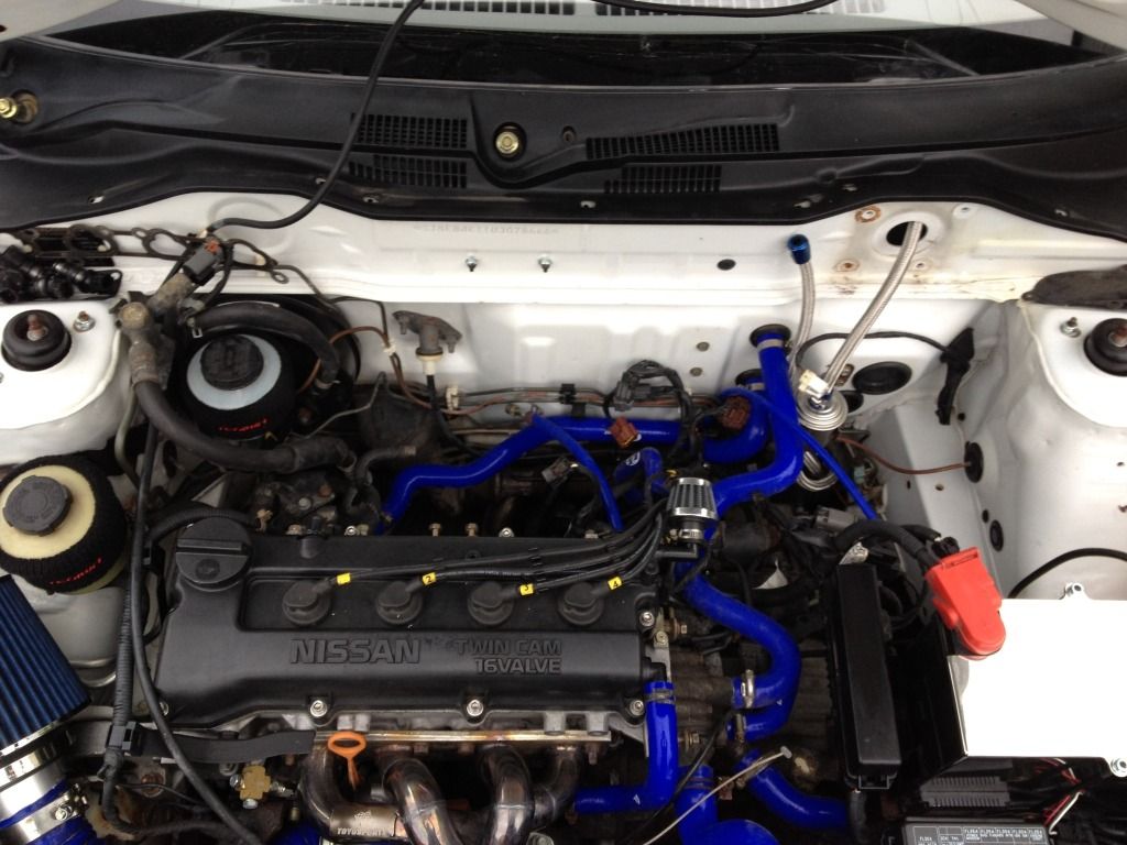

Been tidying up the engine bay again, coolant hose set fitted, new dump valve silicone tee, re-heatwrapped top pipe and adjusted to clear bonnet, newer radiator, braided fuel hoses, tegiwa power steering/brake fluid covers, genuine nissan fuel filter, tidied the wiring up a bit. Still a few more bits to do before crail!
Cheers penyo, i yellow flyeyed them but i dont like it so my minds still not sure yet!

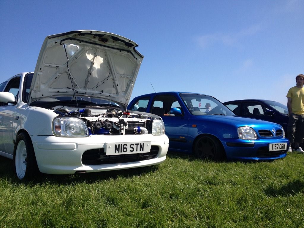

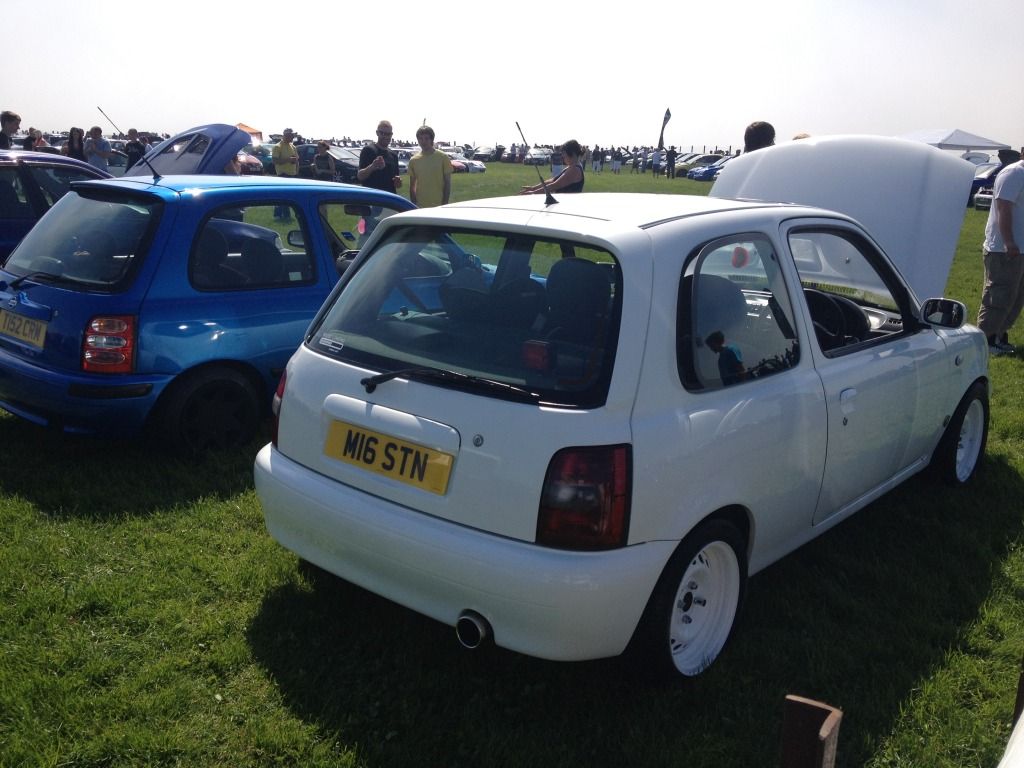

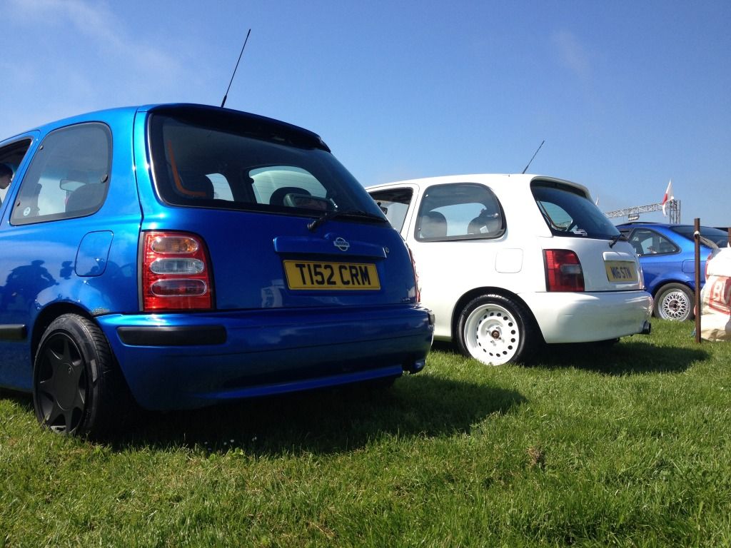

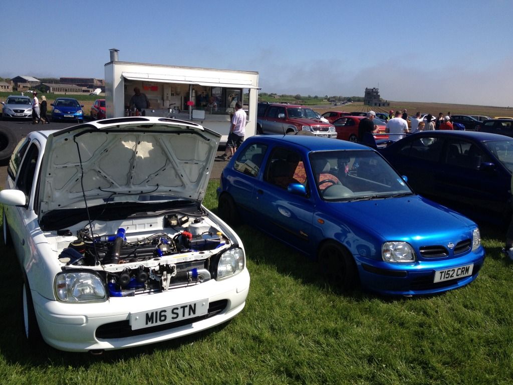

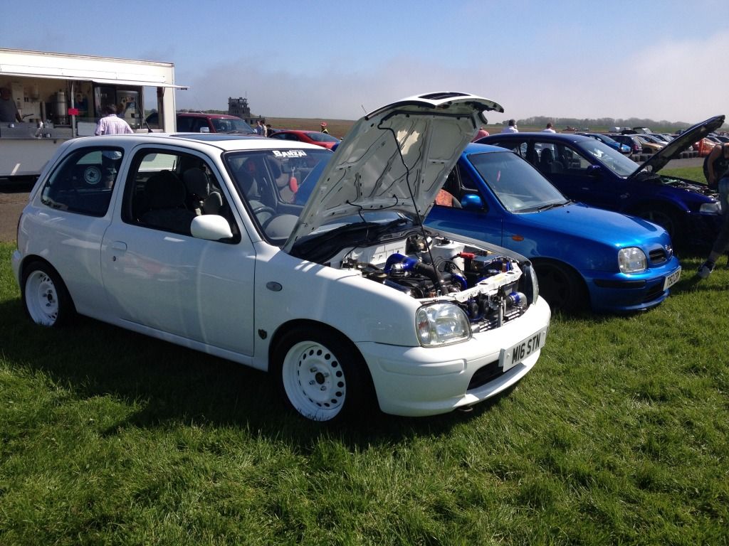

Also today i was at crail not racing due to the lack of management but thought we'd stick it on the grass looking its best. Cleaned it then opened the bonnet and before we knew it crowds of people around, then had a chat with the banzai guy who took some details and gave me a sticker so i got him to put it on for me. Then a couple hours from the end a different banzai guy (steve mccann) introduces himself and says he wants to feature it so i couldnt refuse!!! Whilst speaking to him he said of all the cars here only my car and a civic were getting featured, all a shock really but im glad my work is paying off. I also spoke to a guy who will setup my car so all in all a great day!! Now for a few pics...
Will do! Hes coming to see me in a few weeks so ive got till then to find where im going to have it done. And to tidy little bits up that wont matter but for peace of mind haha

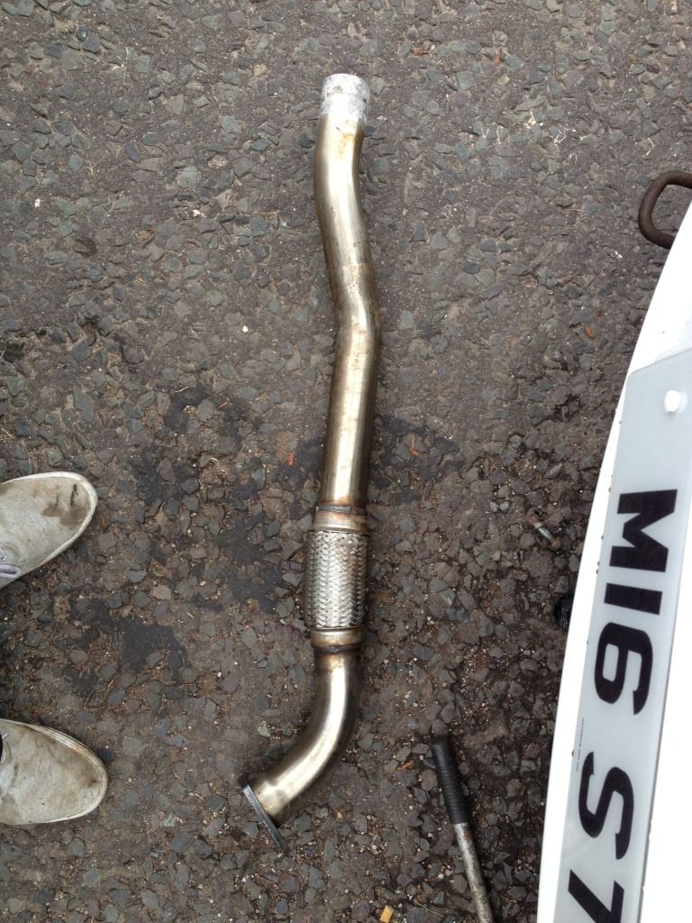

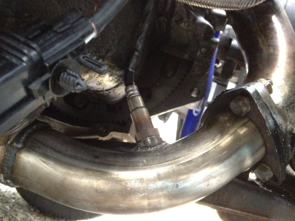

Recieved my wheel centres back today, also got my wideband so ill fit the extra bung while the cars immobile :p
Last night me and big mike tried to remove the front section of my exhaust to fit the bung for the wideband but failed! So today after work i managed to wriggle it off myself, drill a hole, weld the bung in and refit in 2 hours. Then i had to give the car a quick clean as the birds were not very nice to my clean car!
WHAT A NIGHT! Recieved all my powdercoated stuff back so got to work with cleaning everything up and rebuilding the throttle body/dizzy from scratch. Always thinking that if theres going to be any problems its these. Anyway got everything together then realised the battery was flat so took a jump from my van and the engine would only turn over so doubled check everything which was fine so checked for fuel/spark. Theres a spark but no fuel from injectors, done the tests which showed theres fuel going into and out of the fuel rail just not out the injectors. So thought maybe the baking procedure duribg powdercoating had maybe played with the stock regulator inside so tried another but same outcome. Tried other injectors but still no change so gave up for the night at about 11.30 after spending 7 hours on the car. Then as im seeing my mate out the house it clicked!
Ive temporarily lost my key/fob, so was using the girlfriends key to try an start the car BUT i removed the chip from this key months ago!!!! Honestly the most stupid things always happen to me, but its my birthday now and in the morning ill be putting it back together and have a little laugh when she fires up

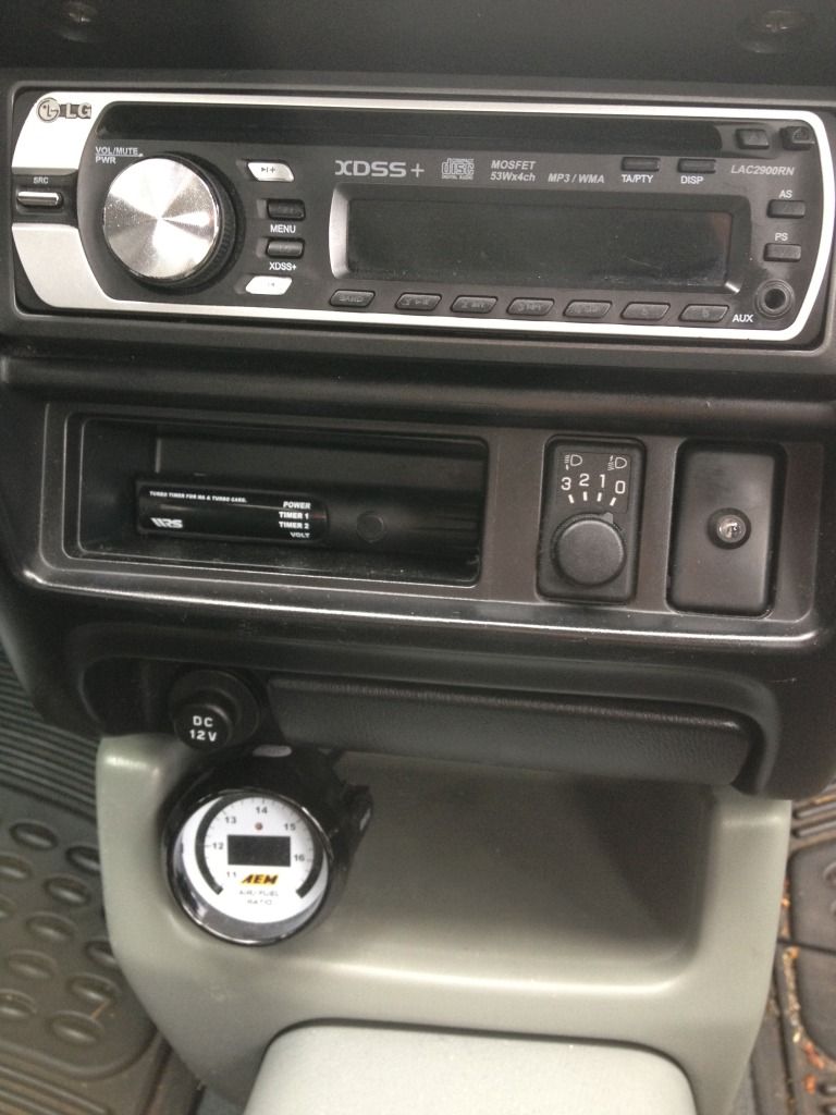

Cars all running sweet, cant believe it was that simple! Also got all the little niggly bits sorted like rattly exhaust and fit complete wideband setup. Upon driving the car the AFR sits nice even when it first comes on boost but if i simply give the throttle a small bash you can see the gauge shooting up into the low 16's.
Powdercoated bits
Where ive mounted the wideband gauge (turbo timer above)
Ive not gave it WOT yet.....too scared incase something bad happens lol what do you recommend i try?
heh, i,m the last one to ask about mapping :) as long a it only leaning for a split second then enriching ok i guess its wont hurt.
i fitted the vacuum damper onto mine to stop it going rich too early and to make the throttle response a bit crisper :)
From what ive seen frank yeah it is, i havent held the throttle down to see what happens once it shoots up. Ill leave that too my mapper :) and blame him for lack of 4 pistons haha!

the only thing in that engine bay that lets it down is the minging power steering pipes,.... will they polish up?.. if not... would you have a stainless cover made up for the manifold.?
The pipes at the top left of the engine? Think i need to sand the metal parts and respray as they dont clean :( And Im not going to get a cover made up
