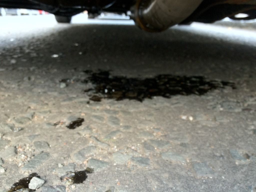

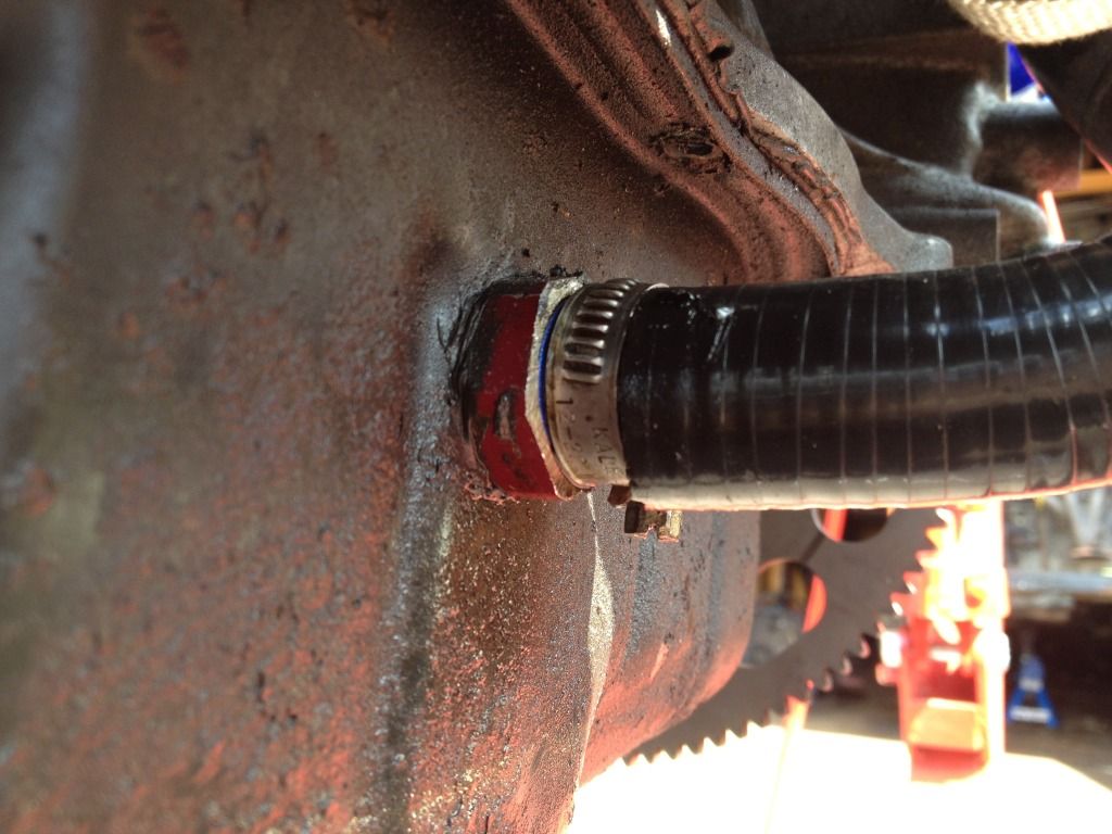

Right where do i start? Thursday night around 8 o'clock as i was parking the car reversing i noticed a line of fluid on the road which turned out to be oil so i turned the car off straight away to inspect and seen that it was coming from my temporary bodge of an oil return (it only had to last to the friday as i was doing the proper one! Anyway i couldnt risk driving the car so got a tow from big mikes slaabb up to glens where it was left for a night.

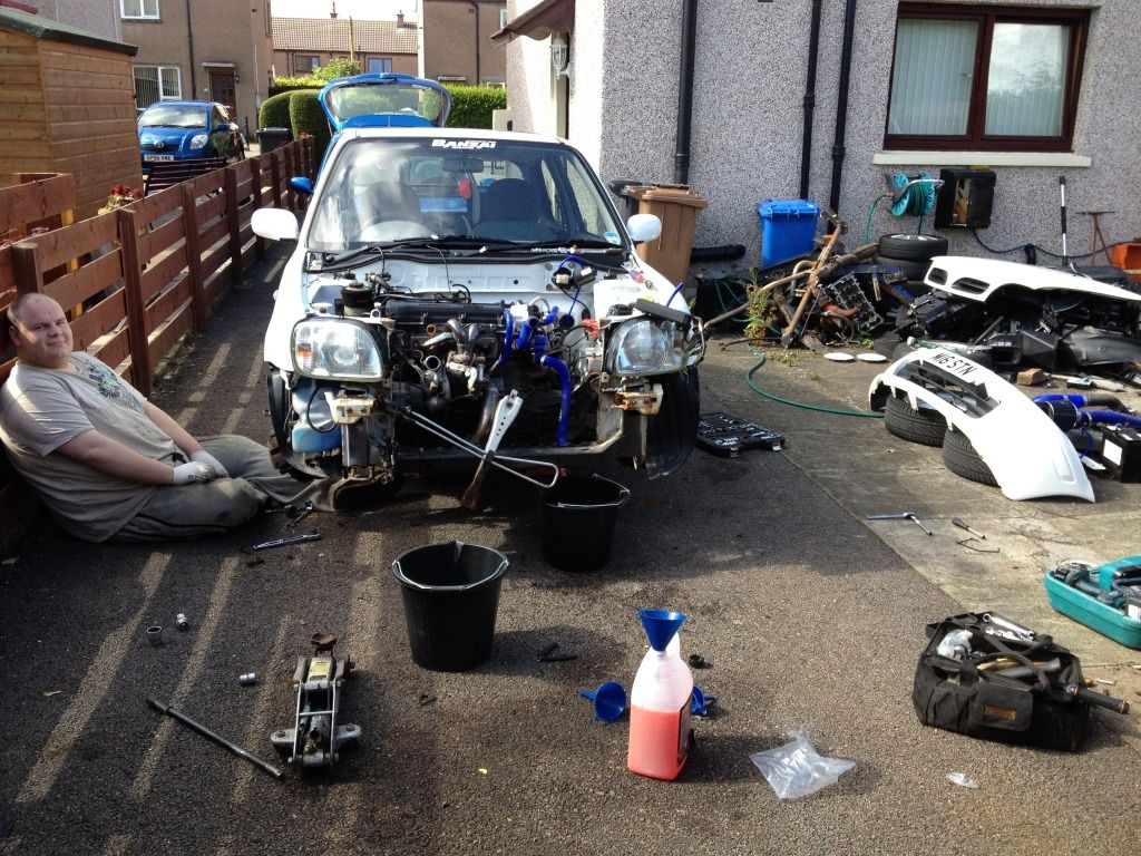

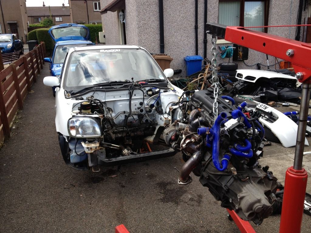

So the next morning glen picked me up, we gathered all my tools etc and headed to his to begin taking the engine out to replace the sump with the right fitting for the oil return pipe, to weld a nut in for the oil temp sensor and to fit my helix clutch and rebuilt gearbox.

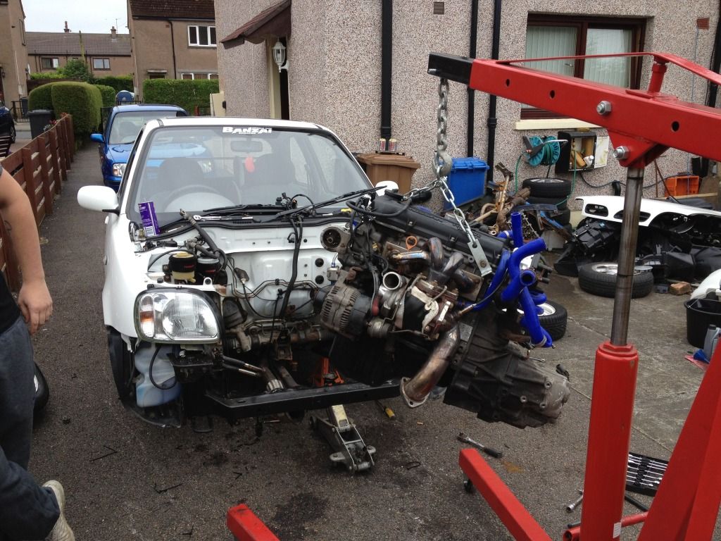

The start
Half way

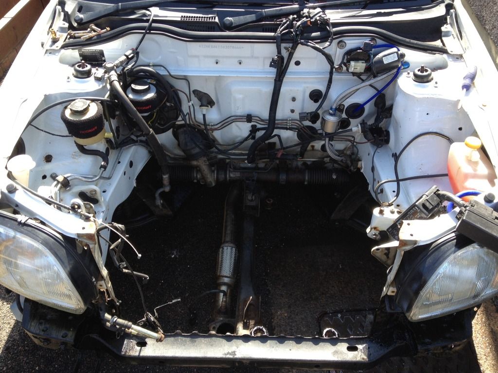

Out

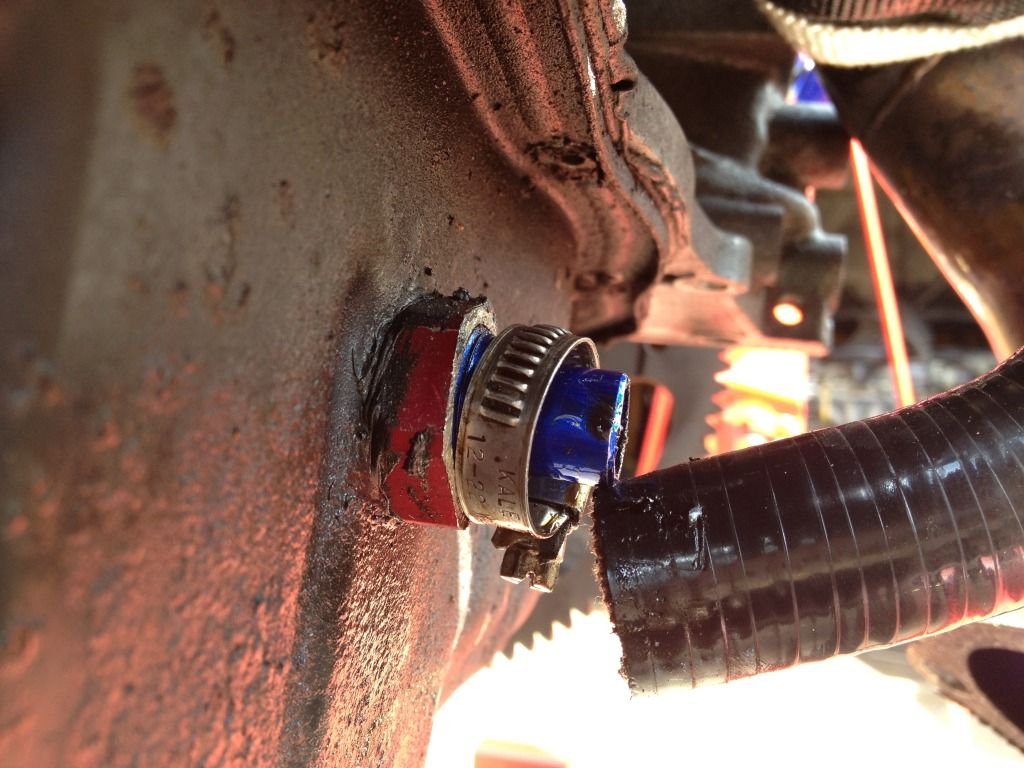

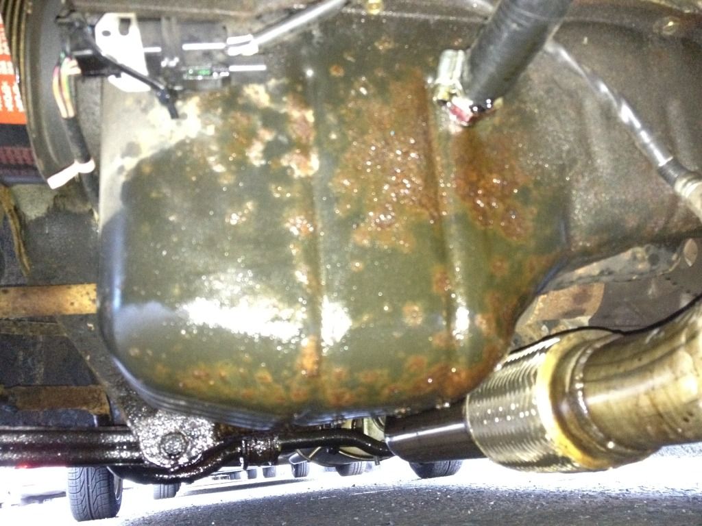

You can see on the next pic why the return was leaking, it had slipped off and the jubilee was sitting loose!
Still enough oil for the engine just!

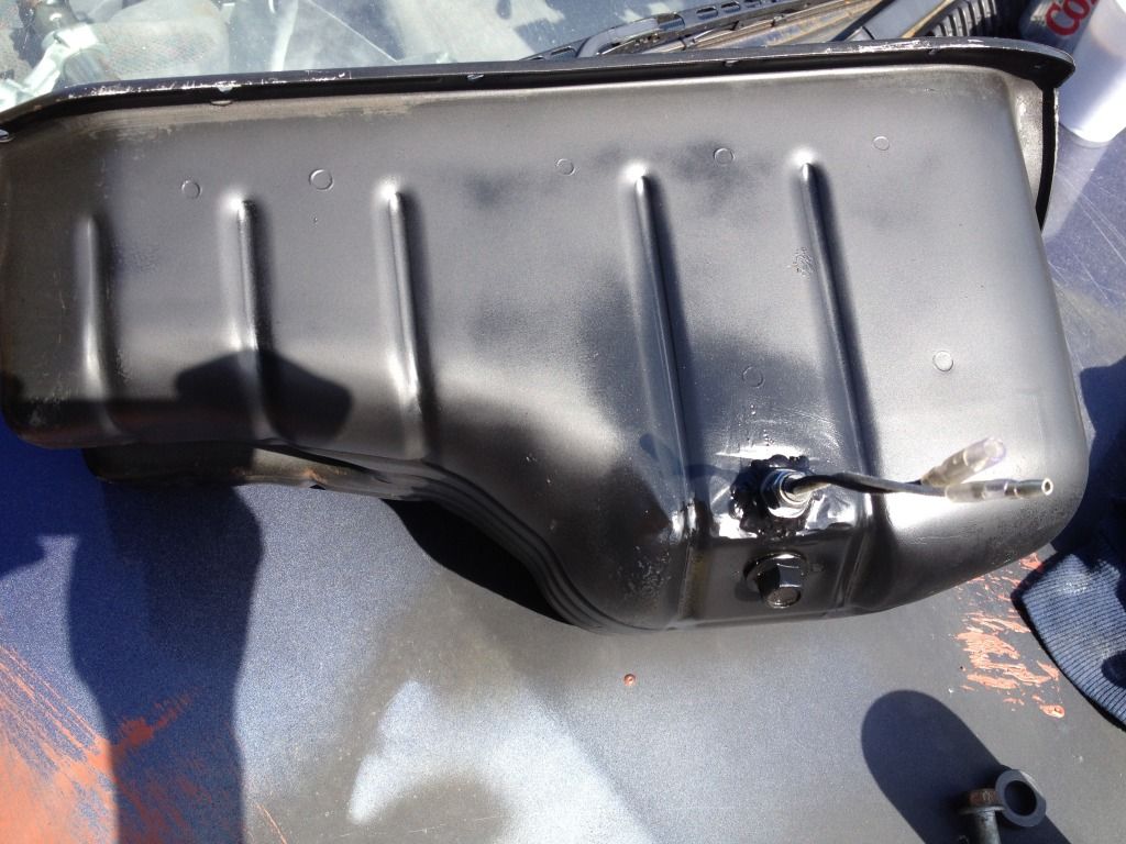

The new sump with oil temp sensor fitted (my welding
) sprayed matt black also, forgot to take a pic of the new improved oil return!

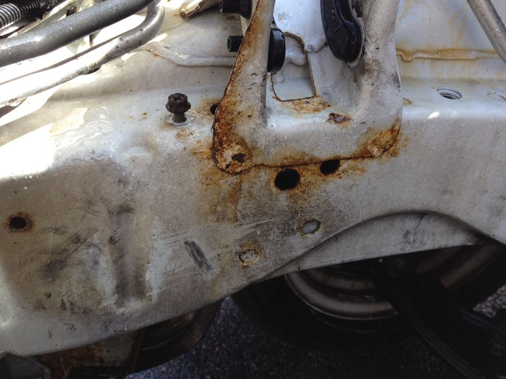

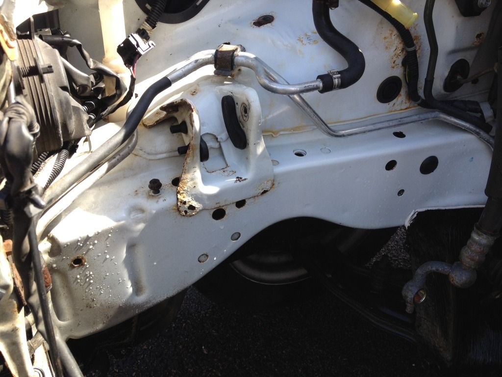

And we cleaned the areas i couldnt reach previously (needs a respray)
Also undersealed where the wishbones bolt onto

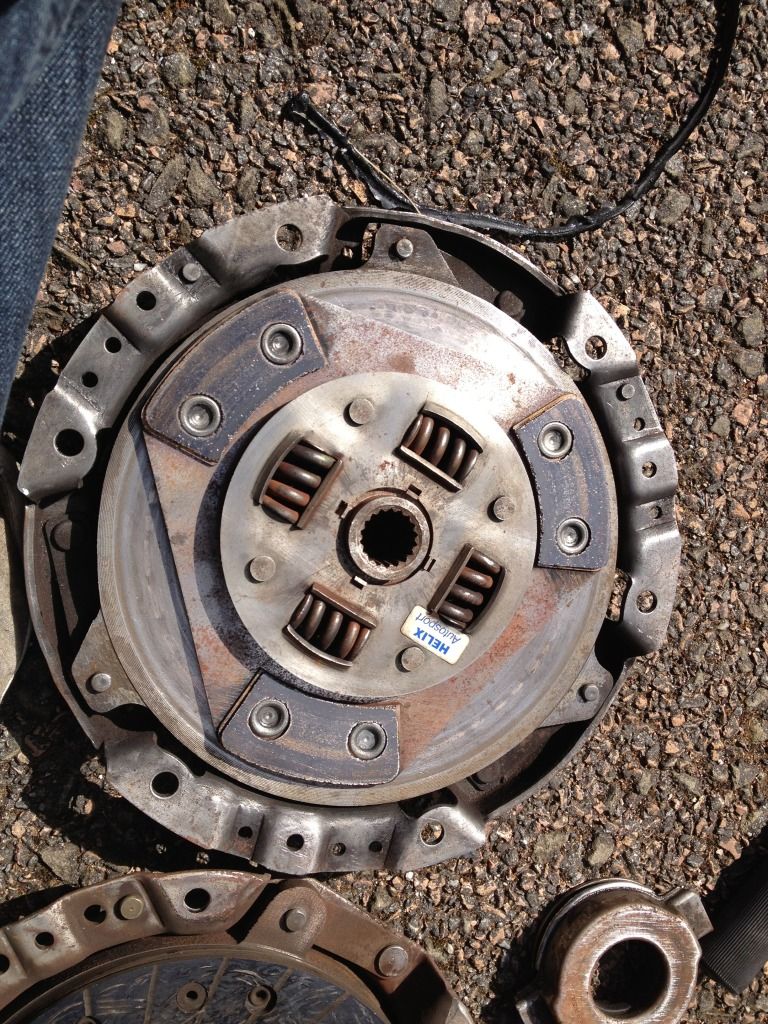

Helix clutch

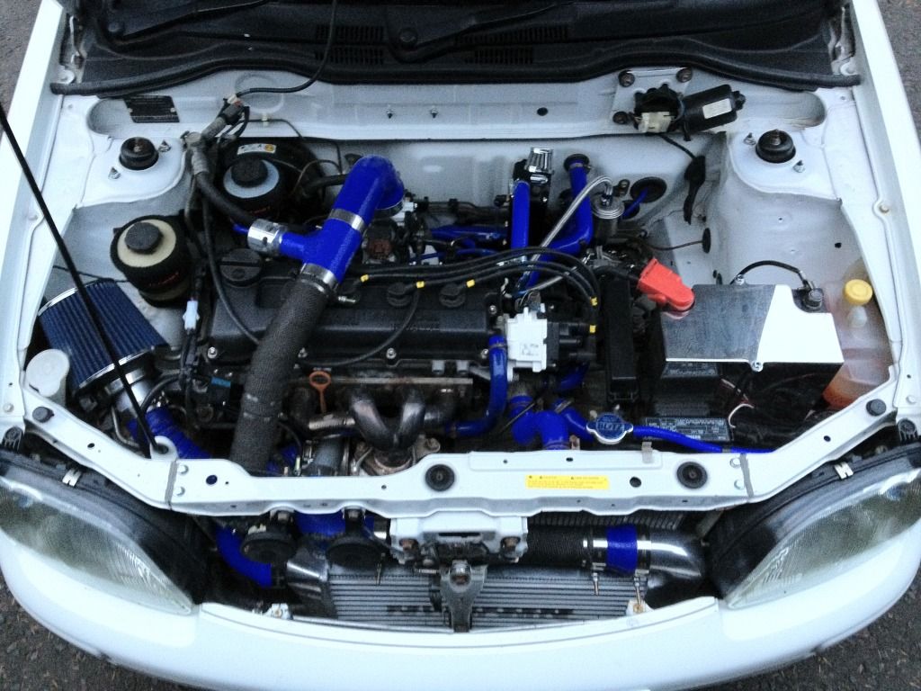

So after that we got it all back together with new oil etc, i also decided not to fit my rebuilt gearbox as the original one was ok beforehand so we fired her up, at first things were ok but noises began to develop. 1 from the power steering pump (in video) then after i took the video the gearbox was making a racket! And to top it off the sump was leaking badly from the tip of the half moon seals, totally confused why it was leaking as id done this loadsa times and cleaned it very well. So gave up for the night and decided to start again fresh on sunday

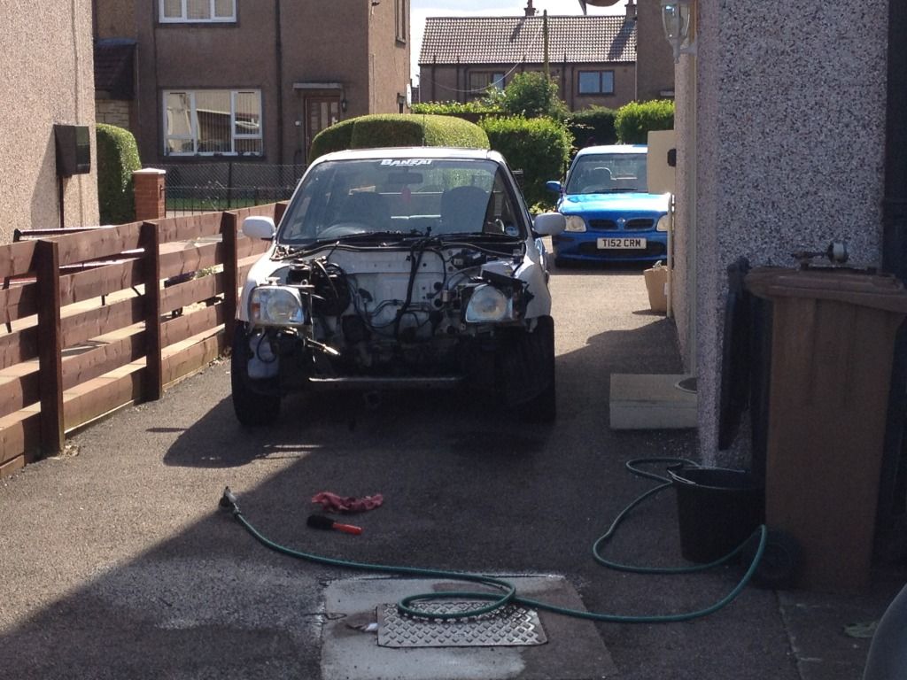

So its sunday and once again glen picked me up to take me to his, completely removed the engine and gearbox again (keeping the needed fluids in seperate buckets for reuse.

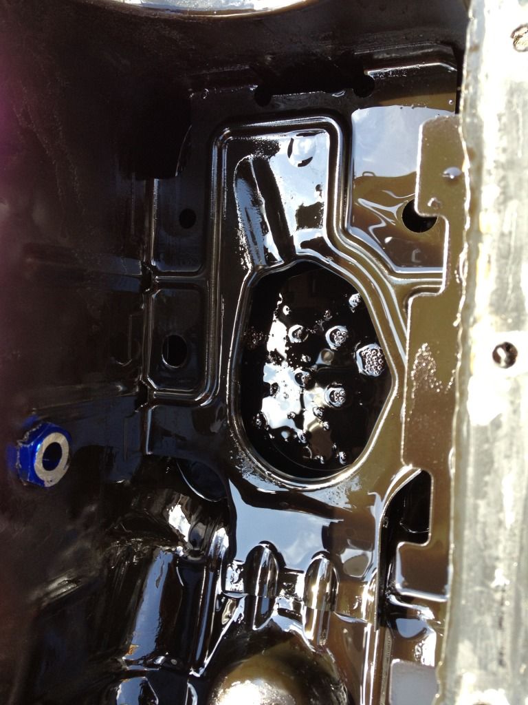

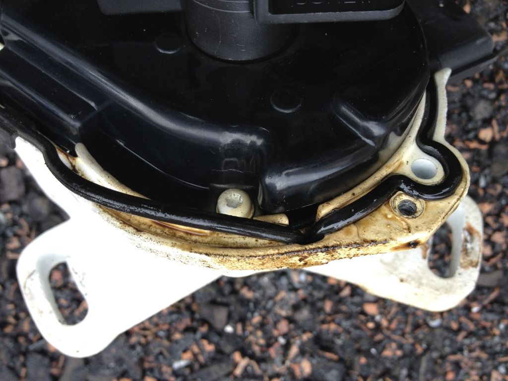

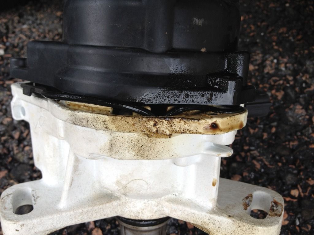

Heres the culprit of the leak, the half moon seal looked short but once removed and offered back up it was fine (typical my luck) so was a case of cleaning the joints up again and resealing making sure the seal was positioned better this time!
