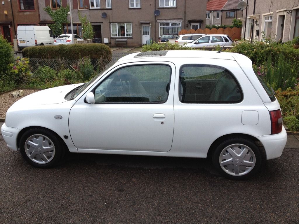

Still very much a fan of white on white, (although my OZ SL's are starting to go a tad off white now thanks to a few years of brake dust). I'm sure your car will come out really well in the mag Stani :)

I love the white on white, i cannot see me making anymore exterior changes as my ideas have run out lol your right brake dust is a pain, totally ruined my old rattle canned wheels hence powdercoating this time round!

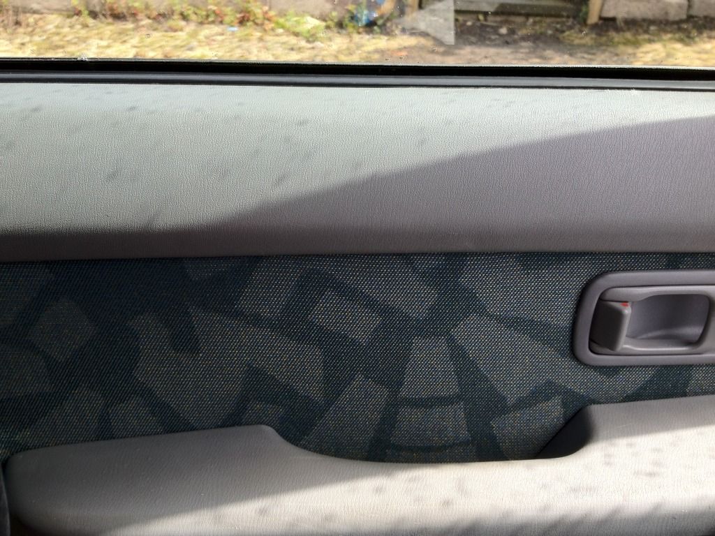

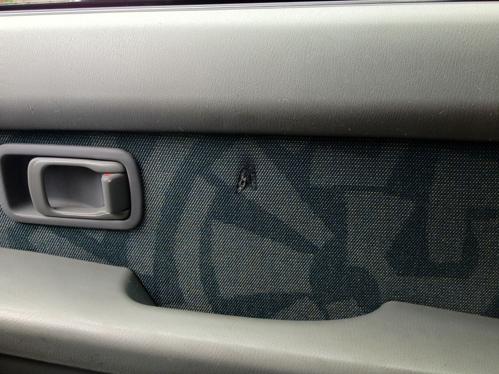

Eventually after 16 months of ownership ive repaired 2 of the most annoying eyesores :D
Drivers door burn
Fixed

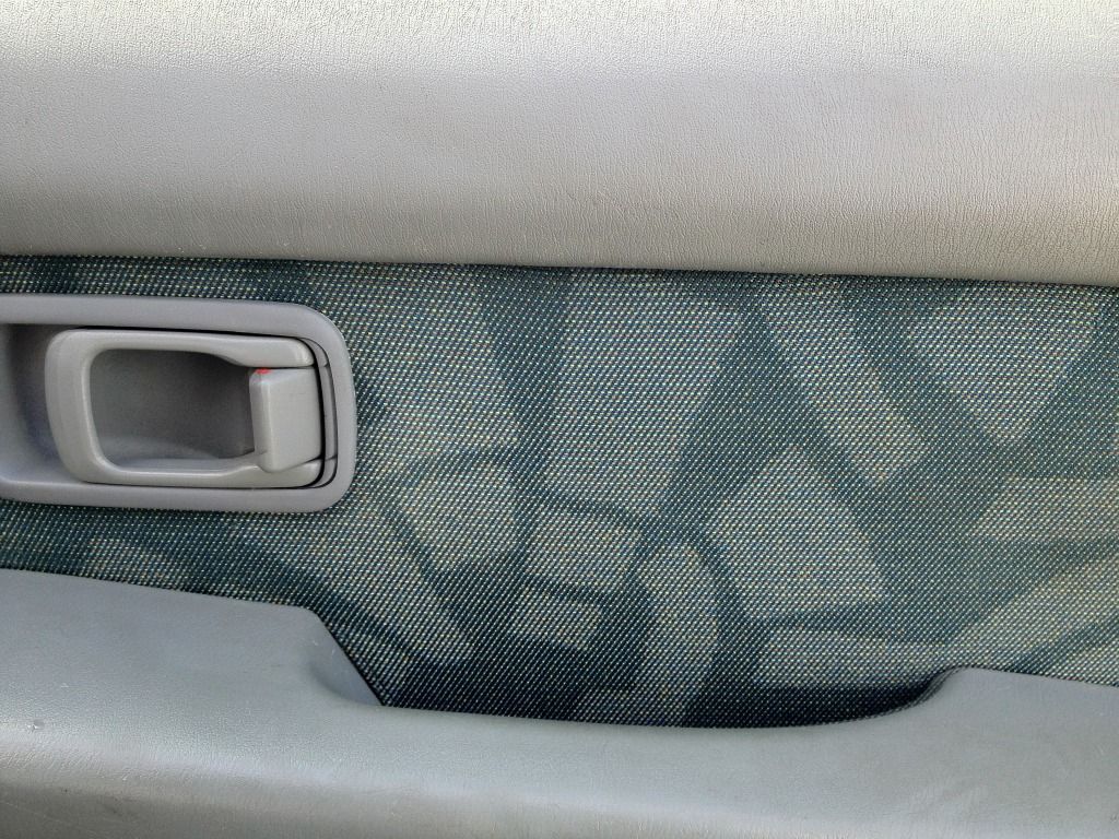

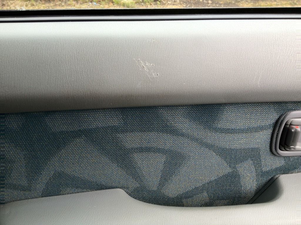

Passenger door scratched plastic
Fixed

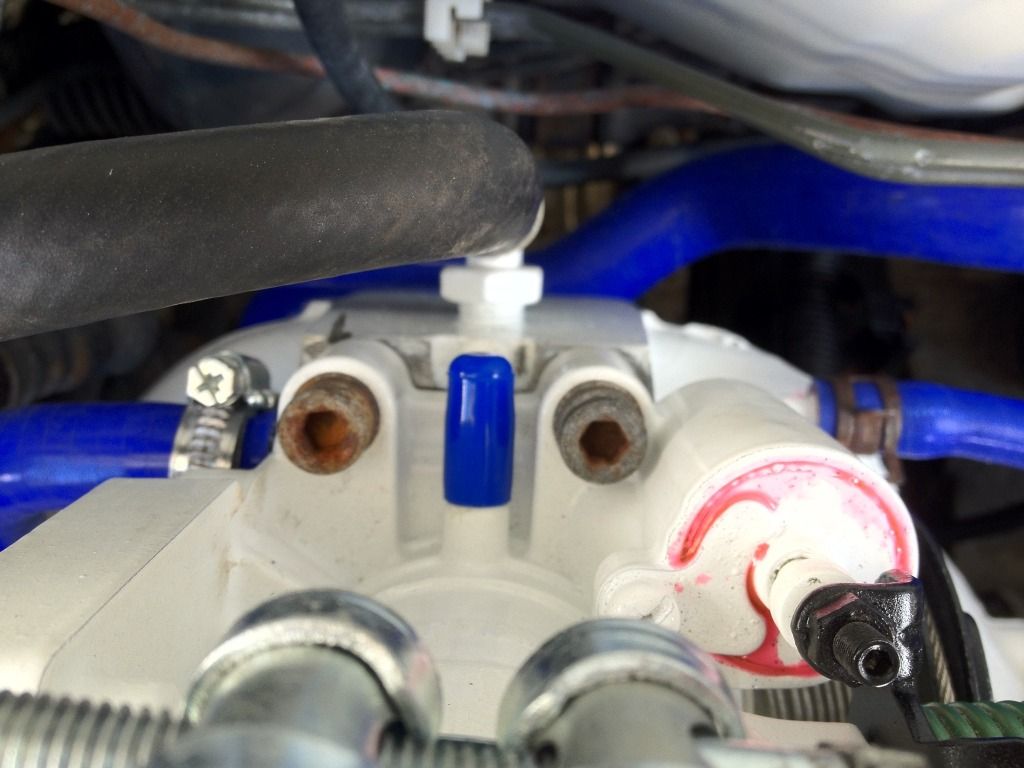

Recieved my silicone blanks today, first time ive ever had this part of the throttle body blocked off properly :p also in the picture i have a small coolant leak. Does anyone know whats inside the part its leaking up from? Anything that could melt whilst being baked during powdercoating?

I'd usually recommend bypassing the TB coolant lines, totally remove the waxstat mechanism that jams the throttle arm slightly open from cold (since they're guaranteed to seize n fail n cause high idle when warm, so most ppl just turn down the idle screw to compensate which causes idle issues) and letting the IAV do its job

So bypassing it would be fine? Ill probs just remove both coolant pipes and blank the ends....
Also would removing the threaded rod and nuts in the bottom RH of the picture stop it from working? Obviously once the coolant has been re-routed
yeah bypassing or shutting the TB coolant pipes fine. i totally removed the hoses on mine n crimped shut the pipes at the back corner of the head and the little pipe on the coolant return pipe with some pu sealant inside too
and no the spring loaded fast idle throttle cams always trying the keep the throttle open, the wax plunger when warm would push against the fast idle cam till it receeds and so allowing the throttle to shut fully = lower idle.
so once you've unhooked the coolant pipes you have to remove that sprung loaded fast idle cam mechanism to allow the throttle to fully seat, optionally clean & adjust the IAV solenoid before finally configuring the warm idle rpm. wrote a guide bout this

Strange, I removed the coolant lines about 10years back with the wax stat adjusted out of the way, set up the idle and never once had any issues. Same went for when we ran a GA16DE throttle body as a test about 5 years ago and we never had any issues there either.
I set the idle the same way with the jenveys with no IAV and I don't have any idle issues there either.
From what I have heard people seem to always have the issue of the car not being able to start from cold and they have to hold the throttle open until things warm up but that's just down to poor setup.
yeah sounds like a IAV stuck closed or IAV head misaligned or idle screw set too low to compensate for the fast warm idle from a stuck fast idle waxstat cam
I've removed the pin before and cleaned it up (when it was sticking) never had any leak issues afterwards...cant remember if theres an O ring on the inside, probably good odds though. :)

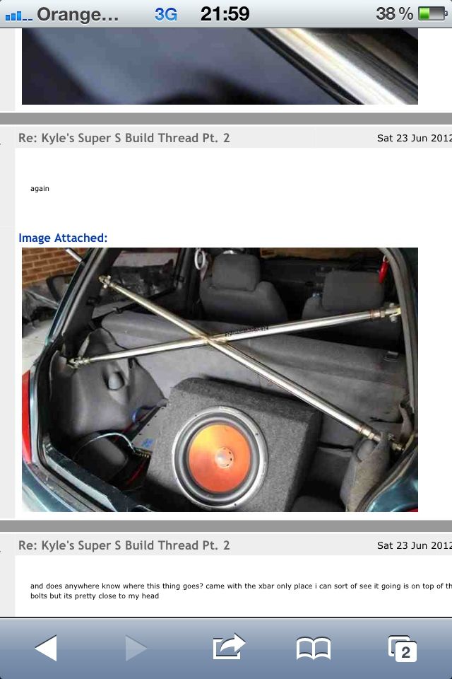

Also im away to do away with my parcel shelf and put my fog into the light cluster and make one of these x-braces if all goes to plan :) purely for show nothing else

Stani, how did you fix the plastic panel? I have a scratch on the passengers door and it's bugging me off anytime I look at it
Replaced the door card :p although i think i seen that this piece can be unscrewed from the panel so easily replaced with another

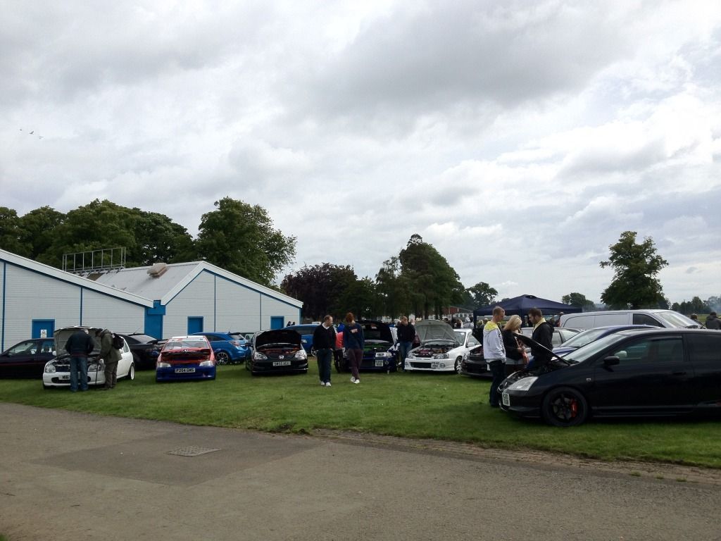

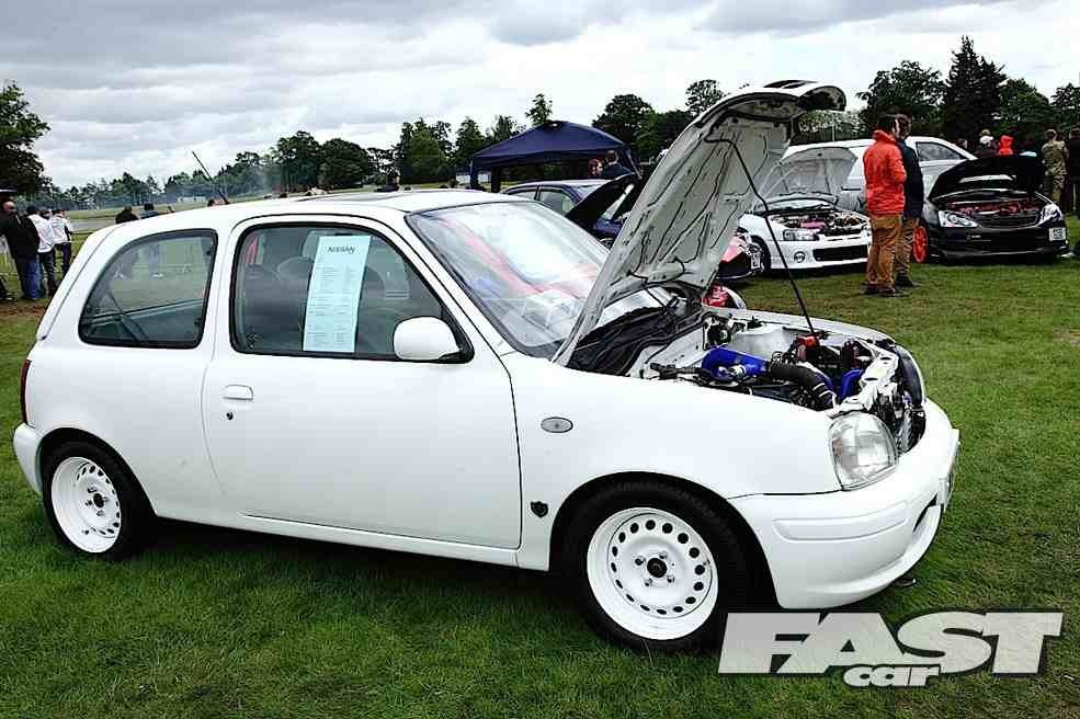

Not alot happened, cars running smooth still. Was at ingleston car show on sunday, alot of attention on the car again which was good and plenty more new photos kicking about heres the stand i was on

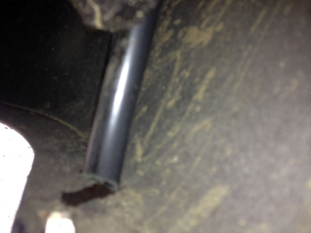

Had some time to spend on the car today and first on the list was to re-route the sunroof drain pipes as i was getting water in both driver side footwells. Was such an easy and quick job to do. For the fronts i took off the kick panel where the pipe comes down drilled a hole through behind the wing and posted it through. For the rears it was a simple case of pulling them to the back near the lights and posting them out through air flaps.
Front
Rear

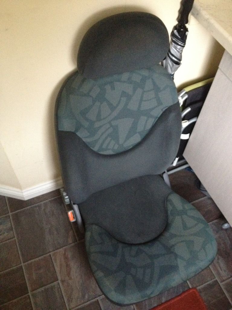

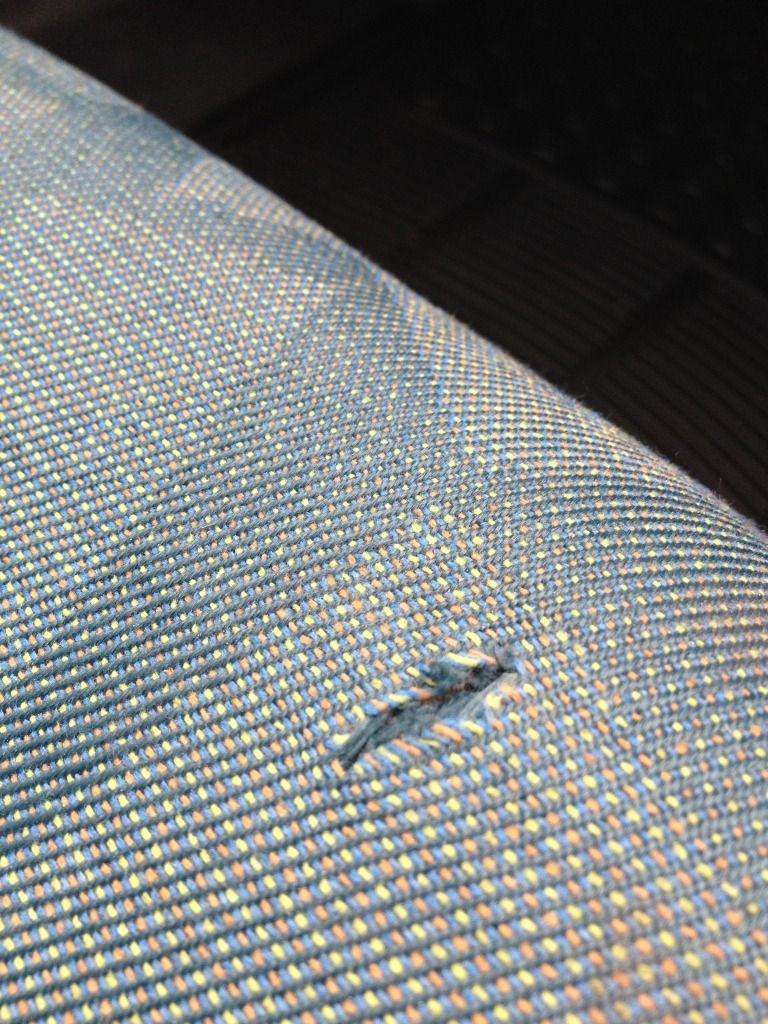

I also got round to fitting my new untorn passenger seat
Old
New

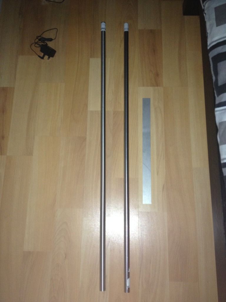

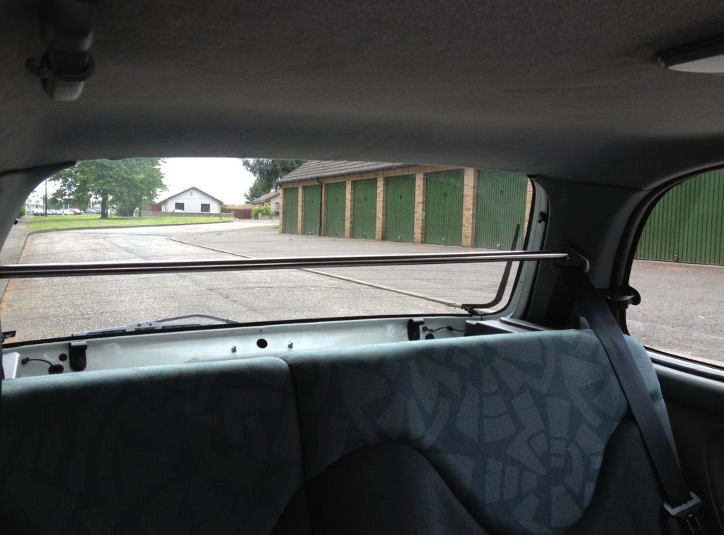

And i also cut the stainless bar i had and jammed it inbetween the rear seatbelts lol rattles slightly

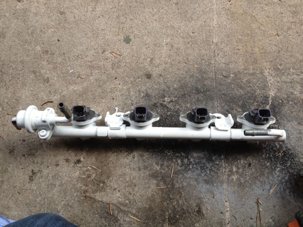

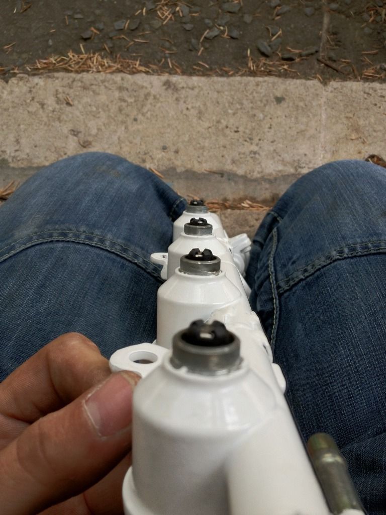

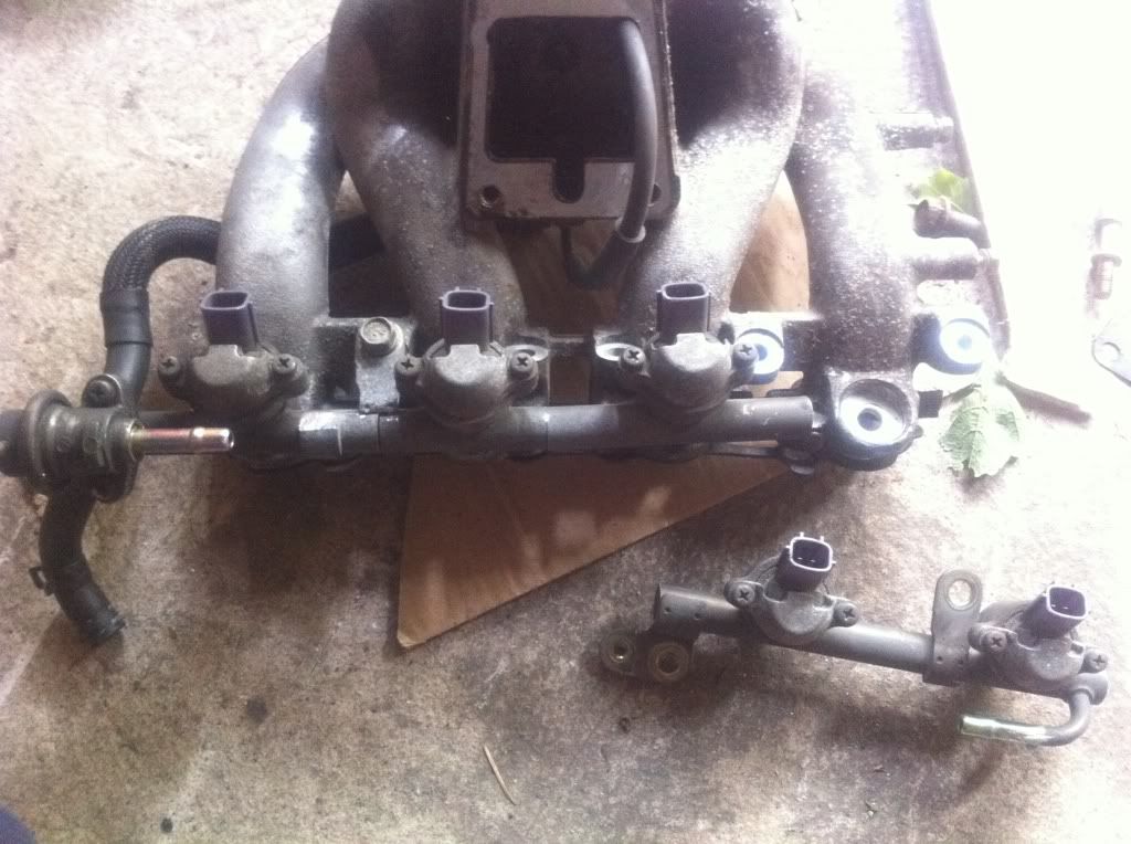

Also realised ive no pictures of my completed RB25-CG13 fuel rail (made by the one and only frank)
Work in progress
Complete

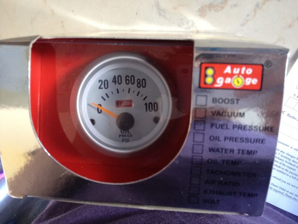

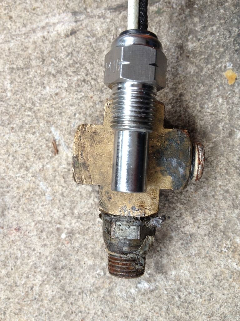

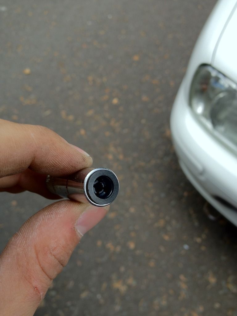

And last but not least ive got a oil temp gauge but the fitting goes too deep in and will block my oil feed to the turbo so has anyone a solution? Ive bought some extension pieces but theyre wrong!
Ahh i see, i just presumed it went onto that fitting because it screwed in. So yeah im sure i can find somewhere to do that or even drill the sump and weld in a nut :)

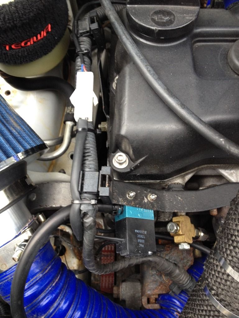

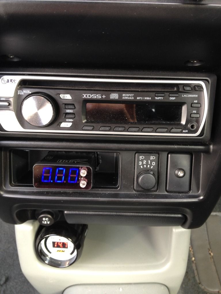

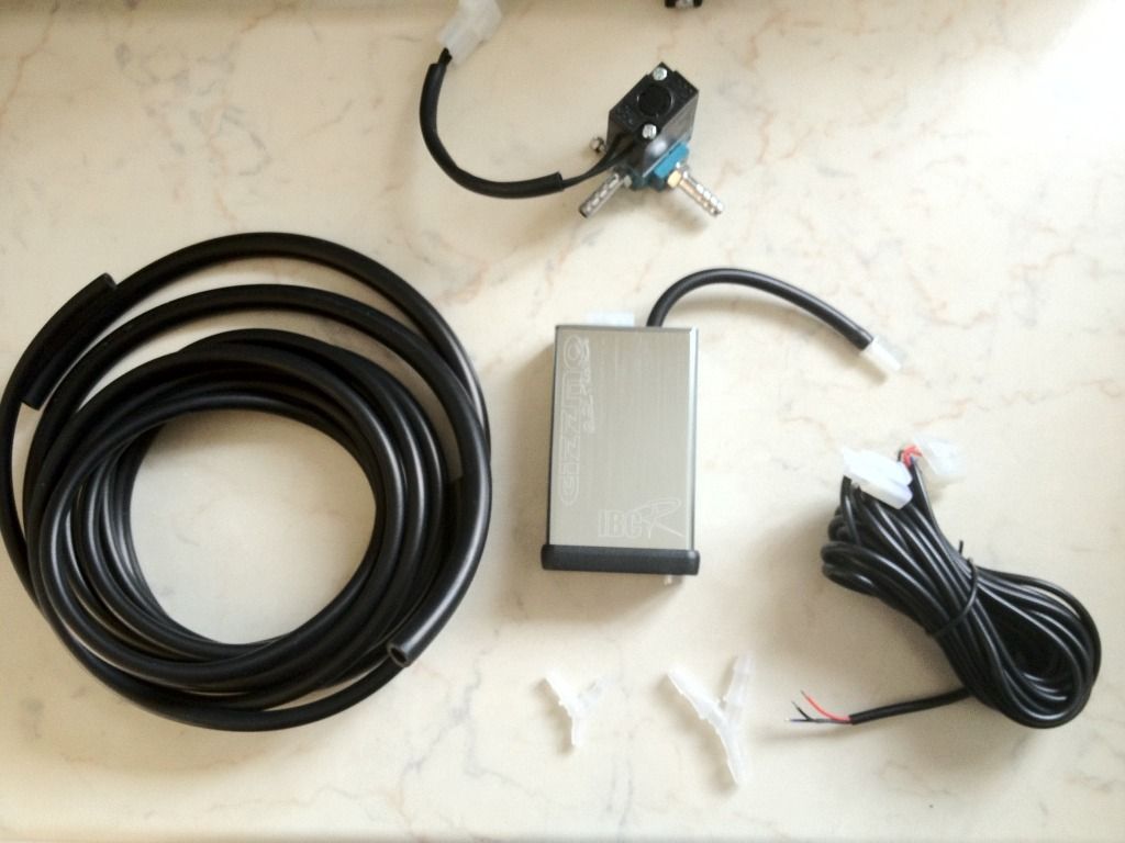

Fitted my boost controller last night, took a fair while to get it hooked up and fitted tidily. One day the dash is coming out and ill hide all the wires somewhere else other than below the ecu/behind the centre console. Cant actually set it up fully as i need to give it full throttle. Will leave it to the mappers in august ;)

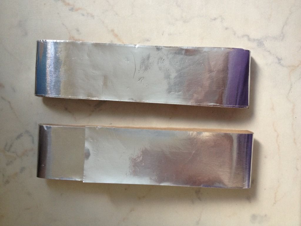

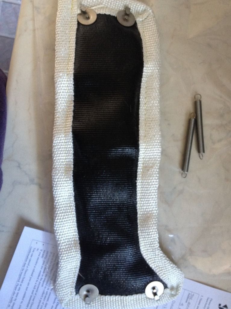

Heat reflective tape

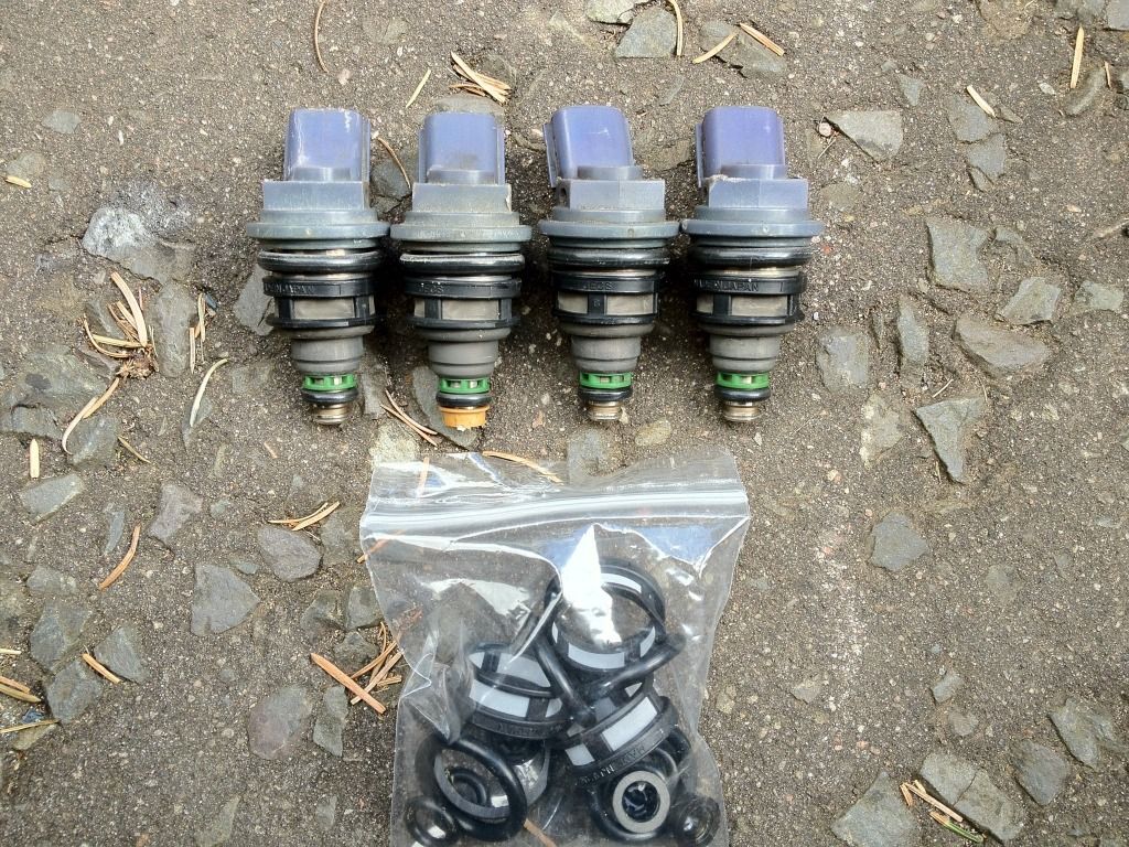

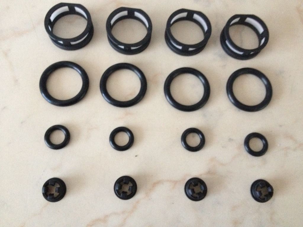

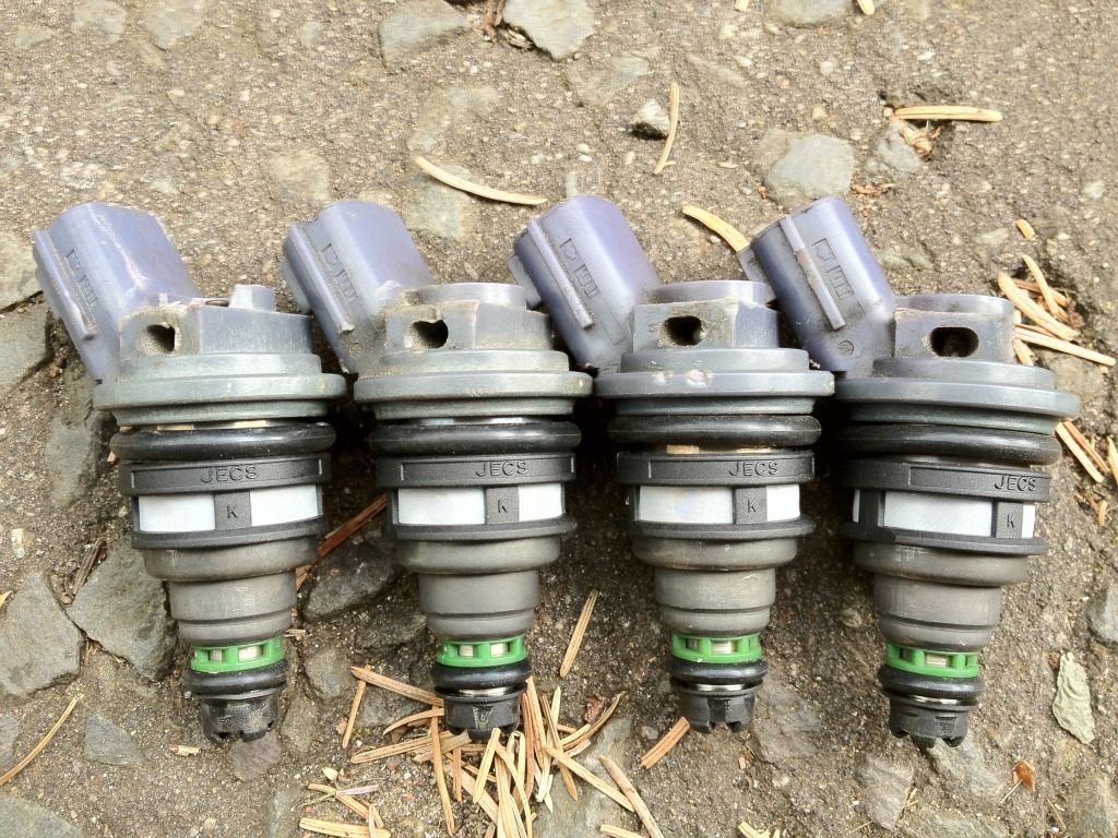

Injector rebuild kit

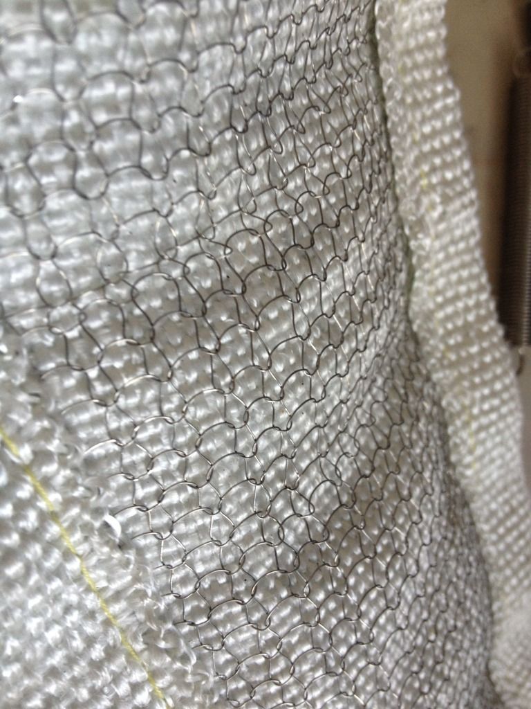

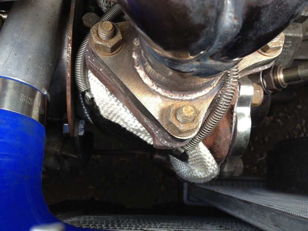

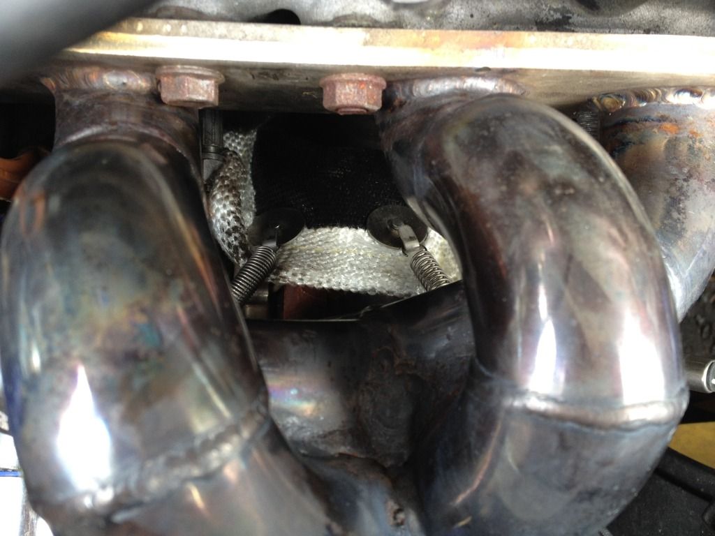

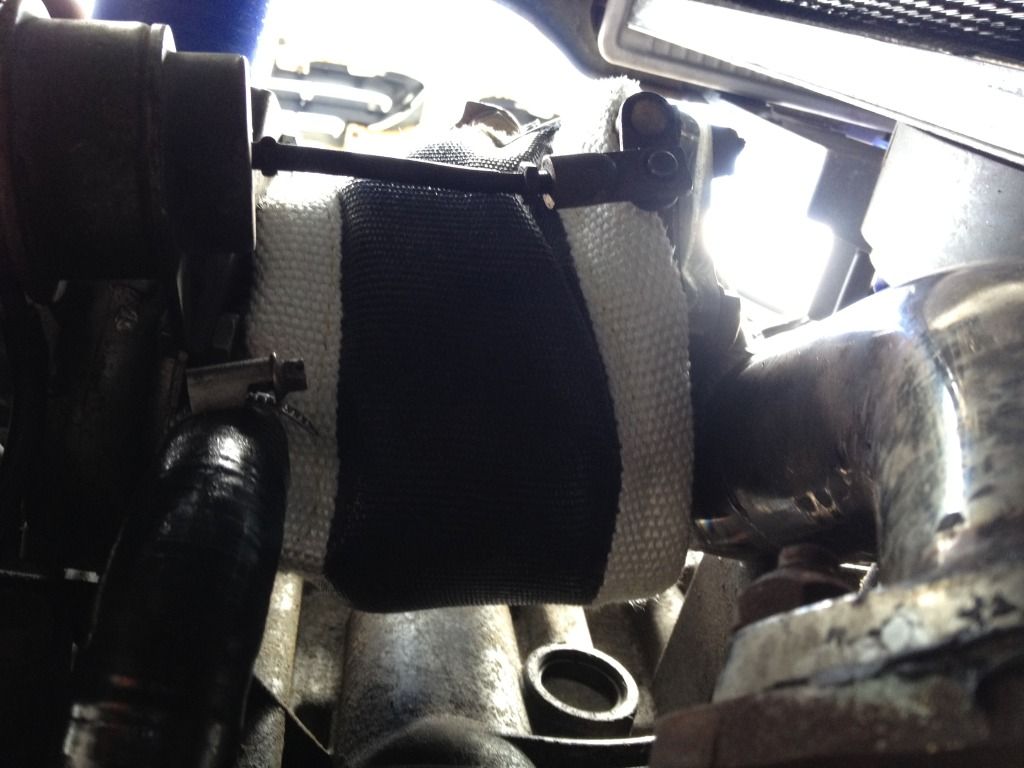

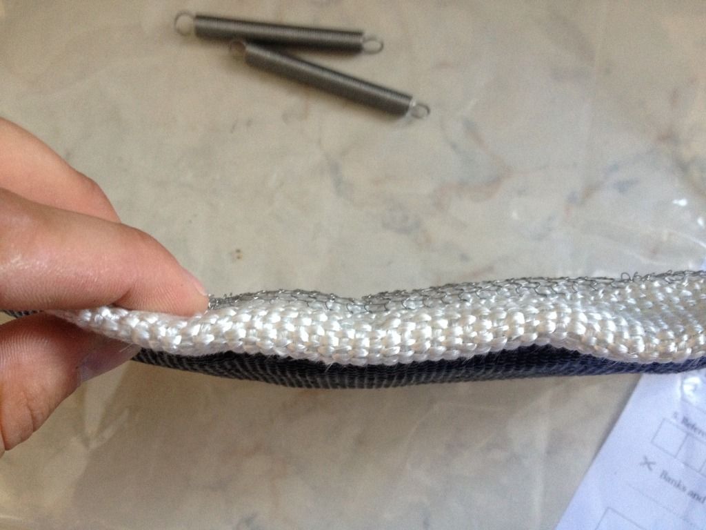

Got my turbo wrapped up today

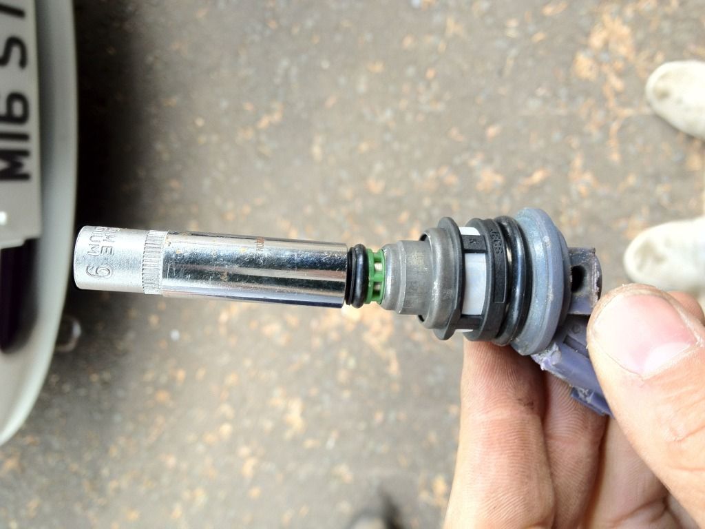

Got my injectors rebuilt, pintle caps are difficult to push on so used a 9mm socket to knock them into place

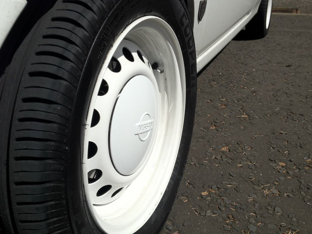

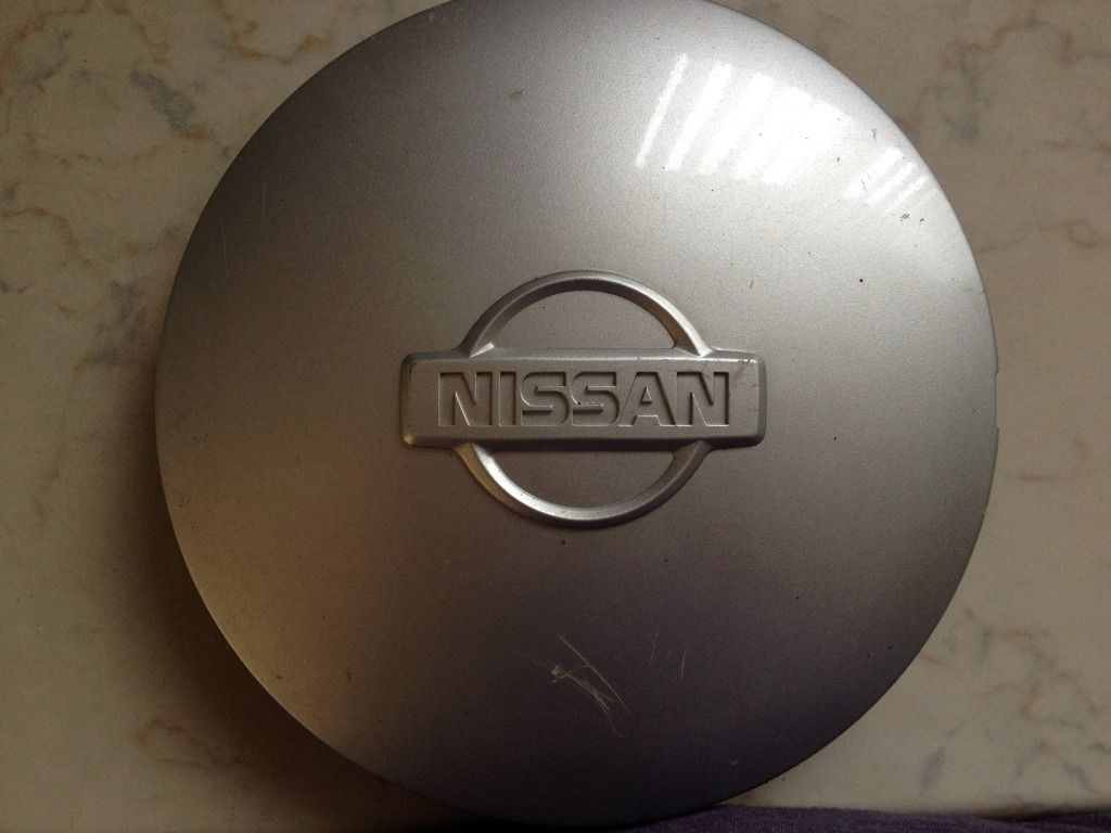

Also managed to get some stock steels centre caps. Downside being i have 14'' steels so theres a 5mm gap allround :(

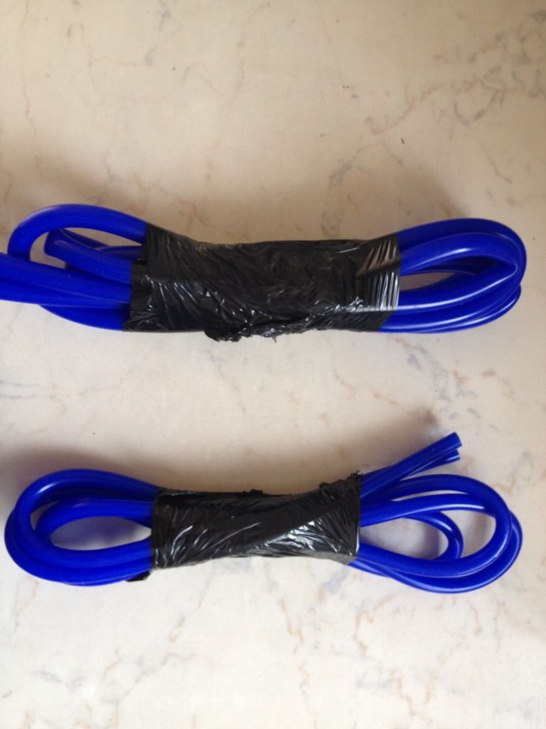

And i bought myself some dpare 4 and 6mm ID tubing
