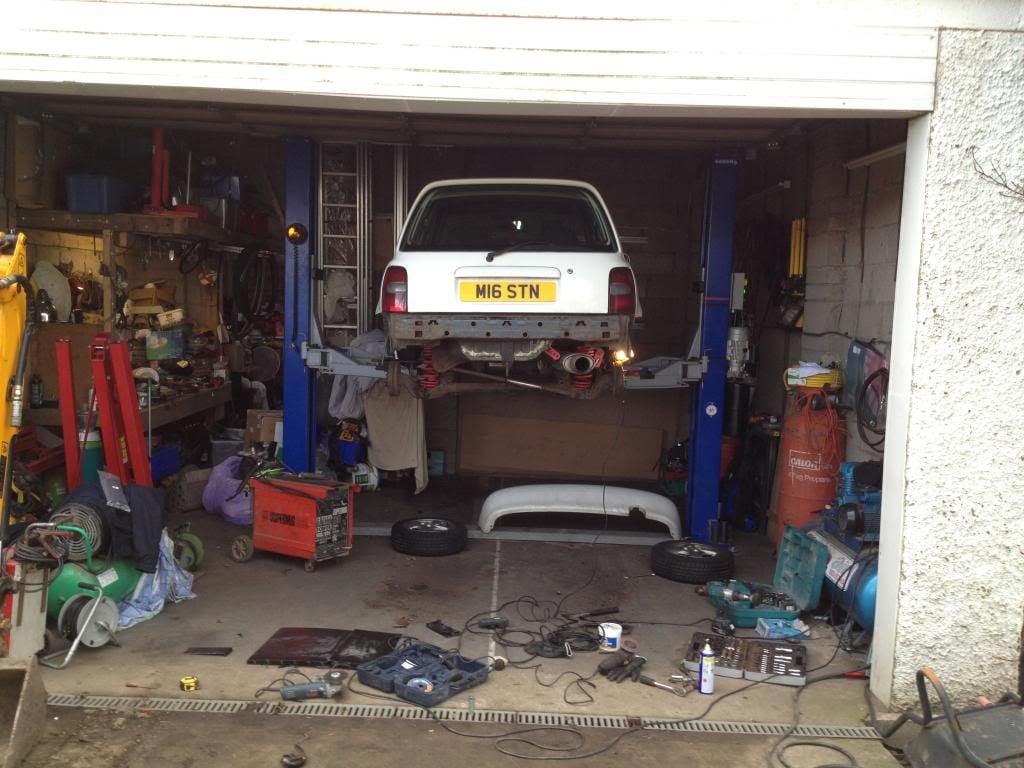

This weekend me and glen are going to be making a start on the patching up. Probs aim at doing the rear ones first because my dad was in the back when I picked him up tonight and he said the seats were wet/damp. Then there's the other 2 patches to be done, still to rake around the rest of the body before I commit to trying to pass the MOT. Also still to do the roll bar links front and back and rear cylinder and shoes/spring kit. Then I'd like to trace and fix this oil leak, it's in the region of the oil pressure switch/oil filter/sumo area and is minor. Just hope the emissions can somehow make it through or I'm going to have to go back to standard and reload the base map on.

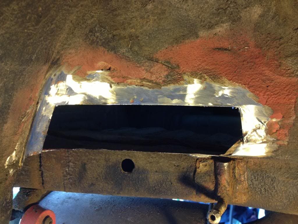

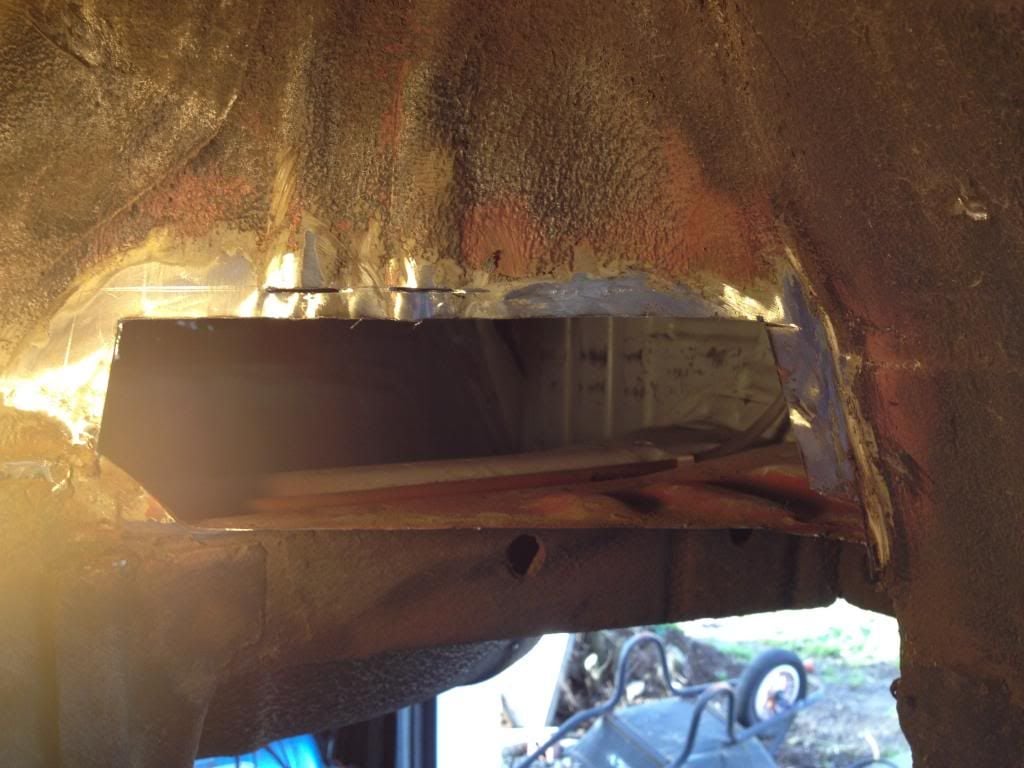

POST CURRENTLY WORK IN PROGRESS DUE TO ****TY PHOTOBUCKET!!!

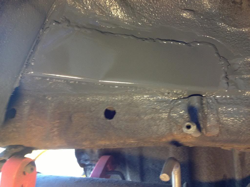

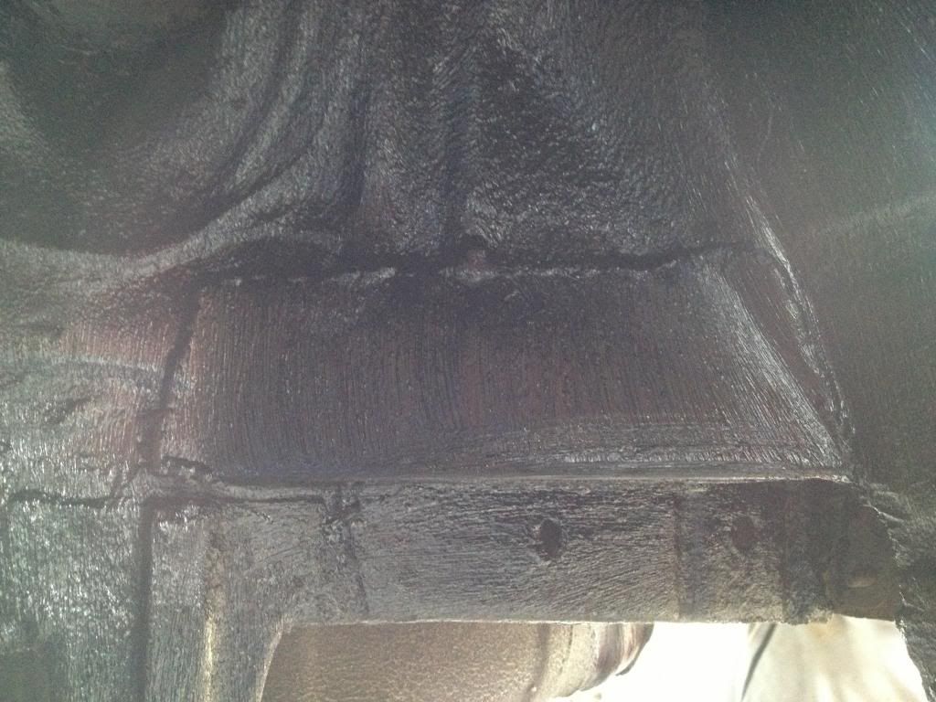

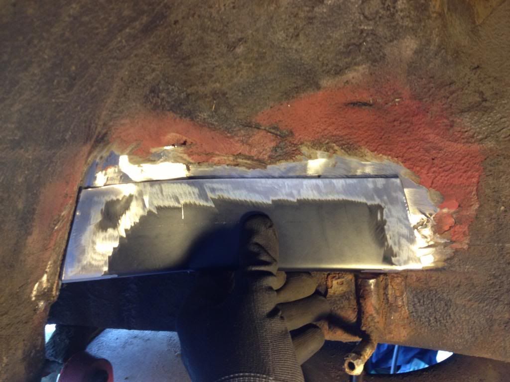

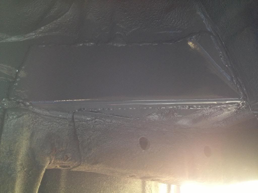

N/S rust cut out

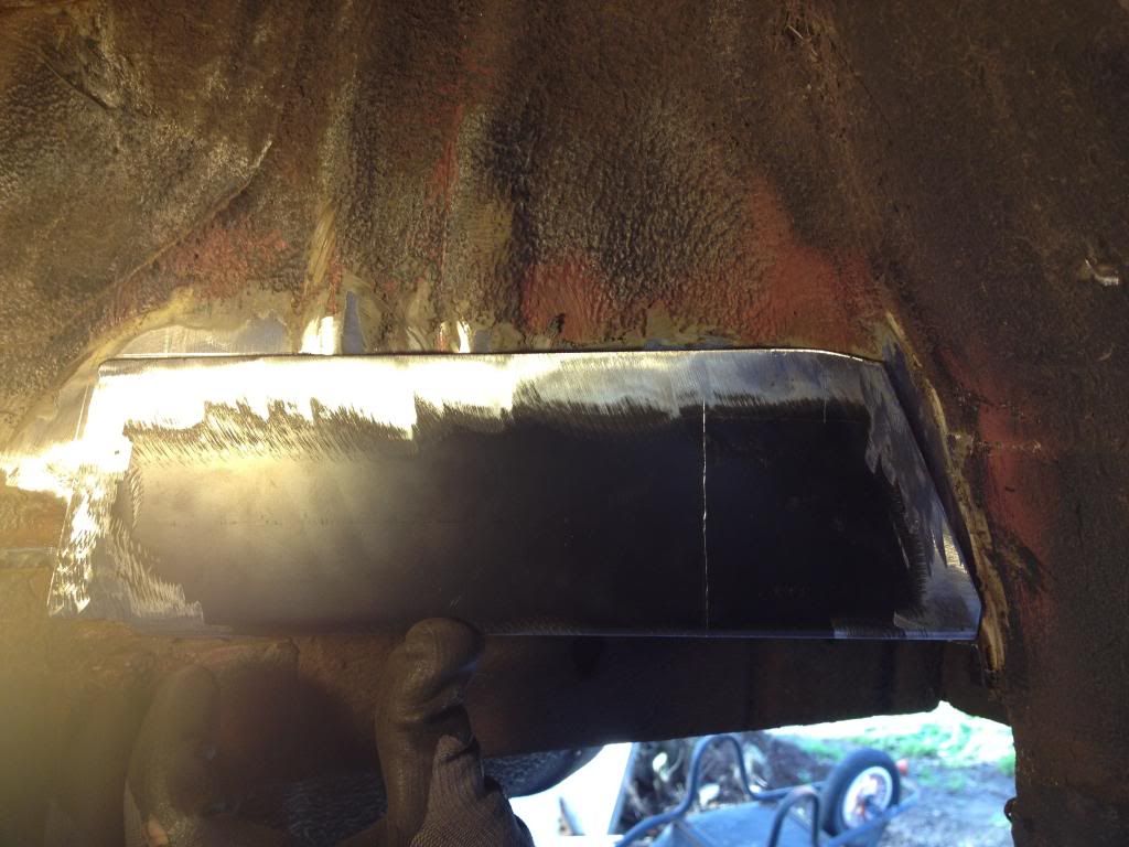

Patch cut and shaped

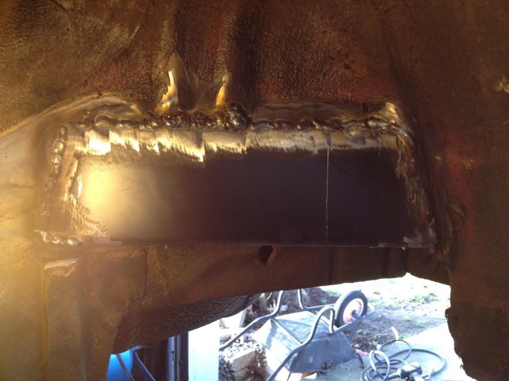

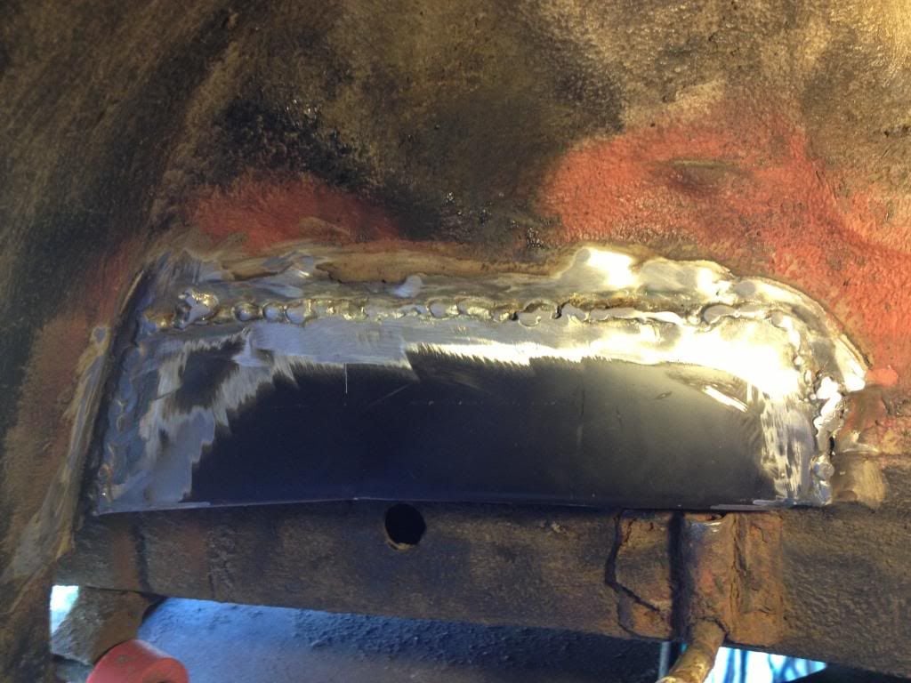

Patch welded
Zinc primed
Stonechip and sealed

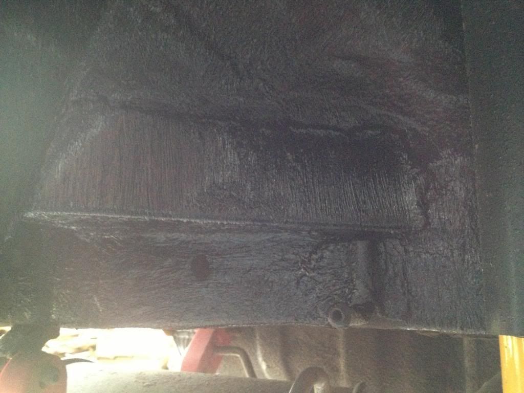

O/S rust cut out
Patch welded
Zinc primed
So thats 2 of 4 done, doing the other 2 next saturday then that leaves the drop links and brakes etc and hopefully ill have an mot certificate :D huge thanks to glen for today

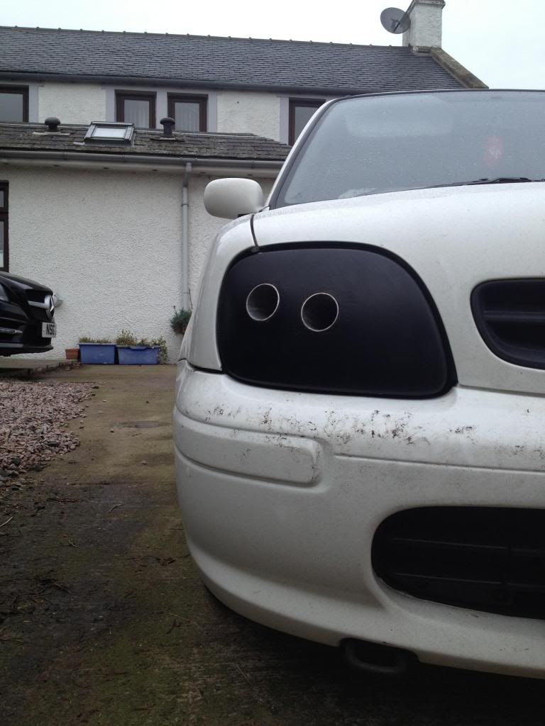

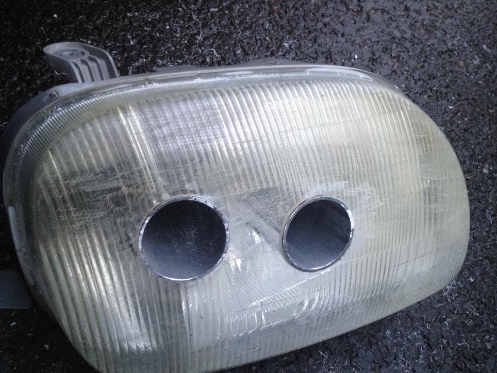

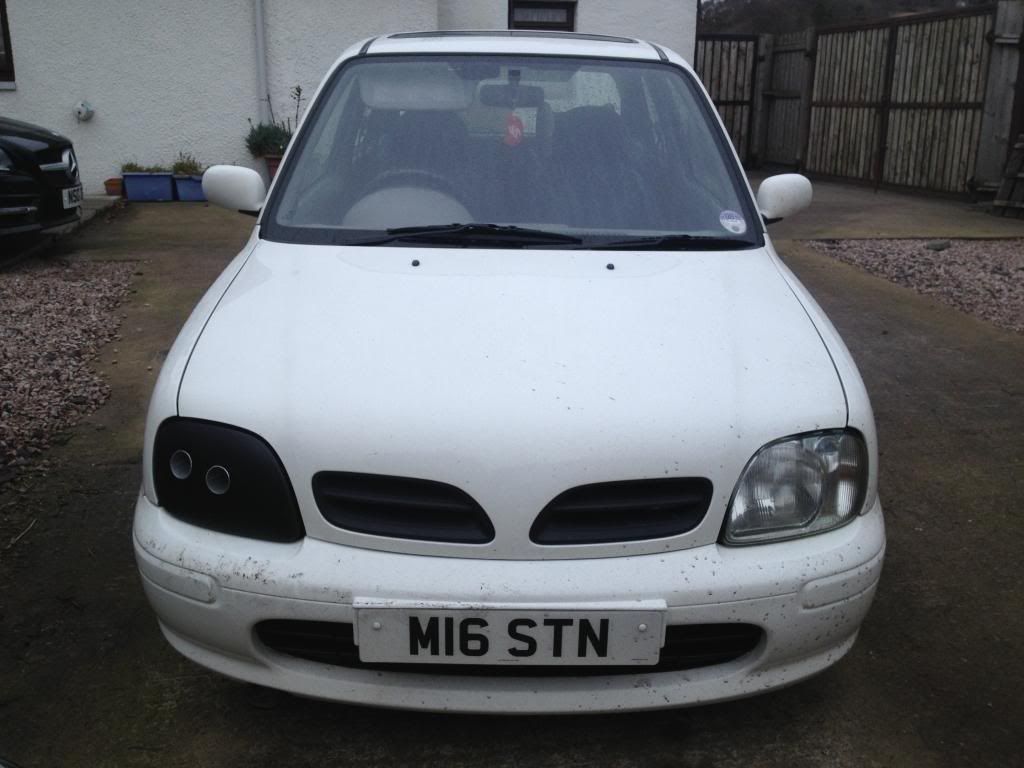

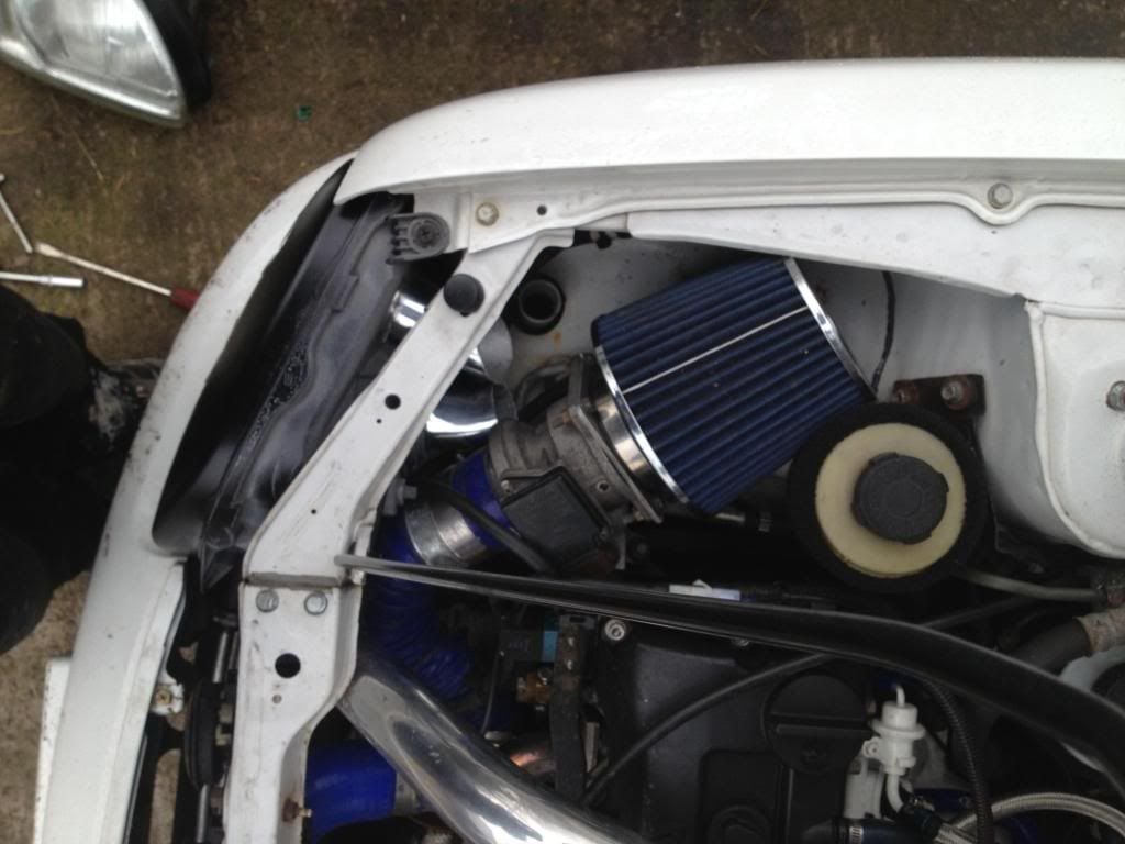

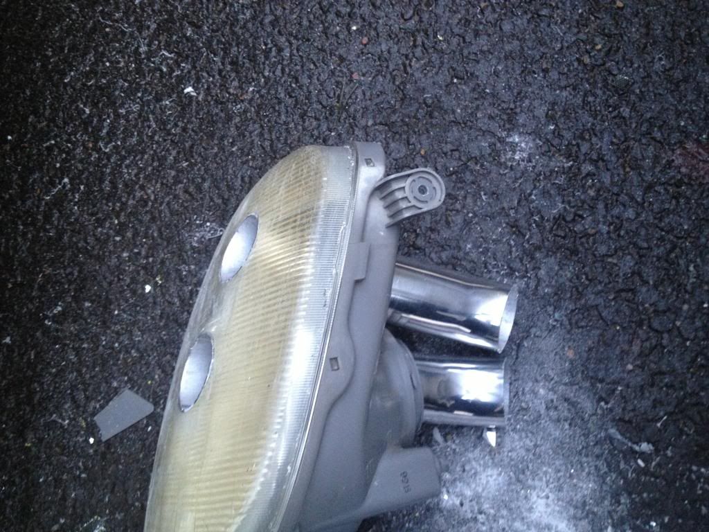

While at glens yesterday doing his car i got a lick off paint on my headlight intake. Yes its not performance enhancing but its just for looks

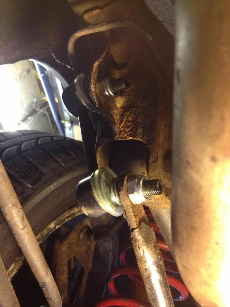

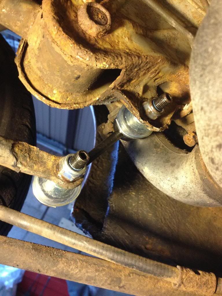

We also got my rear drop links but i fitted them the opposite way round because on one side my exhaust was knocking off it. Is there anything wrong with fitting them this way??

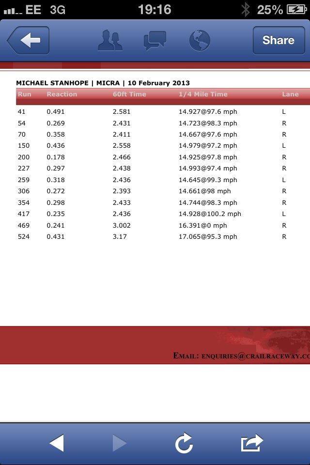

Also got over to crail today, was actually dry/cold but windy! Managed to pull off a decent time to start the year with, i lost twice which were my 8th race and 2nd last. One was a DC5 integra which looked to have plenty money thrown at it, i did beat him by a few metres the first time we raced but he got me the next time by about the same! Then my mate in his mazda 6 mps beat me by a fair bit due to the rain making an appearance and his 4wd system lol im happy with what ive got as i know there are easily improvements to be had as i deliberately took the car down 'standard' to set a time :)

Nice to see some 1/4 times being set. I'm hopeful that finally some of these CG's will be my ST time @ pod.
Cheers, im glad ive stuck at it. What time did your ST get? Unfortunately i cant ever see me making santa pod so beating that time elsewhere means nothing unless by a good margin which wont happen

14.01 @ 100.1 is my best time.
Nice, maybe the difference in surfaces?

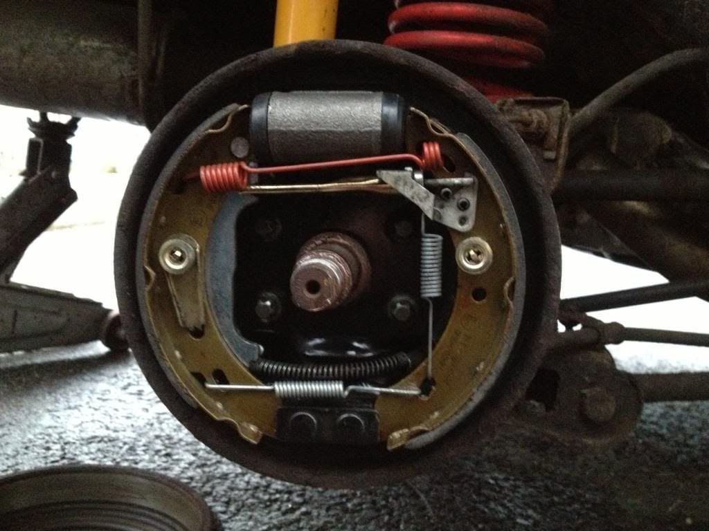

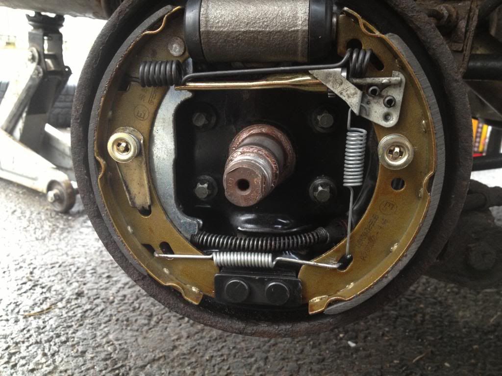

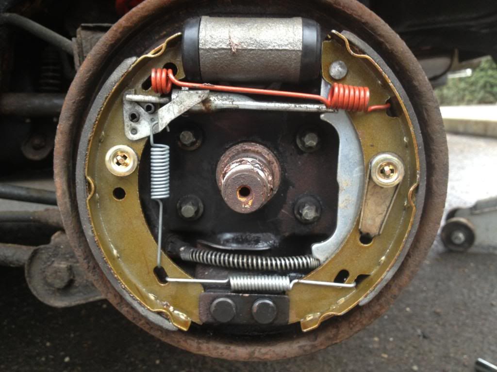

Yesterday after work i made a start on fitting new rear cylinders/shoes and spring kit. Managed to get the drivers side done before it started to rain so finished the passenger side today. Had a few problems especially trying to remove the brake line, turns out i had to chap a 10mm spanner onto the 11mm fitting but upon turning it the brake line was trying to twist with it so some WD40 and back/forward turning i was able to remove them damage free. Got my dad to help with the bleeding and setting them up evenly as its a pain going back and forth! One other thing in the new spring kit the longest springs were different colours (one red and one black) turns out there sided and i didnt realise until i opened up the passenger drum so had to take the other one apart and swap springs! Anyway glad thats out the way, just 2 patches and exhaust to swap and i may have myself an MOT.
Heres the drivers side complete but with the red passenger side spring (i thought it didnt quite look right)
Heres it is again with the correct spring
And the passenger side done
