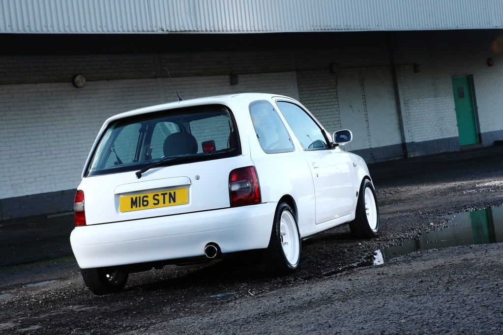

Also threw my rear bumper on to see how it looks
