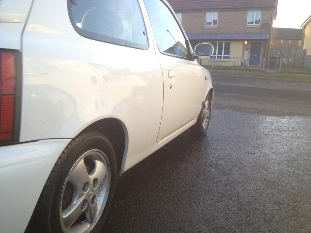

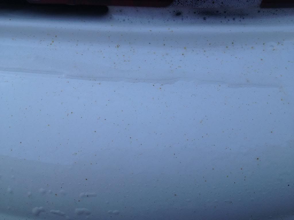

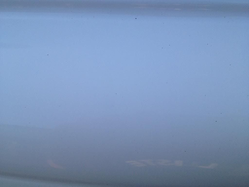

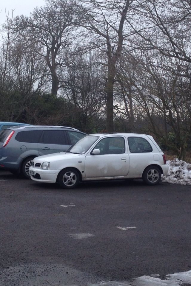

I eventually fitted my new distributor that we bought months ago now that im selling my other to oddball, also withthe car getting really dirty recently i had to give it a wash too. Turns out after scrubbing the car it was still covered all over in small orange rust spots! I used oven cleaner and had to go over the whole car than wash it again and double check id got them all off :(
New dizzy
Rusty spots
Clean
Cant wait to get the steels back on!!
Staini I'd go back with them dust spots looks like a lack or prep or primer under that paint
Even on the plastic bumpers though? I was putting it down to other rusty cars and spray from the road. Never had it last winter and the car was just as dirty

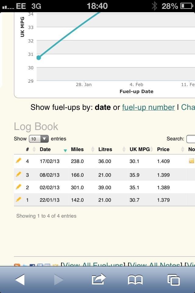

Been keeping track of my fuel and mpg on www.fuelly.com spent a little over £200 this month :O

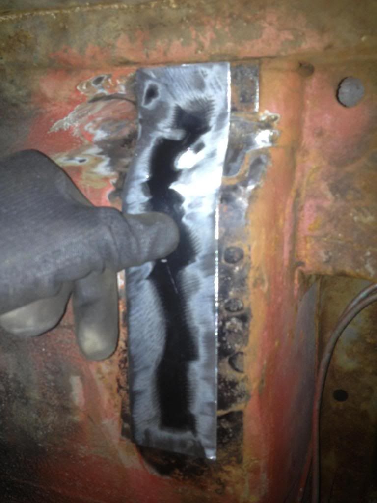

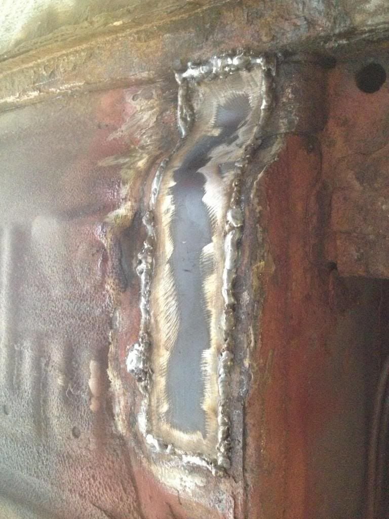

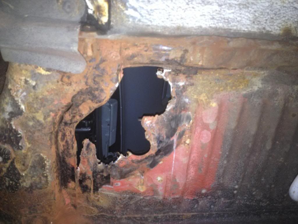

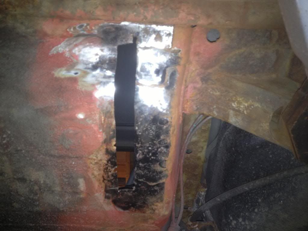

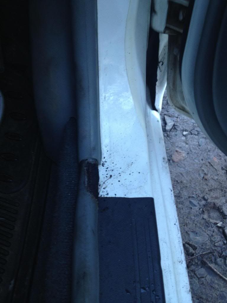

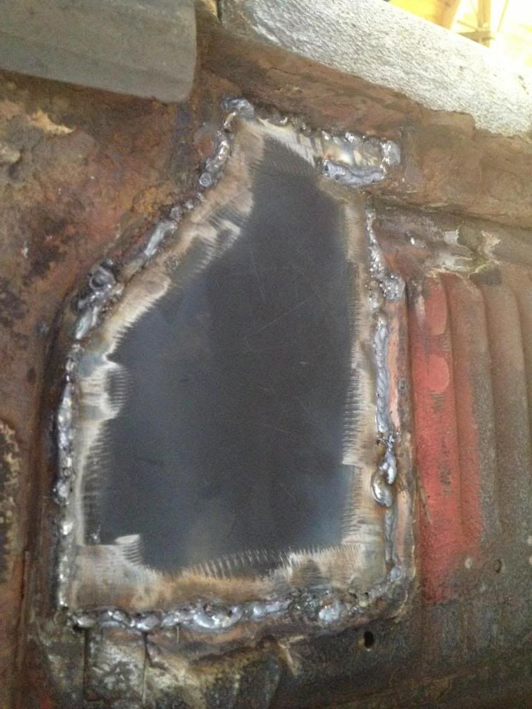

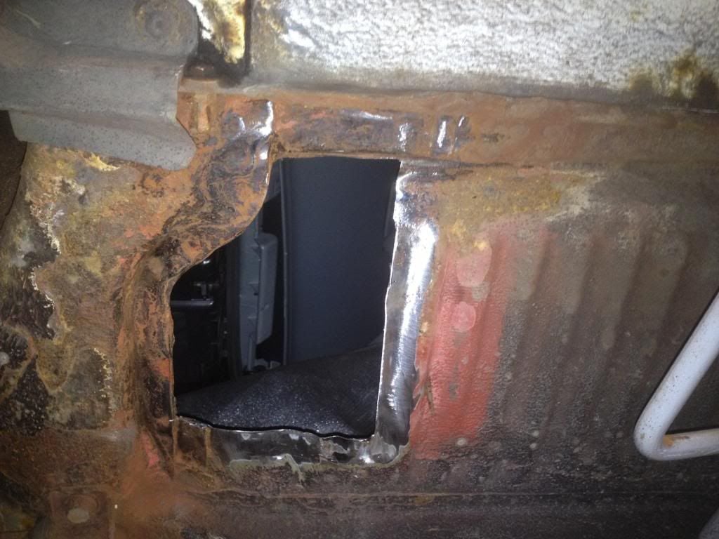

On thursday me and glen took to the rust again, we decided to clean back the areas, cut them out, get the new pieces cut ready to weld and kurust them over night. Glens dad got all the welding done this morning before i was even able to get over and im starting to be happy with the car again (rust wise) we got the custom exhaust off and the exhaust that will hopefully pass MOT on. Car is now silent and extremely sluggish which was always expected, we also got the remaining metal brake pipes (2 rear ones) cleaned up and copper greased but i need to replace the flexies which ill do before friday as im booked in for 9am. We also got the front brakes looked at as they were feeling terrible and the discs were in bad shape and 1 out of 4 pads were down to the metal!! Luckily glen has donated his spare stock discs and pads on a temporary basis till i fit my pulsar ones. Never got a great deal of pictures but heres what i did get :)
Front drivers footwell
Rear passenger footwell
The patches are zinc primered, stonechipped and undersealed just like the previous 2. Big thanks to glen and his dad! :D

Nice one! What's your rough MPG Paul? My latest half tank was £141.9 that's another penny since the week before, at this rate alot of people are going to suffer, it's like a government are that stupid they can't work out petrol price affects every single person
you torched it stani ? :D and have you lost about 40hp with the stock system ? (mine did)
Yeah it obvs got out of it being tucked and was stuck to the patch lol and frank the car is so unresponsive its amazing how much a free flowing exhaust makes, ive set the boost controller to 0 just let it run off the actuator eventhough im now back to the driving style from before it'd been mapped so no boost required!
I'm guessing that was a welding mishap :D Minor inconvenience! Car is looking really good!! Good luck with emissions!
Yeah it was, even if it was the carpet who cares eh? :p and thanks thats my only worry now

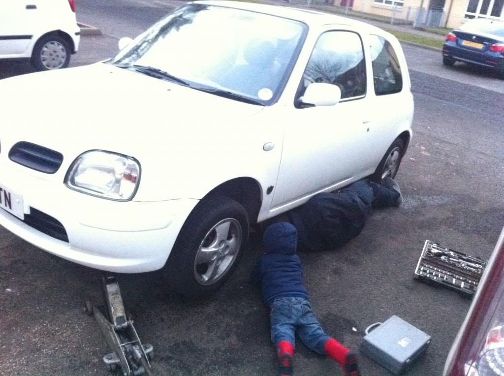

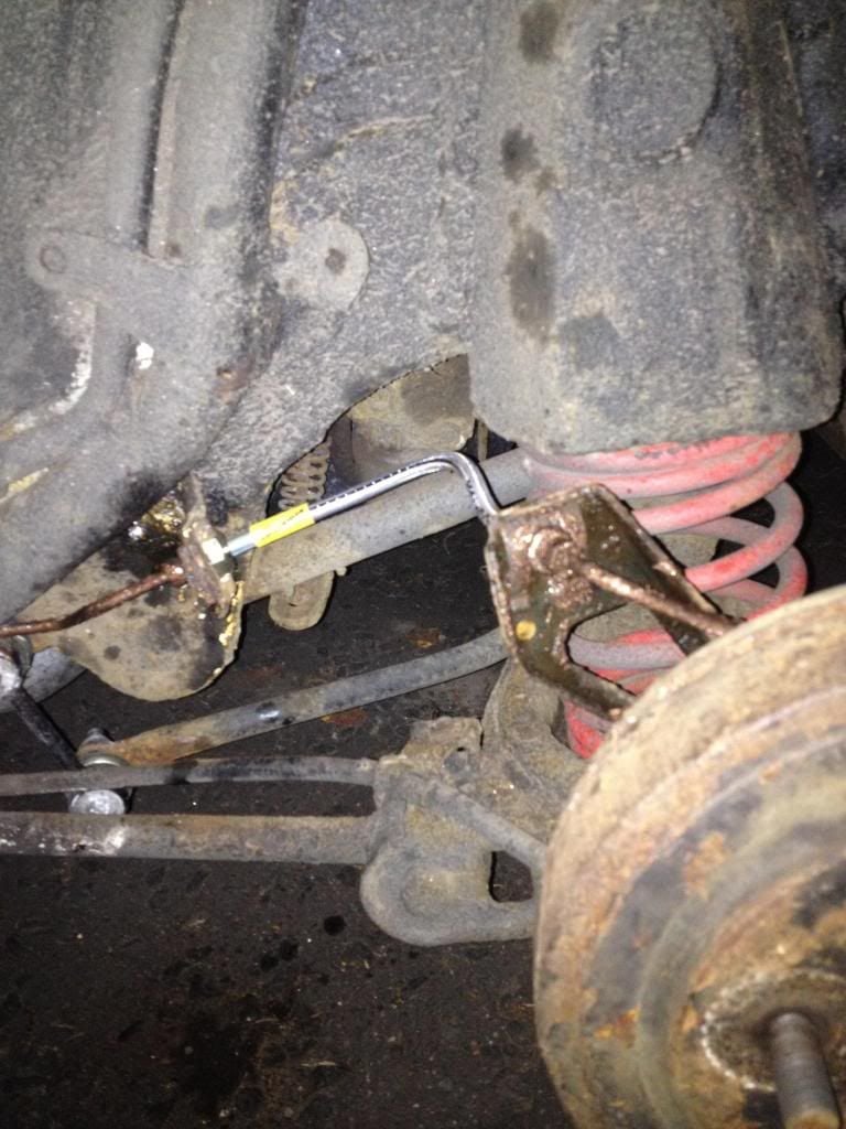

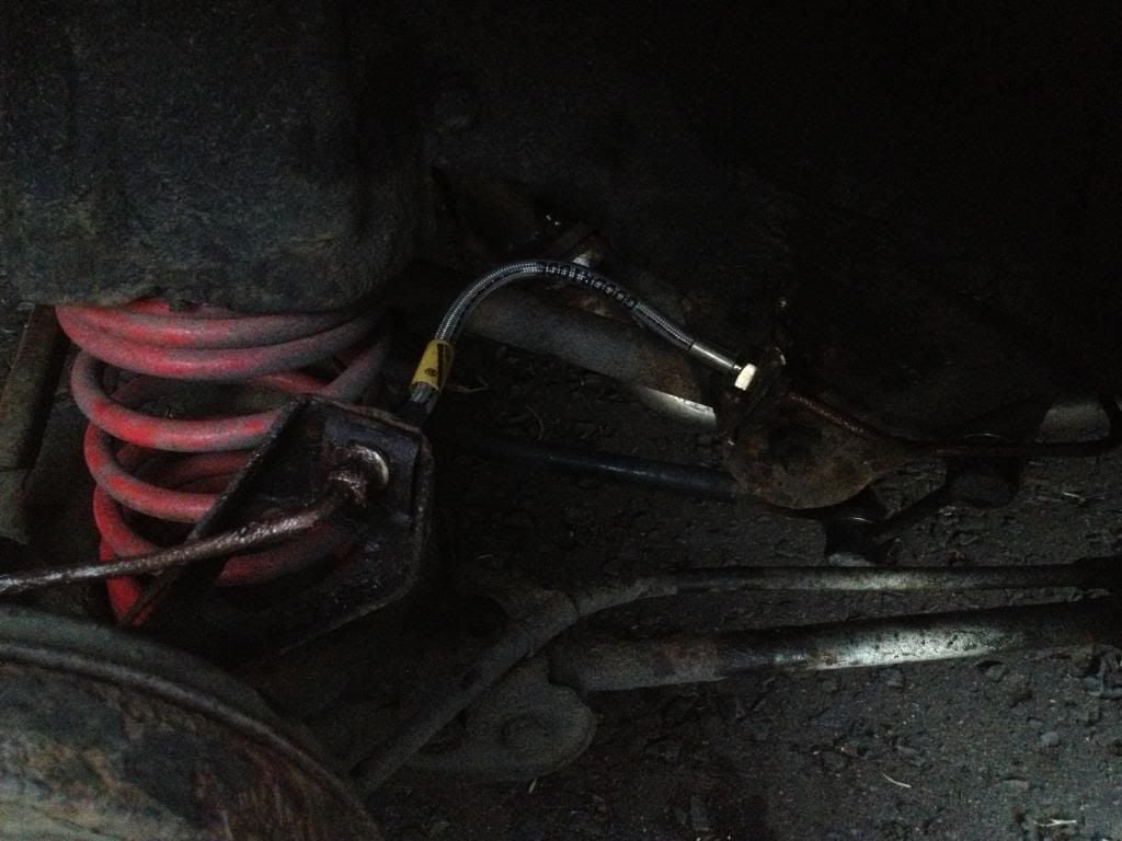

On wednesday i got the 2 rear brake flexy pipes replaced, was surprisingly easy. I found it best to wire brush and WD40 till there almost clean then crack the seal with some mole grips and use an 11mm spanner to free off the remaining dirt. Also after fitting my stock exhaust there was a leak at the cat area so whipped that off, put my loctite sealer in and left it a few hours before i started the car. Once i did it was still leaking! So had to do it again last night, turns out it was the other side of the cat this time so apart it come, loctite in and left until this morning. Took car for 1/2 hour drive to warm up before MOT @ 9am. At first it wasnt good, because the car sat for maybe 5 mins on idle the guy had turned the car off to check dash lights but took 10 mins to get her fired up again! Anywho the initial test seemed spot on, now emissions test! At first try i think he said the c/o levels were too high (0.6 when meant to be 0.3) while we had to wait on the machine for the 2nd test the guy was revving the car as he was sure it would pass this time and it DID! :D levels were much better after heating the cat more.....
Goodridge brake flexys
Had a help from my son doing the exhaust repair last night
