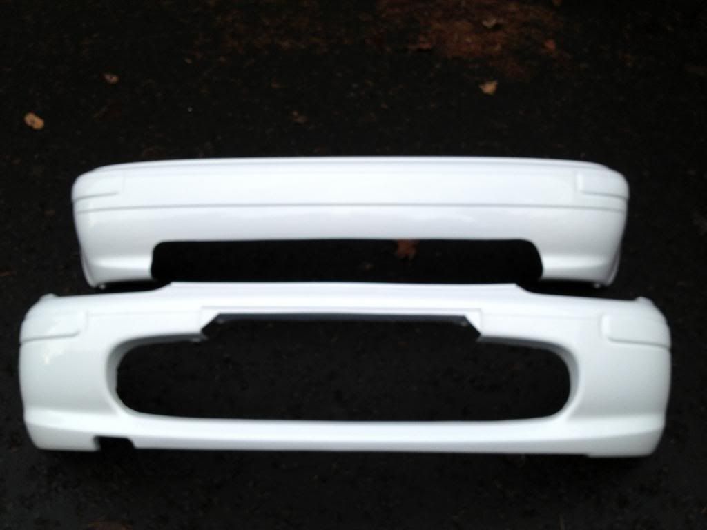

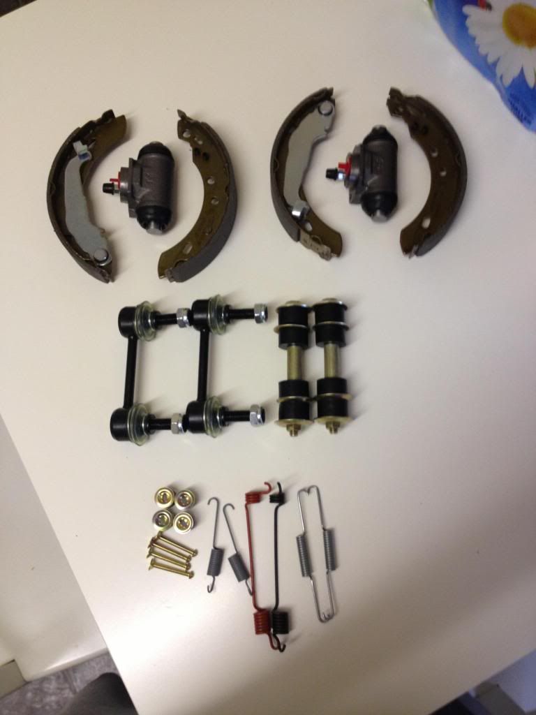

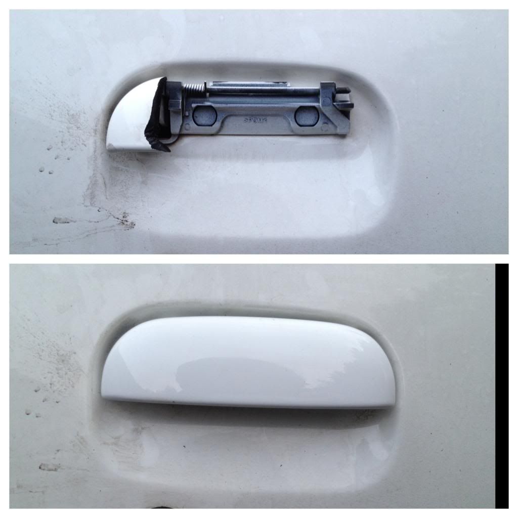

The last week or so ive handed in my bumpers (for track use) and new drivers door handle for spraying as my mate accidently broke mine, ive also had some reg plates made up for track. Also got my hands on a set of pulsar calipers/discs an pads and ive bought new rear cylinders/shoes and spring kit as ive not replaced them yet. While im there ive to swap the passenger wheel bearing as previously ive swapped the drivers aide twice but sue to my dodgy hearing it turns out it was the passenger side the 2nd time LOL

With regards to the anti roll bars im getting off hoodedreaper ive bought new front links and rear droplinks just to be replace them really. MOT is due 7th march but will do it as early as possible to get a month notice. Will be replacing the rear brake pipes also and fitted my long awaited braided flexi pipes too
Its all off ebay, not seen many spring kits around though....

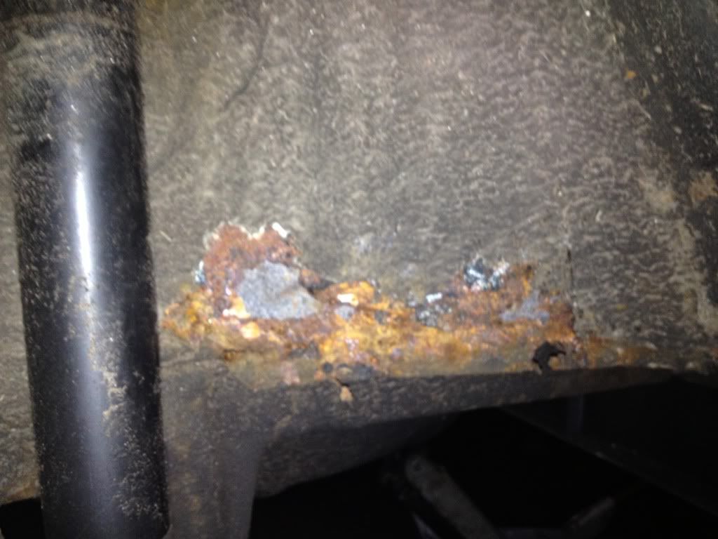

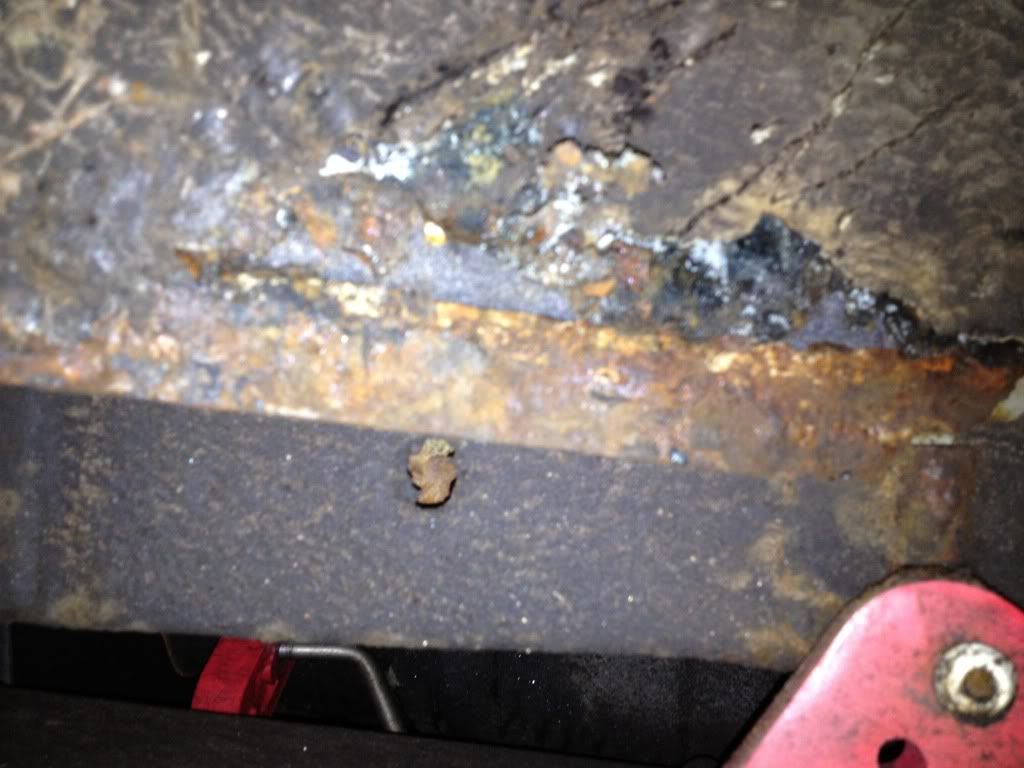

Went to do some of the repairs tonight but soon gave up after finding this :(
Never seen rust in that area before so im pretty annoyed. I noticed that some of the seal was hanging off so went to town on it and ended up that way. If im going to keep this car im going to need to cut it all out and redo. Will end up doing so myself as im fed up of it being patched

That'd be just under seat belt mounts, no? Id be checking those as well, pull panels out the rear and get a proper look inside the car as well before repairing

No no, that areas good, its to the rear of each strut. Look at the pictures closer you will see
Have you a sunroof? I know on my mera behind the struts rot out and in the boot area because the sunroof drain became blocked, hardly a similar issue?
