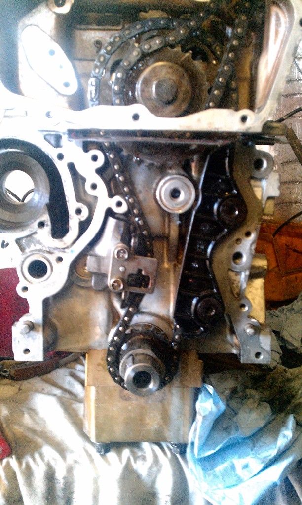

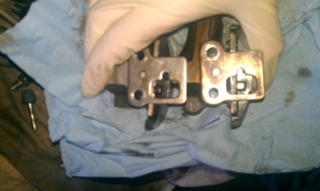

i thought you had read my blogs, 5 minute job that slackens the lower chain, and tightens the upper oneHad to shorten the lower timing chain after the block skimmed 3mm (micra piston), took out one link but now the chain is to tightso tomorrow will see the tensioner getting modified a bit
I have missed guy, where has he been for ages?
i thought you had read my blogs, 5 minute job that slackens the lower chain, and tightens the upper onei left the small tensioner off too, (depending on how worn the chains are)
aye where ya been mate![]()
ahh, my badYep I've read it and lowerd the idler but it's still to tight, but Ive looked at the tensioner and it doesn't go all the way in so it will get modified slightly.
barely run in then ehPretty much done about 10k, had to leave off the little tensioner, will get pics later
