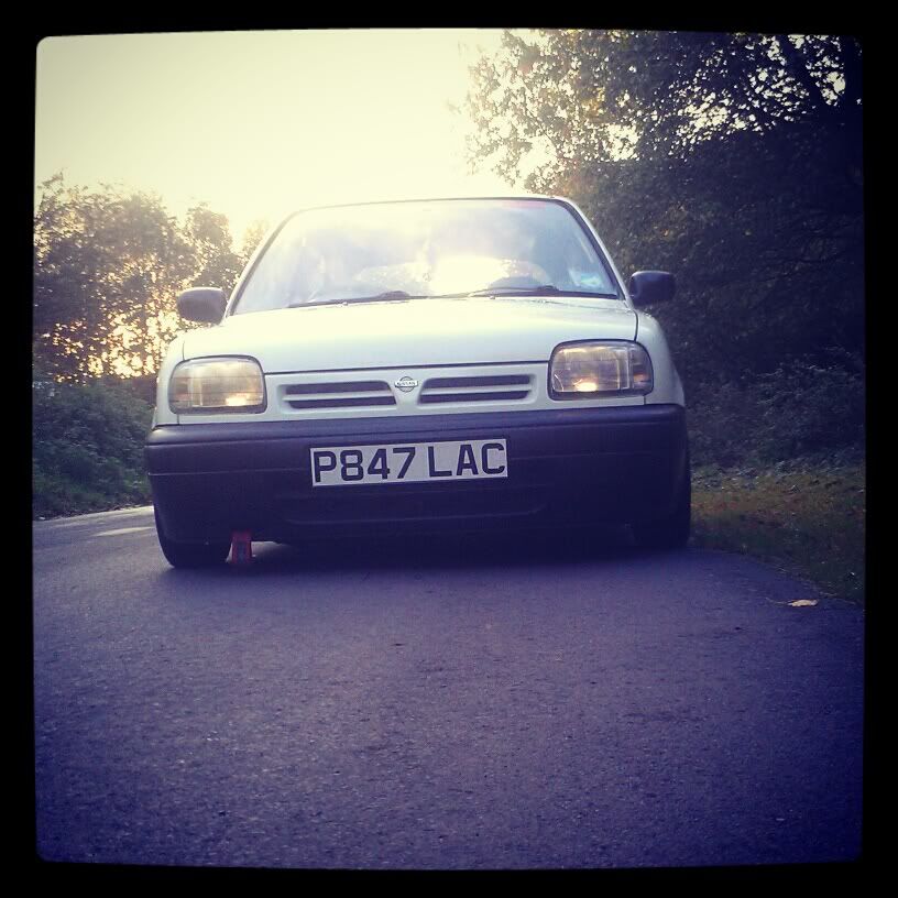

was it as much hassle as ive heard to do corsa coilies? im thinking of getting the lower spring seat dropped on the stock shocks instead, just 20 quid for the welding at my garage... should sit with approx 1mm arch gap on the front after lol
Na its easy tbf, even tho i had a fair bit of help lol
Well thats alright then! might start looking see if i can find a cheap set then, probably safer than what im doing atm lol, its basically so i dont end up with bitchin' negative rake when i chop the back springs for the corsa shocks ive fitted...
That would leave it riding on the bumpstops joe ! You need a shorter leg if you want any suspension travel
Lucky i havent got it done yet then! Thats one thing i hadnt managed to check yet coz i'd need the strut off to check where the bumpstops were cutting in. I know i can get another few mm grinding the boltholes a bit but if what you say with the bumpstops is right (and knowing you its spot on :p ) then im pretty much stuck on the stock fronts!
the stock leg has about 4" of travel when the car is on the ground eh joe, so my alto springs leave about 2" of travel before contact with the bumpstops guess, matiz legs are about 2" shorter to start with :)
Are matiz legs a straight swap frank? would i be able to put the micra springs on them? IF i can thatd be almost as cheap as the old plan and would actually work too!
