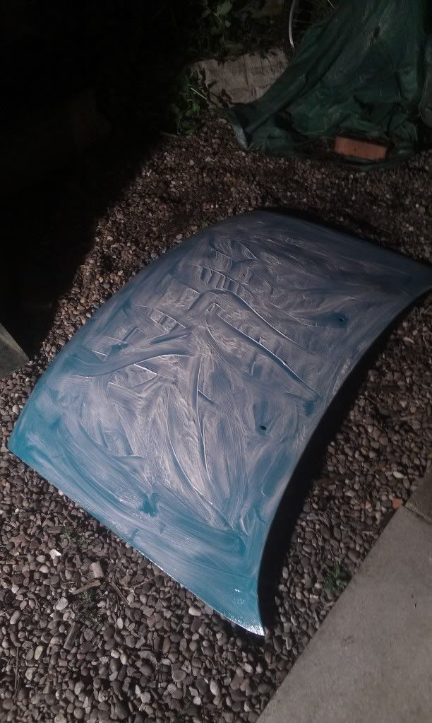

Been doing something different today
Been trying to get the paint off all day, nitromorse worked ok in the end.. im going to either take it back to bare metal and polish it, or take it back to bare metal and make it rusty over time![]()

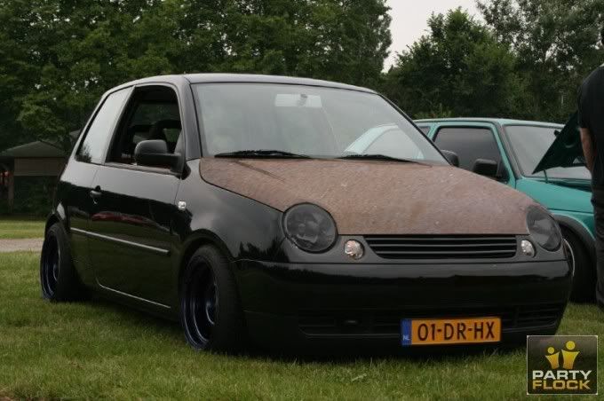

Lol itl be a fun different then, change of plan, il get it sorted tomorrow ayitIf you're going for the rat look bonnet I found this:
"need to sand/angle grind the top layer off so its realy shiny, nothing worse than thinkn it will rust with the galvanise still on. then when its proper proper shiny get some vinegar, lemon juice n salt, in a squirty bottle, spray on n wait. if you have grinded the surface enough it should literaly rust overnite. i found just salty water gives a good rust as the lemon and vinegar make it soooooo fast it doesnt rust enough in some places, just very very light creating a surface barrier for more rust to actualy bed in, it will then come off in the rain. but be prepared to wait longer and apply a good few doses"

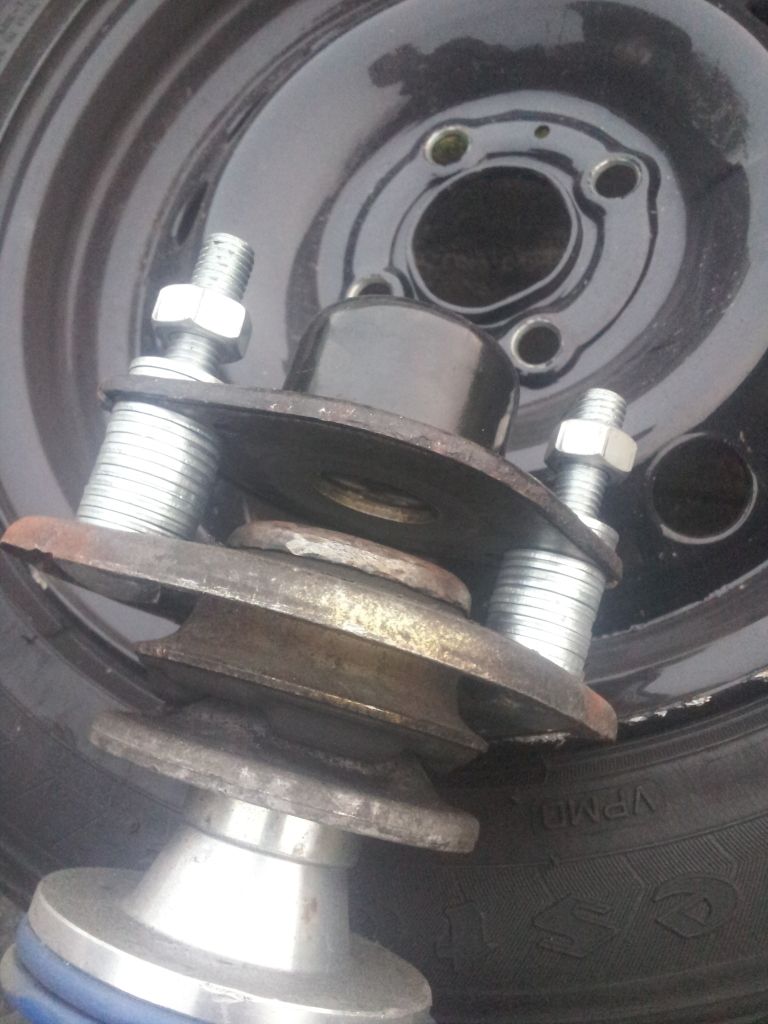

fitted the cut-down drums and hubs i did a couple of years ago, and then turned the other ones down on a lathe (less cowboy-esque)
View attachment 21238View attachment 21239

Made a start on my rusty/rat bonnet today
The rest of the car is staying ''clean'' just done this for a while![]()
Meh i say! lol, im no follower just got boredThere should be rules to stop this kind of thingit isn't a VW you know
Awww jayI don't like it Doug sorry.
