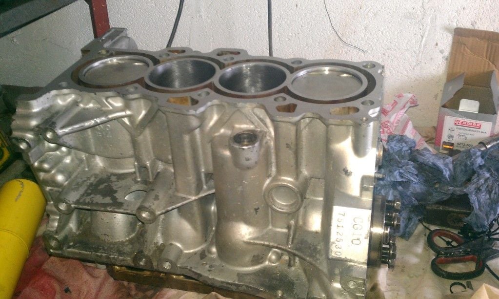

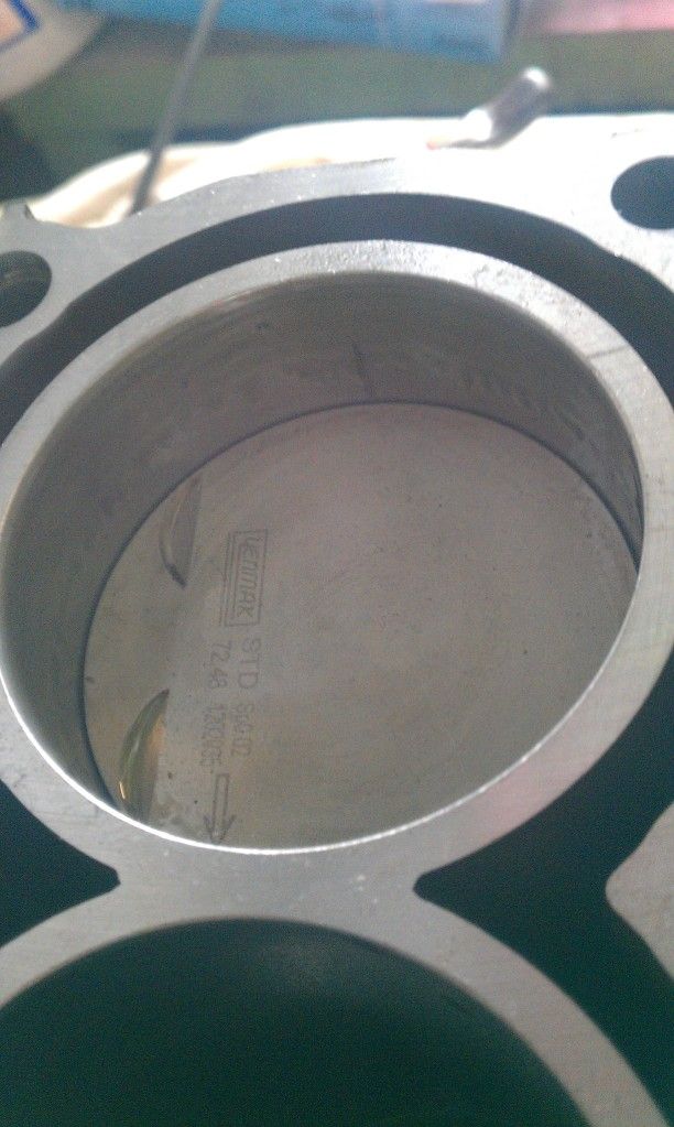

if you dont mind me asking how much was it to have the block bored to fit the corsa pistons and for the skim?Dropped engine off for a 3mm skimhopefully there's not much of a wait
i shortened my headbolts by 5mm too btwDropped engine off for a 3mm skimhopefully there's not much of a wait
is the 3 mm skim to bring the block flush with pistons?i shortened my headbolts by 5mm too btw![]()
ayeis the 3 mm skim to bring the block flush with pistons?
Im thinking about high comping the cga3 but need to look into prices n stuff :/ may turbo the 1.0l propperly
cheersBore and skim came to £120, pistons new with rings wher 40 each posted
cheersGone for the 1.2 as their flat tops to help up the compression ratio. Yep stock rods.
