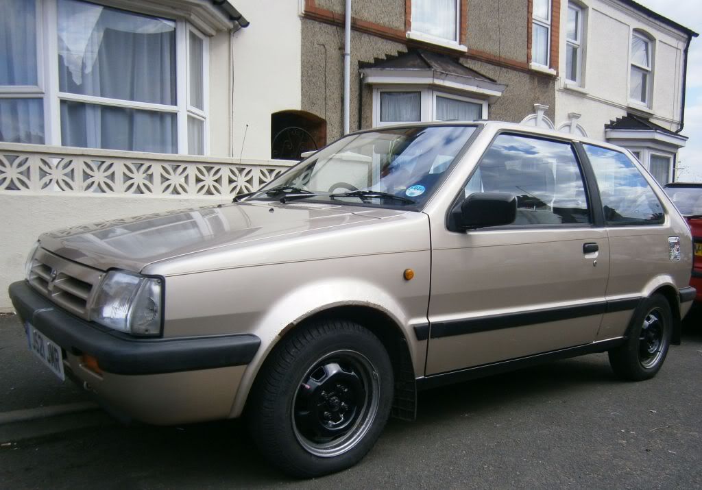

£150 for four wheels with good tyres spacers nuts and spigots... :)
£37.50 each... probably cheaper than the tyres you need to get for em now... lol
whats the spec on yours?
Lol, I spotted them the other day, I almost couldn't resist putting in a bid.
Et will probably be listed in imperial as 0out or 0.25in for example, but is easy enough just to check, measure the back space, measure the overall width, half it and then take it away from the back space. Take all measure ments either from the outer edge of the rim or from the bead seat, but don't mix and match.
Hold out and another pair will turn up at the right price.

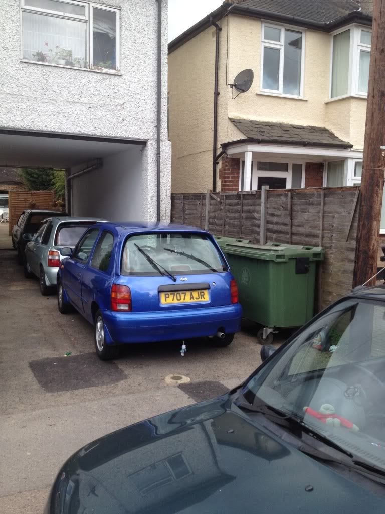

and thats where i work most mornings lee :)

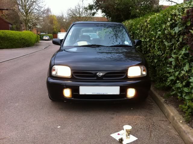

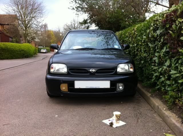

I fitted a yellow flyeyes kit to my fogs :D I was gonna fit the headlights to but i'm not sure now, I quite like the contrast between the heads and fogs. Sorry I couldn't get a picture of both but it started raining just as i finished.
