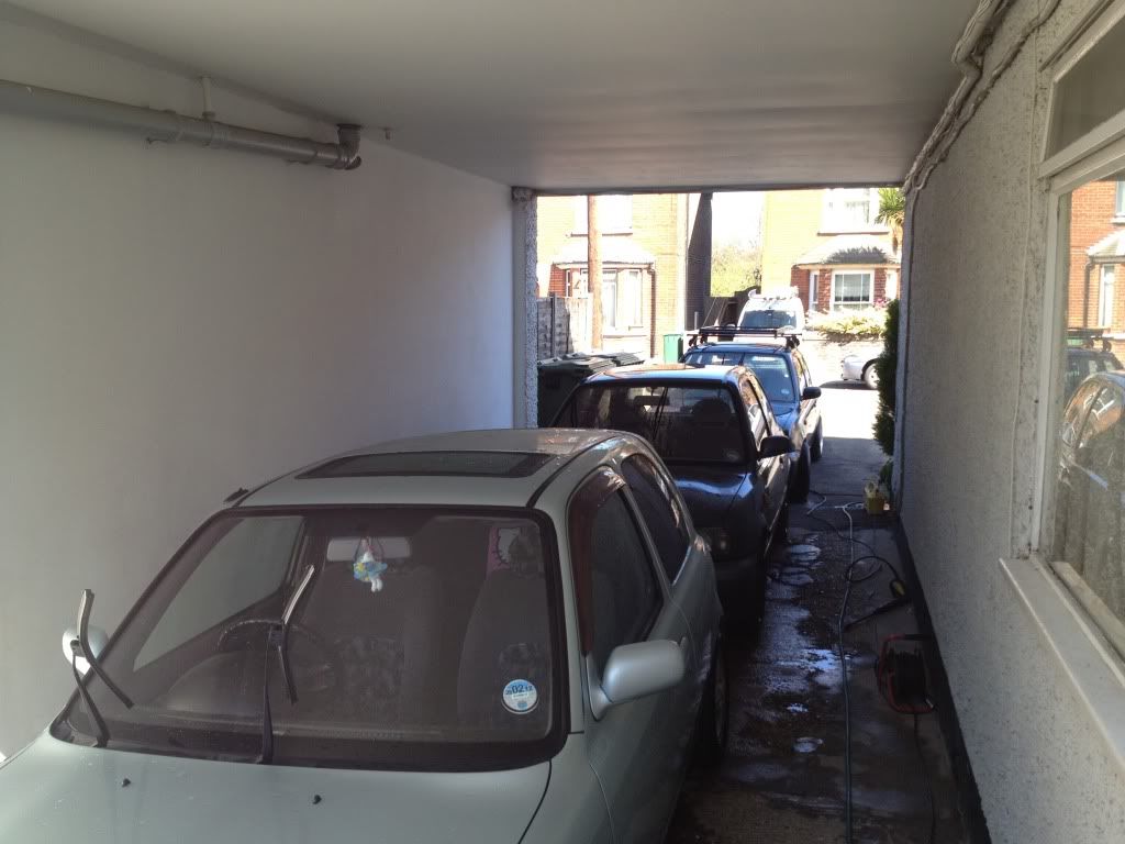

Got my heavy duty puller in the post. It got my passenger side wiper arm off but the driver side wouldn't budge. Finally found an old knackered puller in my dad's garage. It kept tilting off but by leaning my entire body weight on it eventually came off. The spidle was covered in galvanically corroded aluminium. I've put out a scrappy request for new arms as they're chewed up to heck.
Note to Nissan in Wigan. USE. COPPER. GREASE. BETWEEN. ALLY. AND. STEEL. AND. DON'T. OVER. TIGHTEN. EVERYTHING! (This is the same garage that meant I had to sploosh £70 on a rattle gun to get my wheels off after they put them back on with air tools!).
