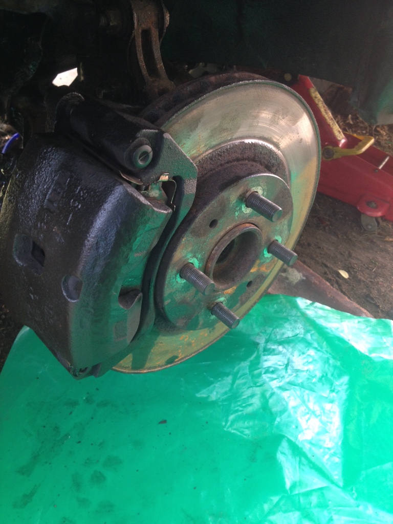

don't use copper grease, wd40, oils or any petroleum based lube on rubber seals cos it gets absorbed into the petroleum based rubber making it slowly swell up permenantly over time till it binds & dries up (uneven wear from binding guide pins), which then makes removal & reassembly slightly more difficult next time.
suggest using non petroleum grease like silicone paste or red rubber grease or stuff labelled for rubber
I've been using waterproof grease for mountain bike hubs for ages... Cheap and never given me grief :)
yeh redone the caliper today and took copper grease off and used rubber grease so gona bleed it all out now
on metal/metal bits or outer shielding rubber seals the swelling ain't a prob,
the issue is more applicable for any tolerance dependant rubber seals such as rubber o-rings, piston seals, guide pin surrounded by rubber sleeve.
the swollen rubber basically jams tighter against the metal, pushing grease out and increase friction.
if you know that then chap, why you asking lol. you know how to check bearing play dude?
I was asking because it wasn't any play in before I took the hubs off to redo my calipers after I changed it then tighten it up and now I have play in, I also had no shafts in and I didn't feel any play in
Never seen a bearing saved that way but its worth a try I suppose!
Yeh true am sure can be bearings coz there is no shafts holding it and when the jack goes down it wobbles the tyres inner more so bearings I think, I heard u need a press to fit them ?
