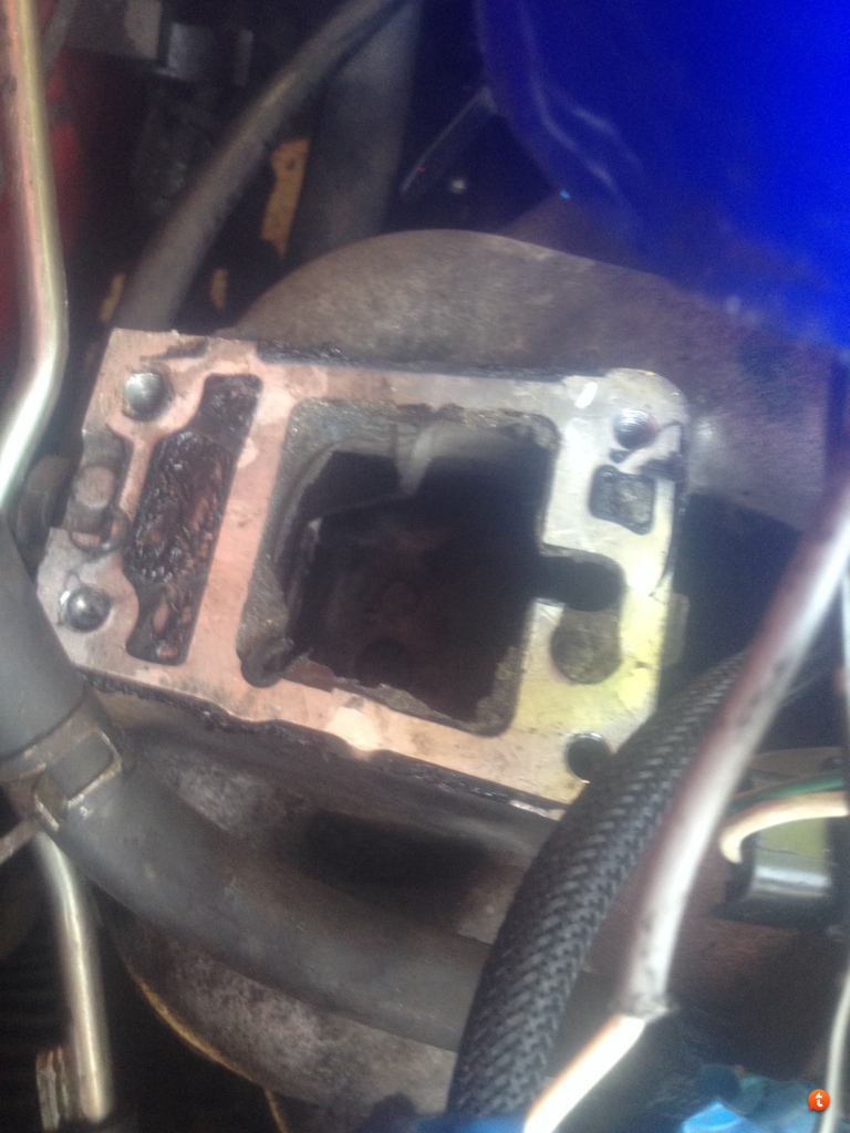

Frank I fixed the the seal on the Thottle body, and found this
so cleaned it all out and used just halfords spray, and replaced idle valve with my old one, started it up and no leaks on there, now when I rev the car it stutters and don't wana rev up ? with maf plugged in or out it's same matter ? I took the rocker cover pipe off to check and it reved up ? So am guessin there is no leaks I can see ? my gearbox underneath is leaking all over ? I don't see the housing plate on ? Do I need this or is there a loose bolt ?

frank I have noticed my dump valve isn't working at all tryed 2 now and nothing working ? Can it mean something ?

when you rev it in neutral azzy ? because it only works when you,re driving really eh
I have a geniune hks one I think they have soft springs and bov on low revs, but if that's the case how comes mines not workin now ? Can it be a leak for that to happend ?

if the car was idling too high with the idle control valve deleted then i doubt if its the injectors or map or maf mate, gotta be an air leak somewhere ?

if there is a vacuum leak then there wont be enough vacuum to jerk the bov open when you snap the throttle shut azzy
Soon as I started it up it was going from 1k to 3k revs without me touching the gas pedal? then I moved the dizzy cap so the car stays better and unplugged the throttle sensor which I can alter the idle control which made no Diffrents, started it again so it's all reset and it was doing same up and down on idle

I was thinking same frank got to be a leak coz no air is opening my dump valve like it use to ?

the hissing noise you described sounds like a vacuum leak to me mate, are the 2 pipes under the mani connected ? and the 2 pipes at the back of the mani ?
I have 2 water jacks in there, 1 pipe to fuel reg, and 1 on brake house. 1 going into catch can is blocked with a nut no leaks

just a listening tube really mate
yeh the tube helped me find the leak on the Thottle body so sealed it up and that's fine, I tryed tube on other parts of engine can't find the fault gona try the hand cover one Tommow see if that helps
