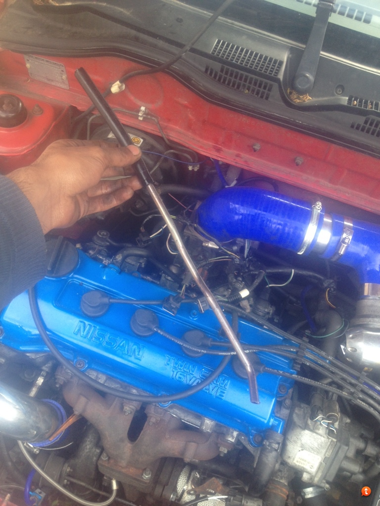

I just put fresh oil in 2 days ago but I didn't really check the dip stick maybe it's extra 1 litre in there ?
Sent from my iPhone using T
e="jamier2007, post: 681113, member: 13265"]If you put a whole 5L can in there?[/quote]
Maybe I put like 4 litres in causing it black smoke

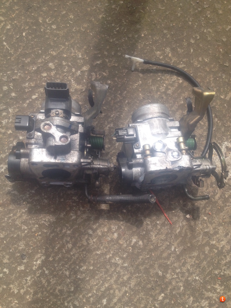

tommows job drill the top hole and use that as idle valve gona use a pipe and join that on see if it helps my idle

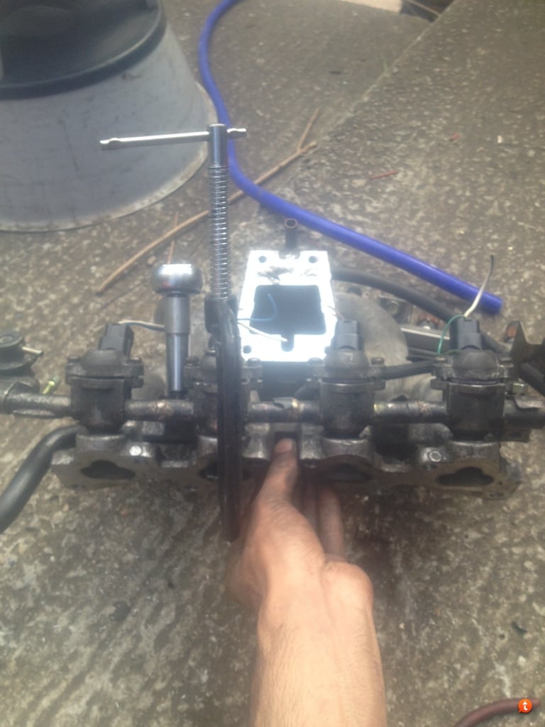

I haven't checked the Spark plugs as they brand new but will check this Sunday as am working on my car all day to finishs it more problems I found today was this

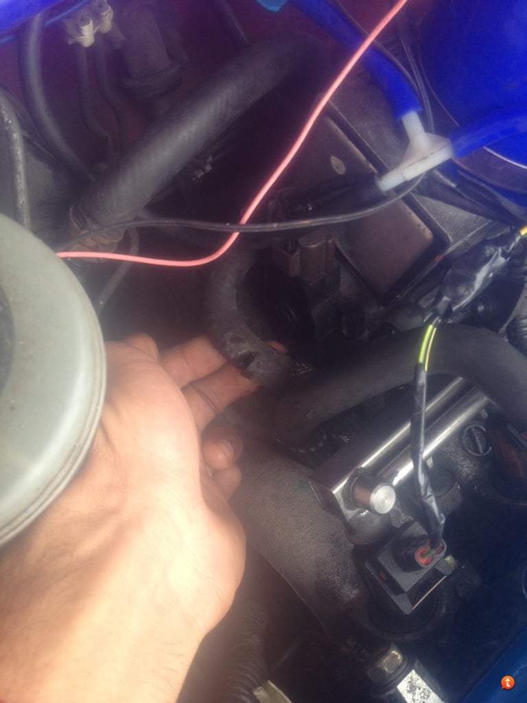

Water leaking from the inlet pipe ?

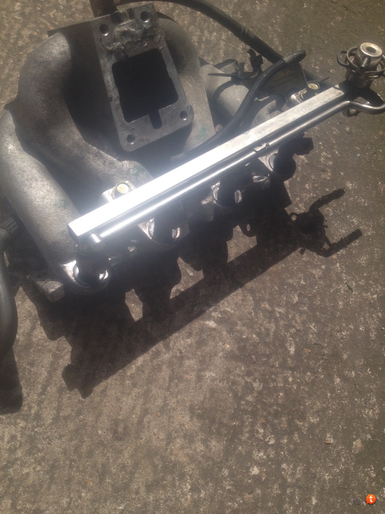

So long day today and got bit tricky till it started to rain

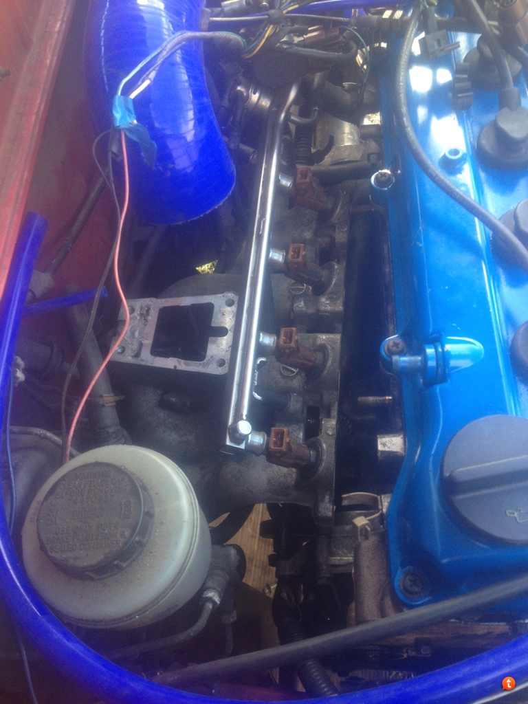

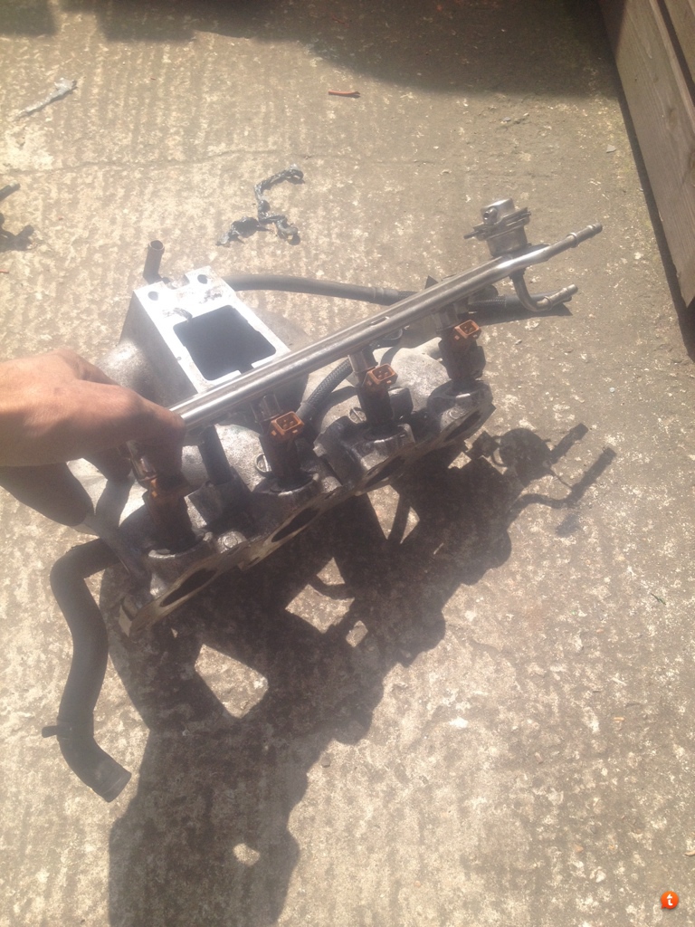

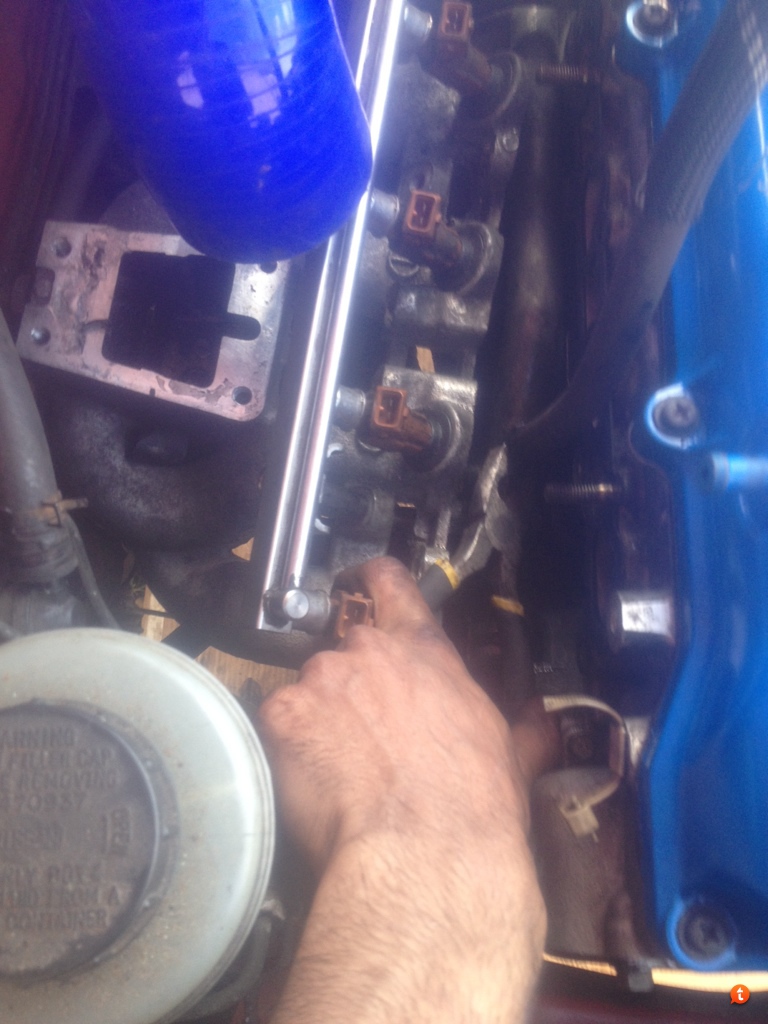

I started by taking the inlet off and Thottle body so I can swap over to idle valve Thottle body, now took my 350cc injectors off and swapped over to 370cc sr ones with loom I had found and chopped, now was the tricking bit making sure the inlet goes on and going under the car to get the 3 bolts on and holding the water pump pipe, after this was done I got on to my injectors fitted just right now needs wiring and fuel pipe extension to fuel reg as it's other side, too much rain stopped me to even finish 30 mins off it or start it up,

Its so he can run an iacv, right azzy? But I still not sure that that is the issue:) I would have mounted it remote like Frank did a couple if years back
Would changing the injectors size not mean changing the map Eds put on for you?
Good question when I had this problem I called ed first and he said the base map is originally for a 370 cc base map so my injectors shouldn't make a Diffrents so I thought of changing it over as I can have a idle valve same time, I will fired it up today and check
I'd say changing the injectors would mess up the Ve table ( if nistune use one)
It wouldt as ed said the base map was for a 370 cc but my injectors I had should be ok but I changed it so I can have a idle valve
I have tired remotely it made no Diffrent just went very loud and no idle then cut out so I'll try with idle

so extensioned my fuel line so it fits on the fuel rail end and on the prime it was leaking from the tig weld, I had rewelded it and now it's raining to even refit it and try it
