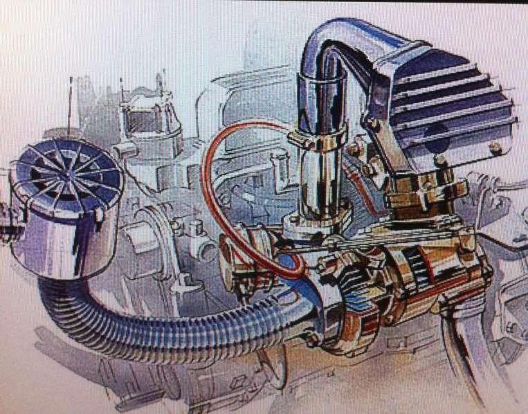

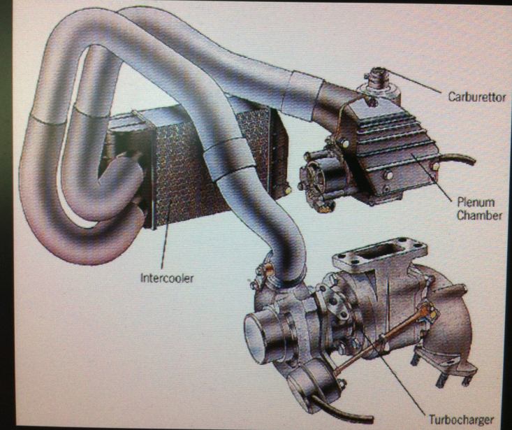

Your views and opinions on this wierd diagram of how the mg metro turbo works ? And thats supposed to be an su carb there .... Just a wierd picture
From what i see yes! I was told su is easy turbo but i didnt think that easy ( yes i realise its bound to be more complicated than i think :p )
Only thing you'll stumble on so far is your ignition and timing. Which is where me and neil are stuck.
Though the ma is a fast burning engine so you wont suffer much
Balls thats where id get caught seen as i dont have half the knowledge of you guys ,
But to clarify , if i make a random plenum box for air filter and connect that to turbo as shown , provided turbo has oil feed and all , thats that ?
( not including timing issue )
EDIT: not for air filter for carb
Pretty much in simple terms:
Bolt up turbo
Make air inlet with filter to turbo
Make piping from turbo to intercooler
Make piping from intercooler to plenum
Make plenum for carb
Then timing issue & fueling
Just got to save up for intercooler and turbo :) there the big bits :) i dont care , this is being done, . If i set up the su on its own , dyno it so i can have it set right and bolt up turbo then would i need to re adjust carb ? Or will it all come down to timing ?
Yea it will need readjusting. Na setups are very different to boost. As your carb acts as your fueling too. A boost referenced fuel regulator will be needed :) l
Timing will also need to be readjusted.
Boosted setups use less retard as they're air fuel mixture is hotter so ignites faster
Im afraid upon that i will be looking for help from all you mechanical stigs! Ha thanks again guys , looks like the setup has changed again! I used to be afraid of plenum because i didnt understand it, now it seems its. Just there to pressurise before the carb , now, off to find a turbo and intercooler!! Fook the exams ! :p ill study for them ..... Never :p
