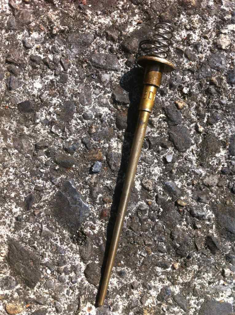

the needle size should be on the needle itself mate, stamped around the side of the widest part at top
edit: widest silver bit assuming its stainless needle with brass collar at top
No its just WK , ill have to have another look tomorrow , :) i wasnt sure how to seperate it , didnt want to do harm ha i took apart the carb but didnt know how the jett seperates from the spring loaded unit, :/ i took a screw out from side but still no budge ? I was afraid to do damage to something iv waited for for so long ,
Thanks man :)
Have had little or no time to work on my car :( but i just got to check the needle and thankfully it is BDL so that saves needing a different one :) happy out :) there will be nearly no action here till i finish my exams in june :(

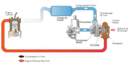

Just pondering for the summer , seem like easy logic for the power i would recieve ? Its a method that definatly works with the SU
Draw through turbo set up is what I had planned for my K10. Cheap and easy to set up, though not as tuneable as blow through. Can't run an intercooler on it either....unless you're planning on building a bomb :eek:
Yeah i cropped the wrong photo ! i found a pretty cool write up on blow through and draw through using the HIF 44 , it seems pretty easy to me! ( draw not blow ) carbon seal Because of the petrol right ?
If its not carbon sealed iirc it'll pull oil through the turbo and smoke like buggery....as well as drinking your oil! lol
Good thing is you don't need to sort much out in way of fuelling ie on boost enrichment sort of thing. most difficult bit will be fabricating manifolds and retarding ignition, neither of which will be that difficult tbh ;)
