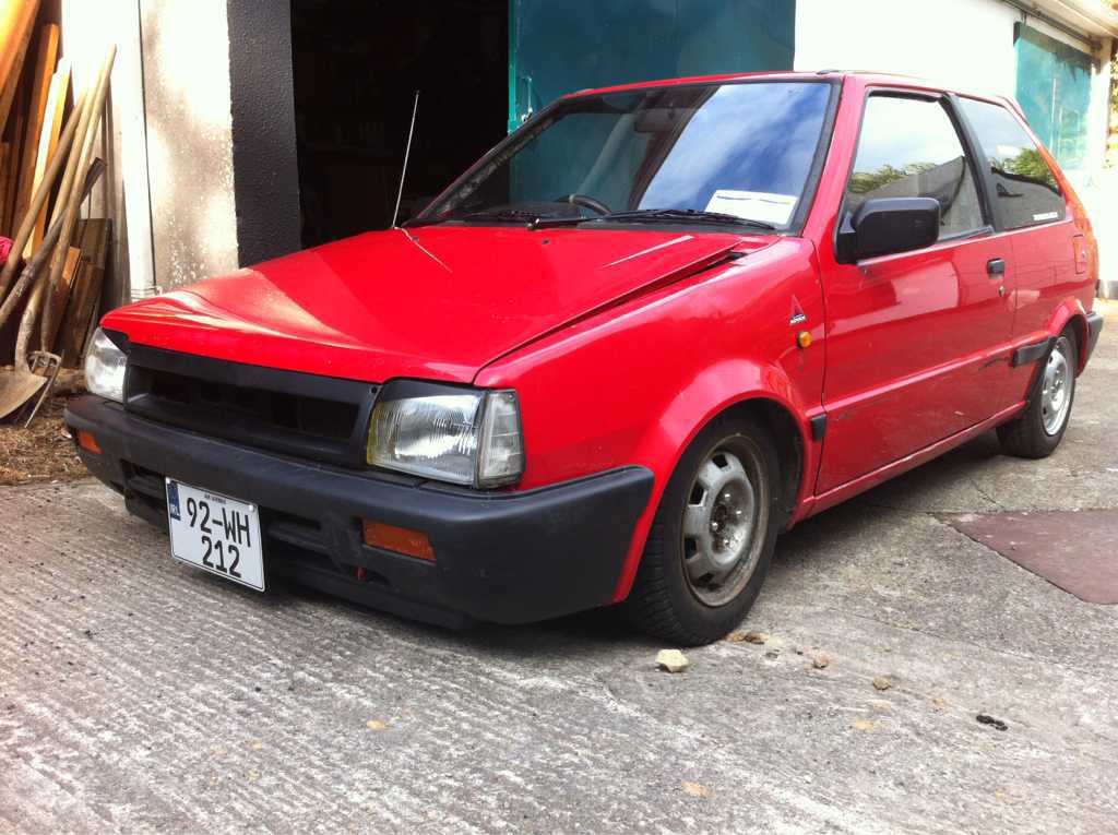

SU carbed k10
Yes im bad at welding but it should hold
Didnt get the car extremely low , but considering the hill in our yard up to top shed where i park it its low enough to just not scrape
Alloys back on till i sandblast and respray steelies

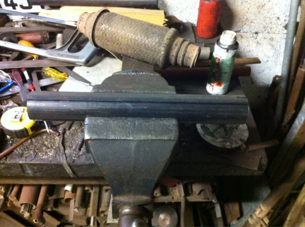

Went bact to making my straight through exhaust
Cut to length
Ends machined to fit over exhaust
Cut slots each end
Cut hole and welded in bung for wideband sensor , dont know why it doesnt look perpendicular but it actually is .
Thats what it looked like before i put it on ,
