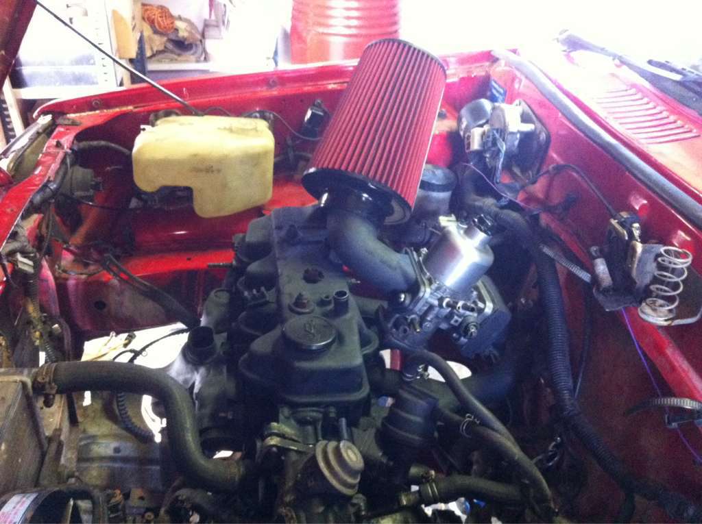

Ma12 cylinder head is on , Su manifold and for the moment standard air intake on SU , need to put back on timing belt back on and i need to figure out how to set the distributor into the head so i dont end up 1/2 turn wrong

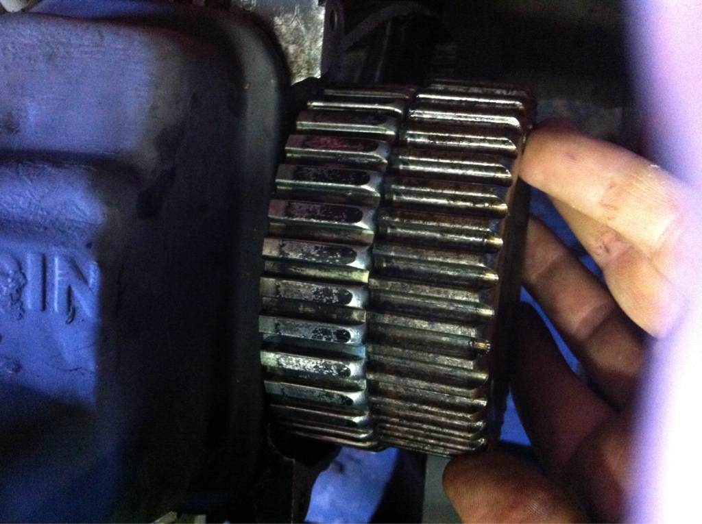

So met another problem , was gone all weekend till now, just went to put timing belt on ma12 head and the camshaft pulley is different and the camshaft pulley off the old ma10 head got damaged when i was stripping bits off ma10 head, so it was standing on its side , and it got knocked over and slightly bent camshaft pulley , why is it i rarely damage anything but when i do its something i need ! May go take engine out of grey k10 like i wanted to anyways , and take camshaft pulley off that , hoping that its the same , or get one somewhere else and not touch my spare engine ....
Yup they pulley , in fairness there on pressed steel theres no real strength in them , but basically ma12 head was missing a few bits that ma10 had , so i had head on a low workbench standing on its end while i took stuff off , went away for a while and while i was gone leprachauns must have knocked it over , it hit the ground pulley first , pulley was a little bent , ( bent beyond use ) so yeah theres a story to laugh at :p

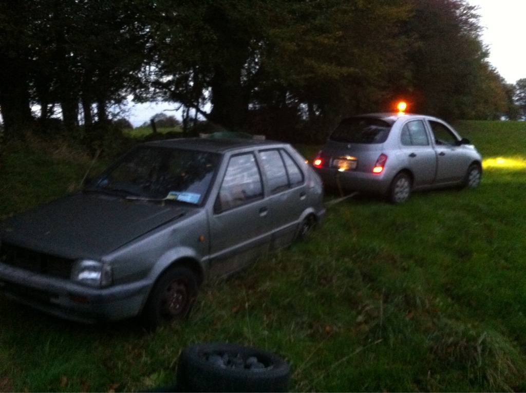

Lol pulled it as if there was nothing behind it ! In a wet field :p

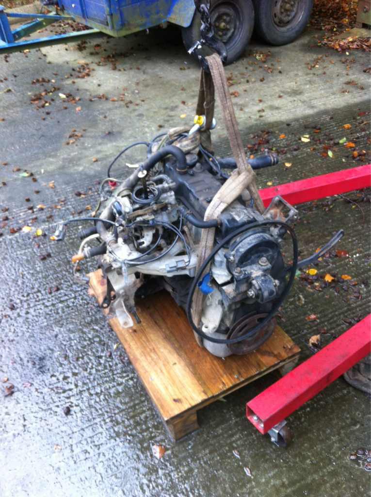

Engine is ready to be lifted , was trying to do it last night but it was pissing rain so i covered it and left it there , and now its pissing rain again :/

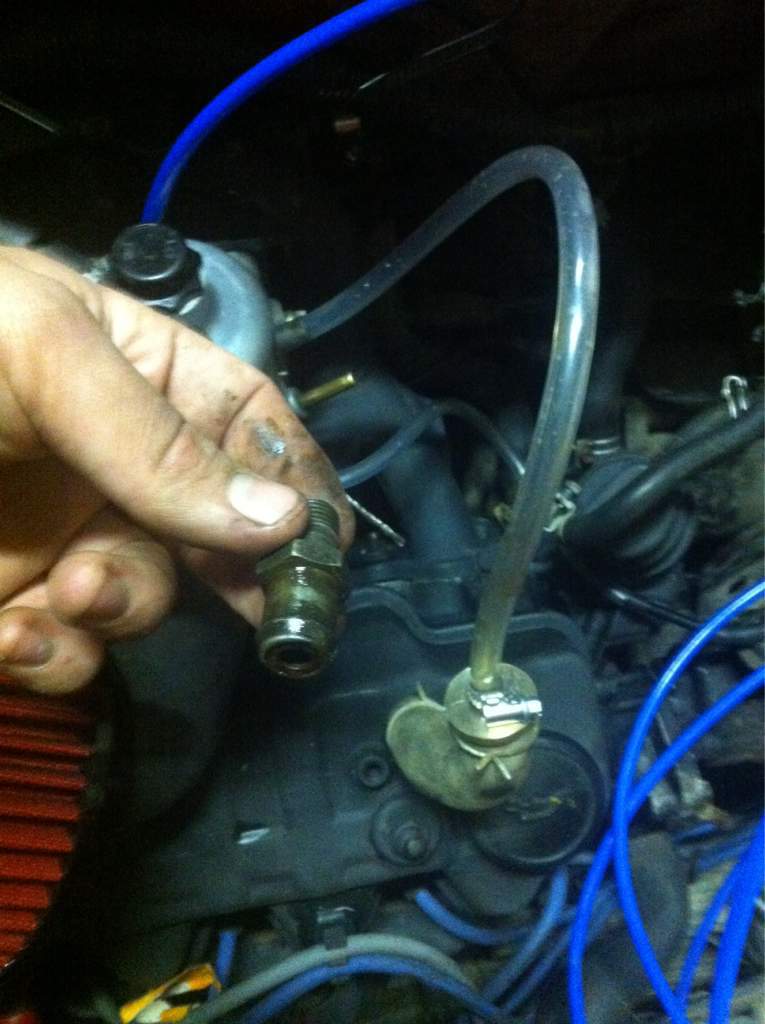

So everything done now , just need to pipe up these few inlets to SU

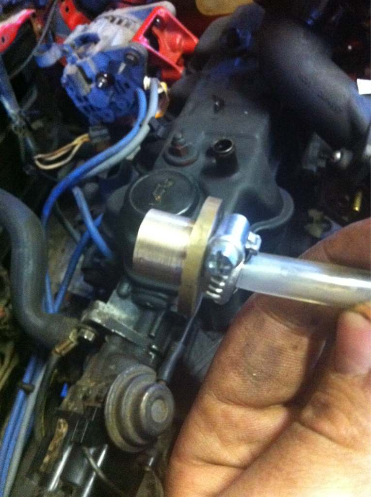

So this one is crankcase breather , so ill stem down. The pipe that other wise would have went to pcv valve

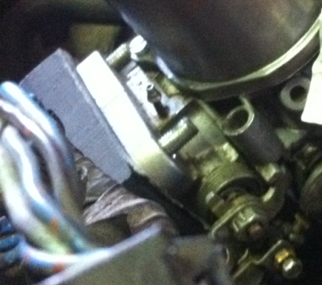

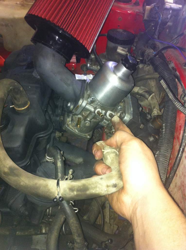

But out of the other two i cant figure which is fuel inlet :
Picture 1 :
Picture 2 :
So whichever is not the fuel inlet is fuel breather , where should that go ?

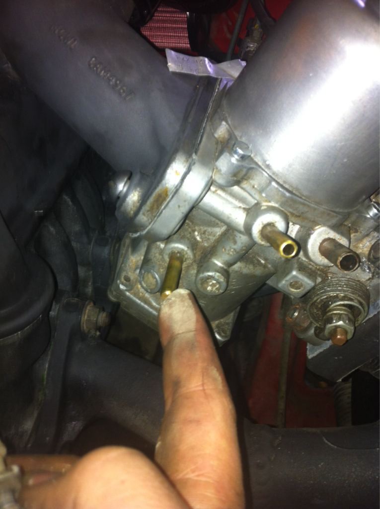

And finally : what pipe goes to this ?
Iv looked at pictures on google but they mainly say fuel inlet is on other side to what it is on mine
Next questions :
Where could i pipe fuel overflow , guess i cant be just dumping it ha
Also , seen as i still think the only petrol input the old standard carb had was from that pipe on the top of distributor , and theres one for that on su as well as fuel input on su can i use a T and pipe them both to the same feed ?
